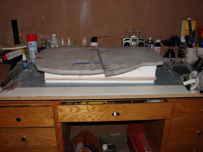

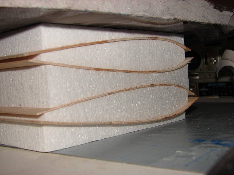

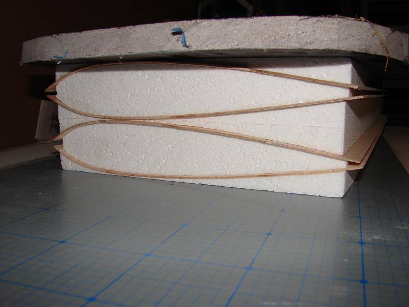

I started my Kougar over a year ago but I haven't gotten very far - I started it with the intention of adding retracts which was the biggest hangup. It just was sucking too much time out of the project and with my other responsibilities in life I couldn't make the time for it.
So, I ordered a couple of new wing cores and decided to start over. This is the thread to watch this thing get built.
Today I sheeted one of the wings, I'll do the other tomorrow hopefully, hoping to have them assembled by the end of the weekend.

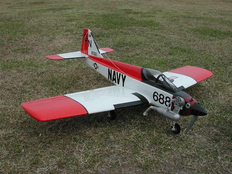

You will love your Kougar !!!!

PilotFighter,
Does the exhaust extension on your Kougar really help keep the plane clean??
Dan
Old 05-02-2007 | 09:34 PM
TexasAirBoss's Avatar
My Feedback: (22)
Posts: 2,972
From: Houston, TX
Default RE: Sig Kougar Build
Yep. Keeps the residue under the wing where it doesn't try to migrate through the saddle into the radio compartment.

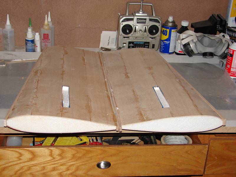

Sheeted the second wing this evening; tomorrow I plan on doing the leading and trailing edges (I think that's what the instructions say is next...).

Sheeting is trimmed, leading and trailing edges are attached, probably tomorrow I'll work on trimming them, adding and trimming the wing tips and the gear mounts.

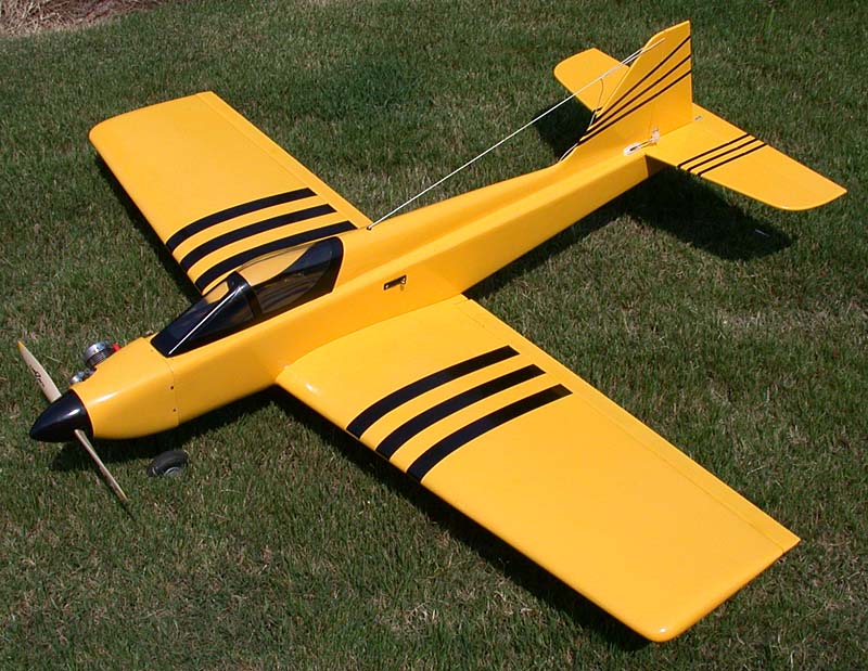

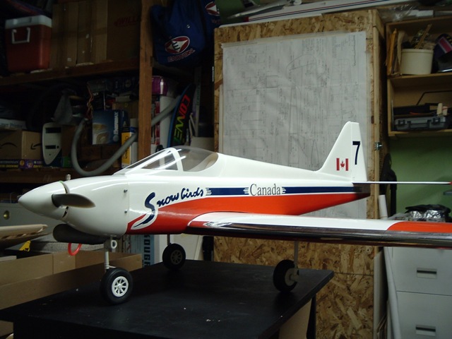

Here's how I covered mine. YS .45 with a pipe under the belly. (Not yet installed when this photo was taken.) The pipe really makes the engine come alive. Dry weight 5 pounds 7 ounces with the pipe, Robart fancy gear, and an extra nosewheel servo. Essentially unlimited vertical.
As has been said many times, you will love your Kougar. Good luck with it.

Very Nice Wayne...
Wish there was room for retracts on this plane and keep the nose gear.. it would be sweet..
Jeff

Nice snow-birds covering job, looks real good.
I too wish there was more room for retracts.
