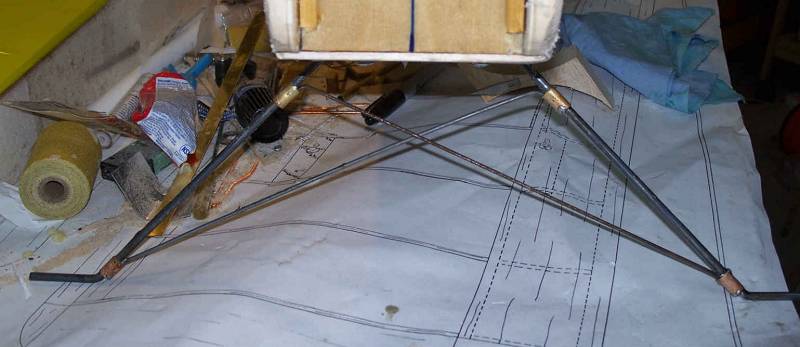

I also had to brace the landing gear from spreading... this was done with 1/16 stainless cable and cable locks. To install this, I used stiff center spring enclosed by heat shrink tubing. The wire provides a spreader at 3 inches of height above ground. I've DuBro air tires and an Ohio specialties tail wheel bracket. A quality tail wheel bracket will go a long way towards exceptional ground handling. A bracket that allows the wheel to tilt even slightly will degrade the exceptional ground handling this bird is capable of.

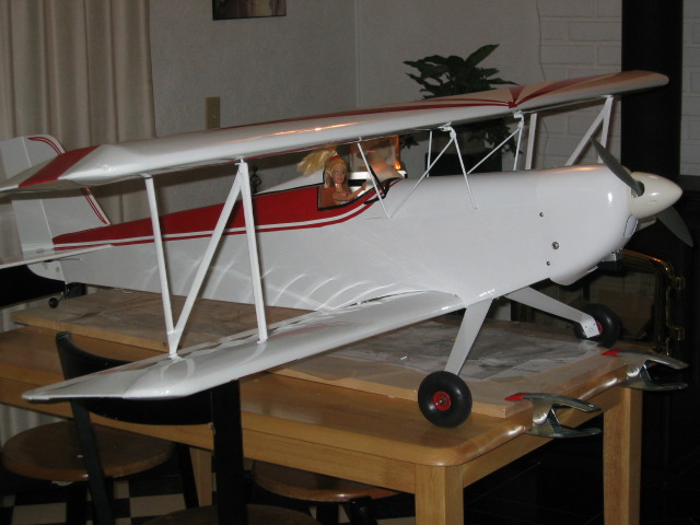

Here's a photo of Phaeton with Sig 120 landing gear, when mounted directly onto the mounting block out of the kit. The drawback is the aluminum is wide and it at angle to the air when it's flying. I don't know the degree of incidence. I think this is causing the down trim, I had to provide to achieve level flight. I know the engine is mounted with the exact amount of incidence as shown in the plans, along with the tail section. Bottom wing is at zero incident and top wing is +1 incidence.

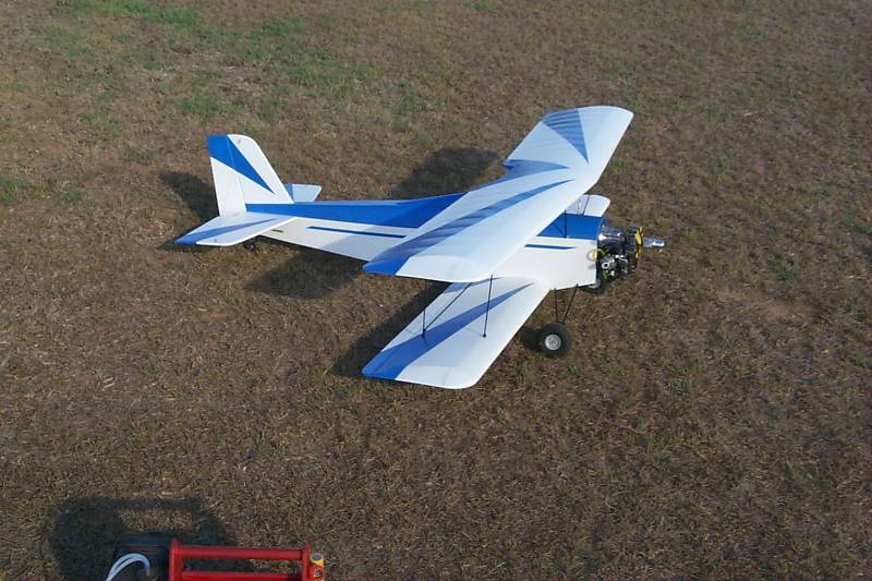

I don't think its yur landing gear If you check the begining post some one else had the same problem. still trying to figure out how to post pictures. should be working on air plane.
Old 11-21-2007 | 12:06 PM
  #31
Joined: Sep 2006
Posts: 2,403
From: White Oak, TX
Default RE: balsa usa phaeton 90
I agree.. down trim was needed for standard gear as well.

with weather and thanksgiving (a new prioraty is inslation in the shop) the top wing is almost covered. I put a picture of what i did with the landing gear

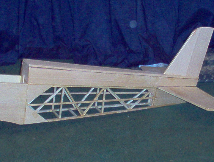

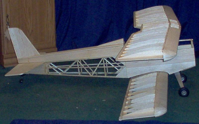

I have one of these. My dog was kind enough to break the horz. stab. at the fuse.I decided today to get it out and bet back to work on it. When she broke it it was not finished yet. When I was working on it about two years ago I had a Saito 100 to go in it. It is gone now and I think I want to go with a G20EI. Ive just read this whole post and am excited about getting back to it. Hey What wind got any pictures?

Here is a picture or two.

Old 01-17-2008 | 12:44 AM
  #48
MJM
Joined: Dec 2004
Posts: 21
From: Port Orchard, WA
BG Fireman,
It's looking really nice in the bare bones. Looks like a little bit of sanding and your ready for some covering! I flew my plane last Sunday. It's a lot of fun to fly! Landings are really easy with it as well.
MJM
