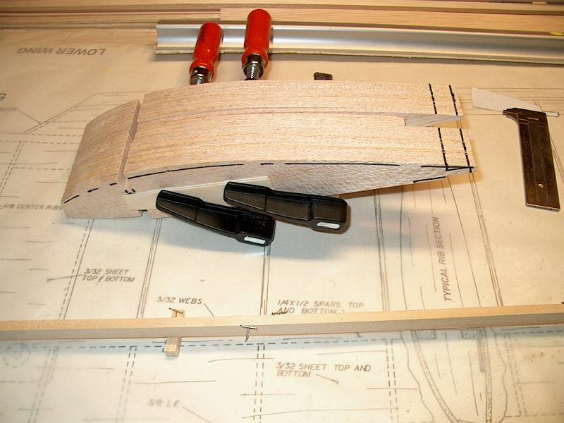

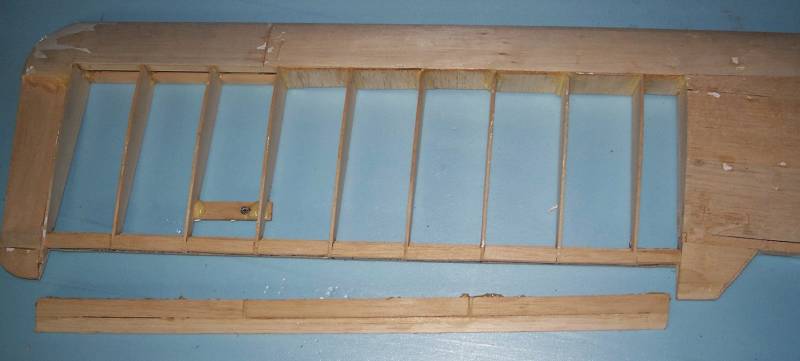

I added ailerons to the uppers this way
At the trailing edge I sliced the lower ribs to allow a piece of flat stock underneath. I sliced in the upper trailing edge for a length of triangular stock (normally used for the T.E. for a flat-bottomed wing). I shortened the ribs just enough that they butted up nicely to a pre-formed solid aileron stock. The uppers are slaved to the lowers with trailing edge rods so only the lower wing has aileron servos, but a beefy one (69 oz in) on either side. I also thined the entire airfoil of the upper wing based on talking to a BUSA90 pilot who did it (following the attached article he passed along to me).

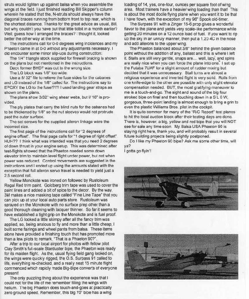

email me your address I'll try to put it on a cd

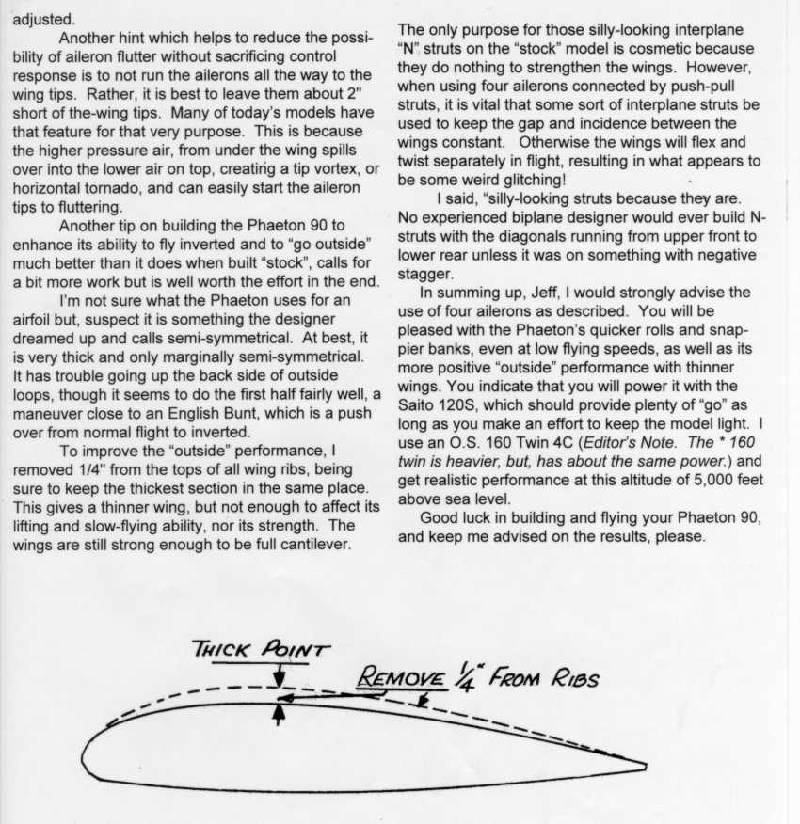

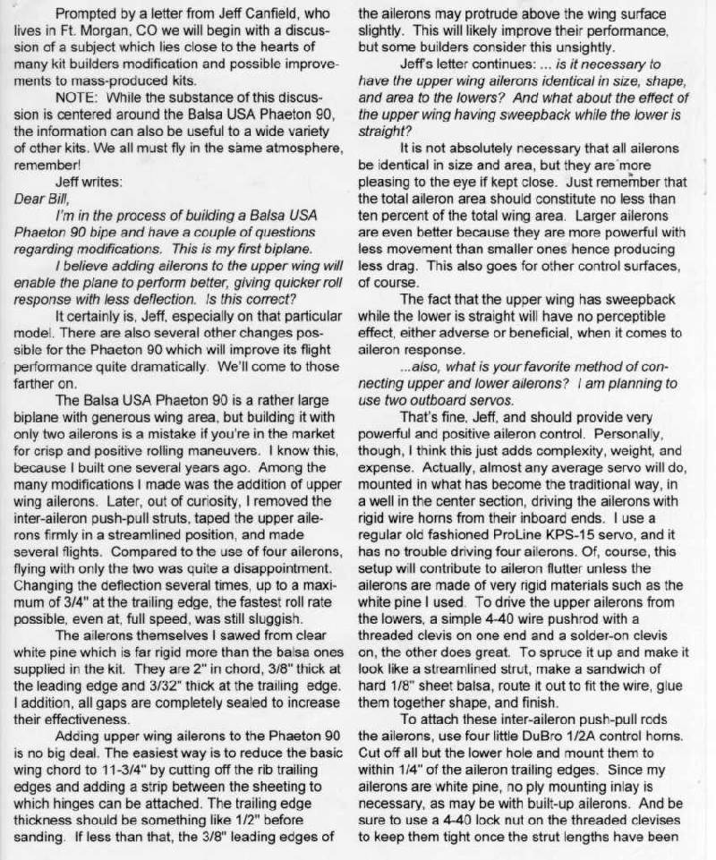

Thanks so much Charlie,
The article explained what I had been thinking of doing and now I feel confident that it is really the way to go. I will make copies (ply) or more properly, templates of the lower ribs and match the larger uppers with the lower ribs, easy. I like to scratch build so it's the same thing as cutting a new rib but I already have the balsa. This plane is very much like a Lazy Ace I had and foolishly let some one fly once...............
I have flown a stock 90 and they are almost the same as the Lazy Ace, sluggish, and prone to one speed no matter the power but a really nice plane overall, especially on ski's. I do plan on a little bashing to possibly include a round cowel and different tail profile that is less square looking? I am using a TT 91 FS and will mount to balance w/o extra nose weight, a problem with these short nosed planes, at least from my experiance. Overall weight will be watched as closley as possible.
Thanks again, Ask and you shall receive!!!!!!!!!

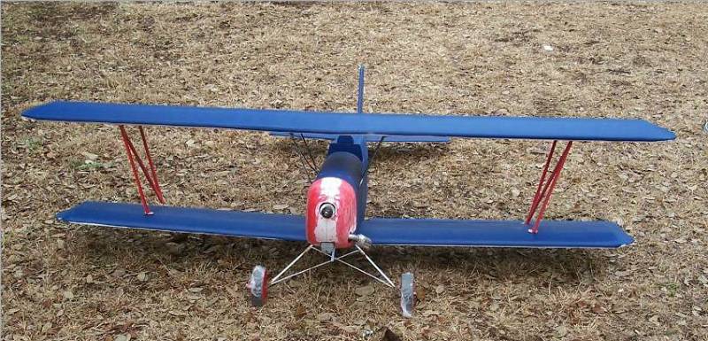

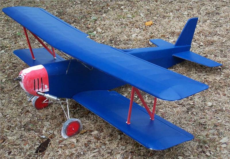

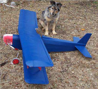

[img][/img]forget it glad I could help. mine is finaly ready for paint. The dog can't understand what I see in it

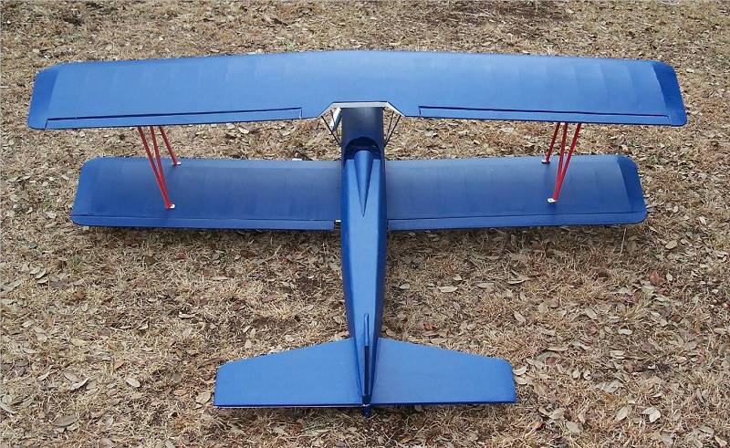

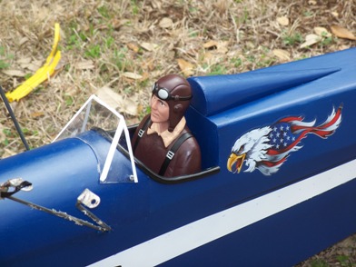

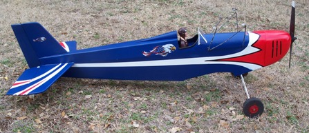

Fuse nearly done just got to hide the wires .found 1/5 ww1 pilot on tower. Got one tank through the engine top wing base white is down bottom wing is taped for paint.

That is one nice looking fuselage! Nice job!!

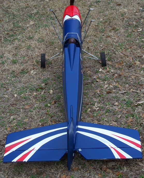

[8D]For the landing gear, one option that I'm considering is soldering an inverted v shaped (^) piano wire brace
between the two main gears. This would give the main gear a little more rigidity and also some play.
What do you mean by "thinning the top wing down" ??
Old 02-29-2008 | 12:33 PM
  #72
whatwind's Avatar
Joined: Nov 2007
Posts: 158
From: Leander, TX
Default RE: balsa usa phaeton 90
thats the way my birdi big bee is done only with rubberbands to attached to the fuse at the top of the ^ to act as a spring. sorry it was Charlie P who posted the article. start at the top of this page and you will find it. no I did not do it to mine. AA5BY the blue and white one on page two looks like he added a leading set to the stock ones.
