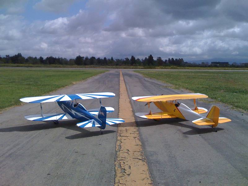

Did the maiden flight on the hog this morning and it all went pretty well. I needed a hair of aileron and a bunch of down elevator (i guess that's my fault for not thoroughly examining it before the flight). I am very pleased with the plane and am looking forward to feeling more comfortable with it!!
My buddy had his hog out there too...
#288
Joined: Mar 2006
Posts: 87
From: Peculiar, MO, AMERICAN SAMOA (USA)
Glad to hear all went well and you have the maiden out of the way. That said I will never maiden an airplane again without checking things over and over. I just lost a switchback that I left the ez connector loose on the elevator. I flew a complete circle before I lost elevator. I don't know why I just "snugged the screw" but I did. From now on I will leave things obviously loose, or lock them down with locktite. No inbetween. Congradulations on your maiden.

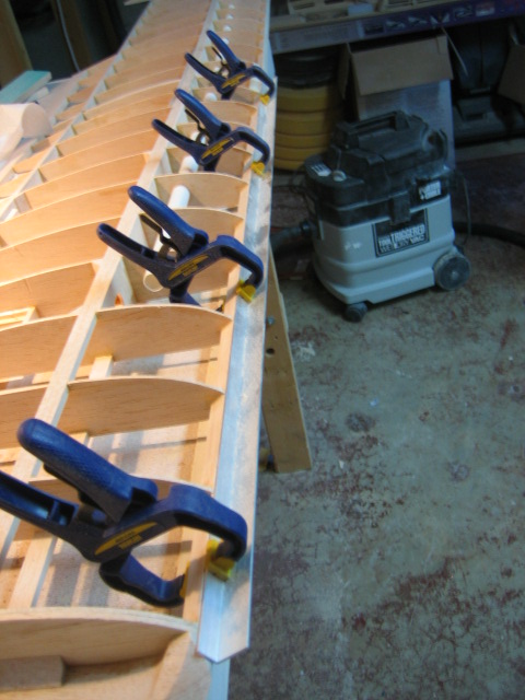

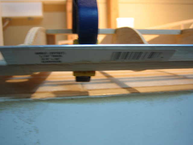

#299
Construction technique sidebar:
I was working on the wing to my Kadet Senior needing to true up the leading edge. I have some aluminum "L" stock sitting around - about 44" long. It was straight and had an easily clamped edge. See pics. After clamping it was a simple matter of running a sanding block down the front edge - badda boom badda bing - a very nice straight leading edge.
