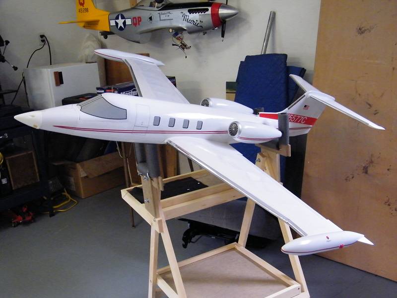

Rebuild commencing once again....
Ok here i am back again with commencing the rebuild of my GPlanes Learjet 40.
To get things started i wanted to re-assemble the model to get some encouragement into myself and power to do it again. I'm out of 1/4" square stocks so i have to wait till Monday b4 i can get those, so in between i went through my wood box and found enough 3/32" sheeting to do the fuselage with it and the sections of the wing. I haven't made any reinforcement pieces as yet but i will, so far fuselage is re-glued with CA and epoxy.

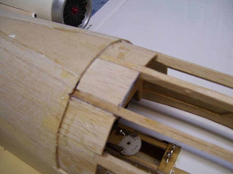

I found long 2" wide strip of 1/4" thick balsa in my scrap wood box, took it out and marked three 1/4" wide strips on it length wise, then i cut them out with my xacto knife and woula!!, i have my stringers!. Started to glue the stringers on the bulkheads full length wise first and then once glue had dried i cut them off and former behind cockpit hatch.
On one of the old stringers i had to be sanded 1/16" x 2"L deep as it was distorted there and then i added a piece from scrap 1/16" sheeting and sanded it lightly until all was flushed and even. I also had to make strengthener fillet at the center of the fuselage which also supports the top sheeting.
One side of the fuselage top sheeting is also added on top of the stringers n bulkheads, i used full length of 3/32" x 4"W sheet to do this. Since it had to wrap around the top of the fuselage curvature, i used hot water to help wood grain soften up, this helped great for sheeting to nicely curve around the fuselage. I used mix of medium CA and Aliphatic resin as source of glue to attach this sheeting.
Batteries of my camera died so i couldn't take any pics with sheeting on and pinned to the stringers n bulkheads.

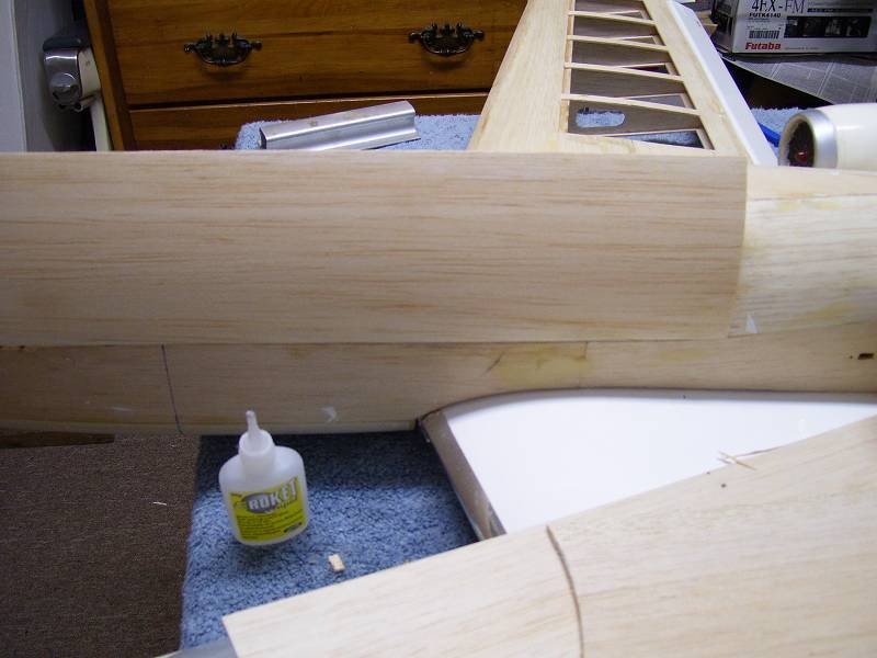

Right side sheeting is now glued on the fuselage.

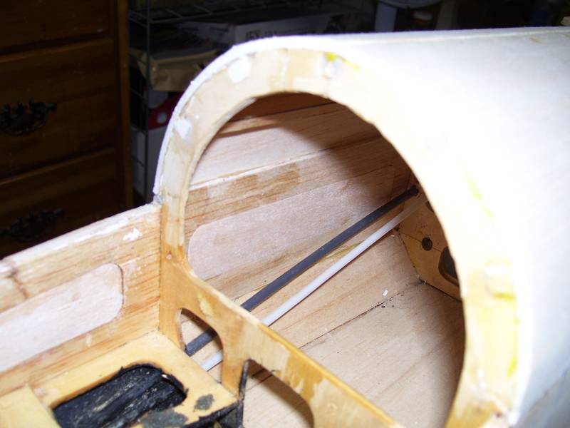

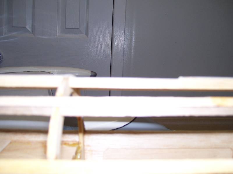

Hey Pat,
How did your top of fuse sheeting aligned against the top cockpit hatch?
I got a 3/32" step between the sheeting and the cockpit hatch, did you had this problem too or not.
I'm thinking to raise the back of the cockpit hatch to by adding filler strips under it so it would be perfectly level with the top sheeting.

From: Mississauga, ON, CANADA
Default RE: Learjet .40 Build
Fuselage sheeted from both sides.
Pictures of the sheeting step i mentioned in ^^post.

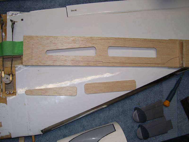

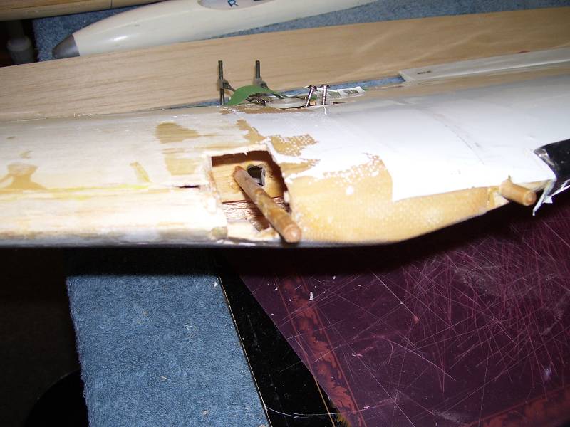

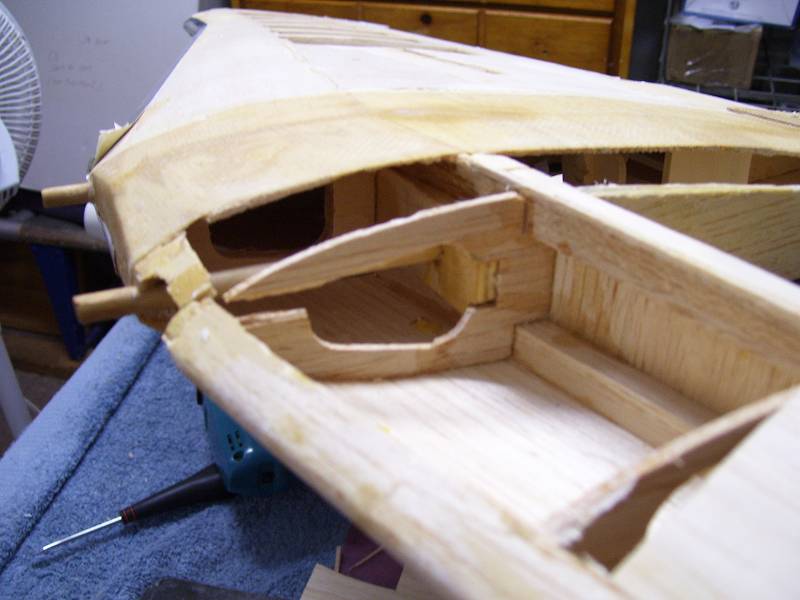

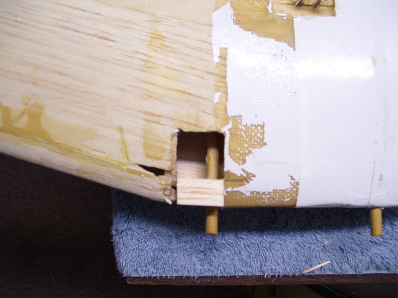

Did some more work on this model last night and still doing it now.
Looks like these Learjets really love me and all the hard work i have do on them. They like my sweat and blood for sure. 1st picture will illustrate what i mean.
Last night i made couple for front rib reinforcement pieces, i use actual newer ribs to trace out the profile on to the wood and then cut them out. I had to make them fit perfectly by sanding more on top and bottom as this wing's ribs have bit of different shape and size to original ones!. Then i mixed 30 min epoxy and glued then butt against the original ribs and pinned them to fully cure over night.
I looked through the other servos openings and it seems that there is more internal damage then i first anticipated, both sides shear webbing of the root rib is damaged as if wing mounting dowel pins were pushed back at the time of crash. Anyways no worries as i will make newer openings in the wing's skin sheeting to add newer webbing in those areas.
While i was test fitting newer rib pieces, initially it was tight fit, so i had to make small insertion hole from other side to put long screw driver in to help push out those pieces before they were sanded and glued on to the ribs.

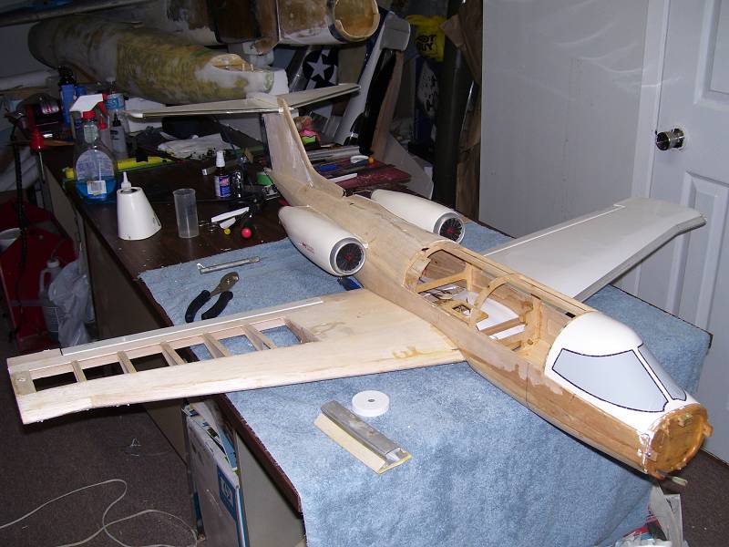

Did some more progress on the Lear, cleaned up the top edge of the ribs on the bottom of the wright wing, then had to cut a piece of sheeting to make it fit over the ribs. This took bit of extra care and angles and notch wasen't so easy to do so but it worked out good in the end.
Wing was mounted in the fuselage saddle also to make sure it fits properly, which it did and also added plastic belly pan also to do the proper alignment check. Looked pretty good fit.
Im planning take of the cap strips from the top of the ribs and add solid sheeting there on both top n bottom of the wing, this will make wing more rigid and will be easily glassed also. Same goes for fuselage too, once whole airframe is glassed it will become very strong structure.

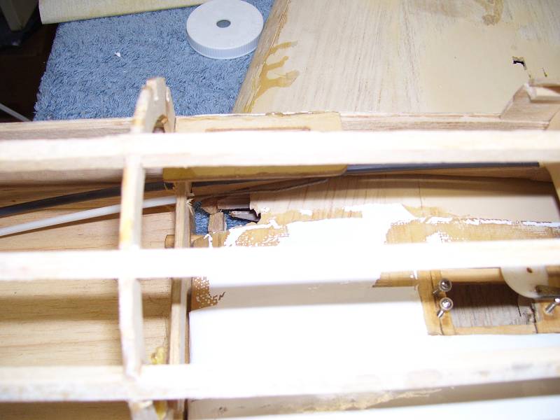

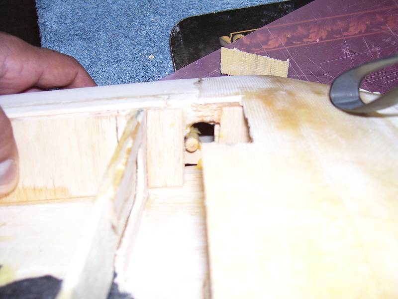

The impact was so high that 1/4" plywood dihedral brace also got damaged by the dowel wing mounting pins as seen in picture below. Pin is where it should be but area around is chewed out!, now this is goign to be another difficult task to make a hard wood piece that would fit in the that opening and around the dowel pin.
Almost same situation is on the front LE section where pin is mounted, you can 3/4 of all around pic structure is missing!. For this i used 1" x 1/2" x 1/2" hard balsa piece from scrap box. I had to clean the original area and square it out, then i cut the block to match the size and drilled out the block to wrap around the dowel pin. This actually worked out pretty good as you can see in the pictures. I will epoxy it in place and then sand it to right shape and contour of LE after i fix the dihedral brace first.
A section of glassed sheeting had to me cut out so i could use knife and file to square out the opening in the brace. I find working with square shapes is a lot easier the odd ball shapes.
