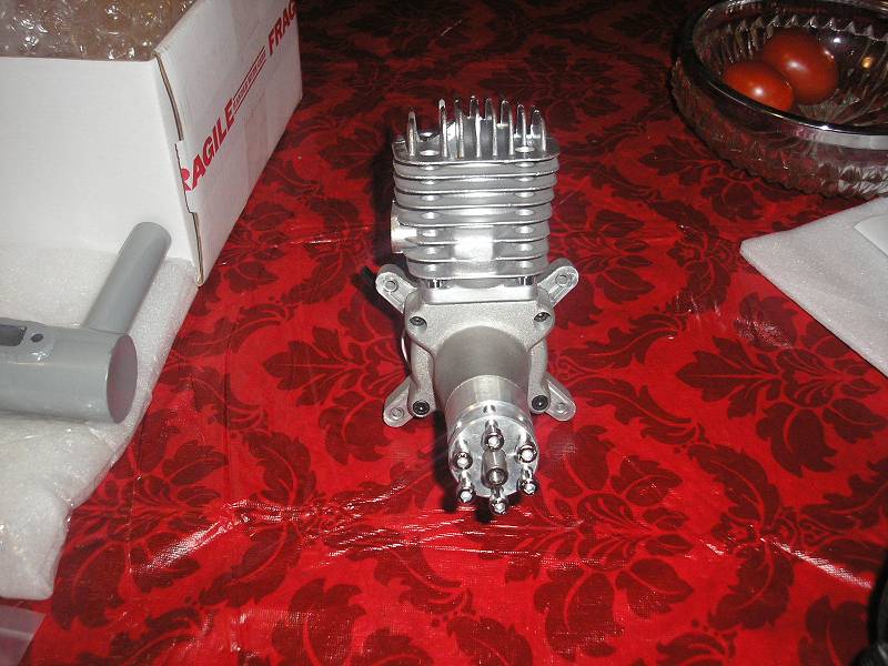

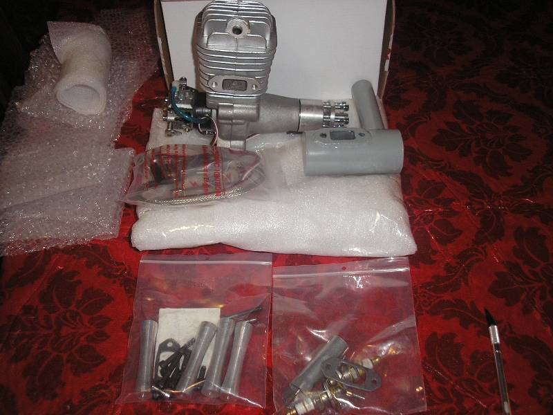

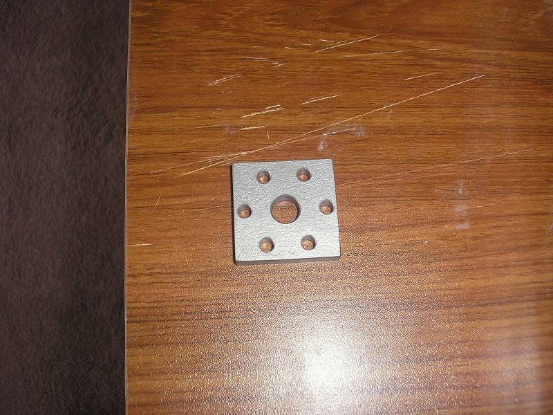

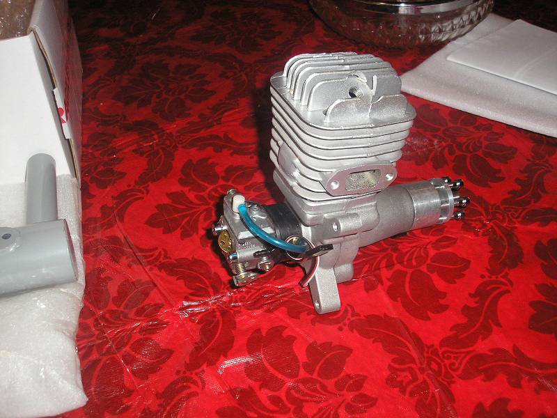

The RSC RV-50 has arrived. It is a nice package. Packed well. Included in the box is:
1. Engine
2. Muffler with 3 graphite impregnated gasket
3. Aluminum Standoffs (4) with 8 case hardened bolts
4. Electronic ignition Module
5. Spark plug with spacer (2)
6. Spark plug wrench
I fabricated a drill guide to drill the props. This engine has a 10mm shaft and 6 5mm bolts to retain the prop so the props will have to be drilled. I also installed 5mm-0.8 keenserts in both ends of all the aluminum standoffs so there will be steel on steel threads. The electronic ignition will operate on 4.8 - 6.0 vdc so unless a regulator or a diode is installed LiPo or A123 batteries can't be used. The muffler is really big and bulky I may look for a different solution but I have to wait until I see what kind of room I have on the AMR Trainer 50. The last two pics are the drill guide I made for the prop and the Keenserts I installed in the aluminum stand offs.

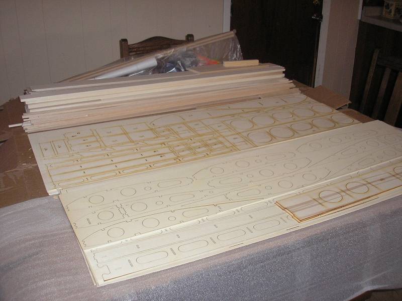

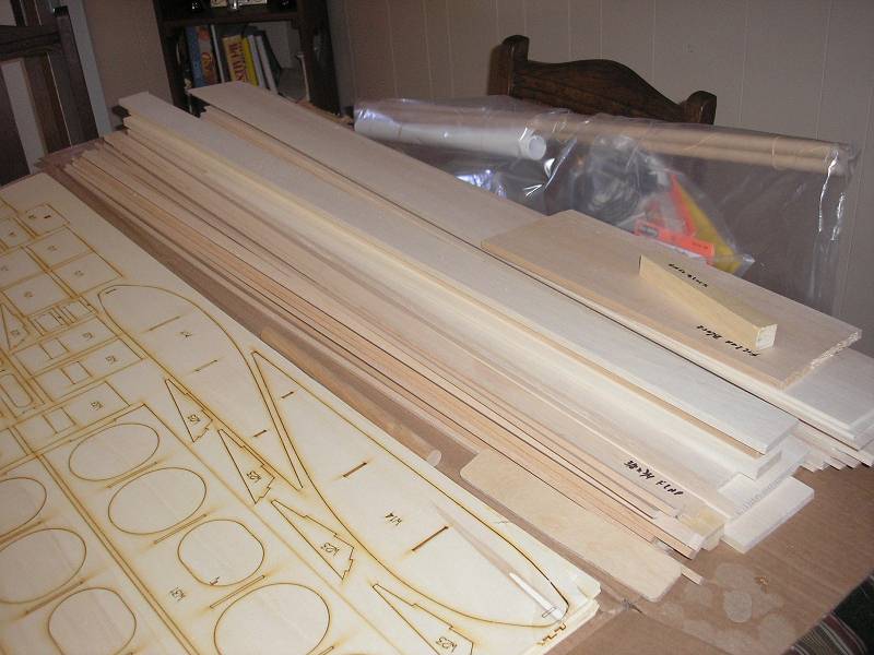

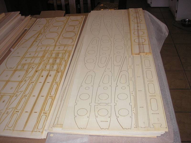

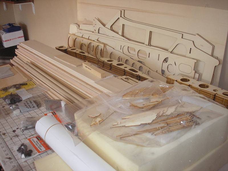

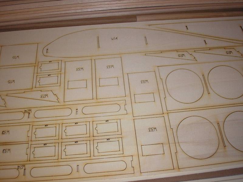

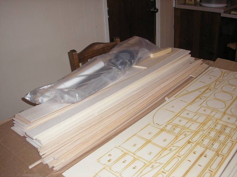

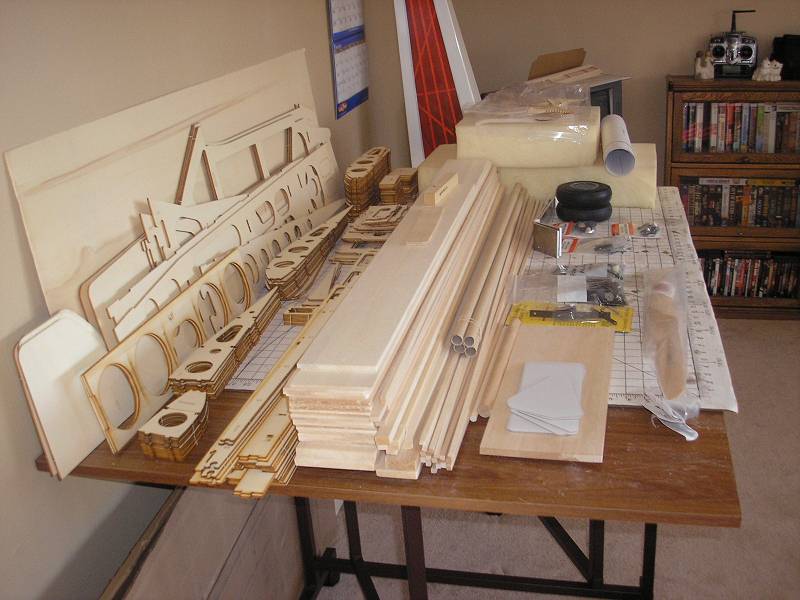

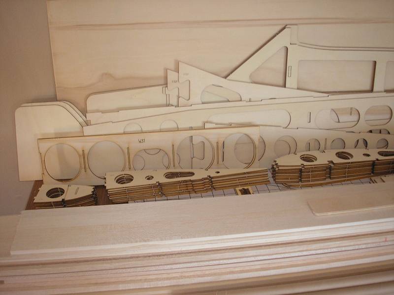

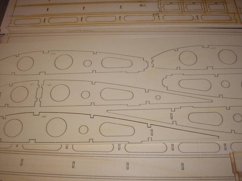

I received the kit today and there was no shipping damage. I spent about 2 hours removing the parts from the sheets of lite ply and sorting them. The laser cutting is awesome. The parts almost fell out and the cuts were very clean. Game on!!

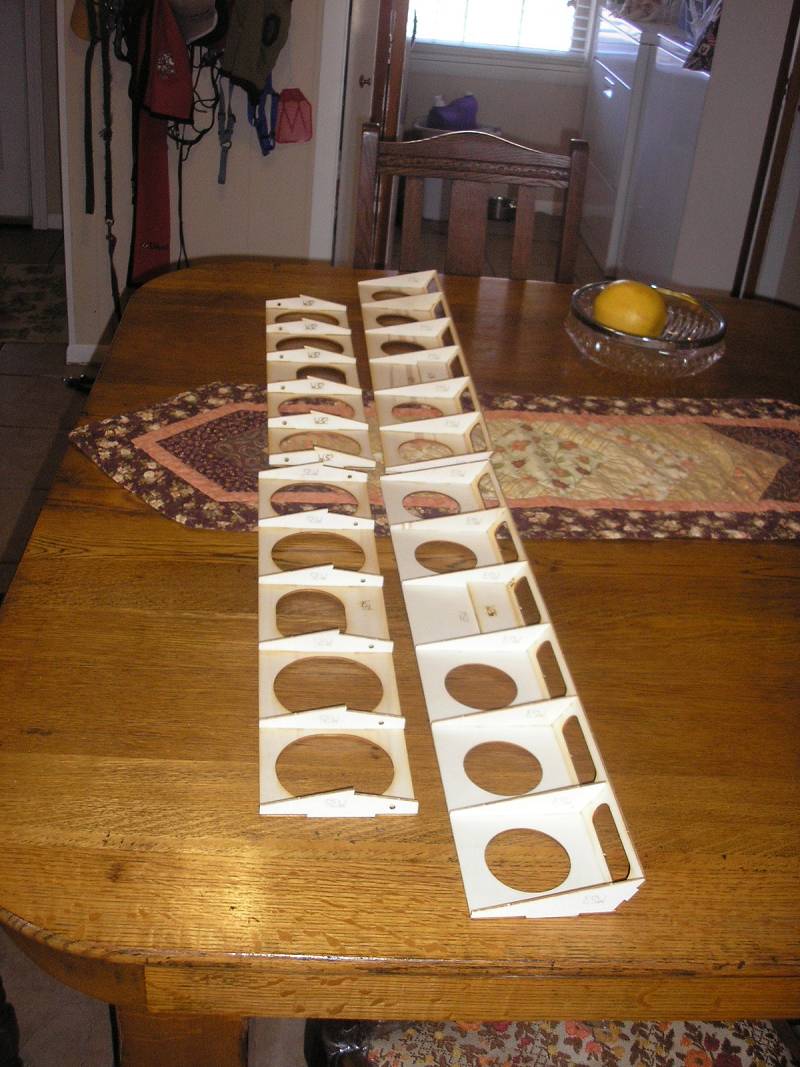

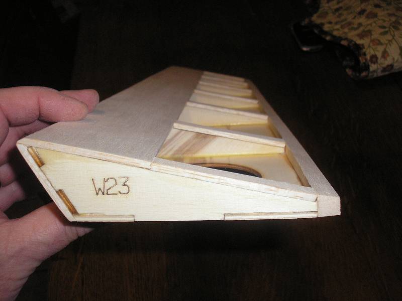

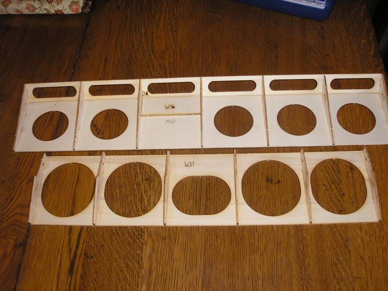

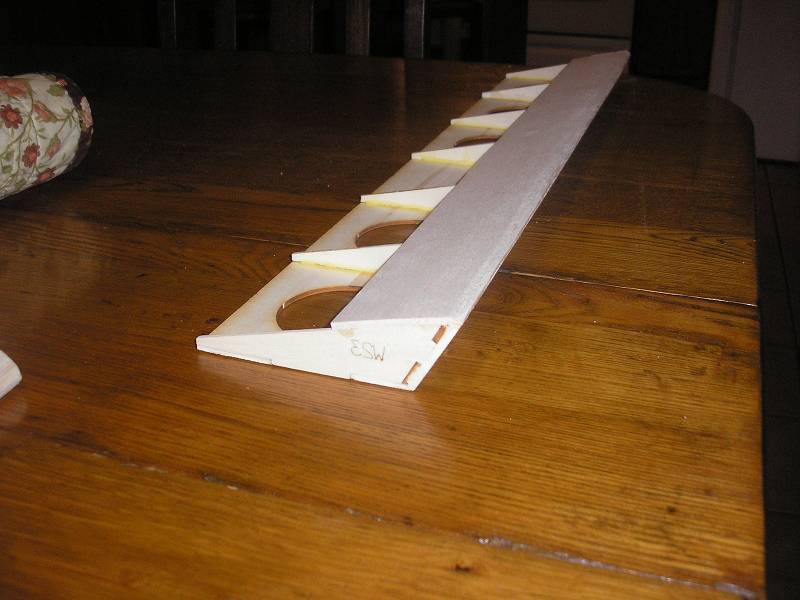

I have finished reviewing the manual and parts and have started basic assembly. The only issue I have had so far is that the interlocking pieces are really tight. When I tried to fit them together like a interlocking puzzle piece, the lamination of the plywood started separating. So to resolve this I placed a 3/4 inch plywood block over the joint and lightly tapped the block and the pieces went right together without damage.
Edit: Ok I made my first rookie mistake. It will not be my last. I have removed the 1/4X1/4 Balsa from one of the pieces and moved it to the other side. I will add the new pic so everyone can see the wrong and right way to do it.

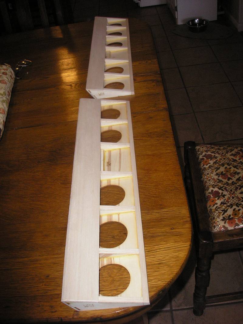

Hello ROn,
I am glad you start the building.
Looking at the pictures, you are building two wing of the same side. You have to glue the 1/41/4 stick on the other side to make the other wing. OR maybe it is becauce you are building the two sets of wings that you got in your kit.
Whe the parts are tight, you can sand the tab a little bit to ease installation.
Regards,
Vincent

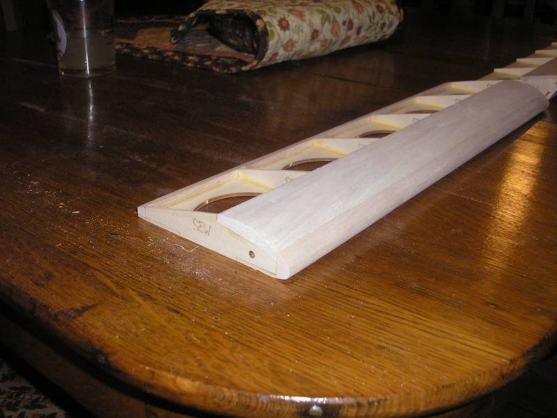

I have the flaps completed and the ailerons complete except for the TE and the rib caps.

It took me 2 days to make the flaps and ailerons. I suspect they are harder to make than the wings. There was much work involved. Tomorrow I will add the trailing edge and wing caps to the ailerons and they will be complete. When I posted the pics I saw the saw dust on the table and went right over and cleaned it off. I might be dumb but I'm not stupid.

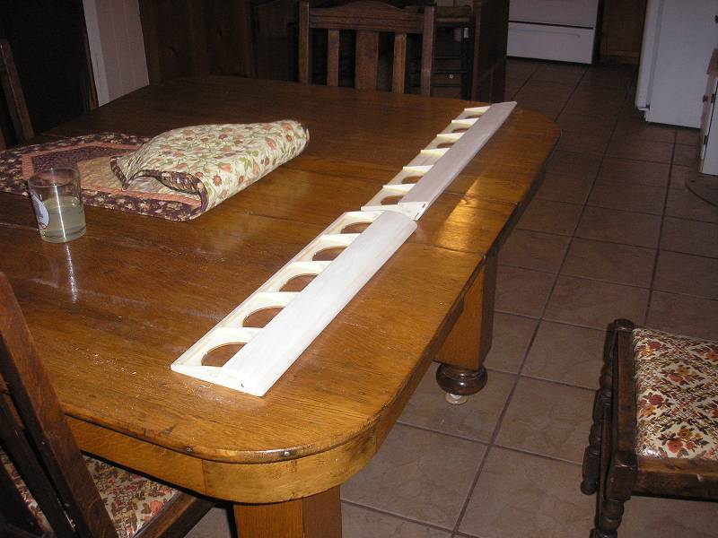

The ailerons are complete. I added the trailing edge piece and the rib caps. They look really good. I compared them to the ailerons on my Rascal 110 and they are the same length but twice as deep and 3 times as thick at the root. These control surfaces are big.
