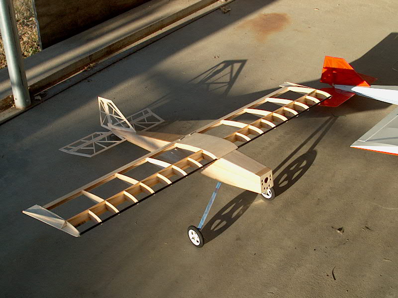

I have built two MUS copies that are about that size, for some reason I can't send pix from work so I'll send them later this evening. The White an Red model has an Eflite 450 on it and the framed one has an EFlite 480. The framed one has a much thinner nose that fits the motor better than my first R&W Stik. Still have'em in my hangar...

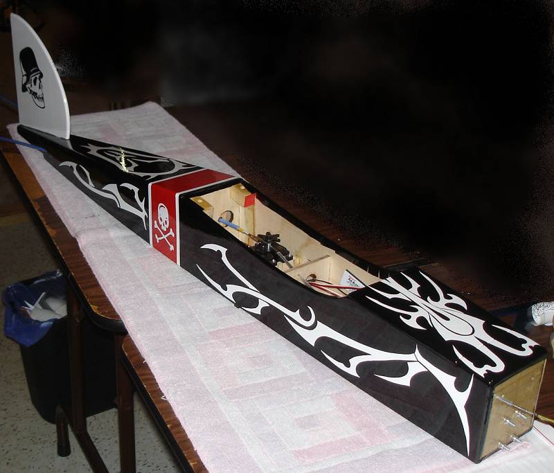

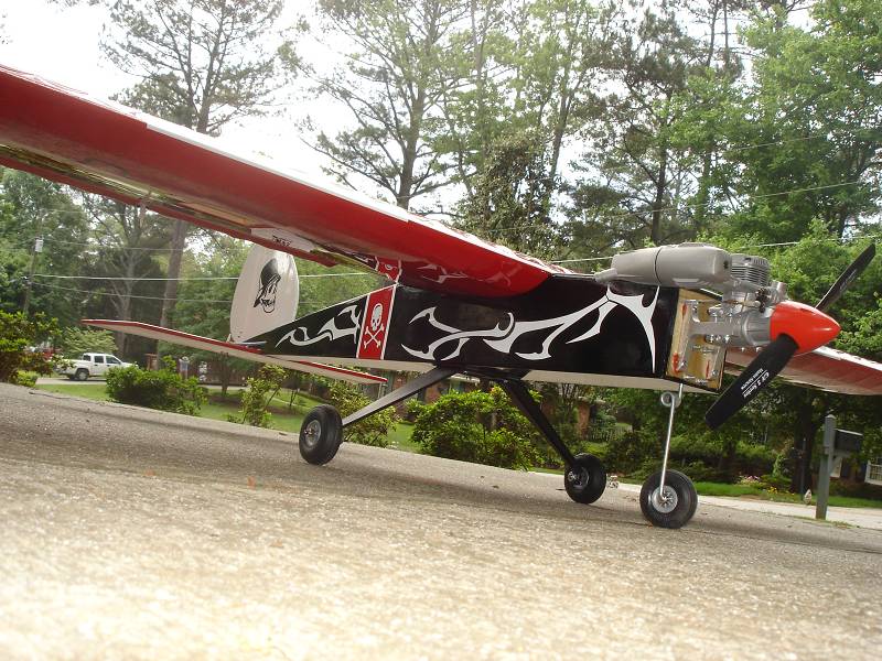

I finished the fuselage markings. Now, back to the bits that make it go.

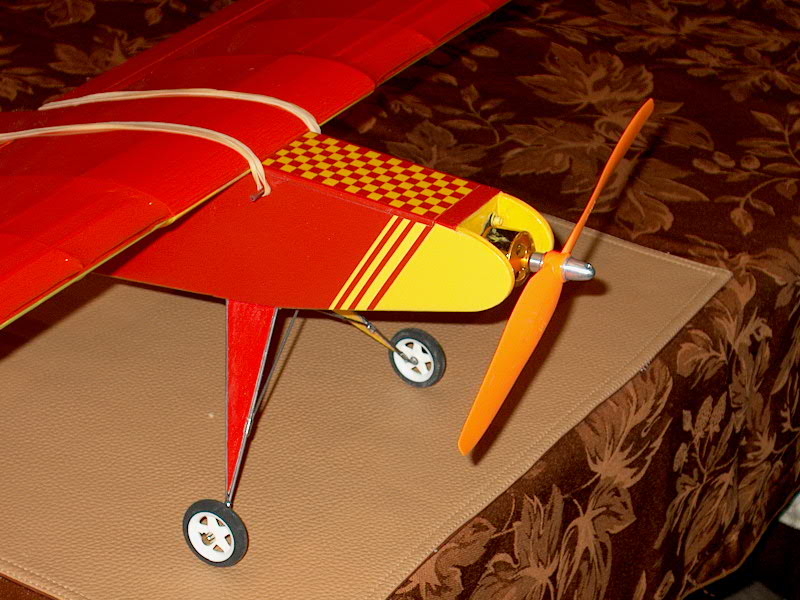

By MUS, you mean the Mountain Models version - or just similar ones?
Do they fly as well as the larger ones?

ORIGINAL: Nergall

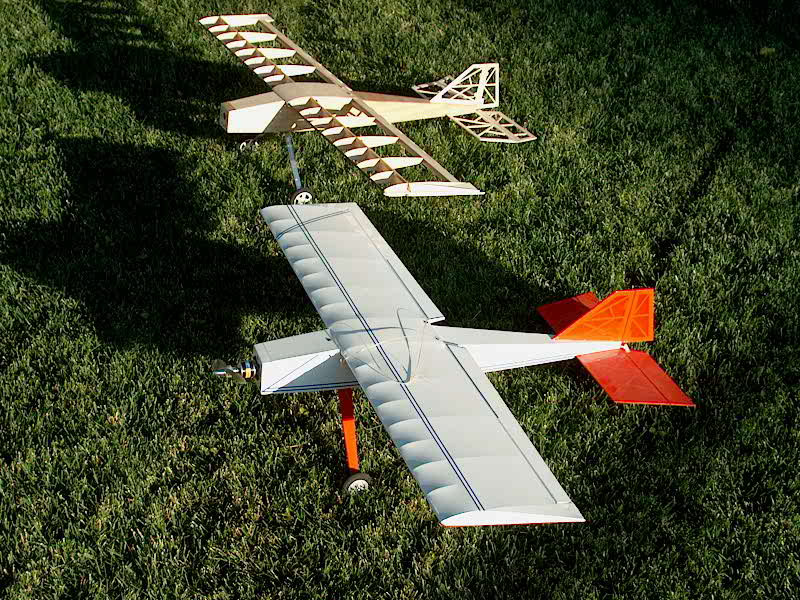

MUS = Mini Ultra Stiks that elfite makes and sells, It seems like all the stiks I have built have much the same behavior, they fly great.
I have 2 MUS scratch built copies, 1 Midwest Little Stik pictured above, 1 Foam Simple Stik, and 2 Small Sticks I like them all.

OK, sorry to be slow on the updates, but I did get a little more work done over the weekend.
1. Finally epoxied the stab onto the fuselage! So, while it is missing control surfaces, I can now bolt on the wing and look at something airplane-ish. Unfortunately, it's too big for me to get a good picture of in the workshop. I need to wait for a sunny day to go outside.
2. I also broke out the RTV and locktite to do final install on the landing gear and engine. I like to put a spot of RTV around the hole, and locktite on each bolt.
3. Installed the switch harness and an Air Alert module. Last stick went into the woods. This stick will make noise if it crashes, vastly improving my ability to find it in the woods.
4. Installed a new propeller.
5. And, tonight I started covering all those last little bits: the ailerons and the aileron servo hatch covers. Those scallops are very tedious, but I like their look. However, my practice, as you can see, is to put a small piece of covering into each scallop before applying the big pieces of covering. 20 scallops equals 20 little pieces of monokote and about 200 small cuts to allow the monokote to spread around the inside curves. Tedious, but I'm done!

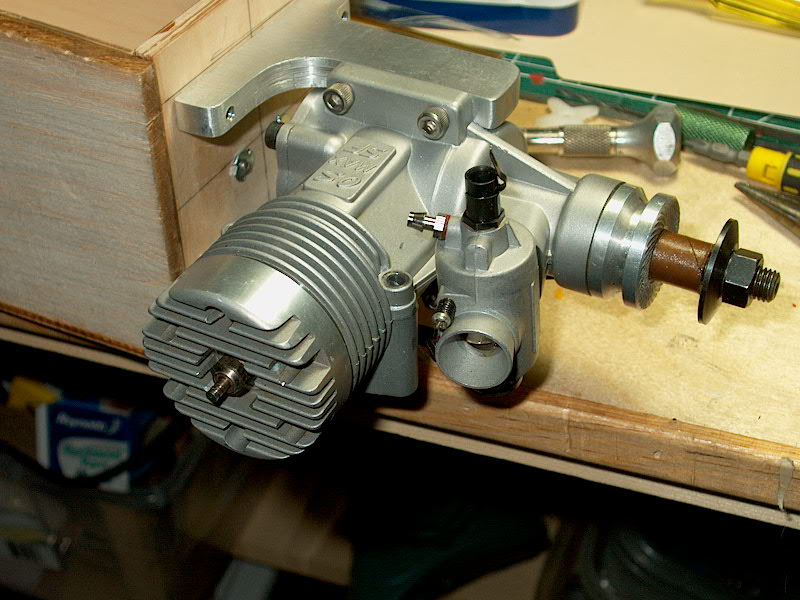

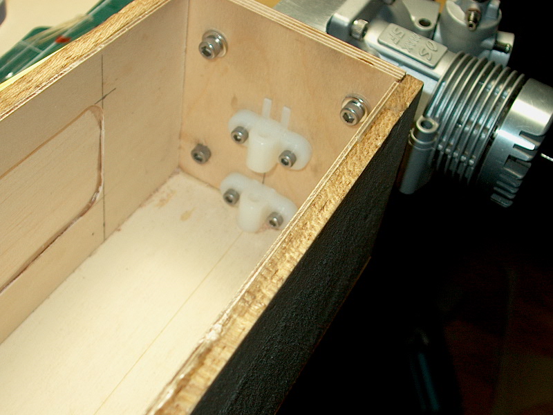

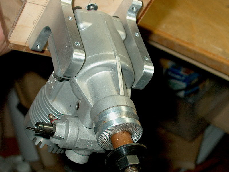

Well I thought I might add some of my Big Stik Shots as well. I was not satisfied with the motor mounts that my LHS had so I whipped these engine mounts up out of aluminum. The problem I had was that I felt the base of the commercial (Dave Brown) mount was very small for such a large heavy motor. After much deliberation I have also decided to make it a tail dragger rather than tricycle gear. Much simpler for me to rig.

Thanks for the picts. I should have done the side mounted engine like you, but I couldn't figure out how to make it fit around the nose wheel mount.
Your solution looks like it took some careful planning! And, now you're switching back to tail dragger anyway? Well, looks like the rest of your hangar is tail draggers, so that's probably for the best.
You'll have to show me how to whip up solid block aluminum engine mounts one day. About the only part I know how to do is tapping the bolt holes.

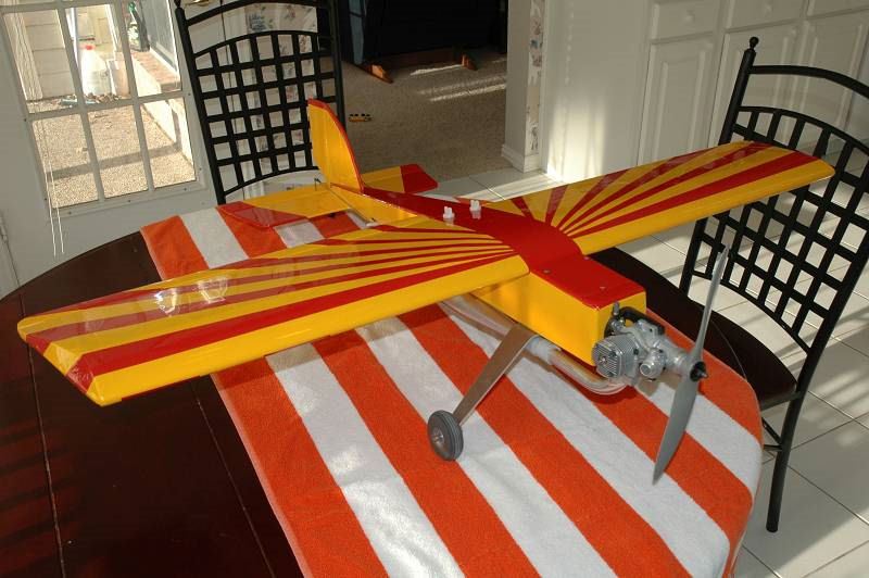

I recently built a Midwest Little Stick kit from a short kit I got from [link=http://lazer-works.com]Lazer Works[/link]. Very nice short kit. I'm currently flying a trainer to get reaclimated after an extended absense from the hobby. But I kinda put the donkey before the cart on this one and decided to build the little stick just to see if I was interested. I haven’t flown it yet but it is built and ready to fly. It has a Super Tigre G-51 with a header and pipe on it. Talk about overkill! I had one just like it back in the early 80s with an OS 40FX and pipe. This G-51 is turning an APC 12.25x3.75 right at 14,000. Can’t wait to fly it! In the attached image, it has an OS 46AX on it. The rudder and elevator servos (Hitech Mighty Mini HS-225MG) and battery are in the back. There are two aileron servos (HS-225MG) and a micro (HS-81) on the throttle. Other changes I made were cutting about 3/4" off the nose, adding 2" to the wing and making the rudder bigger. All up weight is 4lb 2oz.

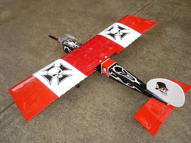

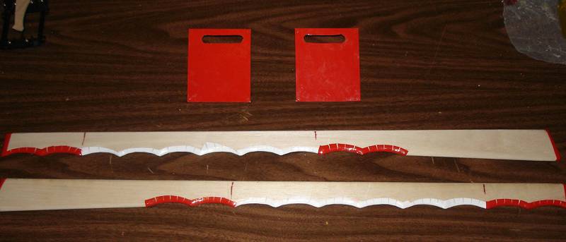

Finally finished those blasted scalloped ailerons. Had some significant free time today, and I got all the control horns and hinges done.
I got 17 meg of pictures of what looks like a finished plane now!
However, I still have the following details to attend to:
1. Fuel tank - needs a little foam to hold it in place and I need to cut, run, and seal the fuel lines.
2. Dorsal fin - install and paint?
3. Aileron control rods.

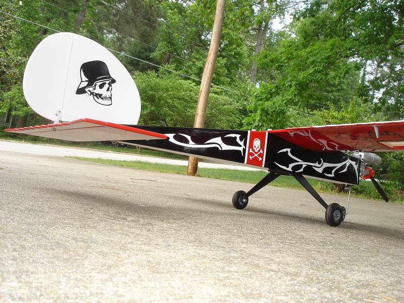

I usually scale them down, but since these are kinda final...
