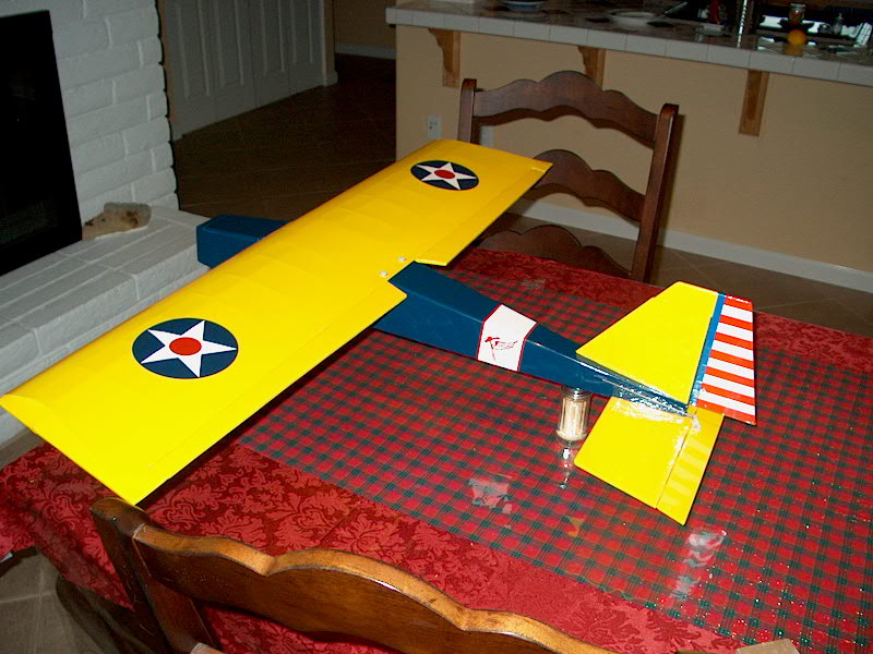

Progress report:
Wing, stab, elevator, fin, and rudder all have their initial covering.
Now to see if I carry out the plan on the fuselage!

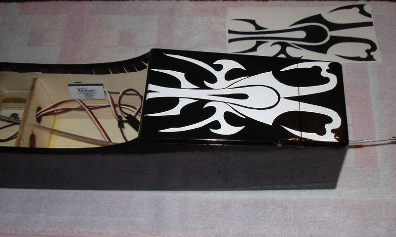

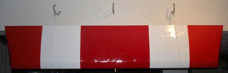

I started on the white markings last night, and it looks like this is going to work great!

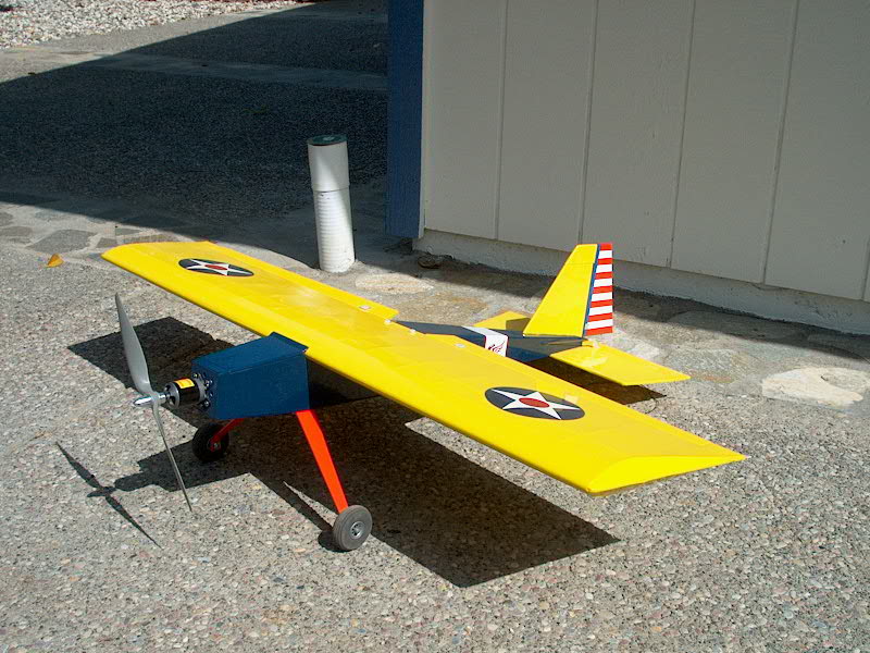

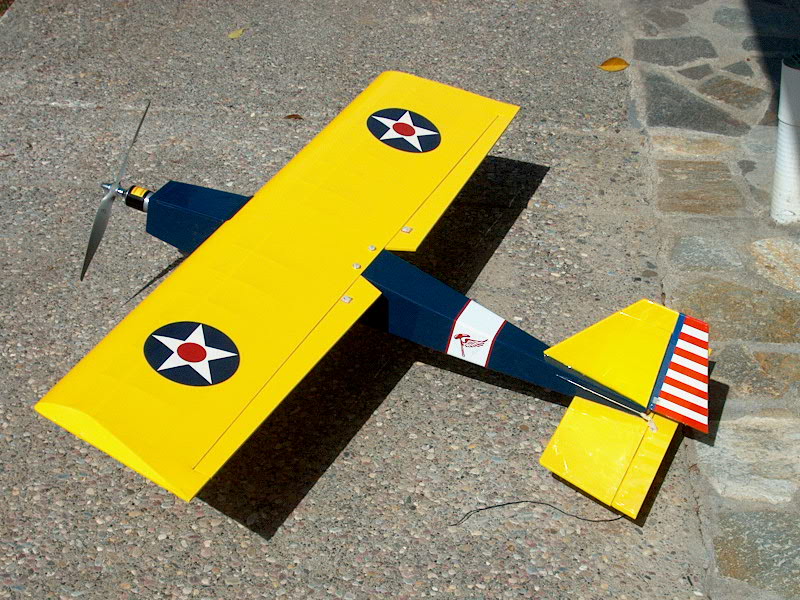

I just finished the Midwest Little Stick that Lazerworks cut. It flies great, I went electric with that one Eflight Power 25, swinging a 12-8 prop. Uses a 3500 mah 3 cell. I'll take some photos of it with all it's gear on this one is just after putting on the covering.

Wish I could laser cut these decals like the ones in this post!
http://www.rcuniverse.com/forum/m_8717525/tm.htm
However, I'm making slow progress with my scissors. As he commented in the linked post, the cut out film is very easy to apply. I just hope it stands up to wear as well.
I'd be further along, but I spent most of my free time this weekend at the flying field!

Lazerworks has the DLS plans and if I remember it costs about 10 dollars extra. Here are a couple of pix of the finished Das Little Stick.
BTW > > Hello Dan,
> > Yes, Midwest Little Stick is still available. It is
> listed on our website
> at $39.29.
> > And if you need a set of plans it will be an
> additional $9.00.
This is the word from Lazerworks RE the kit and plans
ID:	1187939   Click image for larger version

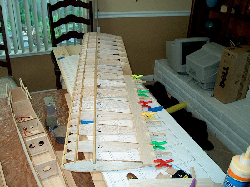

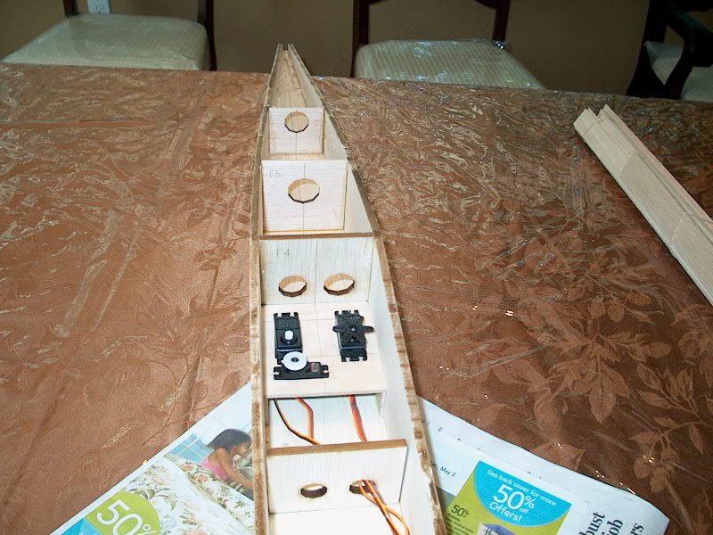

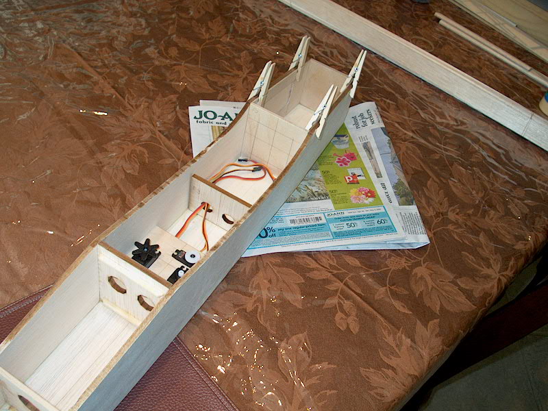

Here are some pixs of my Lazerworks Jensen Stik. As I said before I bought this short kit 3 years ago and after building about 15 other planes I decided I would get this thing built. Plan on using an OS 61SF which I recently purchased, it was NIB for 80 bucks. I used spruce for the spars and leading edge. The center section of the T-edge is 1/8 ply. I have yet to put the ply sheer webs in and the wing dowels. The fuse uses standard size servos for rudder and tail and an 82 MG hitec for throttle. Plan on putting servos in the wings like yours in hatches.
ID:	1187950   Click image for larger version
ID:	1187951   Click image for larger version
ID:	1187952   Click image for larger version

ORIGINAL: CptDan
Nergall,
Do you plan on the single dowel in the center, or two dowels?
(Lol, first time I read that I thought you planned to put the OS 61 in the DLS!)
2 Dowels is how I usually make my stiks. My F2 bulkhead on the Jensen stik I made from 3/16 Plywood rather than the soft 1/4 balsa the kit came with. Also made some 1/16 ply nose reinforcements on the vertical walls.
Old 04-28-2009 | 09:50 AM
  #98
Joined: Jun 2008
Posts: 428
From: , GA
Default RE: Ugly Stick Build

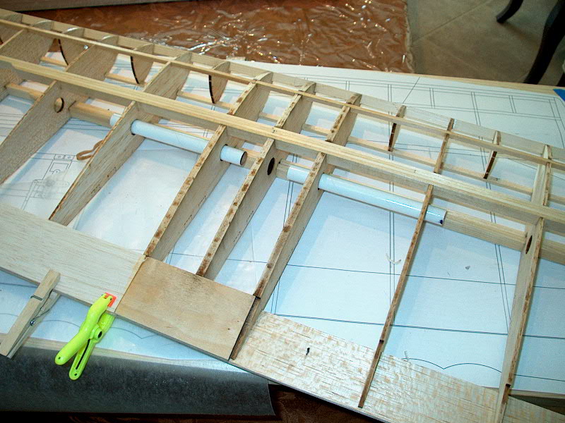

Then I guess you add some wood to the center of the wing to support them?
When you get that far along, I'd love to see how. I know other planes have a chunk of solid balsa there, but on those models I've done, there is wing sheeting to help hold it in place.
Though, while I had my doubts, the single dowel does seem VERY strong.

What I plan to do is Drill the 1/8 ply Sheer for the dowels and then add some 1/8 ply to the front of the front spar (turbulator). The dowels go just below the leading edge and are epoxied to both plates. The center section will be sheeted also. I generally use carbon Fiber for the dowels. I take a pic of it when I get that far. As I look back at the wing design I think the wing would be a lot torsionally stronger if built via a "D" tube construction.
