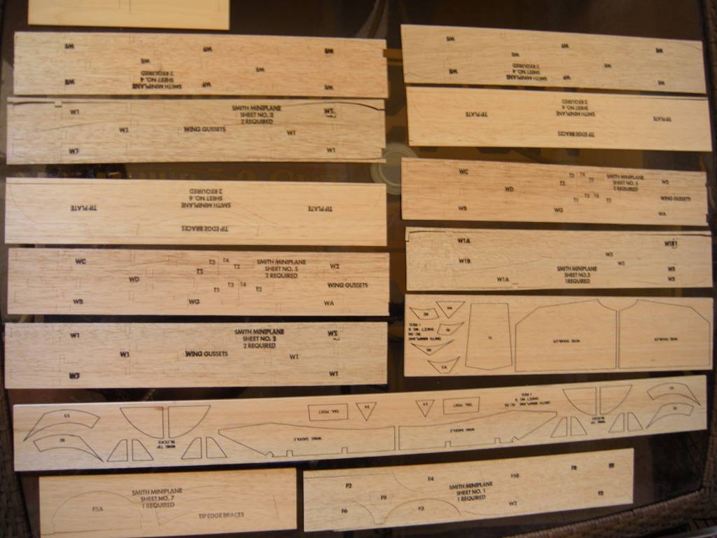

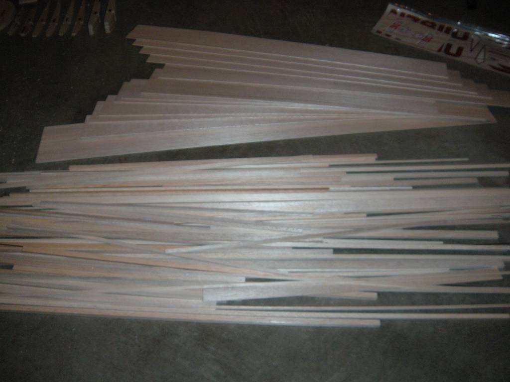

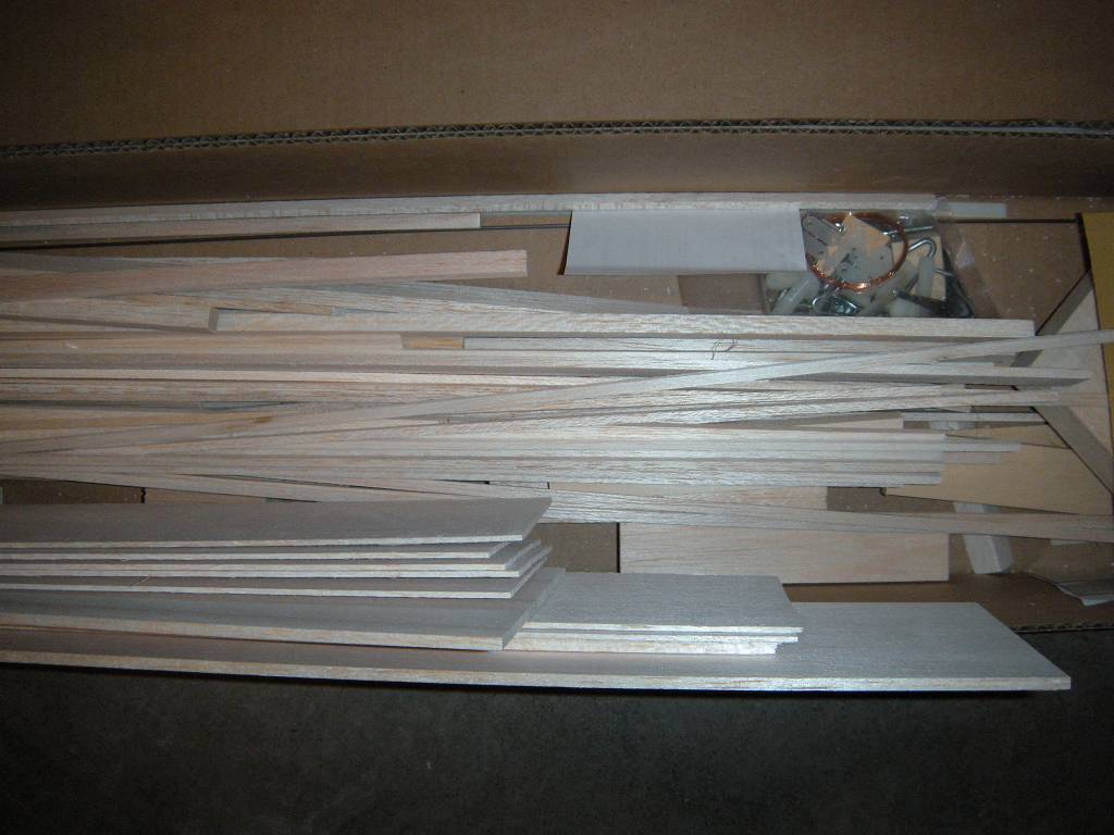

<span style="font-family: Comic Sans MS"><span style="font-size: x-small">here are some more. think i got the computer fooled!!!
i guess they call it a "stick" plane for a reason. not only do i get to cut out all the pieces from the sheets, but i guess Sig thought it necessary to stamp the pieces with ink instead of using a punch stamp to i.d. the parts. YEAH!!! more sanding...</span></span>

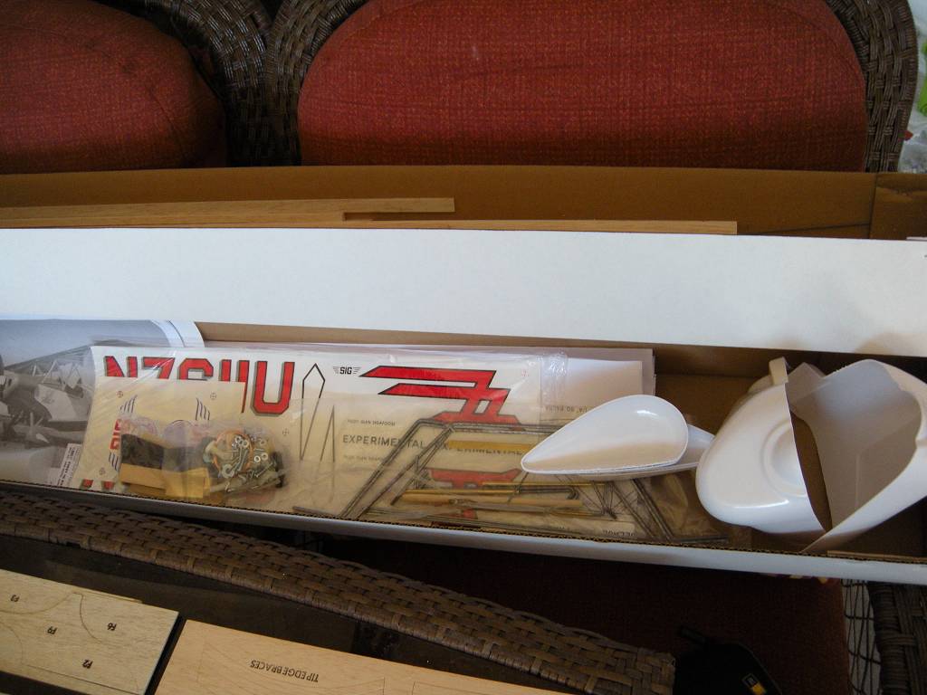

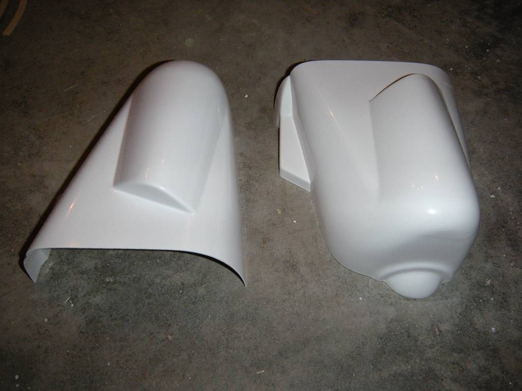

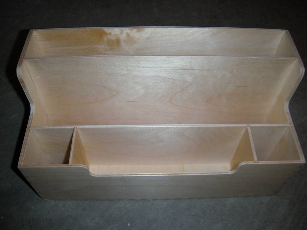

<span style="font-family: Comic Sans MS"><span style="font-size: x-small">a couple more for the day.
1. what doesn't belong in the house???
2. saving grace without a scroll saw (coming soon to a garage near you)
3. i hate ABS (cowl from fiberglassspecialtiesinc.com in the mail)
4. don't get too hasty. OOPS!!!</span></span></p>

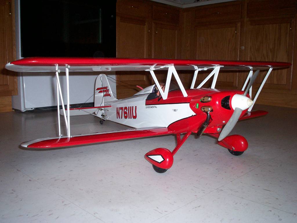

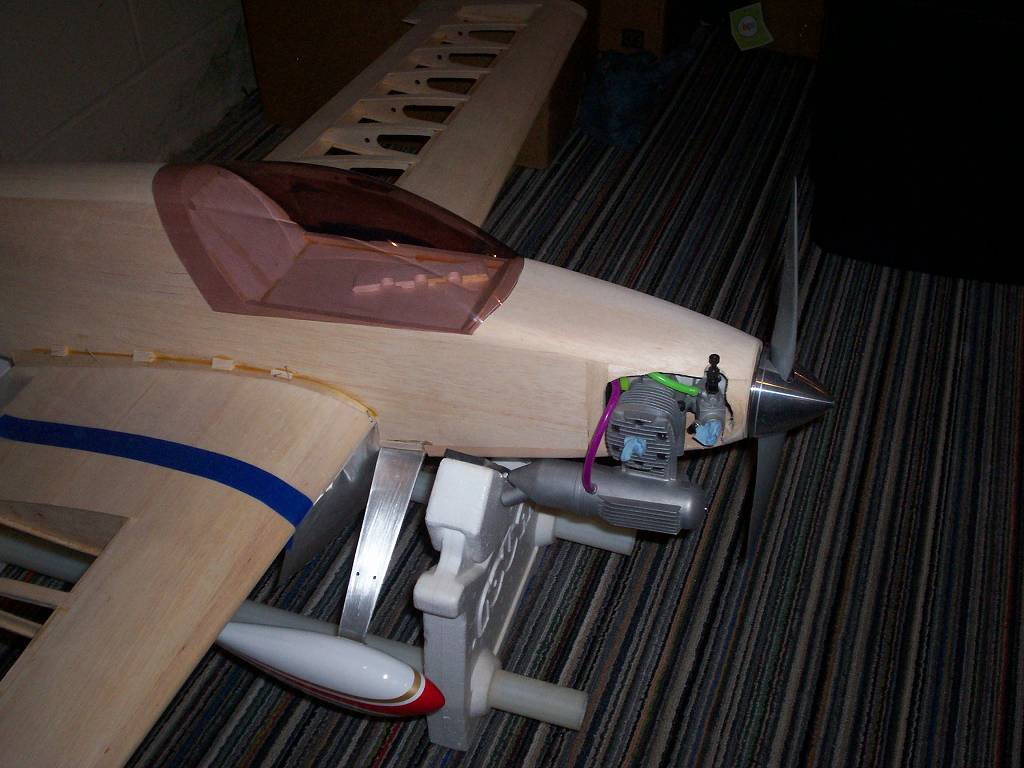

<span style="font-family: Comic Sans MS"><span style="font-size: small"><span style="font-size: x-small">so i received my cowl from the guys at fiberglass specialties inc. and have an issue with it. on the top of it where the 2 seams join together, there is a step between the 2 halves of about 1/16 inch. not a terrible problem, but a problem none the less. i'm concerned with using putty to take care of it and even it out and possibly end up using too much and packing on the pounds. i've never used the epoxy and microballoons, and was curious if i would have any problems later with it coming loose or cracking or anything in the likes. the cowl is of course fiberglass, but will the microballoon stick well with it, and what kind of prep work would need to be done aside from roughing up the surface a little bit? or should i try to send it back for a replacement before even messing with it? i did pay $42, not to say everyone should be a perfectionist. but there is a reason i spent that instead of doing one myself with the ABS one that came with the kit.</span></span></span>
If it was me, I'd contact Fiberglass Specialties about the problem before I did anything to the cowl. A 1/16" error in alignment of the two halves would be unacceptable to me. I'd ask them to replace it.
ORIGINAL: crash bandicoute
<span style=''font-family: Comic Sans MS''><span style=''font-size: medium''>not exactly what it sounds like, i'm going to build a sig smith mini for anyone in this forum that hasn't read the history on my other post. (stick plane for clear covering) the naming is for the covering. being a beautiful ''stick'' plane, i'm going to cover it in clear covering to show off as much of the framing as possible. i love looking at a plane all framed up and perty before it gets all covered up. so far, i'm thinking of the same colors as on the box, with the red and white and black trim, but i just had an idea a few minutes ago for thinning out some acryllic paint and painting the frame work for the color of the plane and using clear (no color) covering over the entire plane showing the color on the wood. ??? not really invisible, but it sounds cool.</span></span>
Granted, you can do whatever you wish, but this really sounds like a recipe for disaster. I hope you would reconsider.

<span style="font-family: Comic Sans MS"><span style="font-size: x-small">i thought about the issues and concerns with the orientation of the aircraft and still do want to do the clear covering, but what would you recommend for bettering the visibility of the plane in the air? i'm going to do the original red and white scheme, but the covering is going to be clear where the white would be, and the clear red respectively. all the decals will be on the plane in their respective places. do you think it would still be difficult to see it? i also fly in a field about the size of a football field. maybe a little bigger. maybe i should just do the top and sides of the plane in the clear and the bottom in opaque?</span></span>

<span style="font-family: Comic Sans MS"><span style="font-size: x-small">i thought about that originally, and yes it does sound pretty outlandish. i think it would look kind of cool, but definitely hard on the eyes. i forgot about posting that little idea. i think the clear and x-parent red will be the way to go, andwith all the decals in place, i would hope it would be pretty easy to see and keep oriented. i need to get away from work so i can get home and start working on it. i just finished up the coming home chores over the weekend and am cleared by the queen to have "airplane time". </span></span>

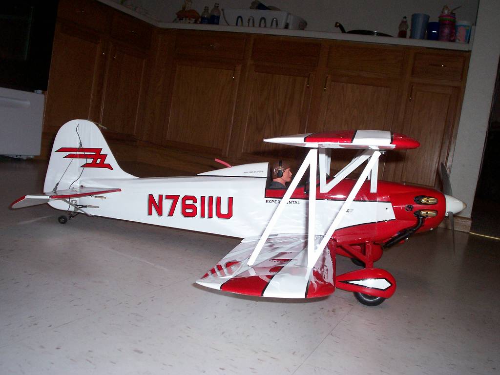

<span style="font-family: Comic Sans MS"><span style="font-size: small">so how much different is it flying bipes? i've only flown high wing taildraggers and my RV-4 once. i heard the mini is a ground-looping queen? is that typical of them because of the smaller stance or what?</span></span>
There is a short tail moment between the firewall and the end of the airplane. Therefore, the torque of the engine has a significant effect on the airplane. When you apply throttle, it desperately wants to spin the airplane hard to the left. This is why , with the miniplane, a bigger engine IS NOT better.
Advance throttle very slowly and do not over correct with the rudder on roll out. This will take a lot of time to master, but once you've got it- it's sooo good.
A gyro would help, but I've never used one.
Ususally with bipes, the extra drag with the cabanes, struts, extra wing, etc will stall you out on landing without throttle management, but the Miniplane will float in like your trainer, only land easier.
Once it's in the air, it is no big deal- other than it draws a lot of attention at the field.
A Hog bipe is a better Bipe trainer, so is the SSkybolt. For the ground-looping issues, I would not recommend it ad a 1st bipe.
I liked mine a lot before I stalled it out in a dumb manuver and auggered it into the ground!!
Happy building,
Brian

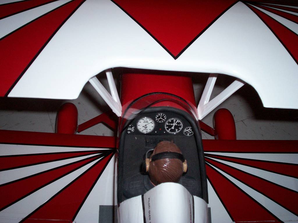

<span style="font-family: Comic Sans MS"><span style="font-size: small">i just like the sound of the 4-strokes.
i don't have one yet, buthave beeneye-ballingthe magnum .70for a long time. it seemedlike a good all around motor for most of the planesi have are .40 size.looking at your photos, your n-struts look more sq'd around the edges. is this okay or should i try tostreamline them? the instructions make it look a little intimidating along with the construction. not that i can't handle it, though. i think i'm more concerned with making the solder joints look nice. i hate soldering!!! i have a buddy that works in a machine shop and was even thinking of asking him if he could fancy CNCme up some T6 ones, nice and thin, then just paint them.same with the gear struts. how snazy would that be??? probably not really any more weight, either.
also, the black trim tape you used on the edges of the red...is that 1/16 or 1/8 inch?
and what scale guages did you use in the cockpit?</span></span>
<span style=''font-family: Comic Sans MS''><span style=''font-size: small''>i just like the sound of the 4-strokes. [img][/img] i don't have one yet, but have been eye-balling the magnum .70 for a long time. it seemed like a good all around motor for most of the planes i have are .40 size. looking at your photos, your n-struts look more sq'd around the edges. is this okay or should i try to streamline them? the instructions make it look a little intimidating along with the construction. not that i can't handle it, though. i think i'm more concerned with making the solder joints look nice. i hate soldering!!! i have a buddy that works in a machine shop and was even thinking of asking him if he could fancy CNC me up some T6 ones, nice and thin, then just paint them. same with the gear struts. how snazy would that be??? probably not really any more weight, either.
I would reconsider the N Strut procedure.
I'll PM you in a little while.
The pin striping is 1/8", and the scale guages I do not remember. I just used what I found that most closely matched the photos in the manual of the full scale original. I built this airplane in 2004- I think. So it's been a while.
