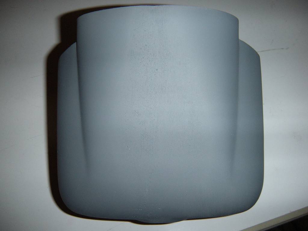

First call FGS about the cowl and see if the problem was in the plug/mold itself or if there was some other problem. The product I use for filling glass cowls with holes or seams is <span style="font-size: x-small"><span style="color: #ff0000">Bondo Glazing spot putty</span></span>, easy on with light coats and easy to sand, good stuff!!
Ground handling on the Smith is just like any short coupled planes, hell on the ground but after you get used to the plane it's just the nature of the beast, you have to slowly roll on power and get the ground speed up, never just fire wall it. Once in the air it's pretty much like any other plane, bipes just slow down faster when you chop power. Landing the Smith isn't hard, it's smooth and slow but then after roll out you have to steer it back into the pits, ground handling again!!.
It's a fun plane and a fun build, just not a good choice for a first bipe but if you have enough hours on the sticks you can figure it out. I had to pull the OS .46 out of mine and install the OS .70FS but it was just to get rid of some of the nose lead I added to get the CG.
<span style="font-family: Comic Sans MS"><span style="font-size: small">just found it... where do you get this stuff at? an automative joint or like a home improvement store?</span></span>

<span style="font-size: small"><span style="font-family: Comic Sans MS">so after a brief stop at the ole McD's and napa auto parts, i found 3M's bondo glazing and spot putty and a can of bad *** duplicolor "chrome red" spray paint. sweet!!! so, off to filling pits and patches on the cowl, i go...</span></span>

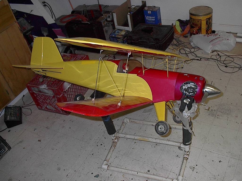

When I said a long time ago it was a very long time ago. I just went out to the shop and pulled down a 60 size Aeromaster I have and the wing servos are mounted on there sides right on the hatch cover. If you look you can see a servo bump. The other shot is just another way to mount servos. I use four different ways and a fifth if it is a scale plane with a thick wing. I'm really not much help on the Smith because it was so long ago. At that time I was into WW1 planes and the bipes just before WW2. When you get to the wing just stop and think about how you can get a servo to work in your wing, the answer will come to you. The mini servos like the HS 82 have the torque needed for your plane but the servo motors are pretty small and will burn out quicker depending on how you fly and how often. With the standard size servos that are tapered that are made today I don;t think I would go mini. Go to Tower and Servo City and look at the different sizes you can get today. I'm sure you will find something for your use.

<span style="font-family: Comic Sans MS"><span style="font-size: x-small">a couple of pics of the cowl primed. it's sanded down now and done with the putty, but needs the finish sanding, yet, before being painted up. the 3M bondo glaze and spot putty is awesome stuff. i was sceptacle at first when i squeezed it and some oily looking stuff oozed out, but then it turned "normal". you can kind of see where some of the repair areas are with the primer on there, but not as bad as before it.</span></span>
