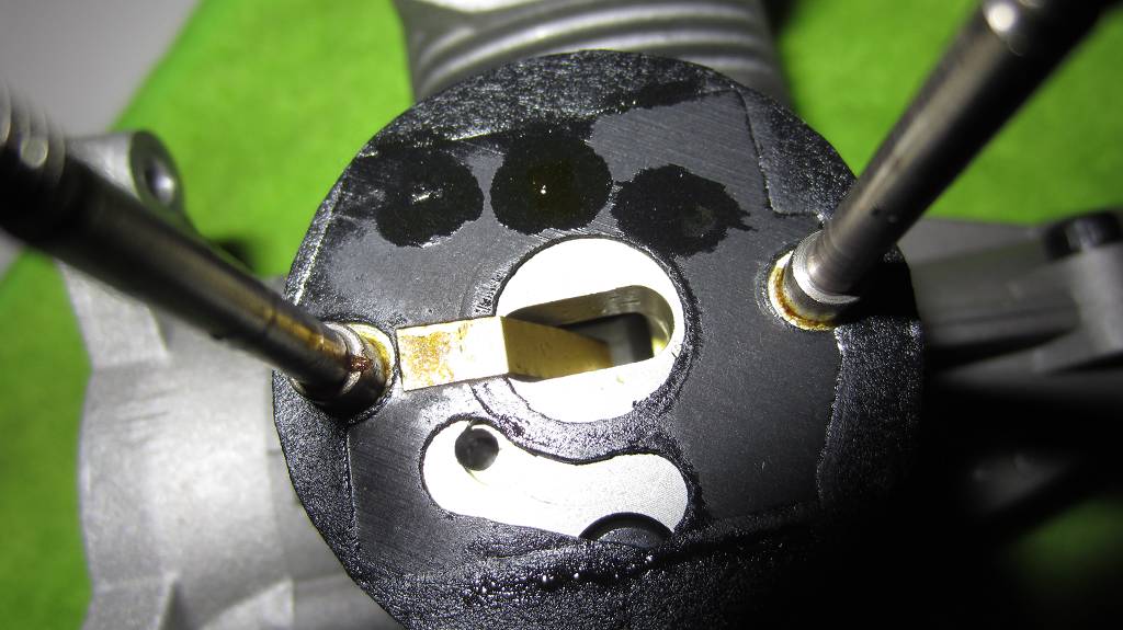

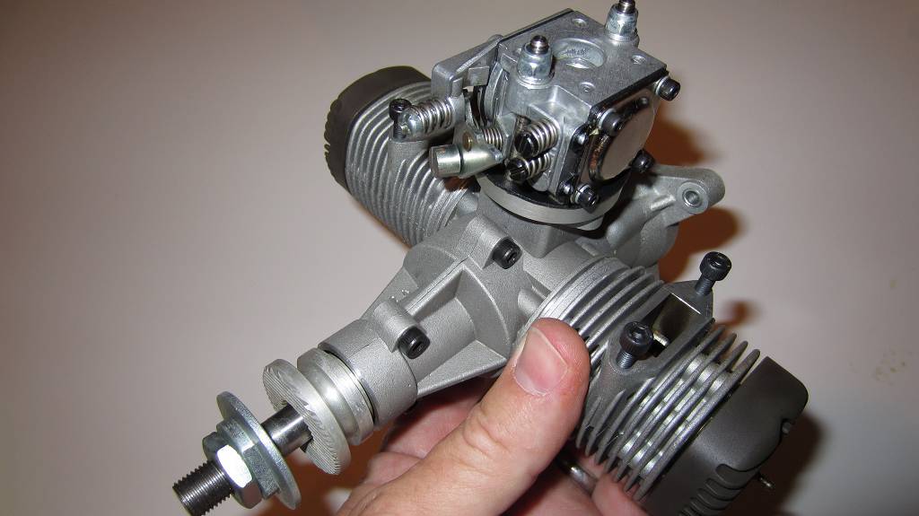

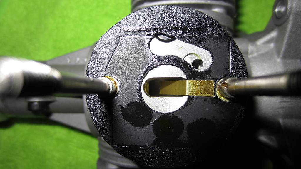

Bill Vail (who posts on RCU occasionally) gave his MVVS 1.20 Twin to the late Jim Cline (Of Cline Fuel Systems) some years ago to sort out. He reports of success with a simple modification, and exchanging the supplied barrel rotor Walbro carb (which seems to be the main problem) to a butterfly Walbro carb suited for flowing suficient glow fuel.
Whilst not set up for all out performance, reliable running and idling was obtained, with Cylinder Head temps within 10 degrees F of each other. Carb Bill used (recommended by Jim) Walbro WA 46 G9.

Following on from my last post, here are notes Bill Vail sent to another enquirer about sorting the twin, which he kindly made available to me. I post them here for all to read:
"It's funny how these threads go. I posted a picture of my collection of toy engines and I've received 3 e-mails asking about the MVVS 1.20!
My 1.20T did NOT run well as shipped. I would not have considered the engine flyable. The carb the engine shipped with would not pump enough fuel and while it would run, it was very close to full goose lean even with the needles back all the way out. Further, one cylinder ran considerably leaner and much hotter than the other. One cylinder ran nearly 100F hotter and of course the colder cylinder was prone to flaming out.
I contacted friend, genius, and hobbyist the late Jim Cline. He recommended the carb pictured. It has proven to be near perfect solution. The carb runs perfectly and the only reason I say near perfect is that the linkage to the throttle is not very handy and will require some work to setup.
As for one cylinder running leaner, he recommended placing a small piece of brass between the carb and reed cage bent such that it deflected some of the incoming fuel charge towards the lean (hot) cylinder. I had NO expectation that such a simple solution would work. It took some tinkering/trial and error but it worked better than I could have dreamed.
At this point I should mention, I've never flown this engine. I did all my tests while it was strapped to the test bench. I removed the engine running extremely well and had every intention of building something that would showcase its looks but the holding pattern over my building bench is large and I haven't gotten around to it - yet (12 years ago)! I did keep notes of my running though.
Dec 1999 - Air temp 70F
Mufflers -Bisson twins
Plugs - Fox IB
Fuel - 8% nitro, Klotz synthetic, and castor.
Prop - APC 15x8, 8,800rpm with solid 1,500rpm idle
RT cylinder 265F, LT cylinder 255F max. (typical - RT210,LT200 at plug)
While it took me several enjoyable days and a fair bit of fuel to get this engine sorted out, all credit goes to Jim. In this ARF/E world, I miss folks like him. Sometimes it's easy to back off sharing what took me days to discover and then I remember Jim who would share everything he'd learned over a lifetime and ask for nothing more than to let 'em know how it went. The bit about modifying the airflow with a bit of brass was genius and he shared it without a second though. I've used it on other twins since and NEVER heard of, or seen reference to, this simple mod anywhere else. If you choose to pass this tip on, please reference Jim.

fiery, could you possibly post some pics. of the fuel diverter that you and jim c. came up with. as posted i too have 1 of these twins, a 1.20cid. thot about a walbro wt-499 alky carb. because of the opened up jetting. the walbro carb. that came with the eng. just is lacking in fuel flow. thought about fabing up a new 90 degree(carb. facing forward) manifold set up with a little greater volume with the reed setup just under the carb. and then putting in a triangle diverter plate down into crank case to direct fuel mix towards both cyls. kind of like a cars manifold does. anyway just a thot.
Old 06-07-2011 | 08:19 AM
My Feedback: (133)
Joined: Aug 2008
Posts: 590
From: Keizer, OR
Default RE: MVVS Twins
fiery, guess if i had enlarged the pics. you posted i would have seen the little brass diverter you mentioned. i worry about how long that would last before eng. pluses and vibra. would cause it to break off and the eng. eating it??? i'm also looking at opening up slightly the intake ''slot'' in the reed valve body as it looks very restrictive!!!!! any loose of flow here could cause a ''govenor effect'' and thereby limiting output of the eng. much like restricter plates that nascar engs. are required to use. we used to use restricter plates in the tow tractor engs. when i worked for skywest airlines. we would install an aluminum plate under the carb. with a 3/4'' inch hole in it and this way limit the rpm output of eng. but wouldn't effect the idle at all, just top rpm. mechanical throt. govs. were very expensive, the plates worked and cost was almost 0. i thot i would open up that slot and blend the top of the reed housing to match the carb. base, then taper it down to the base of the slot, much like blending a manifold or cyl. head would be, opened up then blend back into the manifold or head port.
