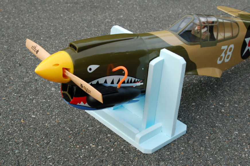

You can actually balance a plane very accurately on a "wide board." I do it all the time, but there is a trick to it.
I make building cradles out of insulation board. It's about 3/4" wide. I've got a number of them around the shop. I pick one that's too big to cradle the fuselage, that hits the wing on each side before the fuselage touches the trough. Then I balance the thing. OK..... actually, I put a strip of masking tape along where I think the CG is going to be discovered.
With the thing balanced, I get a pencil and start shifting the plane foreward. At some point, it will just start to tip nose down. It's easy to hold it and mark the masking tape. Now start shifting the plane back the other direction. When it just starts to tip tail down, hold and mark. Halfway between the marks is exactly where the CG is.
Calm, no hassle, and no real effort way to find the CG. And it's marked on the plane... uh, marked on the tape on the plane.
And no special tool is required. There is a very slight bit of touch to it. You'll pick up the touch right off.
I found the CG on that Warhawk with that foam cradle in the attached picture. It needed the battery moved back so took the wing off, moved the battery, wing back on and found the new CG was where I wanted. When the plane went to the field, the fuselage rode in the trunk in the cradle like you see it.
