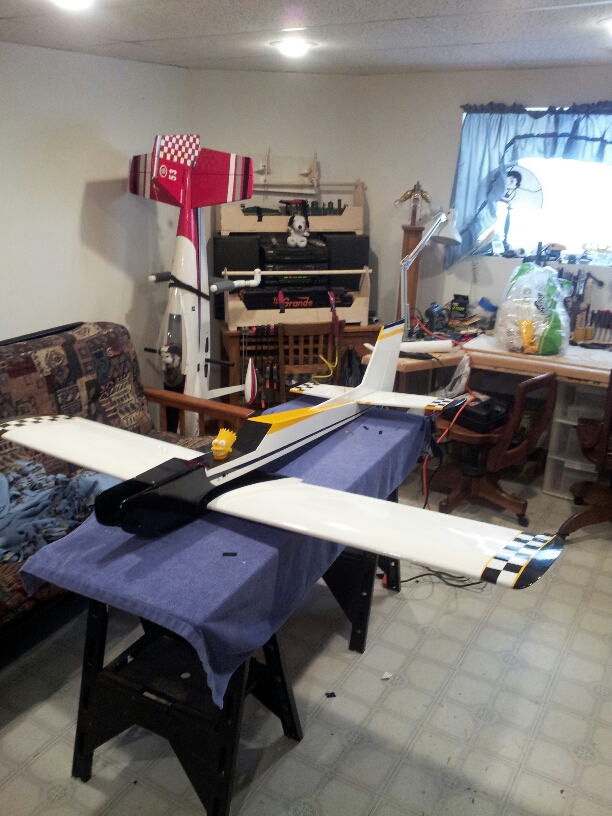

hi
i want to start using rudder on my turns ,i would like to mix ali to rudder what % should i mix the rudder in at ,i know that when i take off and land i need to shut off the switch ,thanks

Default RE: using rudder
Rye many types of airplanes can indeed benefit from a mild Aileron to Rudder mix. It most often is the high wing cabin types and for those I would recommend also around 10 to 15% and contrary to what you think it does not have to be done through a switch and not necessary to switch off for landing.
That is a lovely tiger you have there. That airplane is a good example of a type that there is really no benefit or use for that mix however. So if that is the subject airplane as mentioned you are better off without it and of course do experiment with using the rudder manually, its fun.

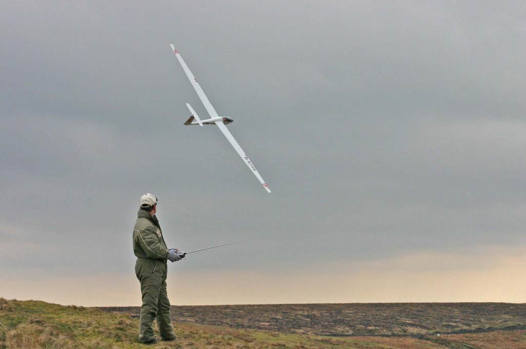

rye nothing wrong with trying a mix BUT PUT IT ON A SWITCH.
Try 50% rudder and take off without it being active. Get three mistakes high, switch it in and see how the plane behaves. Switch it out before landing. Mess around with different mixes.
I suspect that you will find that you don't want rudder mixed with ailerons on that model BUT YOU MIGHT WANT AILERONS MIXED WITH RUDDER if you are trying to get perfect stall turns.
Here are two models I used to fly where rudder and aileron combined either through a mix or manually was needed to get pretty looking non skidded turns. I am used to using the rudder as I fly as play with 3D aerobatics a lot but for a relaxed day flying either of these I had a mix set up and used it most of the time. But it was fun to switch it out on the Stampe and using crossed controls to get it to side slip into a landing kicking it straight at the last moment. The glider needed rudder in turns and if I was flying in marginal lift conditions it was more efficient flown that way.
