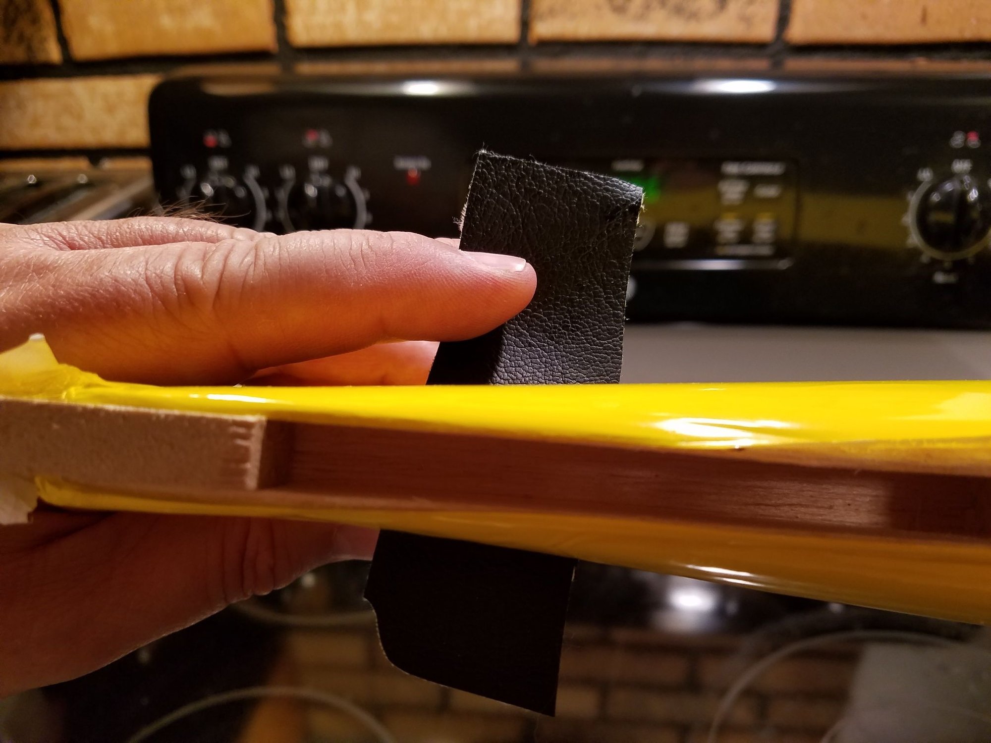

guys, so I have a World Models Midget Mustang (the last model I will buy from them). the slot on this fuselage for the Horizontal Stabilizer has "a ceiling", and the slot has a rather tight fit to the Stab. so if I apply glue to the slot then install the Stab a vary good amount of glue will be pushed away as the Stab is installed,
my friend told me to make divots down the middle of the slot (top & bottom) and use Gorilla glue because it foams,, I didn't like this idea because when this glue foams it has many-many bubbles throughout the glue.
I don't see any other way to install the Stab, can I get some comments about this ?
see page 7 in the link for reference,
A072.pdf
thanks big time guys
Jim

Take a popsicle stick, wrap it with a medium to fine grit sandpaper and use that to widen the slot slightly. Just make sure you don't angle the sides of the slot so the stab stays parallel to the wing. It won't take much to make the stab fit the way you want so be gentle with your sanding.

I'm not too sure about that one. A tight wood to wood fit is the most important thing for a strong glue joint. Assuming the parts aren't in a bind, opening it up will just require filling the gap with glue. That doesn't ever make for a good build.
It's ok if some glue pushes out. Press it into the wood so it soaks into the pores on both the fuselage and the tail. Wipe off what smears and press it into the joint after it's in place. Clean the residue with alcohol before it starts to cure.

no binding, it's a good fit, just a little tight, how about using "TiteBond" (3) wood glue, I know a lot of plane builders use it for framing. being thinner it will soak into the wood more than epoxy and have a longer work time than epoxy. but it will also be scraped off easier than epoxy as the Stab is being pushed into the slot

I would not use Tite Bond, being water based it could swell the wood leaving you with too tight a fit as you slide the stab into the slot. I have two options for you. For the guys who would feel better about using epoxy, use epoxy laminating/finishing resin brushed on both the stab center and the interior of the slot. Let the resin soak in a minute or two, slide the stab into place and clean any resin that may have gotten on the covering with alcohol. Option 2, slide the stab into place and wick some thin CA into the joint. There is so much contact area there that the CA would hold that stab into place just fine. You can easily expect a 3/8" to 1/2" penetration of CA into the joint.

If it's balsa to balsa thin CA would be my choice.

I would probably slide the stabilizer so it is about a glue-joint-width from being in place (i.e. most of the way).
Then apply a bit of slow-setting CA right along the joint, push the stab through so it's the same distance out on the other side, and apply another line of glue.
Finally center the stab in the fuselage (maybe even move back and forth a few times to get the glue spread out inside the joint) and let the glue set.
My bad. I thought the stab slotted in from the side...
I see from the manual it slots in from the rear (sorry, I can't post an image or link...)
Same basic suggestion. The idea is to get glue onto the stab and then distribute it between the two (hidden) surfaces.
In this case I would probably try to get glue inside the fuselage slot using a hypodermic needle or just carrying small bits from the glue dispenser tip into the slot on the end of a bit of solid wire. Then push the stab in place and align it.
Alternatively, you could try a modification of my first suggestion and slide the stab in dry, then slide it slightly to one side, apply glue, slide it to the other side, apply glue, and then put it in position.
A thin epoxy (like WEST System) would also work. You can clean excess off before it cures with denatured alcohol, if you get a little too much in and some of it oozes out.
If you're concerned about the joint's strength after that, you could apply a small fillet of CA or epoxy between the stab and fuselage-sides after the first glue has cured.

thanks guys for replying,
I will just have to find some thinner epoxy or epoxy with a longer working time.
I have been using epoxy since the 90s for many different things, I have found that one of it's biggest secrets is good mixing.
I have had very good luck with Devcon 2 Ton epoxy, but it's work time is rated for 30 minutes, but I mix very well and I find it's work time is really only 10 minutes or less.
mixing epoxy and applying it and thin aligning the horizontal stab correctly takes longer than 10 minutes, so I will get some that has a longer rated work time. .
thanks again for replying, you all conferred in what I was thinking

the fits are so good ^that's just what I was thinking.
too add to that, as I said, the horizontal slot has a ceiling as well as a floor, and it's fit is so good to the stab I think I could just drill 3 or 4 tiny holes in the slot's ceiling and add CA to glue the stab threw the holes, then add CA around the out side joints. then mount the vertical stab.
the photo shows the bottom of the slot for the vertical stab, I could drill the tiny holes threw for CA. I added the fake leather so you can see the 2 slots do not inter-join
Jim
