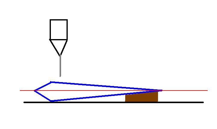

First thing you need to do is work on a level surface.
Now get out your ruler and your pencil and do some layout. Mark where you want the control horn to go. Put marks where all the screw holes go. Mark the clevis--mark whatever you need to do so you KNOW where every screw and clevis is going to attach. This is not the time for "thats about right"
Now you set your control surface on the bench and block up the trailing edge (brown scrap wood) until the centerline of the control surface is level. Notice the red line in my drawing. That red line should be equal distance from the bench on both ends of the red line. Then you know it's level.
Now you set your drill press to level and do a test run through scrap 1x2 and make sure the head is indeed drilling a perfectly vertical hole in the wood. Not slanted off on the X axis by 2 degrees or tilted forward on the Y axis 3/4 degree. Perfectly straight up and down.

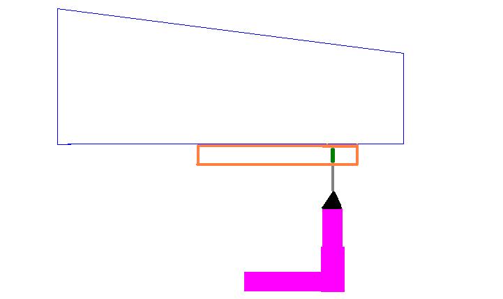

When you need to drill holes in the trailing edge of the wing for hinges, you do basically the same thing.
I made a jig for my cordless drill. The jig holds the cordless drill exactly perpendicular to any trailing edge surface.
Layout the holes where you want the hinges.
Set the wing down on the bench. Block up the trailing edge until the center of the wing is level.
Using a cordless drill--set shims under the drill to elevate it off the work surface until the bit is centered on the trailing edge of the wing. The jig on the side of the drill keeps you drilling straight on and not off at a sideways angle.
The first pic is an end view of the drill and wing laying on the bench. The drill is shimmed with 3/32" balsa strips to get it level.
The second pic is looking from the top. The jig is a simple piece of 1" wide basswood about 8" long. I always use Robarts and they need a 3/16" hole. But, you can make the hole any size. Make 15 jigs. It's easy. I drill a hole in the basswood and epoxy in a piece of brass tubing the size of my drill bit. The bit just slips barely through the hole in the brass tubing and can't wobble around. The brass tube is epoxied into the basswood. When I slip the bit through the jig, I slide the basswood up against the trailing edge of the wing. Now I know I'm drilling a perfectly perpendicular hole into the back of the wing. The drill and wing are shimmed--so I know they are level too.
