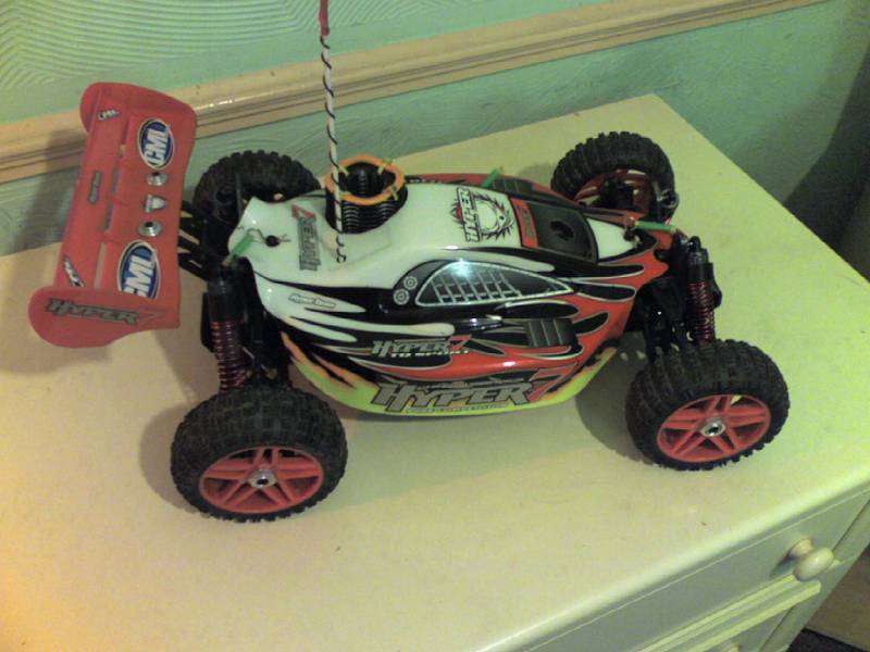

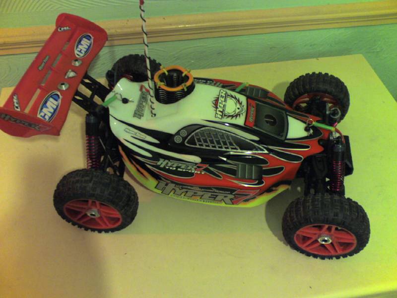

Here's my Hyper 7.28.these are the most popular RTR buggy in the UK from the amount that members of the MSUK forum own.Parts are abuntent on ebay aswell as hop ups so thats why they're so popular I think.The engine is the standard Macstar.28 6 Port..
All i've done is add,Tower Pro MG995 Steering servo,Futaba throtle/brake servo,Venom 1200mah RX pack,Mirage Failsafe and purple springs.I recently sold it and got a HBX VRX-2 Pro,I missed it straight away but wanted a change.....
