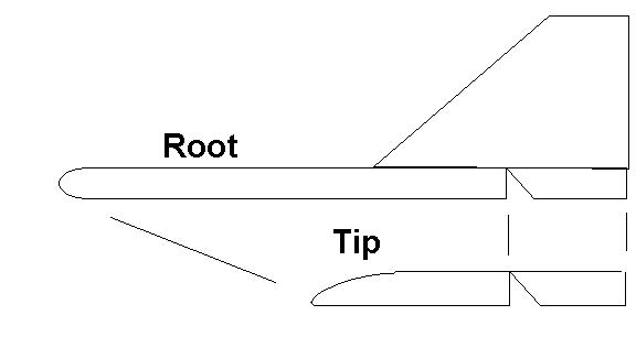

Maybe this is agains the TLAR method, but when you shaped the wing, were you thinking at all about a specific airfoil? or just going at it til it kinda looked like a wing?
Like I said, I do have access to a wire cutter, so I could do some sort of more definied foil.
As for servos and such, I'm guessing the cox .049 could do well with a 1oz tank and micro servos (we don't want to have to fly the plane for 15 mins on a full tank with no way to land early).

The wing is only 3/4 inch thick (18mm) so there's not much to work with even if you had a hot-wire. The rest is just flat foam board the whole way.
Here's a quick drawing to give you the idea.
Not a lot of science or math to it....it just works.
