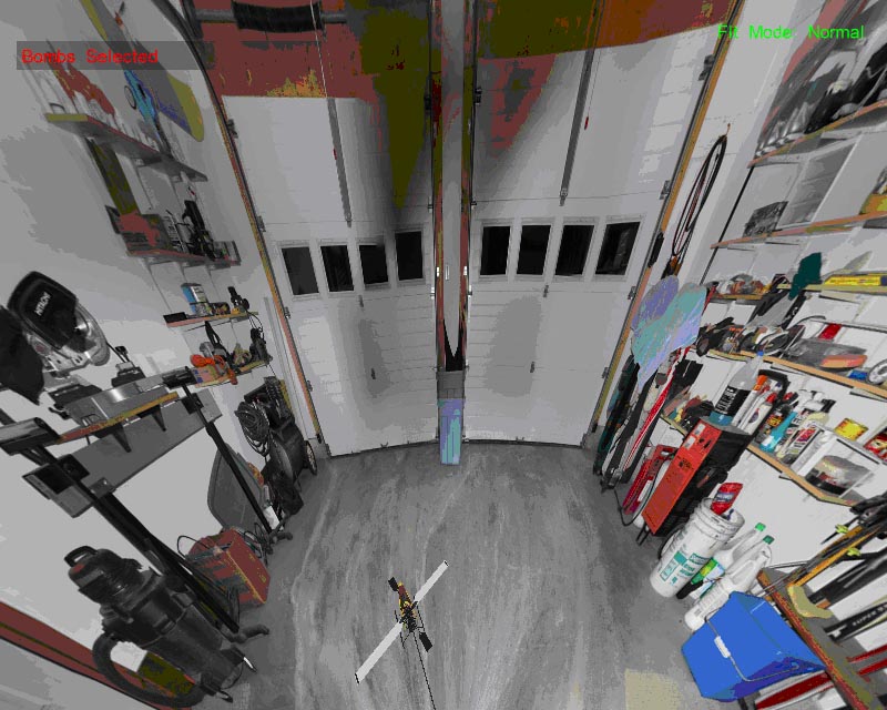

Posts: 297
From: Woodstock, VT
Hi Guys,
I'm struggling with the pano of the garage too:
1) My garage looks strangly out of proportion. I have 8 tiles 4 x 2 (2048 x 2048 each)
2) the vantage point is about 6 ft off the ground, which is where it is supposed to be, but when I zoom out it looks like a pinpoint by my feet and in front of me the heli looks three times too big compared to the space. Or is it the space looks 3 times too small. I don't know.
4) I'd also like to know if I can set the zoom out, as I feel like I'm standing in the middle of the garage when I know the photo's were taken with me by one wall
Scott
Edit: Thought this visual might help.
Scott
