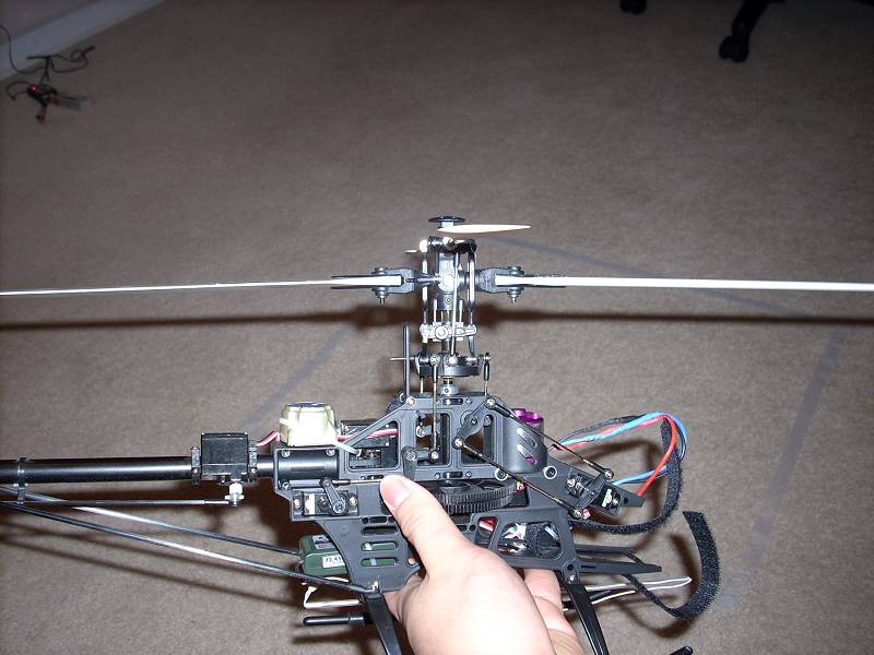

I hope you could help me again, I've got another Belt-Cp issue.
Recently, i just noticed that my main rotor aren't in balance. Instead of one straight line view from one side. it is tilt down from the mddle. When I spin it up in normal gyro mode it spins violently and out of control. When I use reverse mdoe it is usable. It still has a lot of vibration. When it's on concrete ground, it violates so badly, the tail wing knocks the ground couple times and main rotor changed its spots. I think there's some kind of pitch or main shaft problem. I'll appreciate any help. If you need more information, I'm updating some sample videos on youtube soon.

If you've had a crash and by your discription, I believe you may have bent the spindle/feathering shaft in the rotor head.

I've uploaded the pictures, please tell me if there's anythign wrong. The bent spindle/feathering shaft is possible but I don't think it could be. The crash I meant the helicopter spun out of control when throttle turned all the way down and it hit a side of the room.

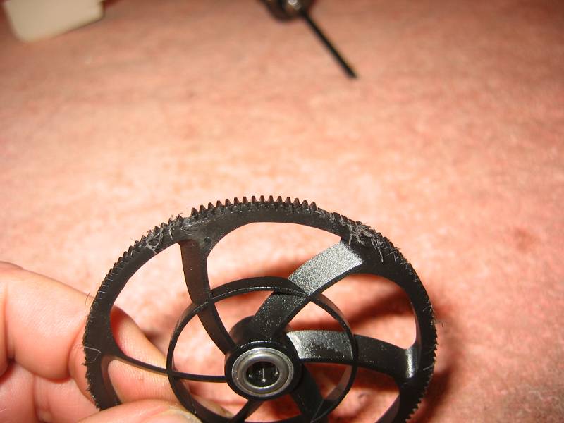

the main gear is slightly damaged from my familization with the transmitter. I accidentally pressed IDEl button and the throttle turned maximum. The strange part is that it was fine after that. Now there is a bit of problem. So could you tell me if there is anything wrong other than the main gear?
If I were to replace the main gear I would need help to replace it. Right now, I see about 2 to 4 teeth completely broken off and a little bit left for 3 to 6 teeth. Rest are fine. Is there non-plastic main gear? I am going to buy the spare part before summer and willing to get it flying just fine till April.

lol, you cannot fly a heli with broken teeth on the gear... none, zero, nada... this is completely baffling to me that you would even consider it and that you're wondering what your problem with the heli is...
change the gear or you're going to have another crash which will break even more parts.
is it just me or is this not obvious??
the reason the gear is plastic is because it's a cheap part, try to imagine what would happen if you had a steel gear and hit the idle up??? you would trash your motor which costs 5 times more than the gear, or you would have broken some part of the head or even if it all held together you would have had instant 3000 rpm and probably destroyed the heli from that.

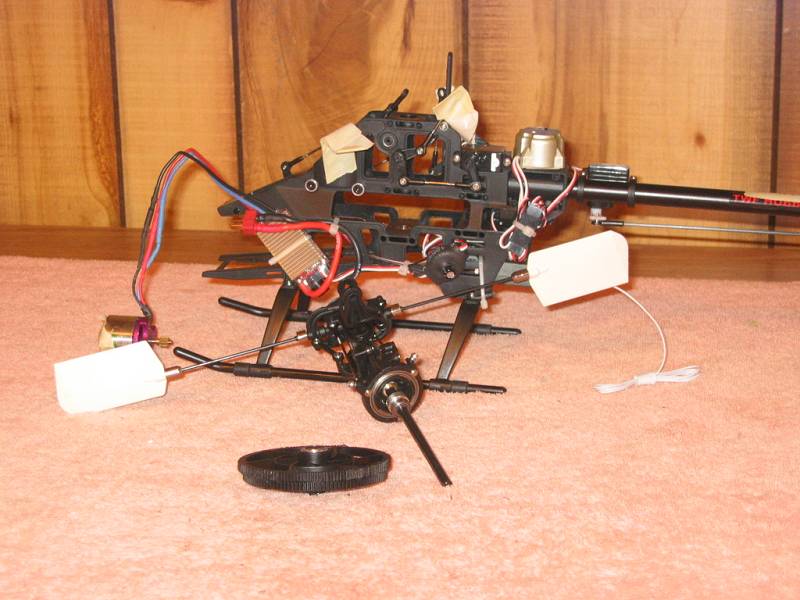

I kinda thought the main gear was damaged by the sound. With 2 to 4 teeth completely broken off, it's time to replace the gear. It'll never be right with out a new gear. The rest may be fine, but it's the broken ones and worn ones causing your problem.
I'm not aware of a non-plastic gear, and it won't be a good idea to get something stronger. Other things would break. I'm not sure they make them for the Belt-CP.. I've got a Belt-CP, and did the same thing, hit idle-up and tore the gear apart.
See pictures of the gear and what the heli looks like to get it out. Need to remove the the rotor head assembly and main shaft.
If you need help, let me know and PM me. I don't always check all the threads.. Oh, you'll need a bearing removal tool also, about 5 bucks.

:}:} the missing teeth is your main problem... your best off not even spinning the heli up with that gear like it is.. also on your first pic you posted it sure does look like to me that the main shaft is bent. anyone else see that??? check your spindle shaft too.. put a hand on each of the blade grips and see how much play you have when you wiggle it up and down.. it is really hard to eye a bent shaft.. even a shaft that has a hair line bend in it will cause problems.. since you have to change the gear you should change the main shaft while you are at it. then you will know for sure if it is bent.
if it isnt bent,,[which it looks like to me] then you will have a spare which you will most likely need one day anyway.. jake.
