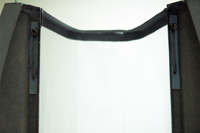

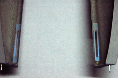

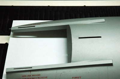

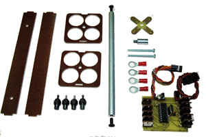

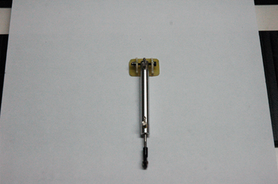

Hello
With some little more work is possible to add a sliding canopyof good effect.
I have realized a small kit to cnc that allows to get a very soft movement and to regulate. To eliminate the possible attrition, has added some strips of polipropylene where they have put the screws, that it has a power self-lubricant. The photos are surely more explanatory.
Regards
Luciano

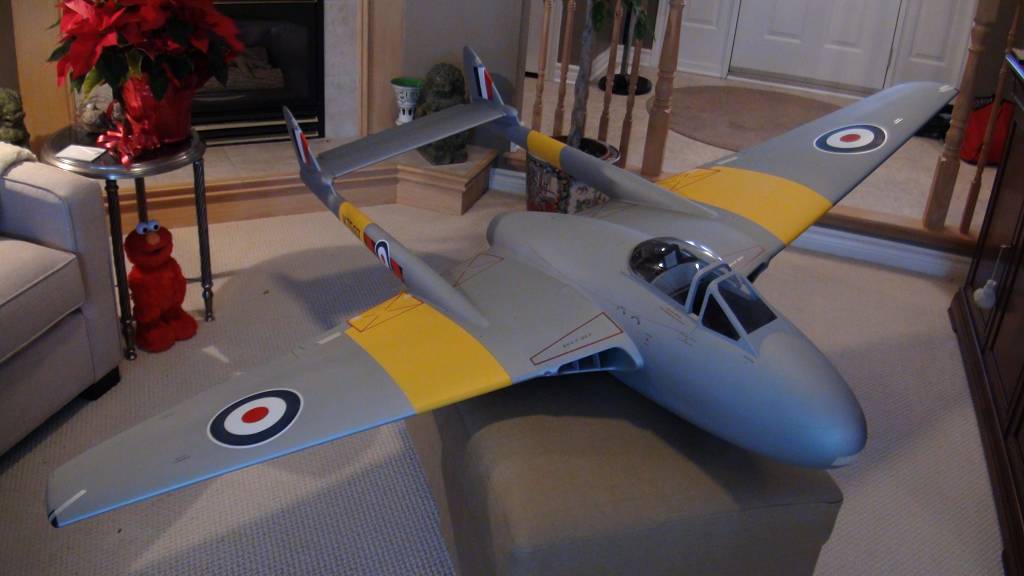

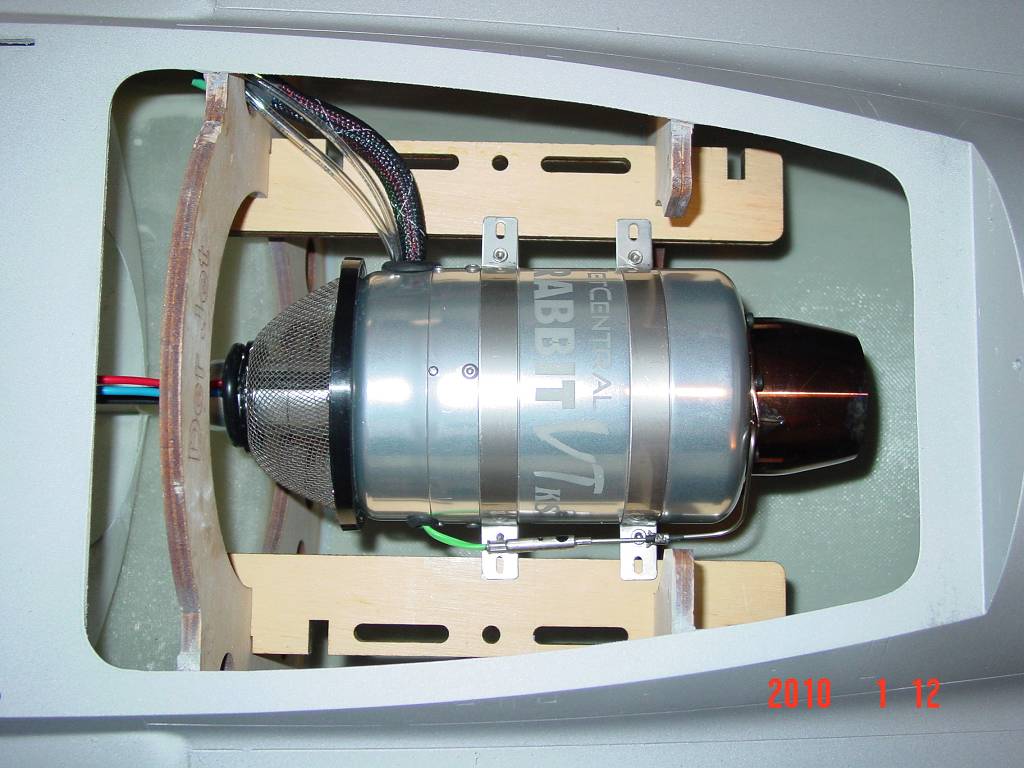

Hi All
Fedex showed up with my Vampire.

Chuck
Looks great, what serial number is that scheme? Which Jet Central turbine you using?
Dave

Dave:
This is a special "one off" color scheme I did for Chuck. It is absent the number 74 on the nose. Vampire is out of Canada.
Chuck is planning to install our Jet Central Rabbit which as of last week is now 20lb of thrust. Also, Kero start is standard.
BTW, I thought it important to post the weight out of the box for DJM Vampire. Weighing everything that comes out of the box. . .including every screw, nut, bolt, and hardware (some of which most modelers may elect not to use) Vampire as delivered weighs 20lb 8 oz. We are extremely pleased with this weight and our production processes in place.
The "weight conscious" modeler can keep Vampire under 30lb at take off. Further, using the utmost of weight management, this can be built and kept within the 13kg weight class for JWM.
Regards to all,
Eric

Hi Dave
I took the paint sceme from a two seat veriant that I found on the net, #WZ 507 on the booms.
Love that Rabbit, I have a Mibo A-10 powered by a pair of Rabbits and it flys great.
Keep the Vamp light with the Rabbit.
Chuck

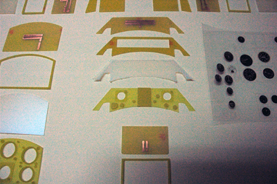

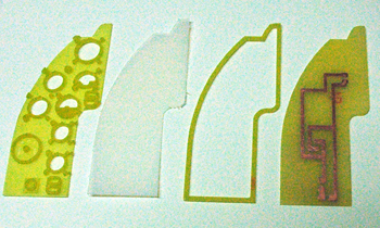

Hello Vampire's People,</p>
I have finished the project of the cockpit. In effects the cockpit supplied by DerJet has a good quality but the scale modeler are a little crazy.... I am crazy.
The kit consists of 24 parts mechanics entirely realized in epoxy laminate and machined in CNC
The project has required more than 100 hours of planning, drawing, cam and cutting, to realize the prototype.
It's totally illuminated with technology led in SMD using the bottom of every panel as printed circuit. (with Led and resistors in SMD)
The next images will be of the painted cockpit, assembled and.... illuminated.
The next project, for the Derjet Vampire, will be to realize 4 tubes for launching the true rockets to place in the front of fuselage, modifying one precedent of mine project that I have realized for my A-10 Mibojet .

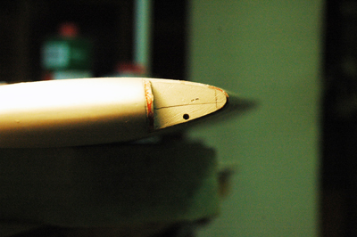

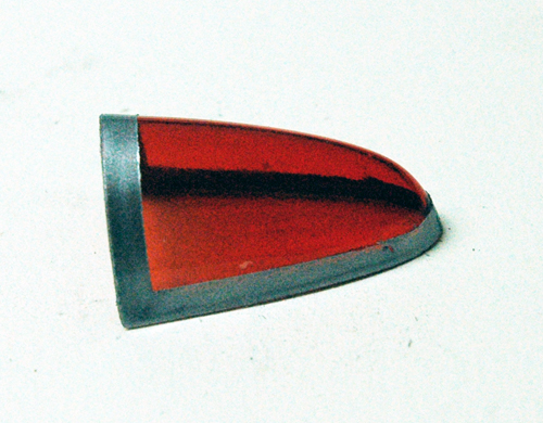

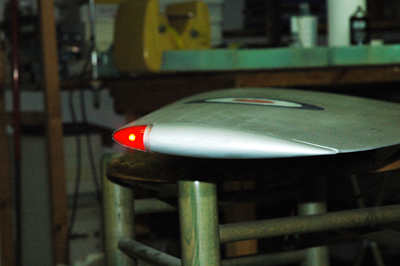

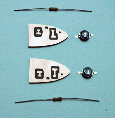

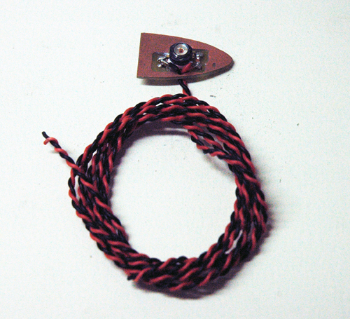

Hello,the Navigation Ligths Set is ready.It consist of 2 print board coupling the shape of navigation lights location in the wings, with 2 led high brightness SMD 1 Watt, 2 resistor calculated for a power supply of 7,2 Volts ( Li-po Battery suppling the PowerBbox, and a couple ow twisted pair wires for 120 cm. of lenght.RegardsLucianowww.flyunitedteam.net
Hi Luciano,
Although I do not own this plane, I like your ideas. The navigation light board is a brilliant one. The copper plan provides both welding tabs and head dissipation. Easy, quick and reliable. Well done.
May I ask you what resistors you're using to make the LED's compatible with 7,2V ?
Many thanks. Oli.

Hi Oli,
many thanks for your appreciation.
Depends from the type ol Led that you use.
In this case, the led is certified for 45 mA of current absorbtion. You apply the 1st Ohm law : R (resistence) = V(volt) : I (ampere )
This led is certified for 45 mA, your power supply is 7,2 Volt = 7,2 : 0,045 = 160 Ohm. This is the value of resistor
If the power supply will by 11,1 V ( 3Li-Po in Serial config ) = 11,1: 0,045 = 246 Ohm ( Commercial value of 220 or 270 is good.)
Regards
Luciano

Default RE: derjet vampire
ORIGINAL: fougamagister
Hi Oli,
Regards
Luciano
Thanks Luciano.
My problem is that, sadly, I lost the track of my LED characteristics. They are old Luxeon 1W @ 3,6V type.
From a rough guess, P=UxI so in that case I = 1/3,6 = 270 mA ?
Which would mean that I'd need a resistor of 27 Ohm @ 7,2V ?
Old 01-23-2011 | 12:18 PM
  #100
fougamagister's Avatar
Joined: Dec 2007
Posts: 18
From: TorinoTO, ITALY
Hi Oli,
it's correct, the resistor will be 27 Ohm - 1Watt.
Regards
Luciano
