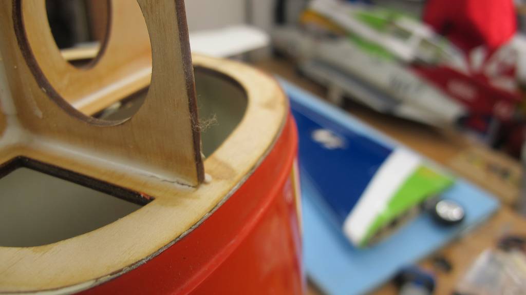

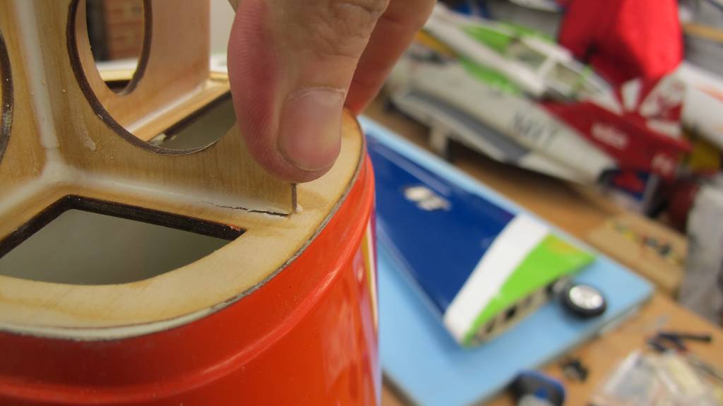

Hi,
I have just started putting my new and excellent PST "Revsion" together and offer a few comments from my experience so far.
I understand the tail plane and fin are designed to be left in place rather than the "Reaction" system where in later models the factory with good effect designed them to be removed.
This brings two points, the first being the front safety bolt which holds the front of the fin in place needs to be re worked to bolt down from the top of the fin ie complete reversal of the kit as sold. Simply you cannot get to the nut when the pipe is in place.
Also my clamp to secure the fin broke two Allen keys trying to tighten it up, I understand that have been some issues with tube sizes of the fin main mount from the factory which are being addressed as I write.

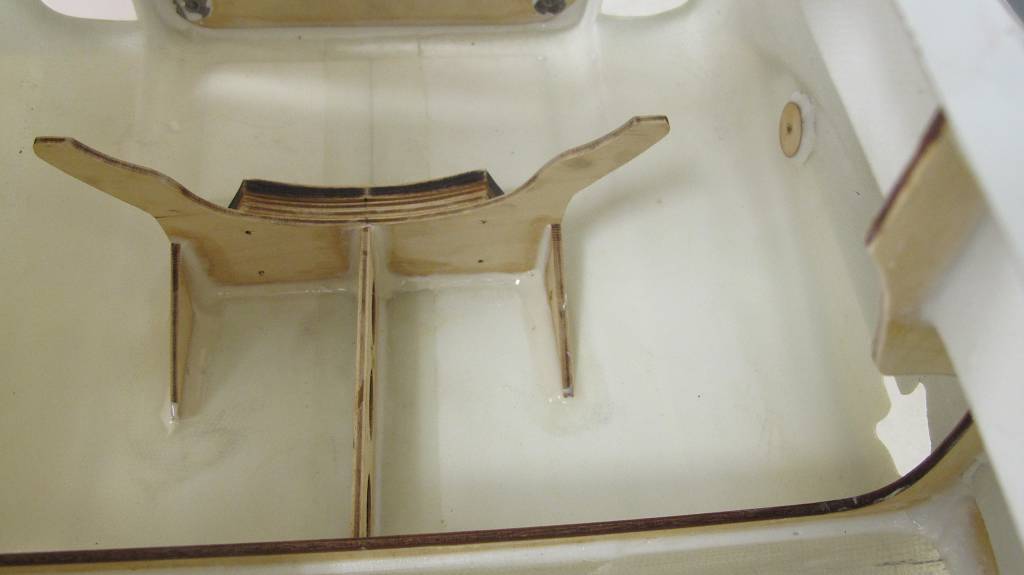

I have chosen to use the excellent "Tamjets" servo mountings rather than the supplied wooden mounts as they allow easier fixing of a security screw from the outside of the servo covers without fear of splitting the wooden mount.
I did find that my nose wheel mounting plate split when I mounted the retract with 4 mm cap screws ( I prefer these to the machine screws supplied). I am sure there will be those that say the machine screws work fine, but its something to be aware of. I believe this is also due to the mounts being slightly too far apart by a couple of mm leaving not enough meat in the remaining wood mounts for any error at all. I will replace these ( In fact as I did on my Reaction).
I think the wooden mounting plates are a little more prone to splitting than I would perhaps like although will most probably be fine with the supplied machine screws. It also would be a good idea maybe if all manufacturers of retracts made them with the hole mounts further apart anyway as this would help in the mounting of all undercarriage s in my view.

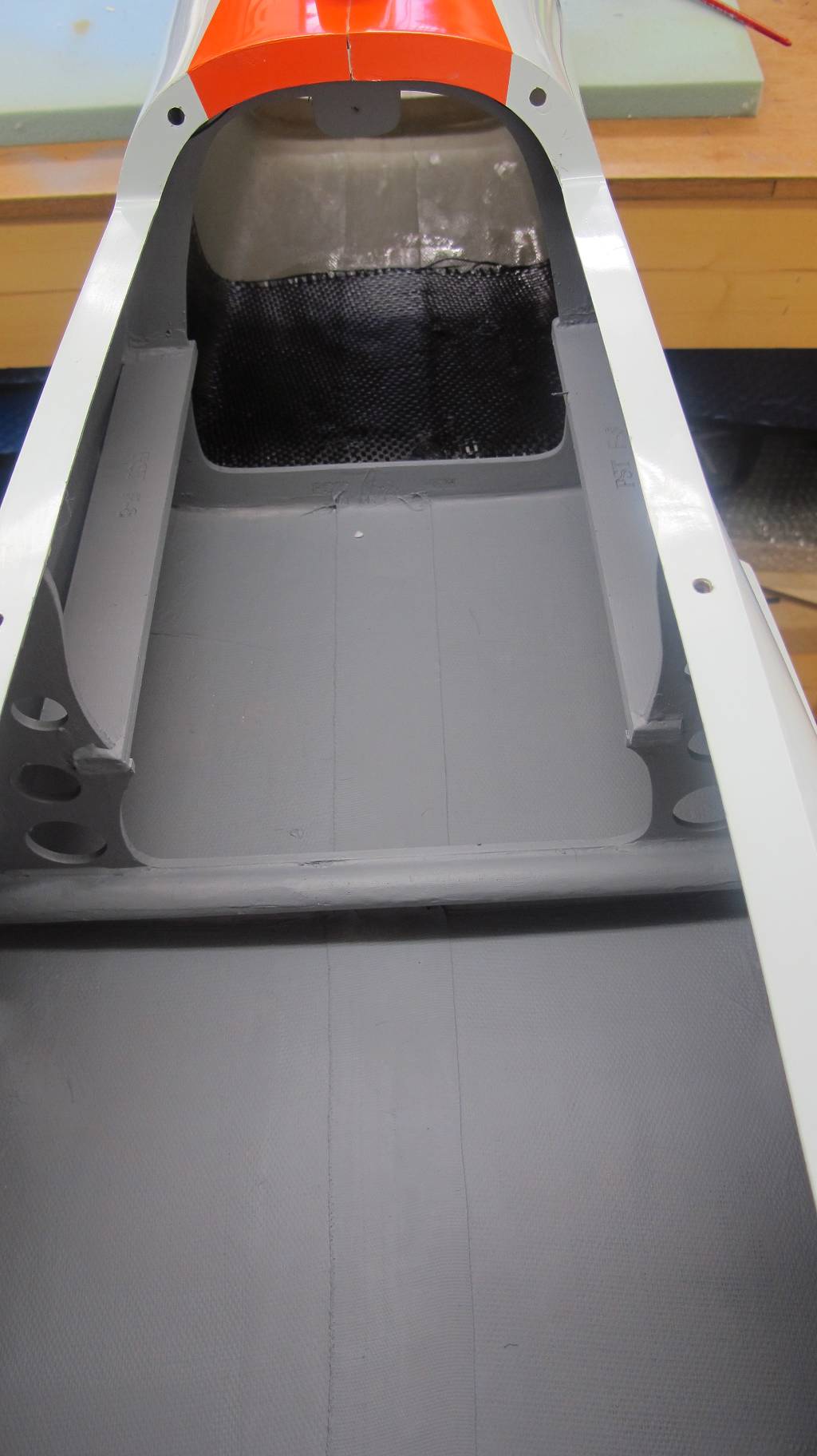

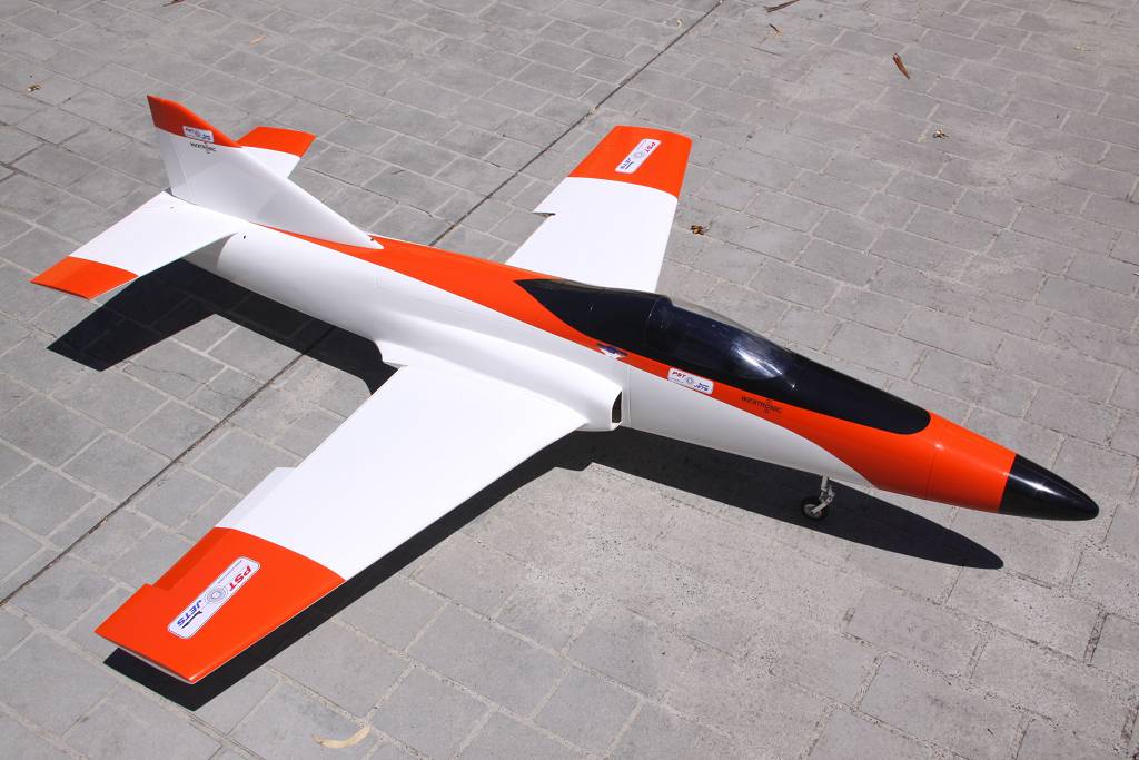

I have just completed a Revision for RCJI review and a full review of the kit components is in the current issue. Verdict: outstandingly good with beautifully made landing gear, as good as ANY, as the icing on the cake.
Build: No real building is required because the kit is completed to an extraordinary extent.
Builder is required to:
1. Install control surface horns.
2. Hinge rudder.
3. Trim and glue clear canopy to frame.
4. Fix gear doors and speedbrake if used.
"Build" complete, ready for equipment installation !
Minor comment, as David said the forward fin screw can't be accessed with thrust tube in place, so I have replaced the screw on mine with CF rod spigot as on the BVM F4 fin which is similar in size and shape to the revision.
I used self tapping woodscrews with pilot holes for landing gear fixing as these will pull out of the wood in a hard landing whereas machine screws tend to pull out the landing gear plates making repair more difficult.
Similarly the forward wing screws have been replaced with CF rod

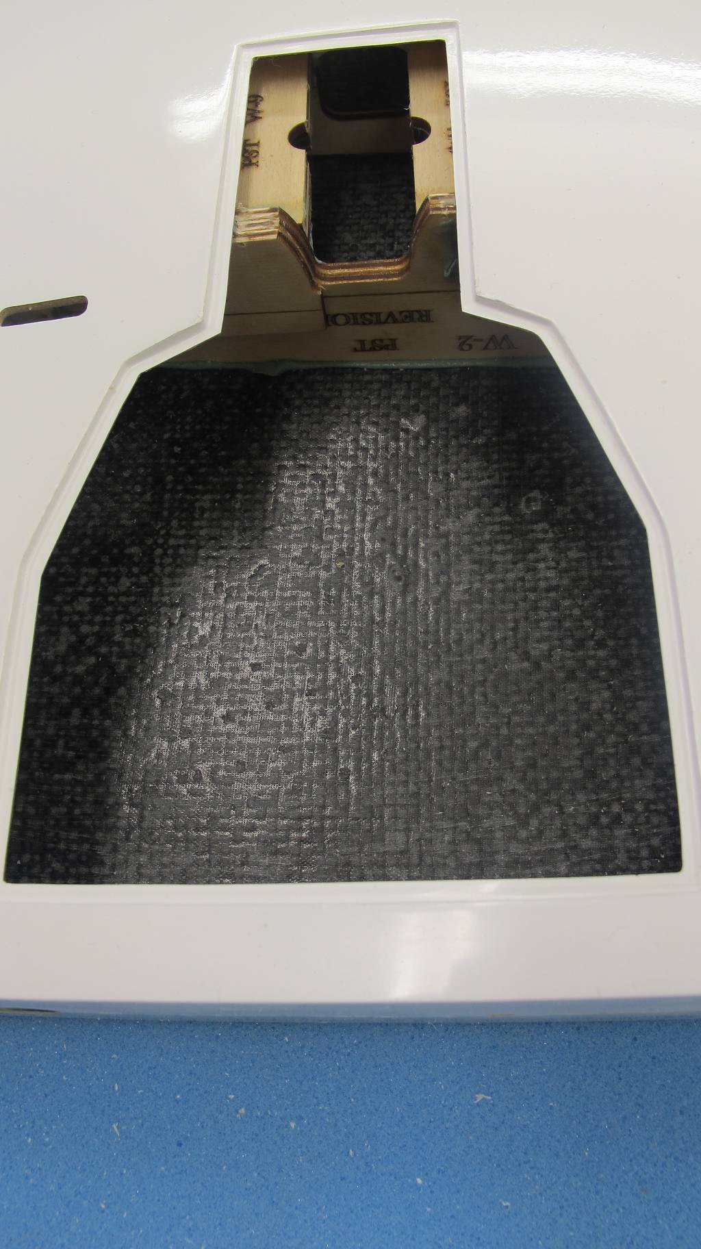

The hole for the flap servo needs to be enlarged, lengthened, to allow JR 8411 servo to fit.

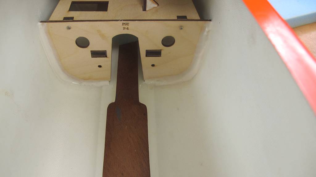

David hi,
I have a couple of questions if possible.
The forward CF spigot replacement,is it clamped as per rear main ali tube fixing or just pegged in so to speak?
On my Reaction I had four 123 2300 cells up front. Does the CG position require a similar weight load up front with the new turbine set up. I am using a 120 SX as on the Reaction.
I would be interested in your tail mounting servo connections as I have been thinking of mounting a horizontal Mutiplex plug between the tailplane plug holes to receive an opposing one in the actual tail plane unit to keep things up from the pipe. Plus maybe a thin blanket of ceramic cloth between the two. Have you made your set up removable for transit ?

In fact I used a screw at the front of the fin as per my SkyGate hawk PLUS the CF spigot, unclamped.
I have not yet balanced it, last job !
Everything is removeable essential for transport over long distances, sometimes by air, in Australia.
The power leads to the three tail servos are clamped to the fuselage side with a layer of ceramic heat blanket with an aluminium face (Wren supplied) There is a horizontal former (1/8 balsa) over the tailpipe at the rear lined with heat blanket to form a little compartment for the plugs. A similar arrangement works well on my AirWorld Hawks.

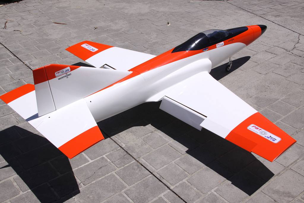

OK, mine is almost ready for flight test. A few notes:
To obtain the balance point, just forward of the aft limit, 1005 grams of lead was needed. The PST 1300 is slightly heavier than a JetCat with obvious slight reduction in nose weight when using the JC. Batteries in the nose are 1 x 3700 lipo and 2 x 2400 lipos.
Engine runs were perfect even though this PST 1300 has not been run for about three years. Starts and runs just like my newer 1300 which has had lots of trouble free flying in my Reaction. The PST bubble trap is quite excellent (its a strong tank and has large bore fittings) and one is going into my SG Hawk.
The fuselage adjacent to the pipe is very cool, almost zero temp rise in the little chamber I made above the rear of the pipe to house the stab and rudder plugs EXCEPT:
The fuselage adjacent to the engine nozzle got very warm indeed during static running (it should be no problem during flight with a flow of air through here) and I am going to put a layer of ceramic cloth in this area, about three inches long, just to be comfortable.
Checks of the air system revealed that the air bled down from 50 psi to nil in about 1 hour gear UP. This was traced to the wing coupling which was cleaned and lubed with BVM O ring grease. The air system now holds air pressure indefinitely, gear UP or DOWN.
Operation of the gear used very little air, pressure dropped less than 10 psi, and it would retract with just over 20 psi, extend with even less than that.
PST has made an outstanding job of the Revision, the quality is equal to the very best and vastly better than most.

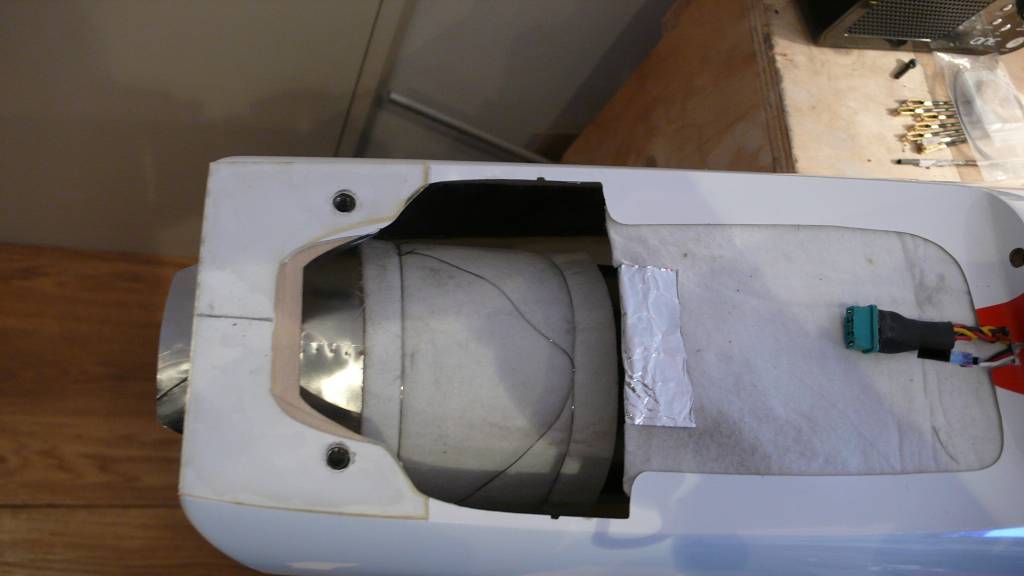

David,
I am in the process of insulating the turbine nozzle area with ali foil and it would be useful to know which side of the former needs the ceramic blanket. I presume it the top f the fuselage or is it all round.
Knowing this will save some unnecessary weight
Thank you
Regards
David
Thank you
Regards
David
Final checks done ready for test flying this weekend, BUT unlikely to happen due to heatwave here, 40 degrees today and forecast to last so testing is probably going to be delayed.
I have installed a ceramic blanket forward of the rear former, adjacent to the engine tailpipe, sides and bottom, so its a "wrap" of about 3inches. The hatch is lined with the supplied aluminium sheet.
I am sure that this is all that is required to protect the fuselage sides during ground ops.
Regards,
David.
Regards,
David.

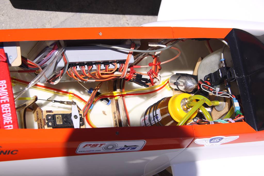

David,
Thank you for the info and I shall also do this now ,just in case !
I enclose a shot of my elevator servo solution with ceramic blanket. I hope the extra few grams will give me a large penalty up the front end when it comes to balancing.
I will cover the servos in ali tape as well.
I suspect your solution is better and maybe lighter but I cant figure it out from the description.
Hey 40 deg is hot and I am not sure I envy you quite that much heat. I only experienced 42' once in Ethiopia towards the Danakil depression and once is enough for a fair skinned guy like me I think.
Best regards
David

OK, pictures coming !
Many thanks for your kind offer, all we will need is fuel and a 12 v battery, I dont need gas as my JC 70 on the BobCat is kerosene start. Rick is bringing a Savex L39 with Wren 44. Really looking forward to meeting you chaps. I'd rather leave the Revision In Australia till its flown and has had a few shakedown flights.
More engine runs this morning and the insulation is working, the fuselage temperature adjacent to the nozzle keeps the temp way down and the insulation sheet inside the top of the rear cowl does its job, although as soon as the engine is stopped I will remove that cowl to help the heat dissipate.
The only other mods. I made were 1. to install a small tube to guide the Allen key onto the socket head bolt to secure the fin and 2, to delete the screws at the wing root and reopalce witha simply CF locating peg.
Final ballast: 850 grams.
After connecting the GPS unit to the Weatronics receiver, she's ready to go !

Any chance of a shot showing how you dealt with the elevator servo insulation. As I have shown above my solution but yours may be lighter a the tail end and therefore more preferable.

1) Is the plywood cradle the supports the fuel tank, and it appears that the underside of the fuselage may have been subjected to some force in transit ( as there are a few hairline cracks in the mouldings that are almost invisible )
2) The edges of the lower fuselage skin where the nose leg exits the fuselage and the rear nose gear former
3) The corners of the plywood structure that batteries attach to inside the removable nose cone.
It took me all of about 20 mins to run some hysol fillets and have these areas stronger than new. Looking at the way they have broken away ( Wood has started to peel away from the glass, with the adhesive sticking to just the ply) I cant help but think that if the factory were to scuff these areas that it would improve the bond considerably.

While the hysol was setting in these areas, I started to paint pretty much all of the fuselage and wooden internals in 2-3 coats of primer. This was under the instruction of the customer. I had done this to a Skymaster L-39 that he also ended up owning and he liked the aesthetic of the finish. I did it on the L-39 as the internal lay up of the composite work was quite messy. The primer gave a much neater and more uniform look. On the Revision there really was no need. The layup is so neat and tidy, the bonding fillets so smooth as clean that its almost a shame to cover it up with primer..... But, the customer is always right!
I decided to hand brush the primer, which in retrospect was probably not the quickest way, but I just couldn't see how I could spray inside all of the knooks and crannies without the primer running. It took me about 6 hours to apply this primer to everywhere forward of where the turbine sits. I am sure I could have got allot more done in that 6 hours, but hey ho!
Here is the shot of the rear compartment which houses and protects the tail servo connectors. The Platform is just 3/32 balsa sheet
supported on two light ply cross pieces. Foil faced ceramic sheet glued on.

David,
thank you for the photo, " I can see clearer now" in the words of the song.
I agree whole heartedly about the landing gear it really is very high quality. I suspect a few will have their eyes on this for installations other than the "Reaction".
Regards
David
