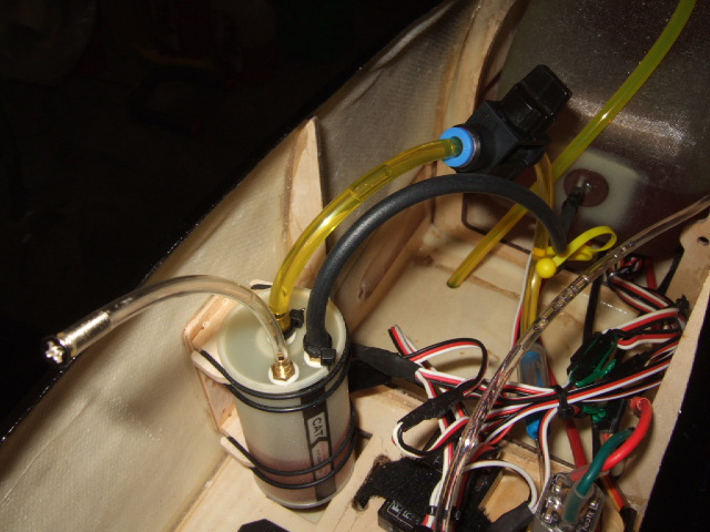

Hi all,
I would appreciate some help and advice.
I tested my JetsMunt VT80 for the first time and wow! what a great turbine.
I primed the fuel line and the turbine started without any problems. The turbine was running for a short while until I noticed a lot of air bubbles, so I shut the turbine and let cool down.
I noticed the UAT tank was only half full (or empty
and was not filled up by the main tank.
I don't understand this as I fill the main tank through the UAT tank.
My setup is as follows:
Main tank has a vent tube (exiting through the bottom of fuselage) and a tube to the UAT tank.
UAT tank has a tube to the pump and a filler plus the tube from main tank
When I fill the tank I see that the UAT is filled up to the top and then that main tank gets filled. I have no air in the system.
As I mentioned I started the turbine and the turbine was running until the UAT tank was down to half full and then bubbles appeared (probably that is where the clunk sits)
Maybe I am missing here something stupid but why is the fuel not drawing from the main tank to the UAT? The main tank is filled through that tube.
I hope you understand my problem. Sorry if I can't explain it better.
Any advice and help would be appreciated as usual.
Ulrich

Hi Ulrich
For straters try these:
1 - Do not use a screw in the fuel fill line. Threads will allow air to get in.
2 - Change the tygon tubing for PU. DO Not use tygon pluged in Festos
3 - Change the Festo filter. They tend to brake and let air in. Keep using the filter and manual valve in the pressure side.
4 - Make sure there are no restrictions and filter in the clunk
Regards
Nuno

Hi Uli,
Welcome to the world of jets! Your CAT (its not a UAT) is drawing air in somewhere. The first thing to check is the cable ties round the black tube between the main tank and the CAT. These are a bad idea as there can be a small gap where the ends of the tie meet which can allow air to be drawn in between the OD of the solid tube and the ID of the flex tube. Replace these (and I would do the outlet side of the CAT too) with stainless tie wire wrapped twice round the tube before twisting off.
Next thing to check is your clunk and clunk line inside the main tank. Is it a felt clunk? There is no problem with these provided they are clean and you use well filtered kero (fit a couple of filters in your fill line from your kero bottle outside the model) but if they get dirty they clog and the pressure drop across them will accentuate any air leakage into the clunk tube and the tubing from the main tank to the CAT.
Lastly I would check with Marc at GBR Jets that it is OK to mount the CAT vertically. It may be that your air margin is reduced by doing this as the pleated element in the CAT may uncover sooner. Marc will let you know.
Also I wouldn't personally have a shutoff valve on the suction side of my pump. This is another source of air into your fuel system but it isn't causing the air in the CAT. I would re-fit it on the pressure side of the pump - but you must remember to open it before starting!!!
Hope this helps.
Malcolm

Hi Malcolm, Hi Nuno
thanks for your advice. I really appreciate it.
With regards to the shut off valve.
I consulted several forums and people were discussing where to put the shut off valve - on the suction side or the pressure side of the pump.
Opinions are quite divided between the two. I decided to put it on the suction side as on the pressure side I am not sure how much pressure the pump would generate in the case of shutting that valve.
I only know I don't want to run the turbine without a shut off valve.
With regards to the CAT tank.
I thought it is an UAT tank. Anyway, the manual actually states that you should (if possibly) mount the CAT vertically as it makes sure that no air is in the tank.
The screw in the fill line I will definitely replace.
The clunk in the main tank is kind of ceramic material but was recommended for turbine use.
I will also replace that black tube from the main tank.
I am sure I will get the problem sorted. Must be a simple plumbing problem.
Thanks again for your help.
Ulrich

Hi all
that was a quick and easy fix. I think I got the problem sorted.
It was indeed the screw in the filler line and I replaced it with a short rod.
I filled up the tank and started the pump running the fuel into a canister. After several minutes still no air in the line, CAT full up to the top.
Great result. Thanks again for your help.
Ulrich

How good is RCU?? Almost instance response to help you trouble shoot your fuel system.
I agree that a UAT or a CAT is not always necessary, and a lot of people successfully operate a turbine with out one.
However, look at it this way. If you did not have a CAT fitted, you may never have picked up the air leak that you already had. So your CAT has already done a sterling job for you.
I am in favour of air traps. I make it a habit to check my UAT after every flight. If the air bubble is excessively large, this is a sign that a air leak may have developed up stream. They also make a great final filter..
Roger

I friend of mine had your type bubble trap in an airplane that constantly would flame out due to air.
The CAT which is a product designed to help prevent air entering the fuel feed to the turbine (via the pump) has been successfully used for the last 12 months on the NASA/Boeing joint project - X48C. The units were tested to the limits before they were approved for use in a multi-million $ project and I am certain they would have not used them if there was a chance they were no good!
Whilst there is always a chance products do not work for all there are some real important things that must be done to ensure any fuel related products stand a good chance of delivering 100% reliability -
USE QUALITY CORRECT BORE TUBING
SECURITY WIRE ALL FITTINGS - DO NOT USE CABLE TIES (as the name implies they are for use with cable not fuel line)

Have you ever seen posters that ask you to pick out all of the safety hazards. They are usually funny to look at and interesting to pick out all of the unsafe hazards.
This photo kind of reminds me of them. You can see multiple no-no's for fueling a jet.
Tie wraps on connections
no safety wire
Threaded bolt as a stopper.
Festo on the suction side
You can even add items like ensuring all connections are in good condition. I have seen where someone has used a knife to cut off an old fuel line leaving a score line in the barbed connector. The score line works like a channel for a leak to occur.
Marc's comments above are right on the money!! Good points for doing a proper fuel system install.
no safety wire

just wanted to say that I had the turbine running again and with absolute no problems at all.
I can't see any air bubbles at all and the only thing I changed was the screw in the filler line.
Nevertheless I am taking on board all the advice and will replace the tie wraps although I can pull very hard without the tubes to come off. (and I mean I can pull very hard)
