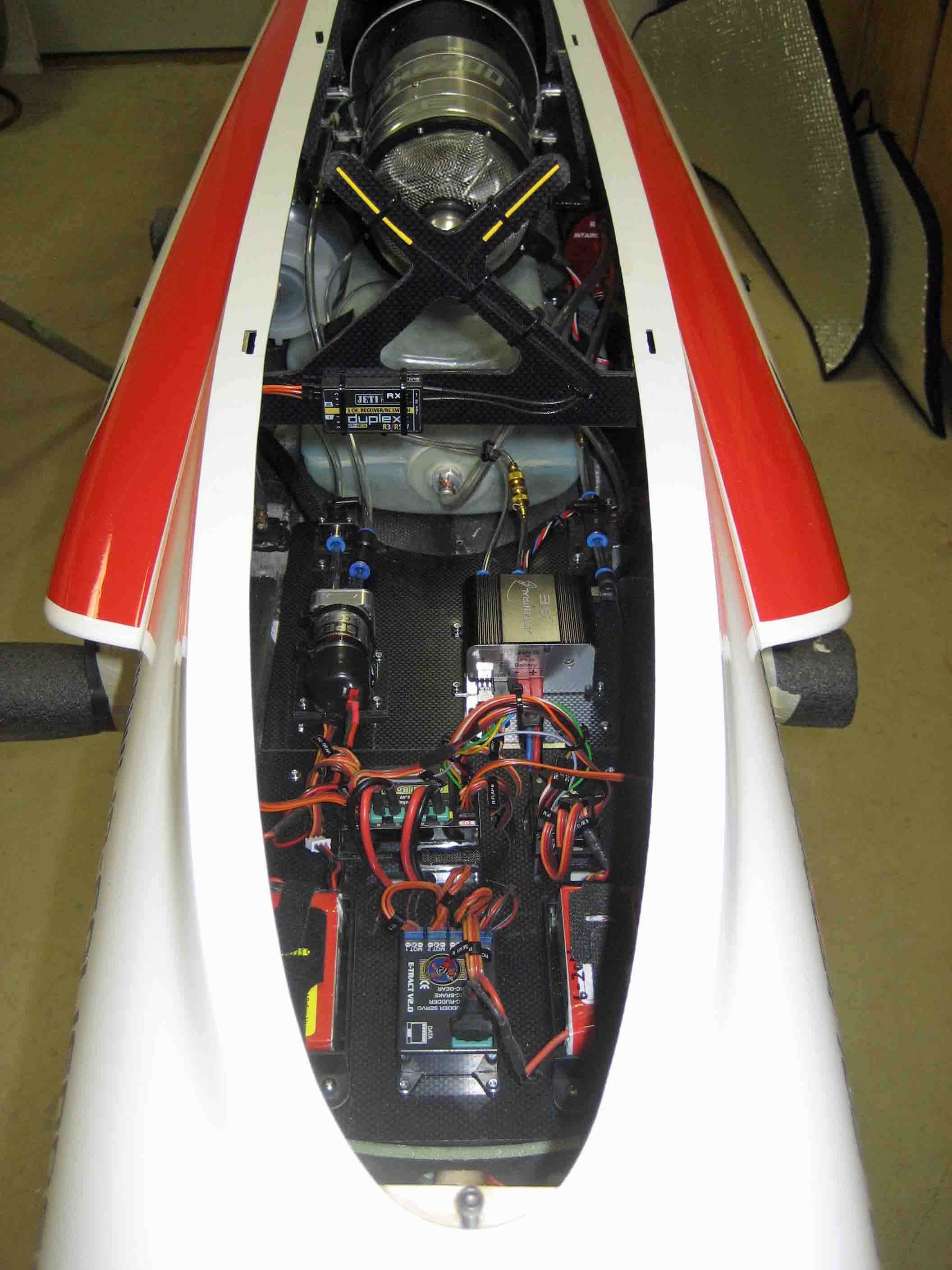

Hello Eagle Driver,
I must say its a top notch pro work. Congratulations!! Have few questions:-
1. How many and what Jeti receivers are you using?
2. Is this Gyro which you have installed speed gain assisted?
3. What you think about PB Mercury SrS with Speed Gain Assisted? Would that be as compatible as Jeti Box 200 with the Jeti receivers?
I need to know because I am shifting from 18MZ to DS-16. I was using PB SrS stuff with Futaba receivers but never had an issue untill I had few glitches while using R7008SB with telemetry on. Heard Jeti is glitch free so far

Hello haisanjafri,
thanks for the compliment.
Im using a Jeti CB200 with two satellites Rsat 2 EX.
The gyro is a GyroBot 900 Wing Jet, it measure the true airpeed with a pressure tube.
I saw the mercury first time on a model fair last weekend, it looks nice and well made
but i have no personal experience. Yes it will work with two Rsat like the Jeti CB200.
I use my Jeti DC16 and all the Jeti stuff since 2009 and never had any issue.
regards Steven

Thanks for the help Steve. I did some research. The BEC you used supplies 6V to servos whereas we now have 7.4V servos. So what Jeti offers to achieve that?

You can connect 7,4v batteries direct to the CB200 without any regulator,
so your complete system is up to 7,4v. CB 200 has no regulator inside.
I have maybe 25 brand new Hitec 7955TG Servos which i use in this plane,
thats why I use the MaxBec 2d plus.
The small piece left from CB200 which looks like a Rsat is a Jeti rc-switch.
regards Steven

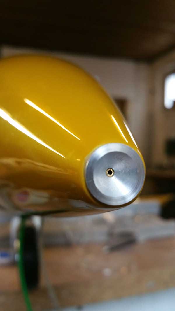

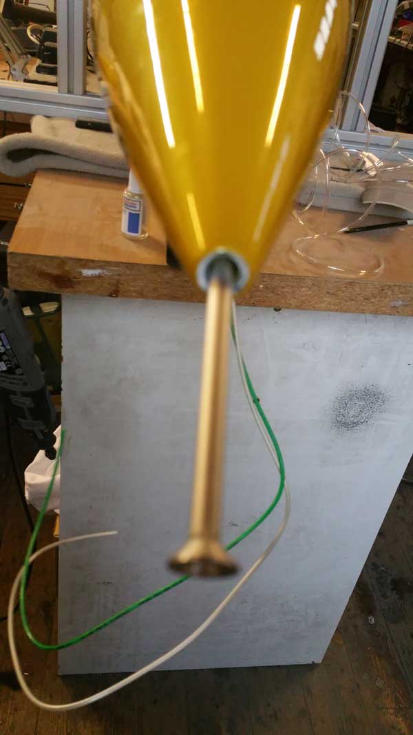

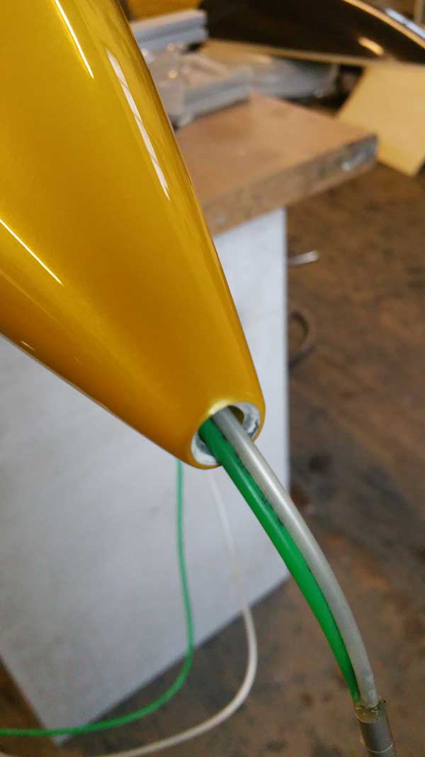

Here you can see the gyros pressure tube installed in the nose
have fun with your futura build .....
Im on a bad a.. UL now ;-)

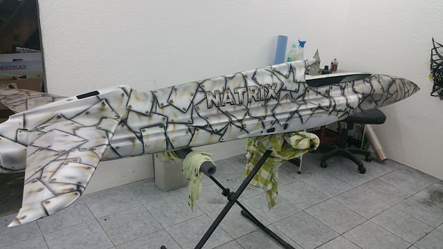

Natrix Nr.4 .....
with a slightly different scheme

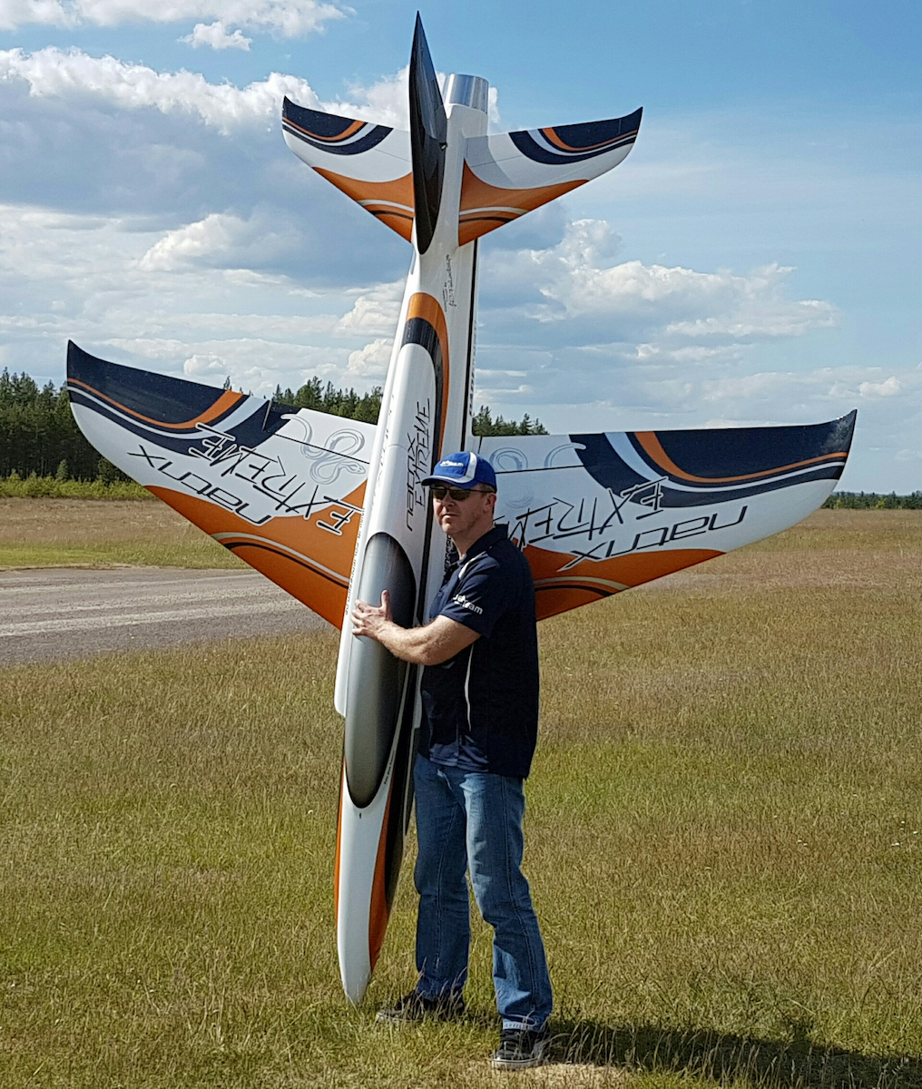

Finally got my Natrix flying after 5 weeks of building & installing. What a VERY nice plane! Good job Paritech!
B300F turbine, Powerbox Mercury SRS with two Futaba R7006SB receivers, 6,2 liters fuel plus large CAT,1,5 liters smoke oil plus large CAT on that too. Dry weight a bit high 19kg because of the large turbine and quite large LiPo's, still flies very light even full of fuel and smoke oil. Haven't tried full throttle level flight yet, but climbs nicely with 30+kg's of thrust.
Flaps are very effective, landings are easy. Knife edge slight coupling to bottom side, very little in fact, no aileron compensation needed. Don't know exact CG, 380-390mm range I suspect. Very neutral behavior, minimal down elevator needed in inverted flight. Had six flights with gyro turned OFF, next time out setting that...maybe some video too...

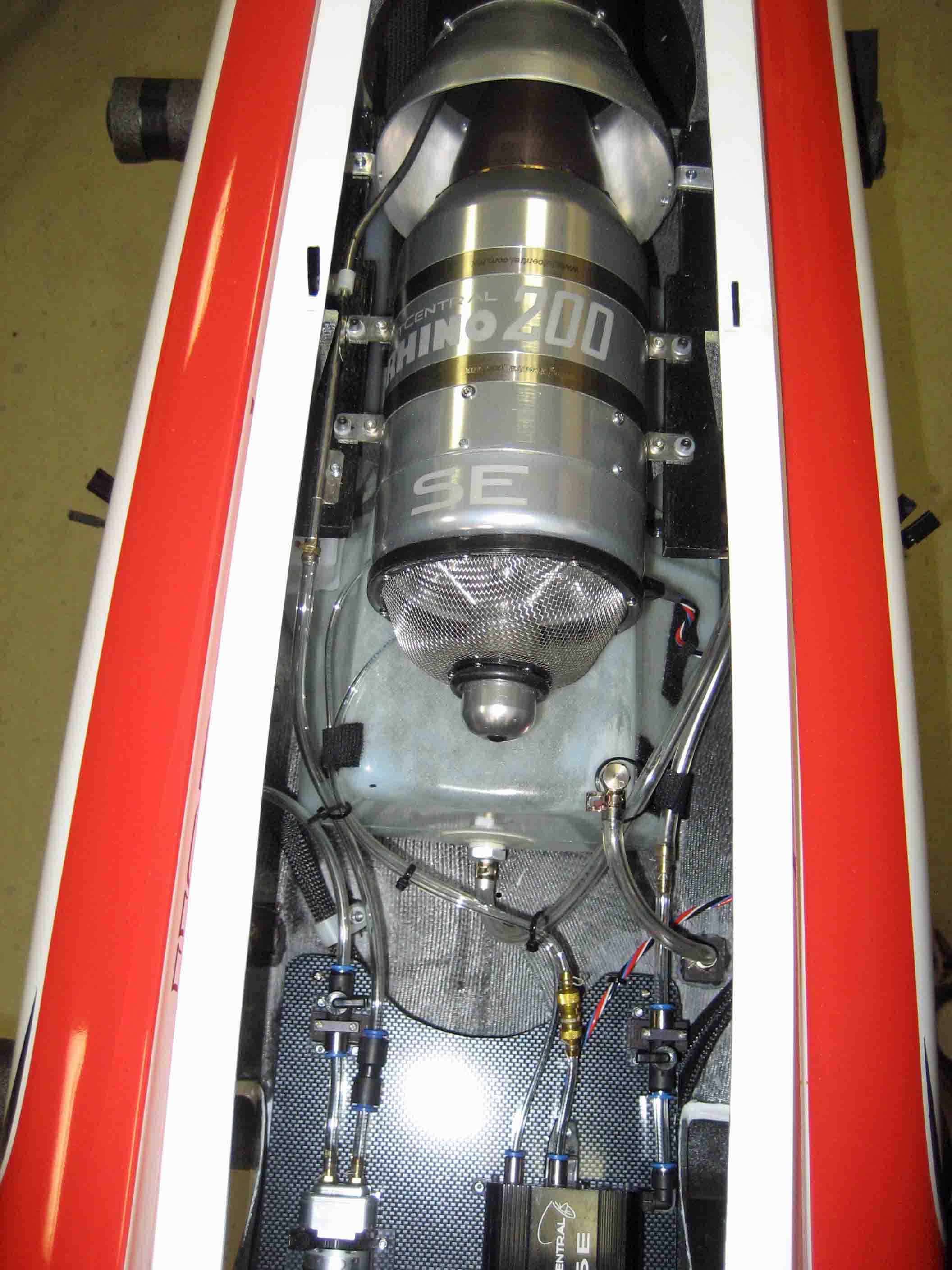

Finally maidened my Natrix today. Wow, what a really nice flying jet! Minimal trim with the CG at 380mm and super clean rolls. Mine came in at 40lbs (18kg) dry with a smoke system installed. In addition to the Natrix it was also the first flight for the following:
- JetCentral Rhino 200. Ran flawless and with unlimited vertical.
- Jeti DS-16 with Central Box 200. Worked perfectly and felt great in my hands. Love the turbine telemetry.
- Behotec electric retracts. Very strong, worked perfectly.
Thanks to Scott Foster (Berthoud) and Eagle Driver for the helpful information provided in this thread!
