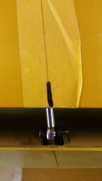

Old 11-09-2015 | 04:30 PM
  #28
Eagle Driver's Avatar
Joined: Sep 2008
Posts: 640
From: Vulkaneifel

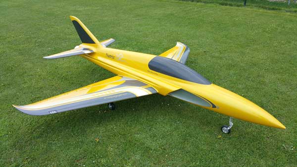

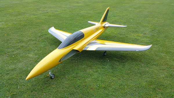

Thanks Scott .....

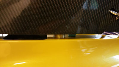

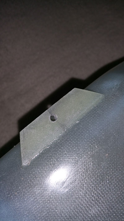

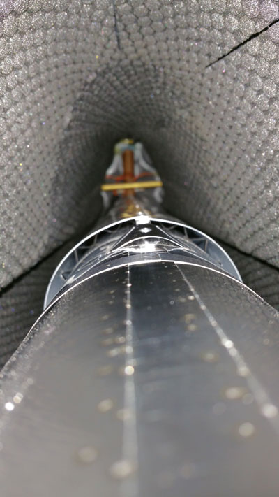

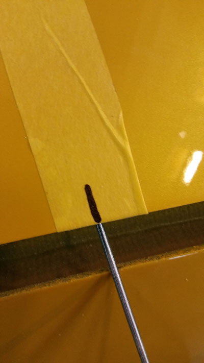

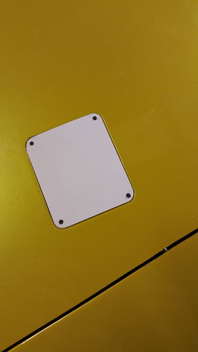

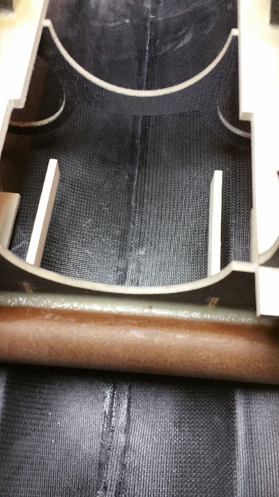

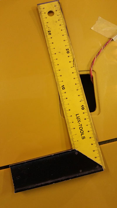

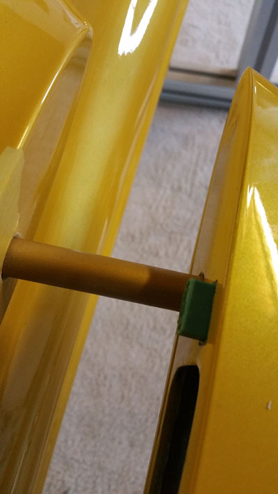

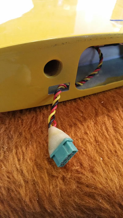

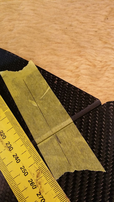

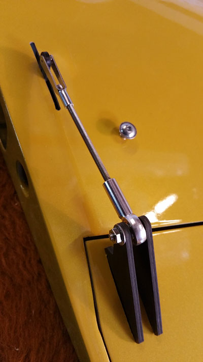

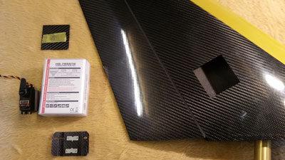

380mm for the CG is a good Point to start, 390mm looks perfect

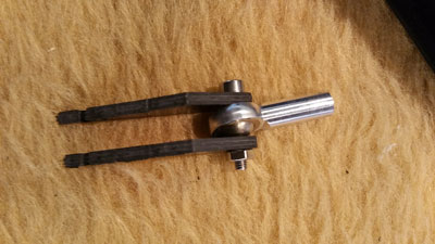

I also changed a few points during the build process but let the pics speak for its self.

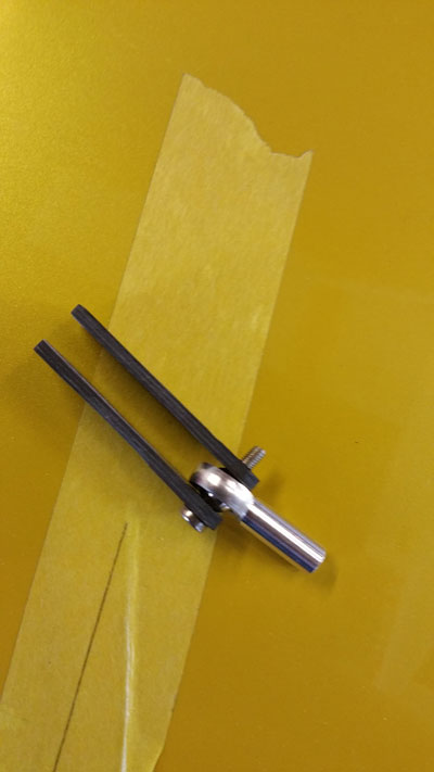

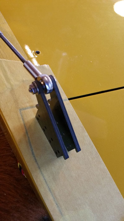

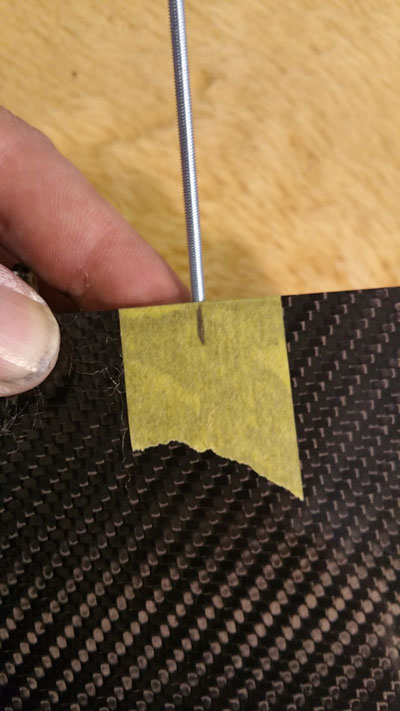

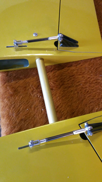

Starting with the elevator .....
Elevator finished but i have to build 3

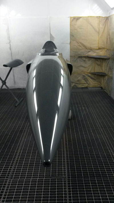

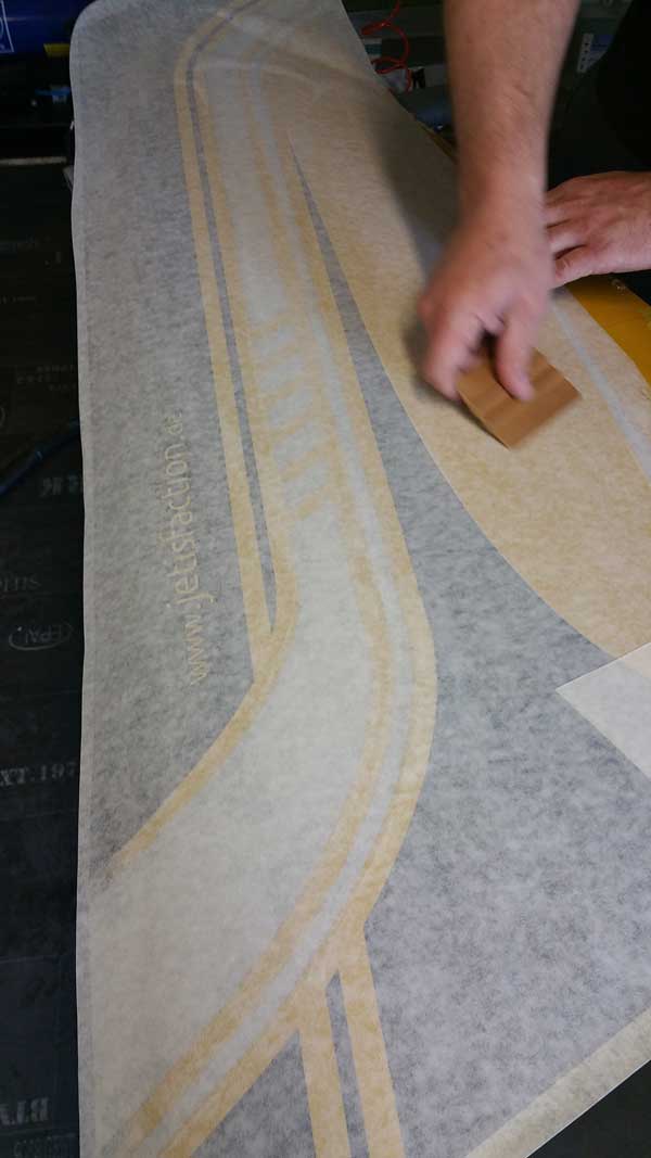

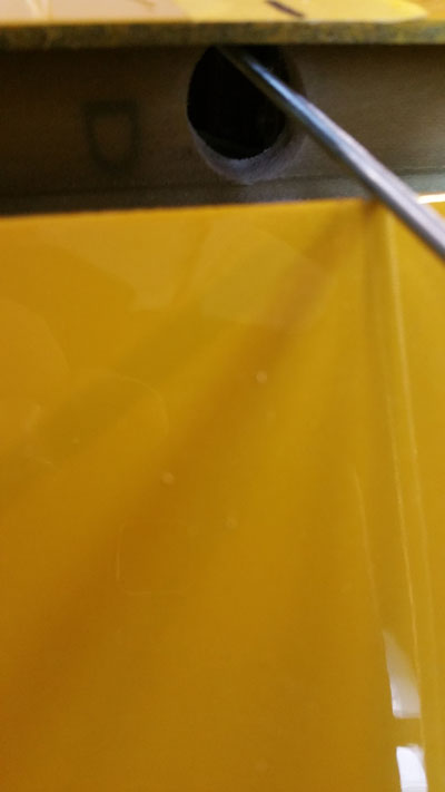

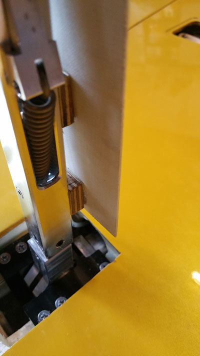

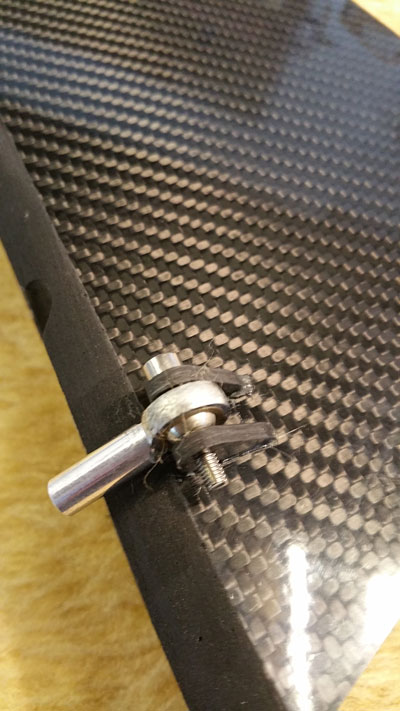

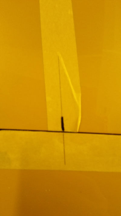

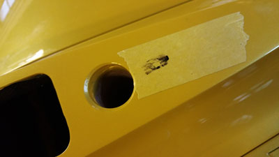

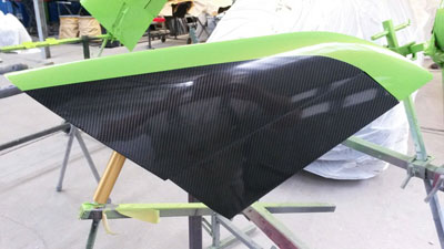

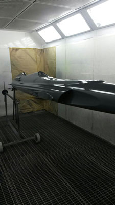

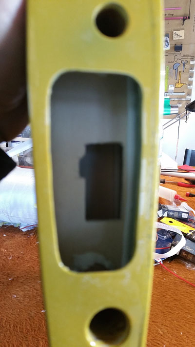

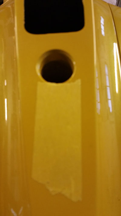

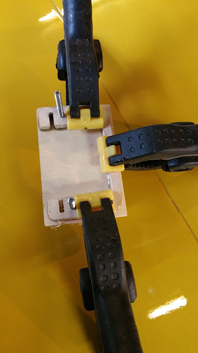

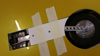

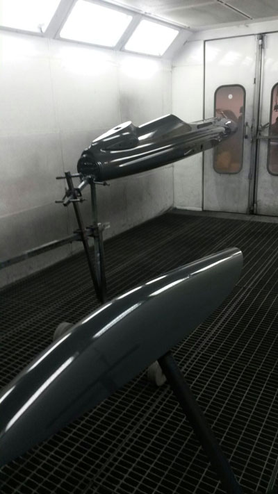

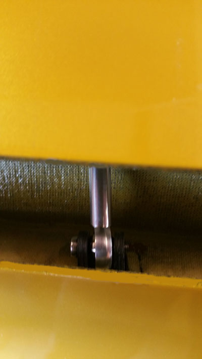

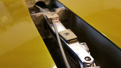

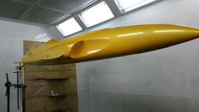

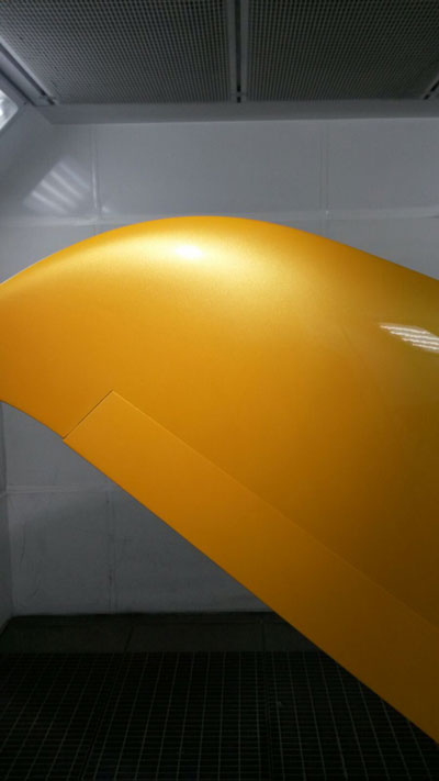

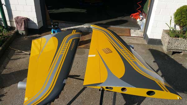

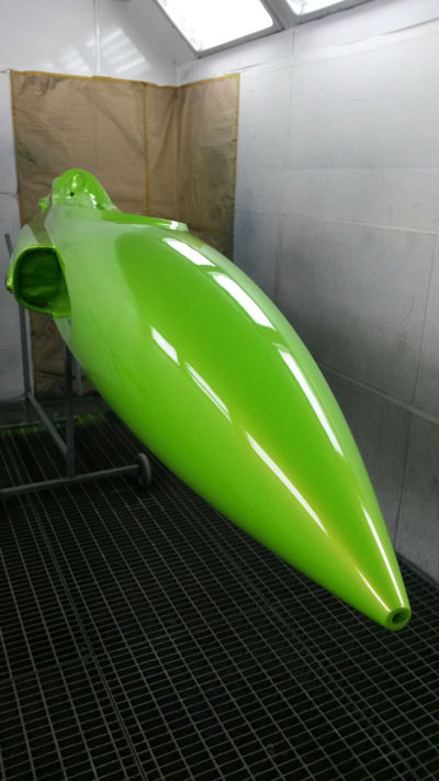

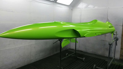

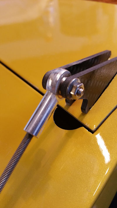

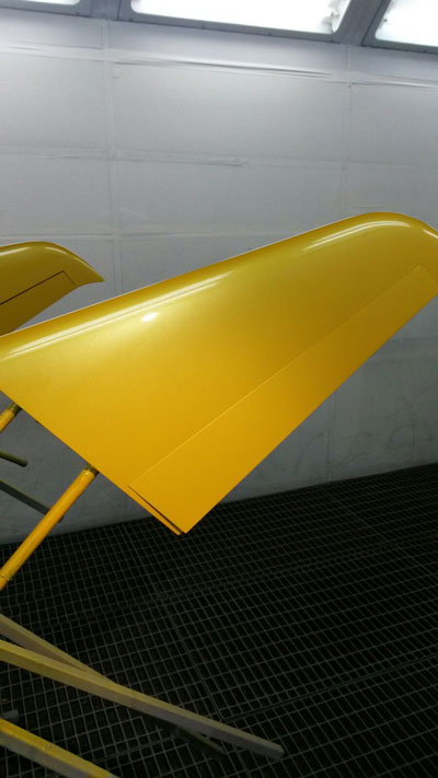

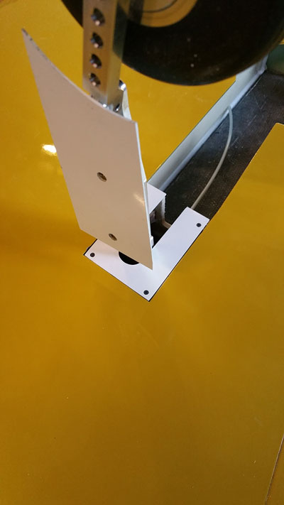

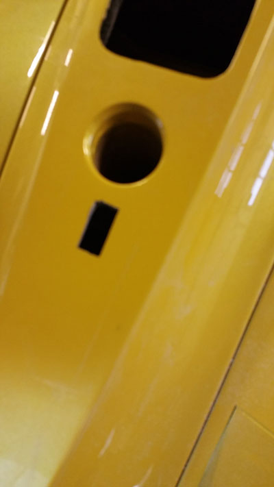

Today i build the Rudder .....
if anyone have any questions pls feel free to ask
and a few shoots out of the spray booth .....

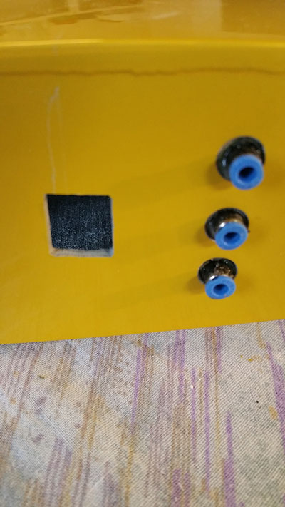

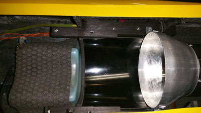

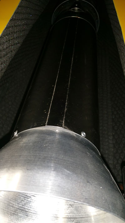

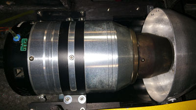

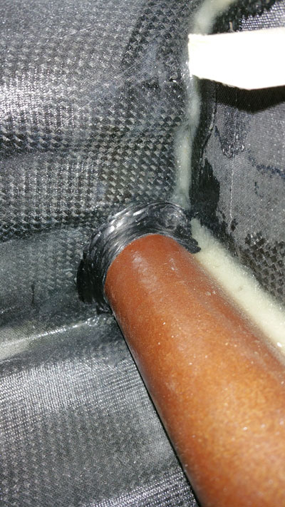

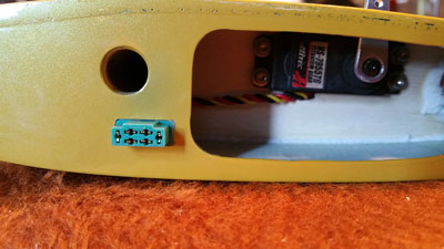

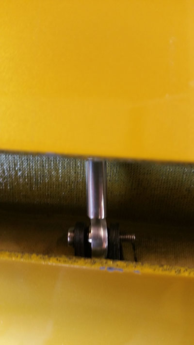

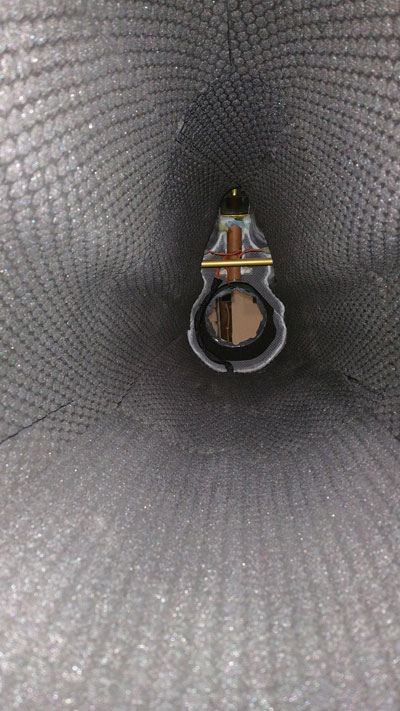

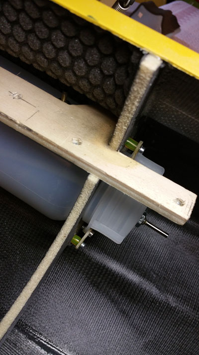

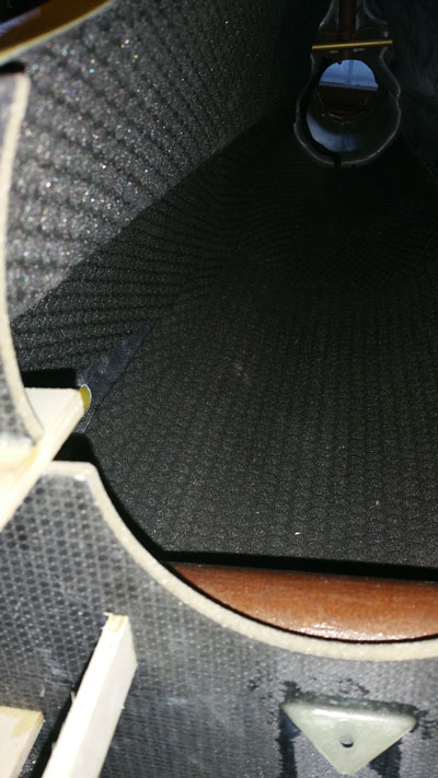

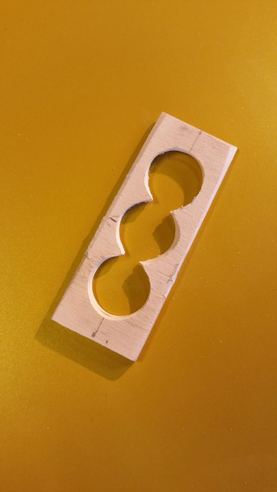

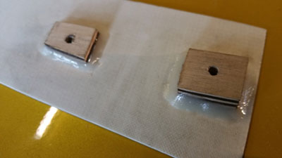

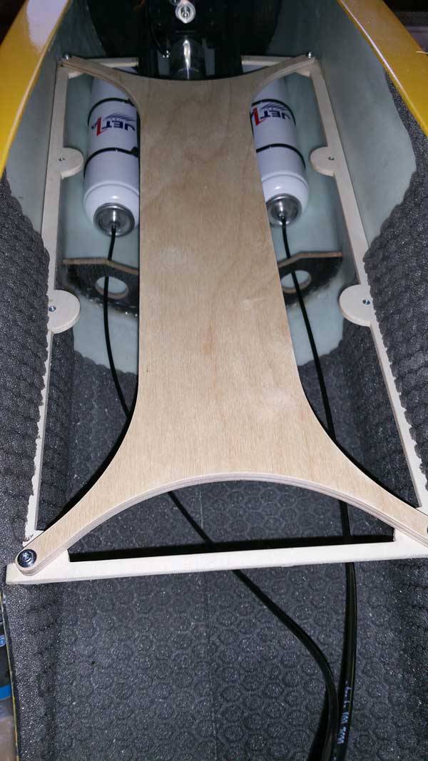

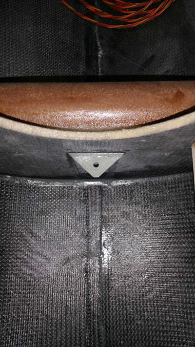

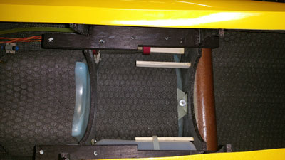

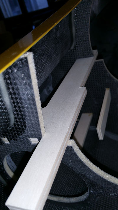

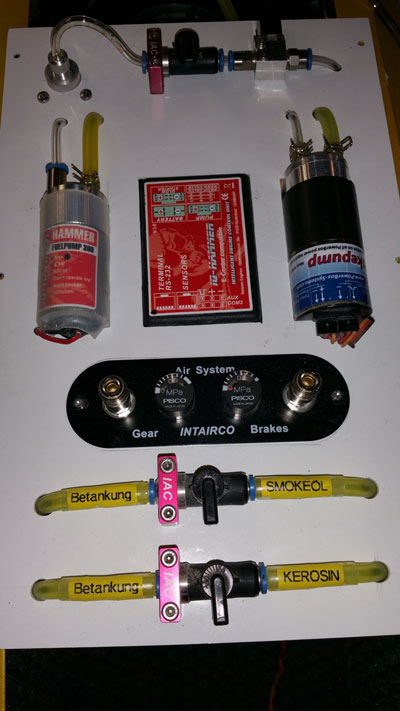

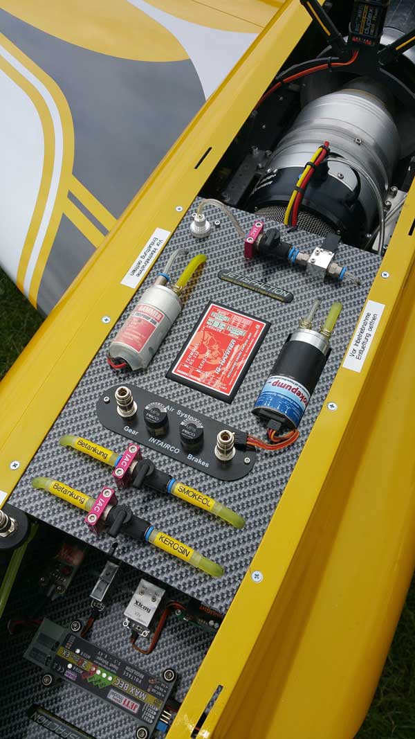

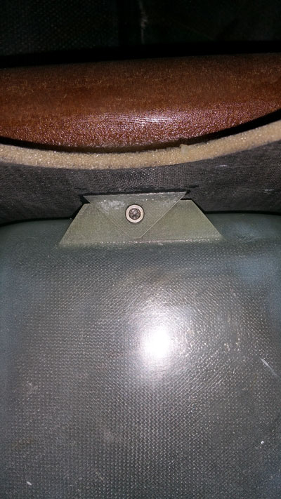

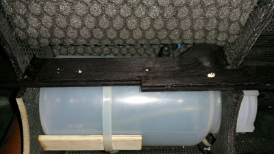

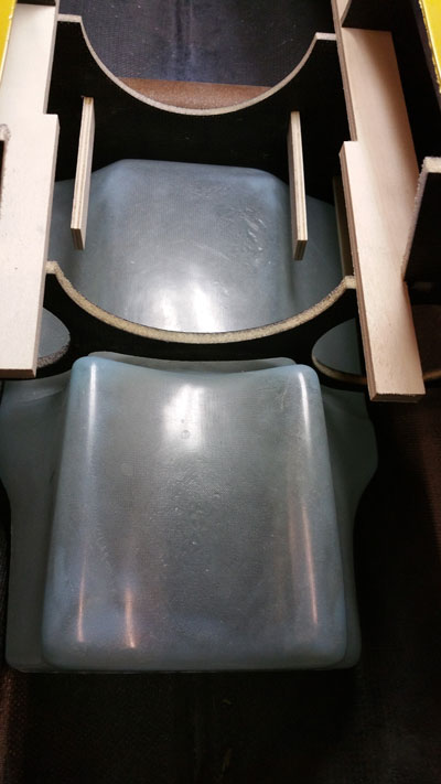

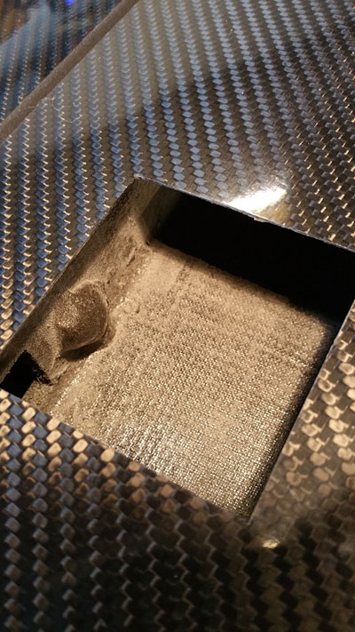

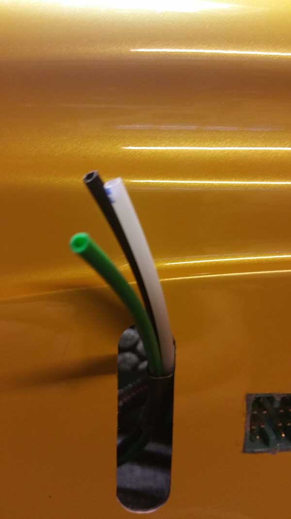

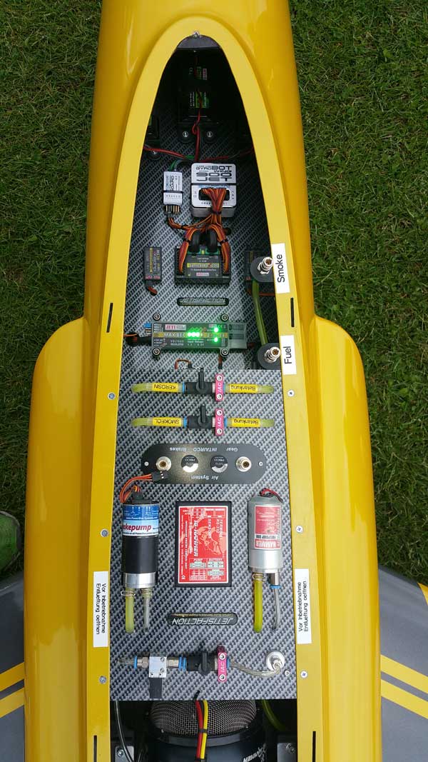

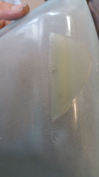

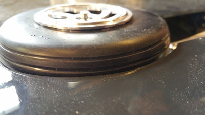

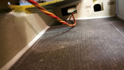

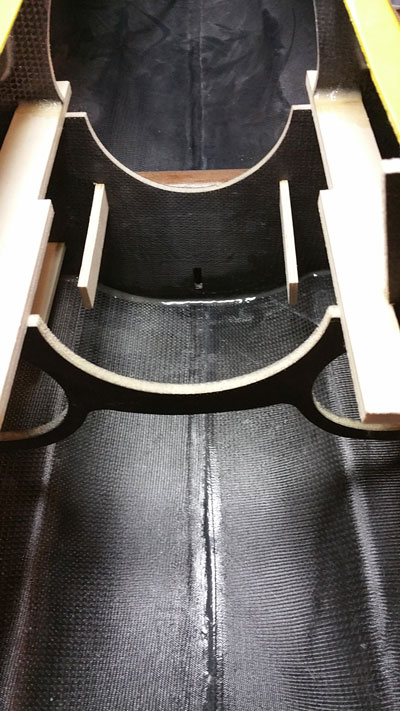

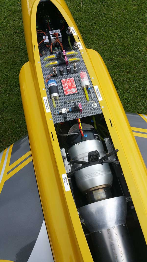

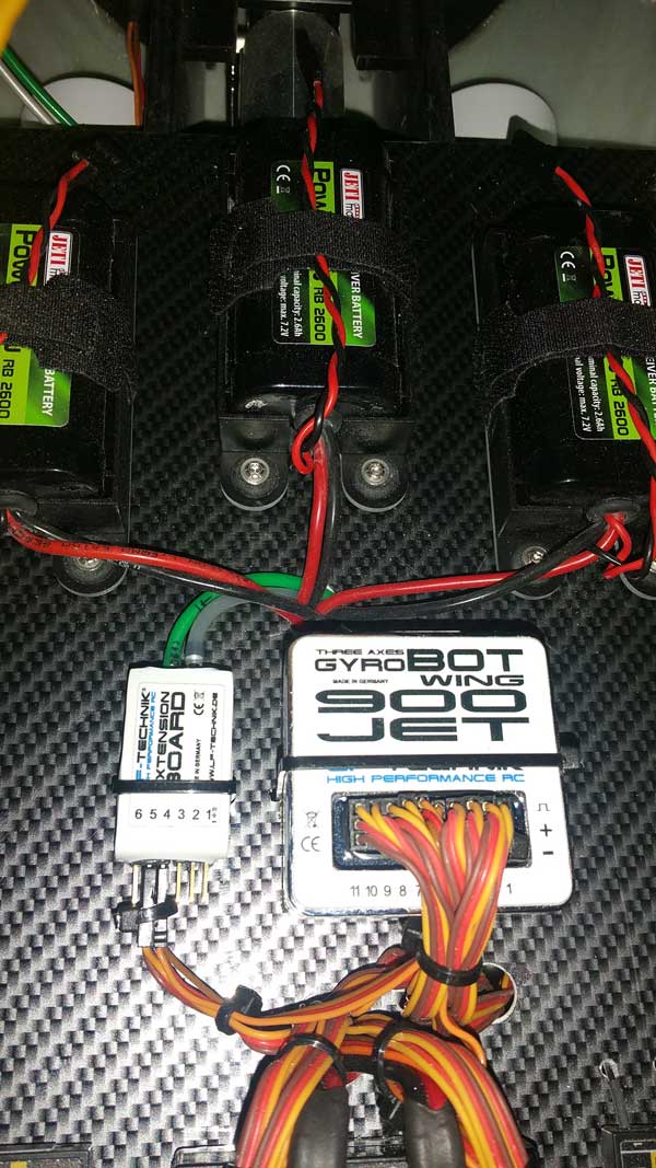

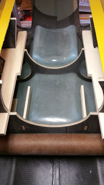

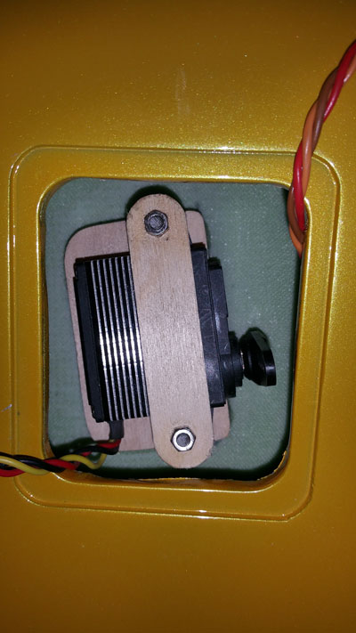

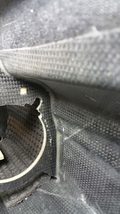

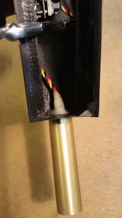

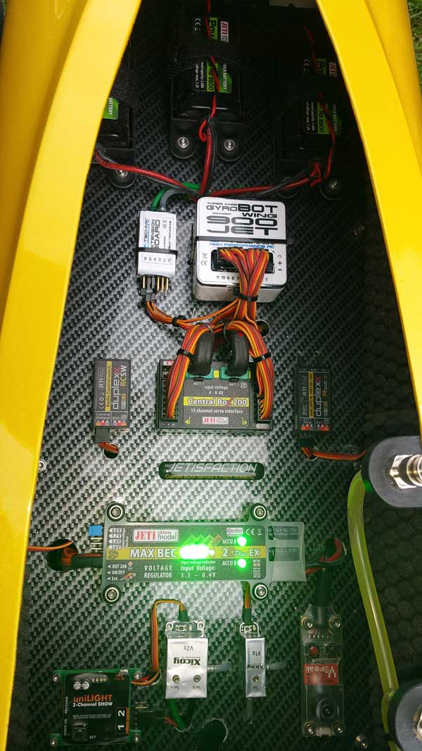

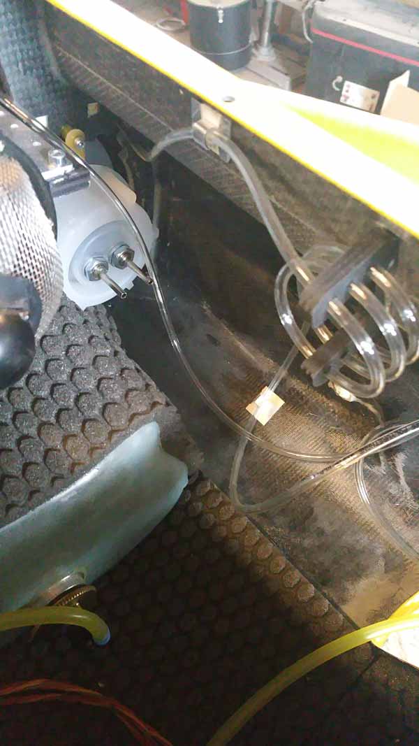

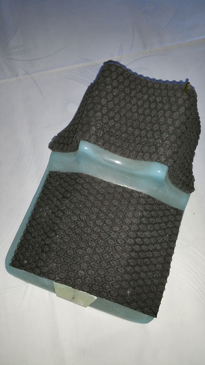

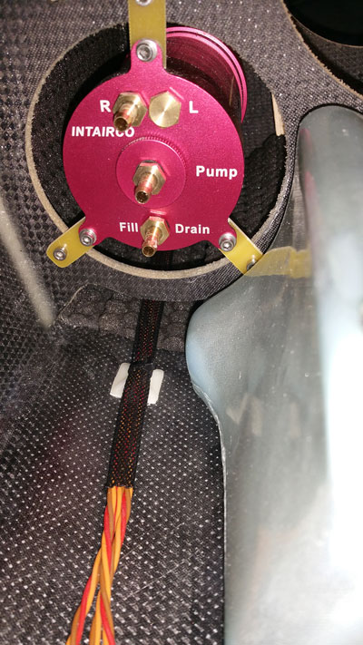

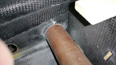

Today i glued some formers in the fuselage and installed the tank System .....
ID:	2130273   Click image for larger version
ID:	2130274   Click image for larger version
ID:	2130275   Click image for larger version
ID:	2130276   Click image for larger version
ID:	2130277   Click image for larger version
ID:	2130278   Click image for larger version
ID:	2130279   Click image for larger version
ID:	2130281   Click image for larger version
ID:	2130282   Click image for larger version
ID:	2130283   Click image for larger version
ID:	2130284   Click image for larger version

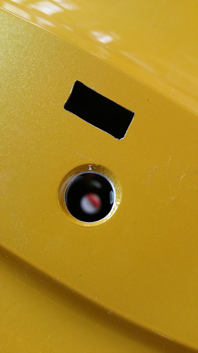

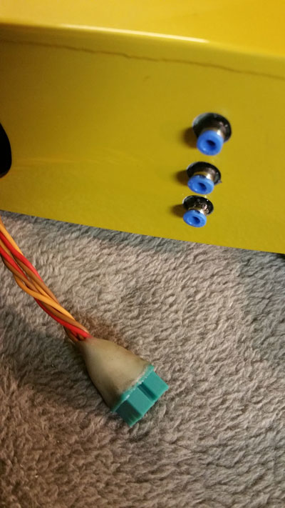

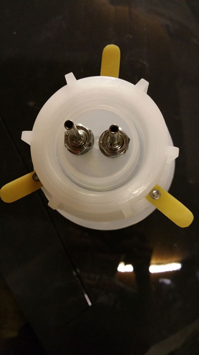

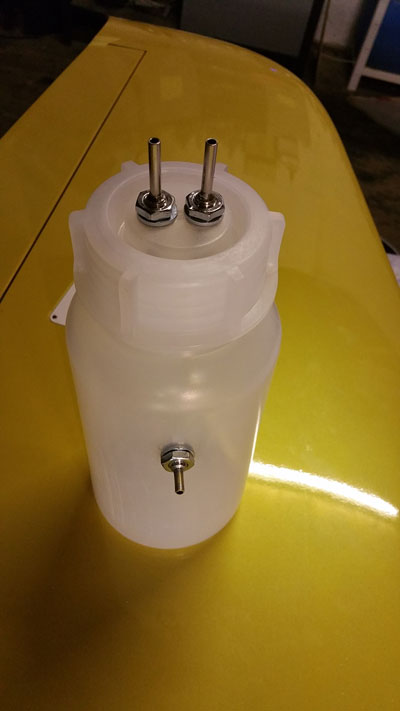

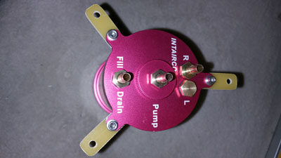

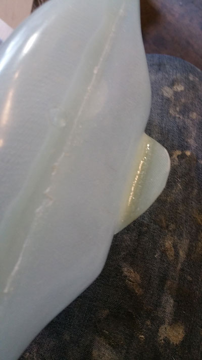

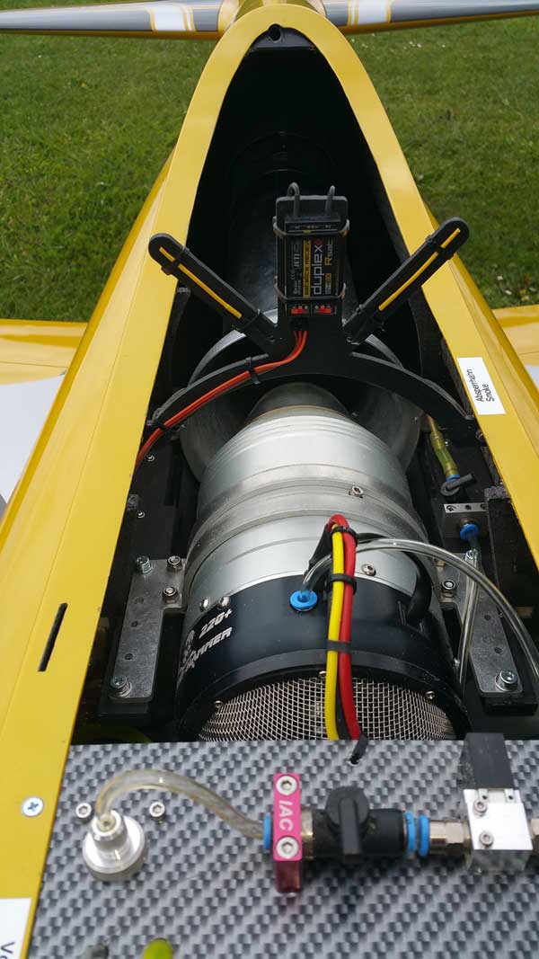

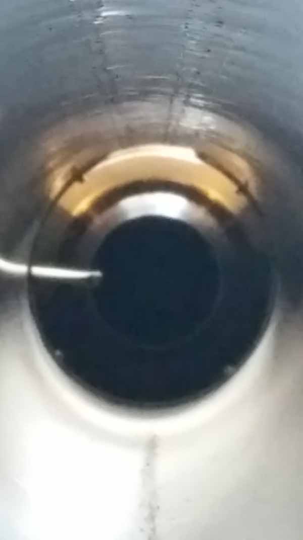

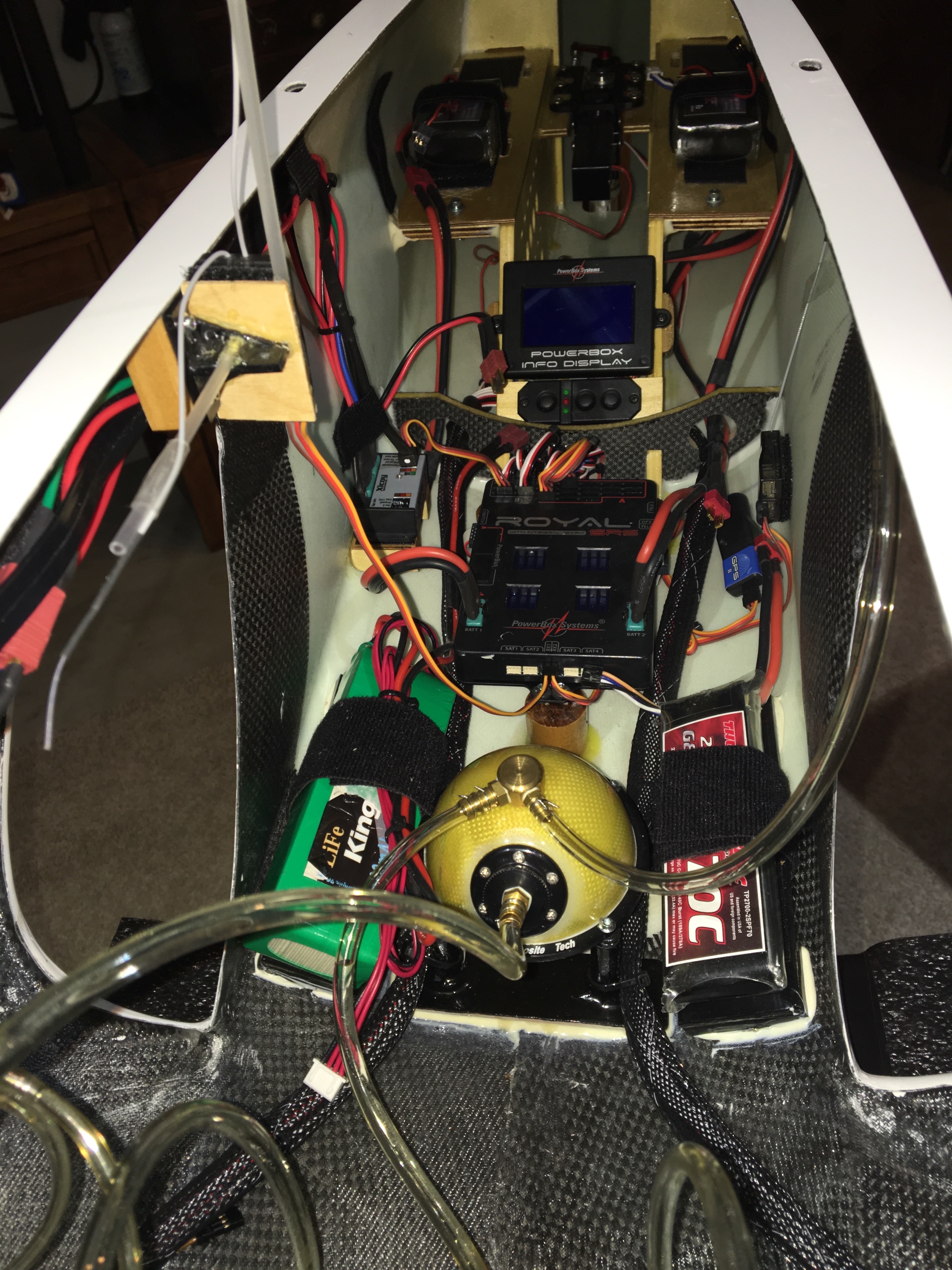

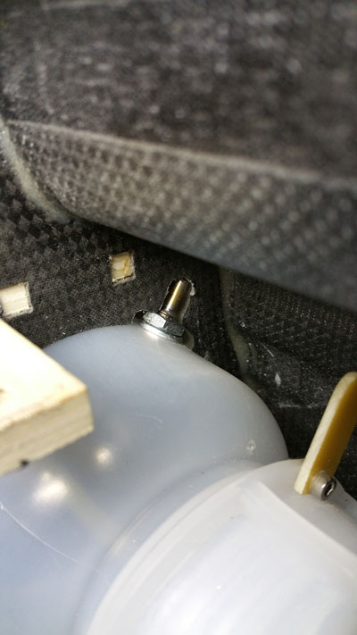

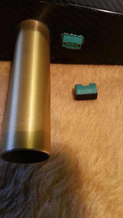

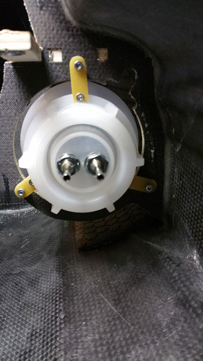

and i assemble the Smoke Tank .....
ID:	2130286   Click image for larger version

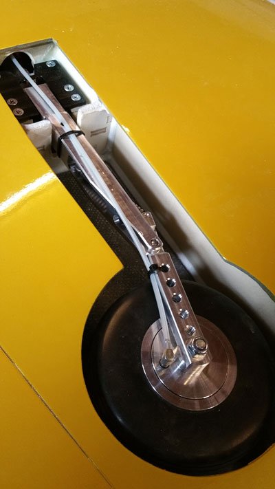

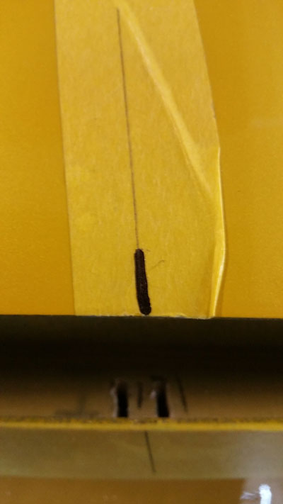

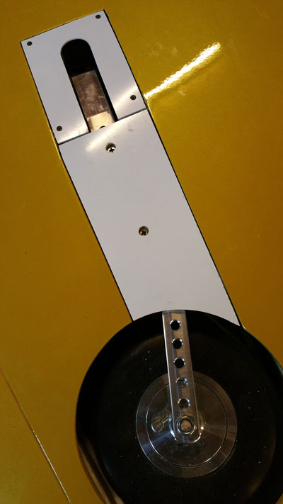

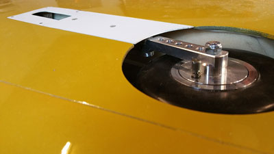

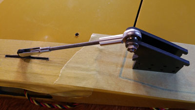

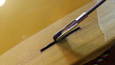

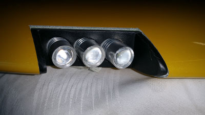

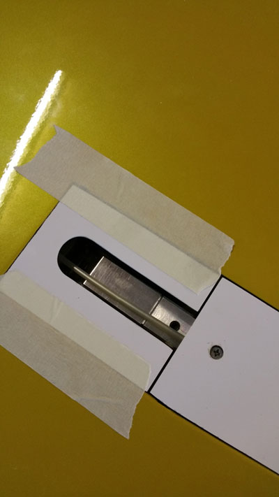

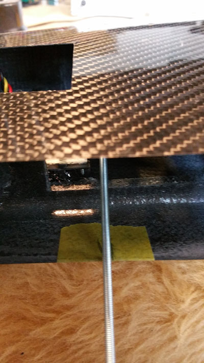

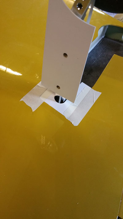

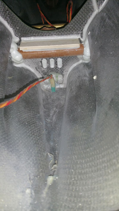

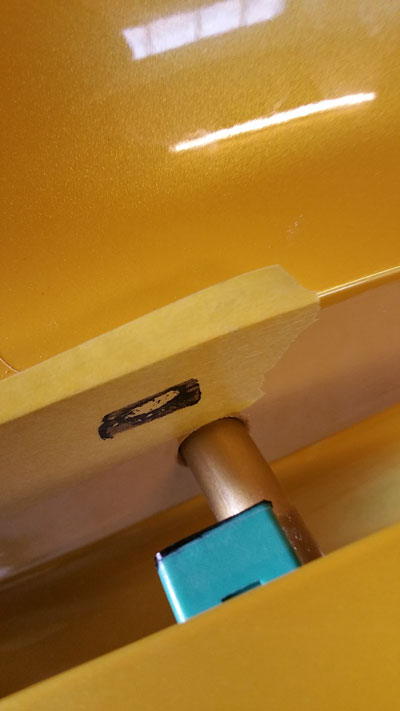

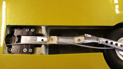

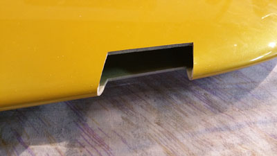

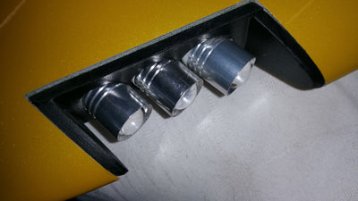

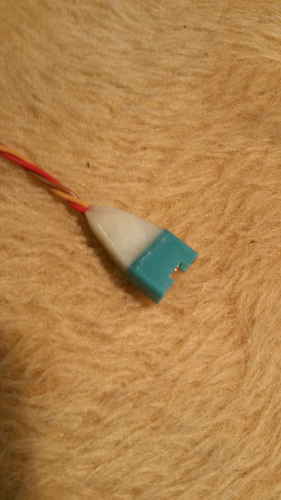

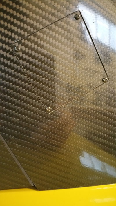

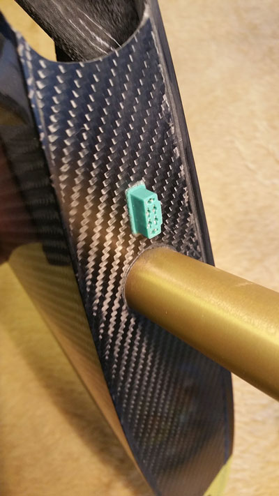

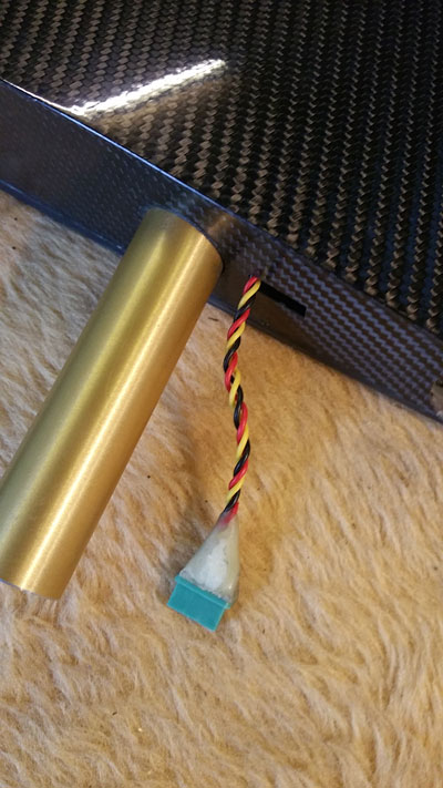

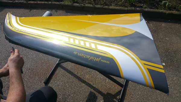

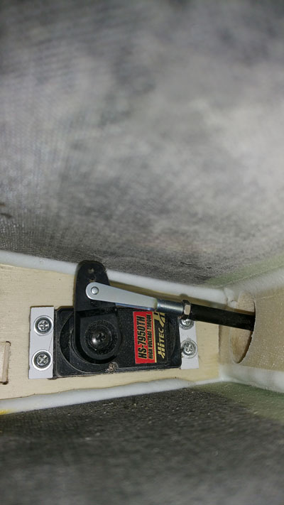

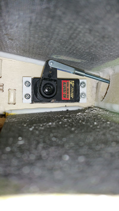

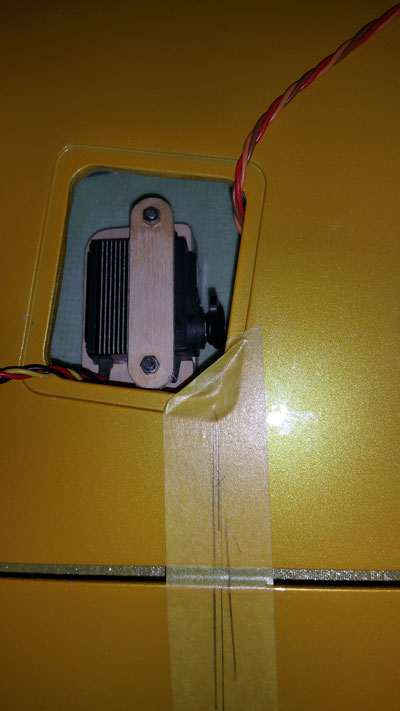

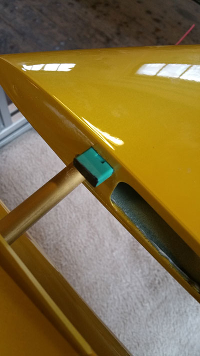

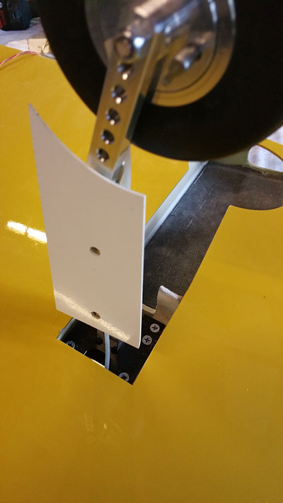

Cant sleep last night so i finished the flap install .....
ID:	2130355   Click image for larger version
ID:	2130356   Click image for larger version
ID:	2130357   Click image for larger version
ID:	2130358   Click image for larger version
ID:	2130359   Click image for larger version
ID:	2130360   Click image for larger version
ID:	2130361   Click image for larger version
ID:	2130363   Click image for larger version
ID:	2130364   Click image for larger version

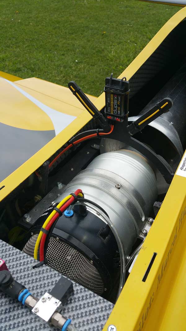

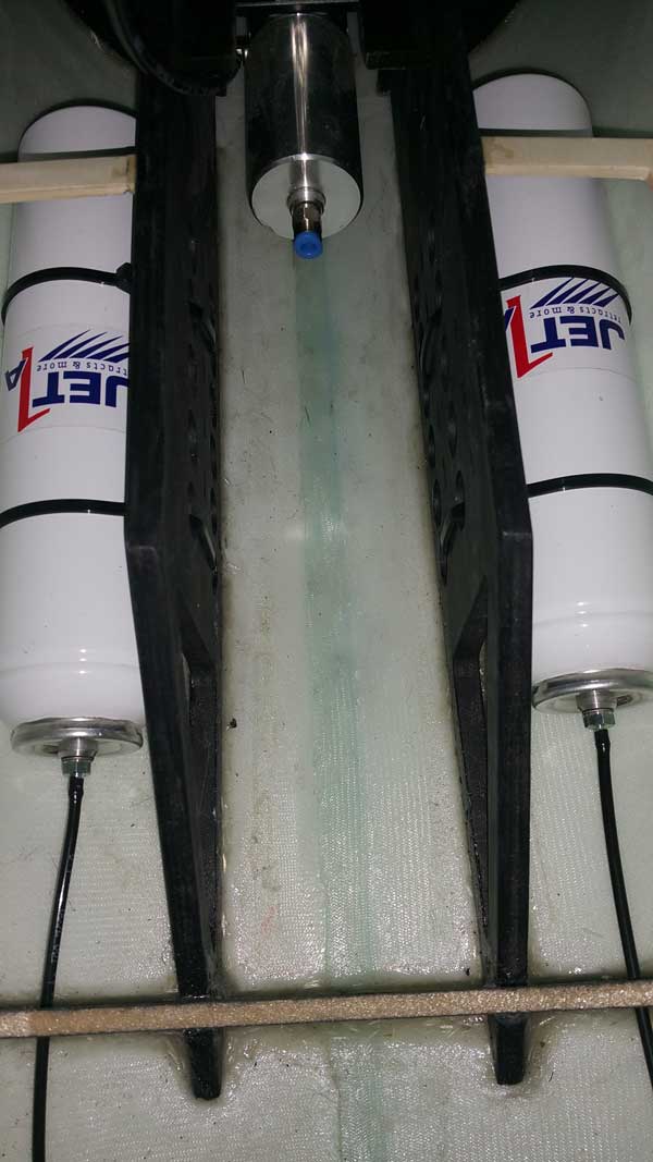

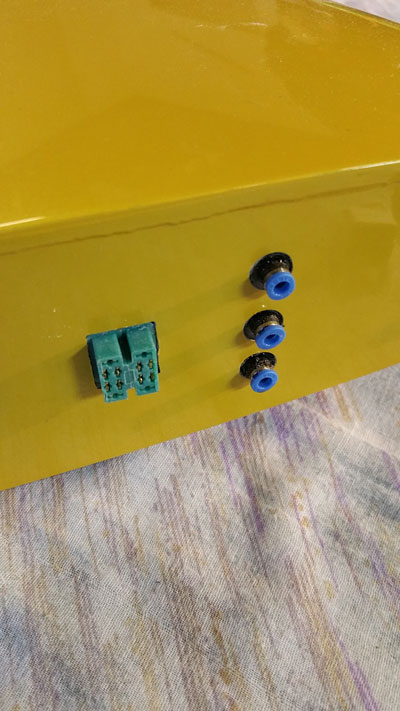

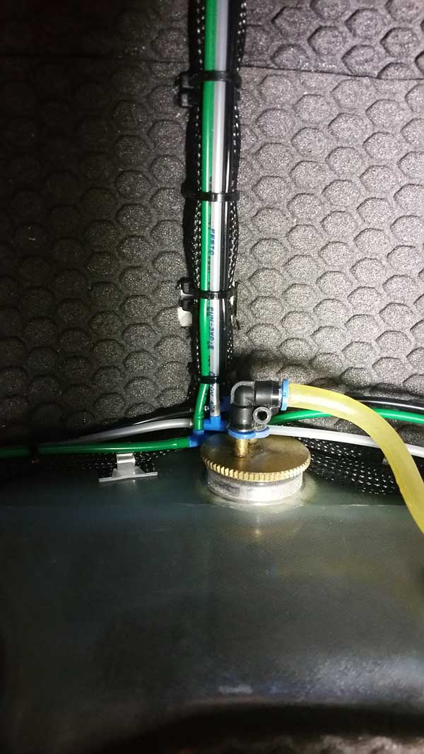

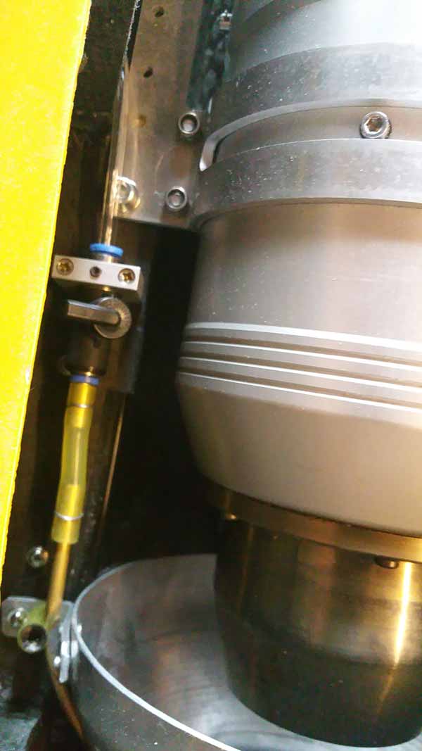

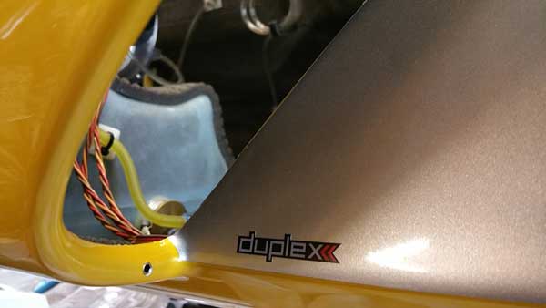

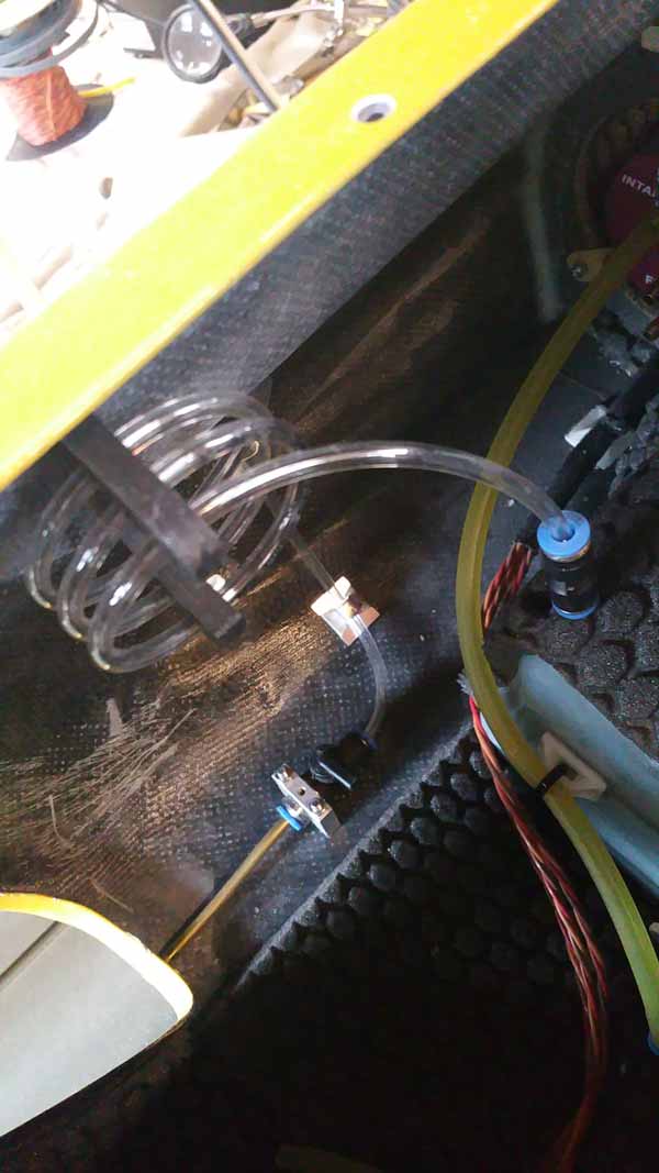

Smoketank install .....
ID:	2130548   Click image for larger version
ID:	2130549   Click image for larger version
ID:	2130550   Click image for larger version

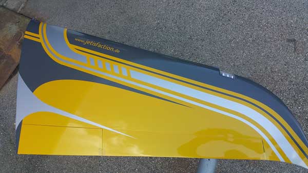

Old 11-15-2015 | 06:30 AM
  #34
Joined: Sep 2008
Posts: 640
From: Vulkaneifel

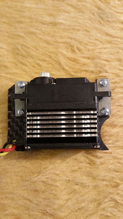

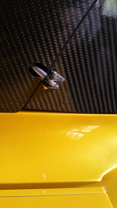

Aileron`s .....

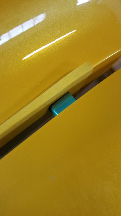

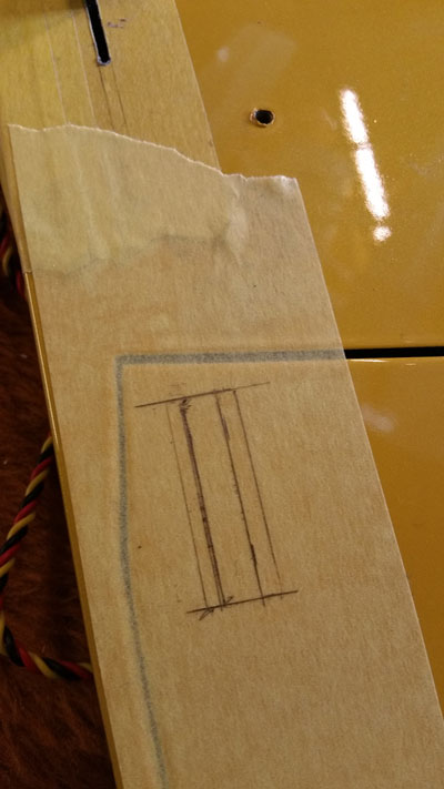

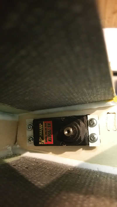

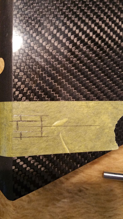

If the ailerons are build with the from Paritech delivered parts, it looks like the next two pictures .....
It is a real big Plane and the Ailerons are 26mm thick in this area so i decided to do it another way.
I want a invisible linkage on the Ailerons ..... and now the linkage is 90 degree to the Aileron !!!

It seems to me that here is not so much interest in this build thread .....

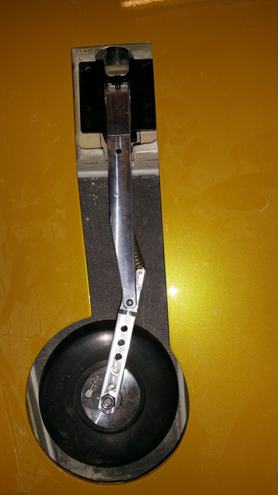

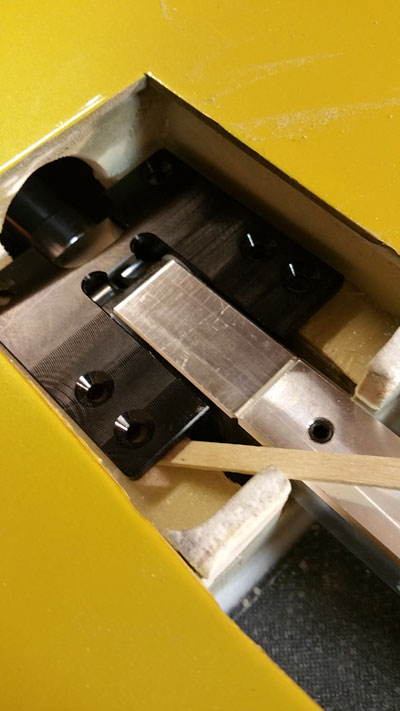

Retracts .....
here i do some major changes
If you install it the normal way it looks like on Scott`s pic
or like this .....
I dont like it that way and so i search for a better solution
After two, or maybe three, Jägermeister Red-Bull i found one
I changed the legs from the left to the right and from the right to the left .....
some other small changes and upppssss it looks like this now .....
and the final install on the wings .....
done

The landing gear is simple outstanding .....
It is made by IQ Hammer here in Germany.

Sorry for being absent, have been too busy in work and family to update thread but as winter closes in I should be able to find some time to get some pictures up.
We ended up changing out the main strut legs to Behotec. The stock ones have so much flex that it made ground handling and steering unpredictable (catchy). The new struts seemed to improve this considerably.
Our canopy also imploded during a knife edge pass at First in Flight. Paritech was quick to custom make an additional former and I increased the number of pins in the mounting system. Thus far, no further problems.

The additional former Scott mentioned is now factory installed in the canopy
and my landing gear looks a little bit different from Scott`s. It´s Air powered.

a little more work is done ...

Old 04-10-2016 | 09:56 PM
  #46
Joined: Sep 2008
Posts: 640
From: Vulkaneifel
a bit more ....

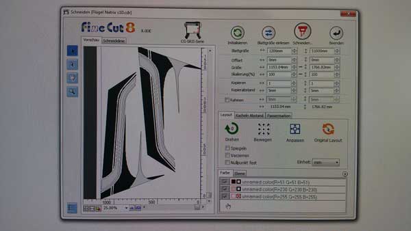

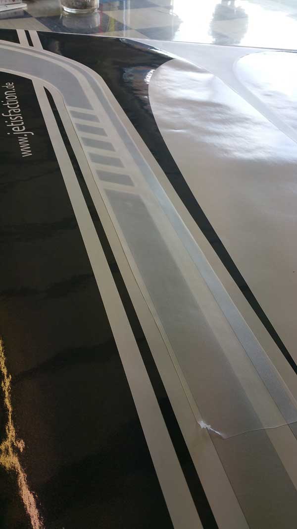

if someone like the Desigm, here is a download link to the cdr files you can use ....
https://www.dropbox.com/sh/ytyj44850...tZM8Xhfna?dl=0

Old 04-11-2016 | 06:35 PM
  #47
My Feedback: (35)
Posts: 190
From: Mansfield, OH
Looks great! There is no lack of carbon in this model. It is a surprisingly big and light (!) model.
I pulled it out tonight to prepare for hopefully the first flying of the season later this week.
I checked my CG and found it was at 385 at the end of last season. I adjusted my two RX packs to the back half of their respective trays and am now at 390 (see pic).
I did a lot of experimentation on aileron differential last season and found that for the previous CG, high aileron was best at 24 mm up, 15 down. I run triple rates on the models and this was for the high rate.
For elevator I run 13 mm high rate up, 10 mm middle rate up, and 7 mm low rate up.
Rudder is max.

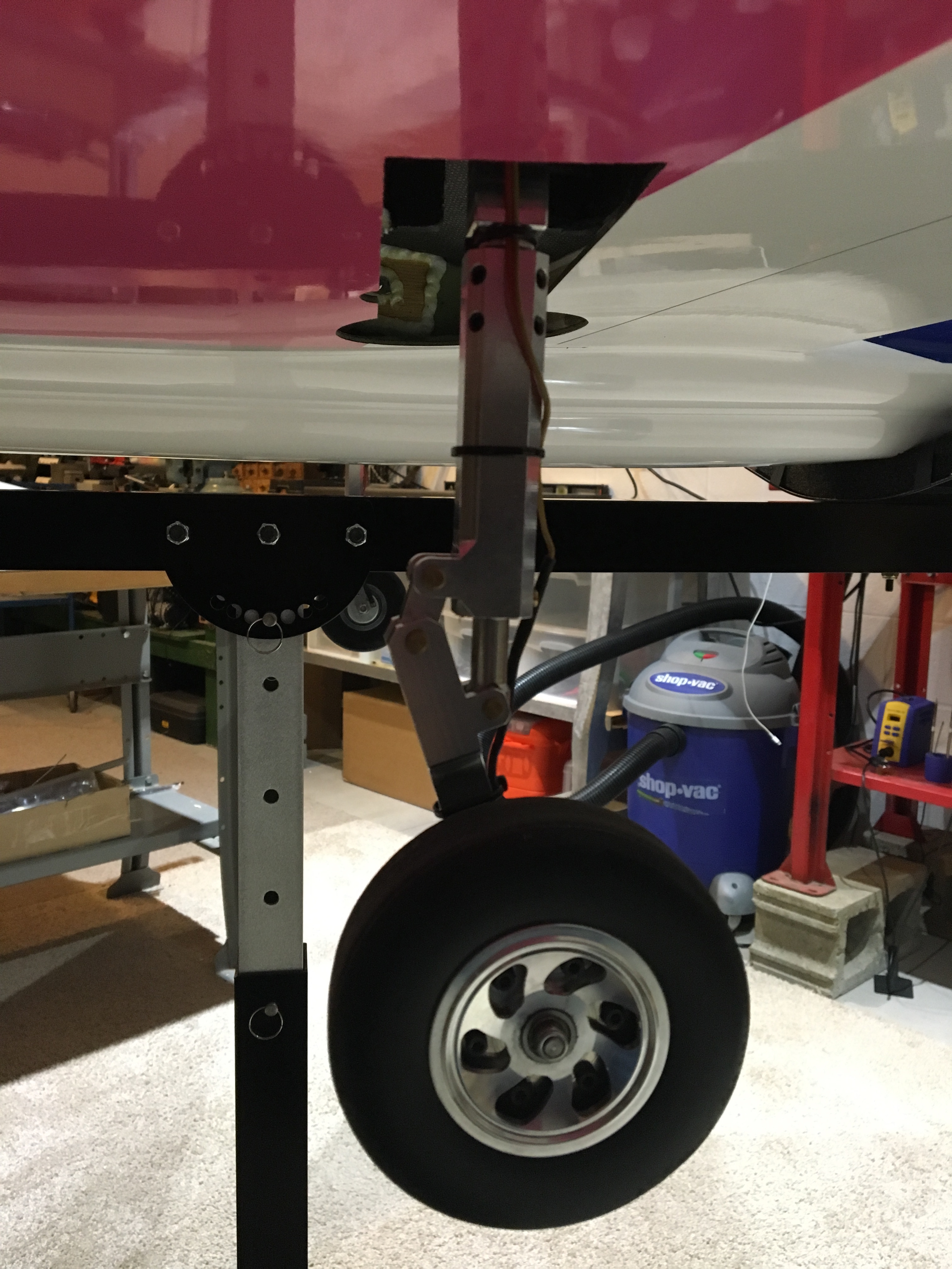

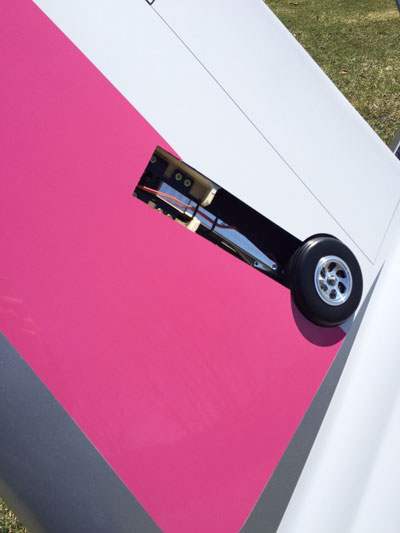

Attached is a picture of the alternative struts. They improved ground handling considerably.
As much as a pleasure as the model has been to fly it doesn't land as consistently as the 3.5 Viper or 2.5 Futura. Just seems to float on by. Ive added an airbrake function to test out and if that doesn't cut it may consider increasing flap throws.
Scott

Old 04-23-2016 | 02:07 PM
  #50
Joined: Sep 2008
Posts: 640
From: Vulkaneifel

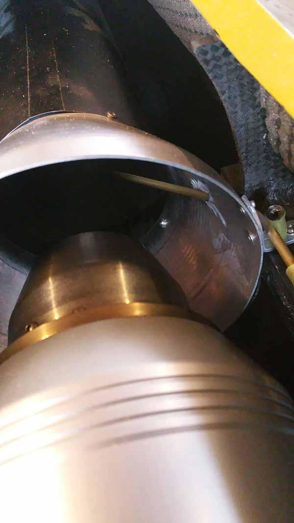

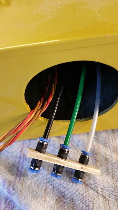

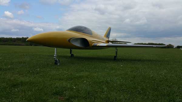

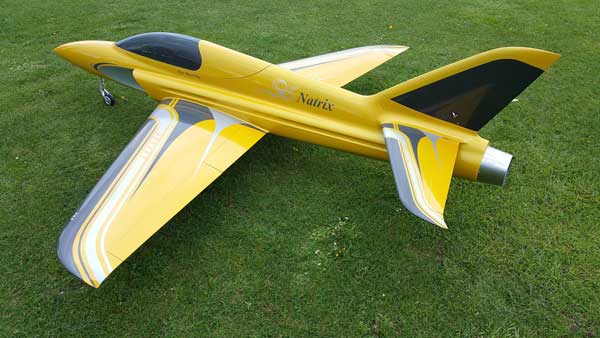

Finished ..... :d
and sold ..... so i will build a new one
