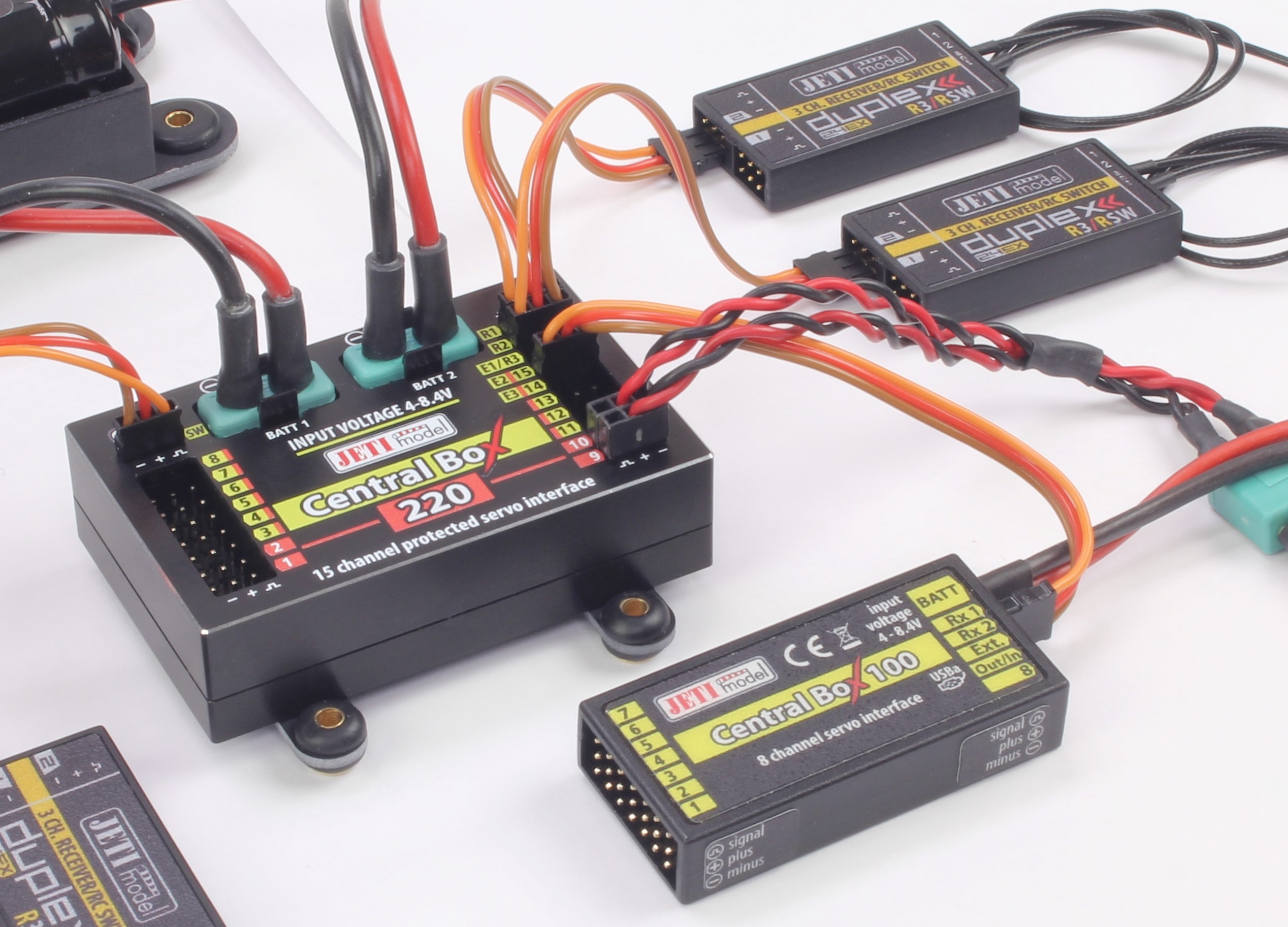

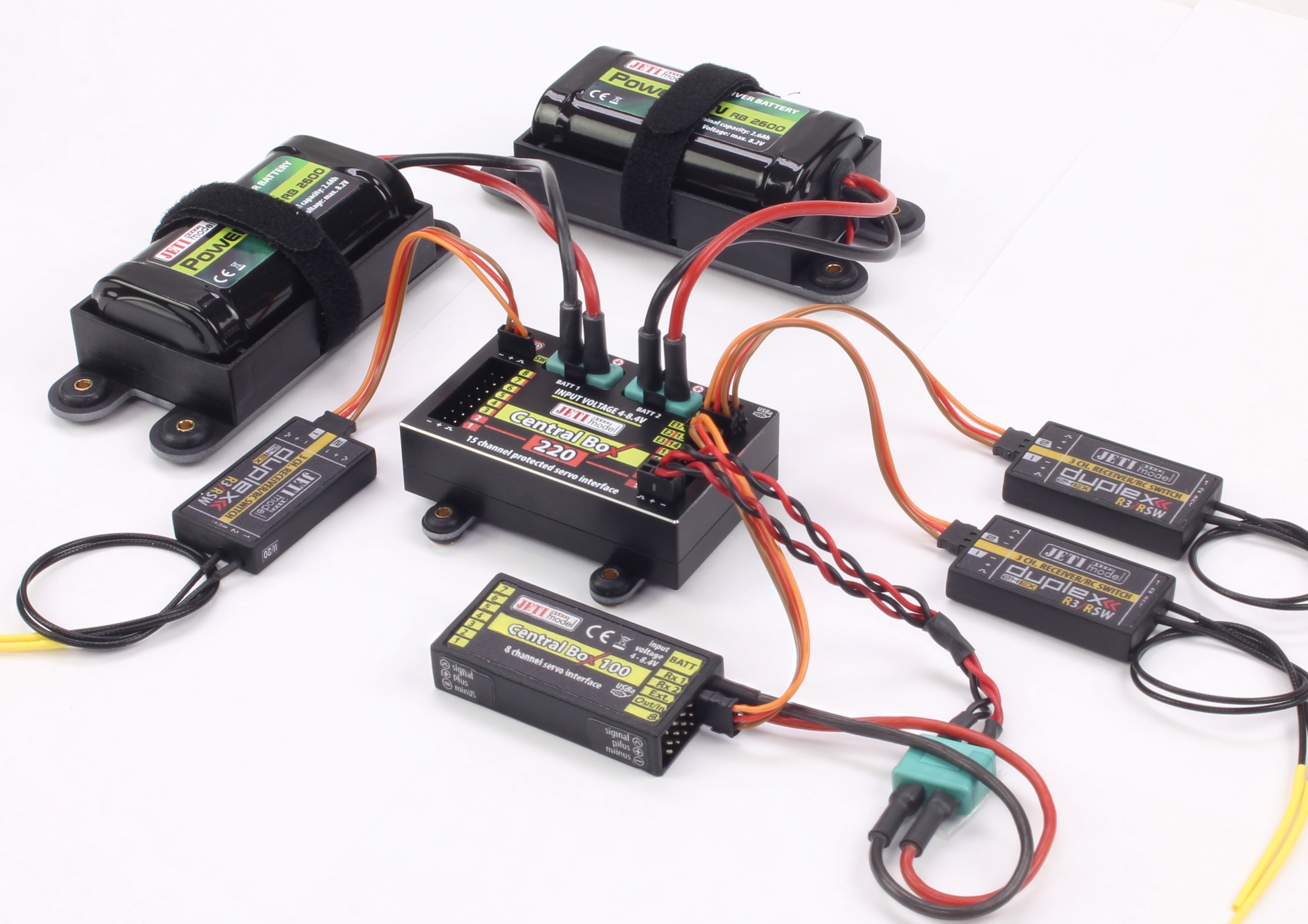

Got few phone calls and emails from guys who need more than 15 servos with they Jeti Central Box 210/220
Here is configuration that uses power from Port 9/10 (2x7A) from CB220 for Central Box 100, this way you can have up to 20 high power servos connected to the system. If you connect Telemetry to the CB100 and use CB100 only for nonessential functions you can get away with single power lead and go up to 22 servos.

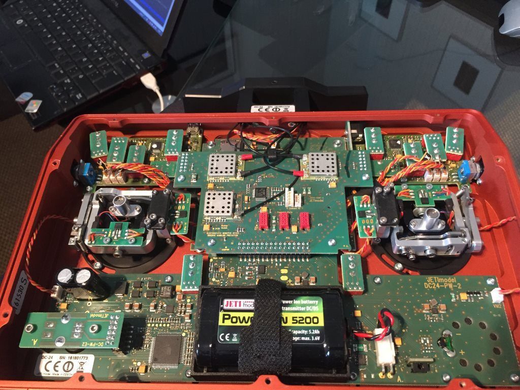

Received 52 Likes on 41 Posts
From: Gone Sailing
Disagree, if you bought a top of the range car and then the dealer bought out a cheaper lower range version with improved capabilities pretty sure you would not be happy.
Would be nice to know what the differences are, the tx has a 900mhz module below the two upper 2.4mhz module it could be an easy swap out.

From: Melbourne, FL
It “might” be an easy swap except that for North American users it would need to be put back through the FCC/IC certification process. This would be prohibitively expensive for an upgrade itself. “Maybe” the only difference between the current system and the gen 2 will be the RF module. If so then it “might“ be possible to offer an upgrade program to swap out the modules once the gen 2 is certified. But that’s a pretty big maybe at this point. The simple truth is at this point no one knows what Jeti will actually offer or when. So if you own a DS-24 enjoy it’s fantastic capabilities. If you are thinking of buying a DS-24 don’t wait for vaporware. Buy the system that is available today and join the thousands that are happily enjoying it now.
