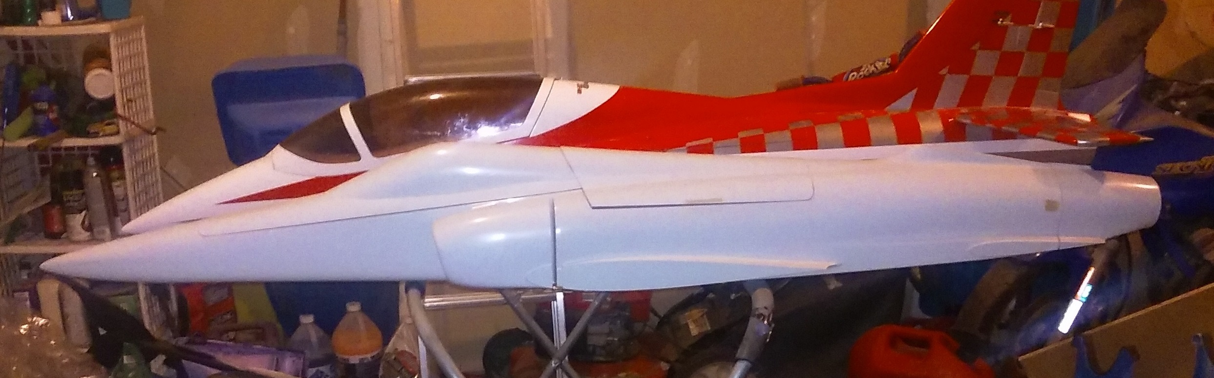

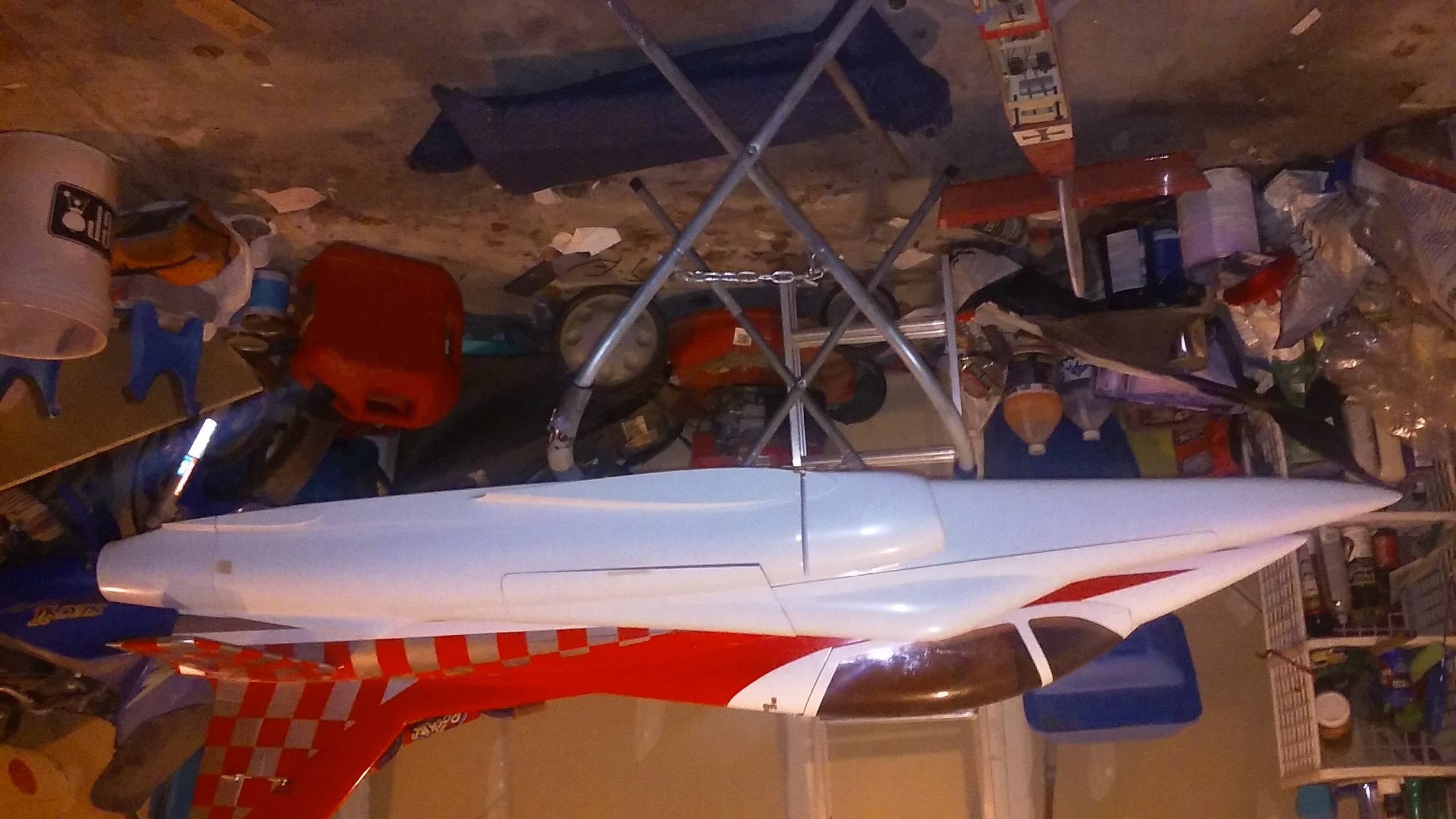

Look what I found! I plan to use it as my aileron trainer. I thought it would be fun to document this "before my time" jet.
Back in 1998 I came home on leave from Aviano, Italy. Little did I know someone was buying me a nice BVM Bandit in Lincoln, Nebraska. It would find me 18 years later.
Let see what we have here first and later I'll layout the plan.

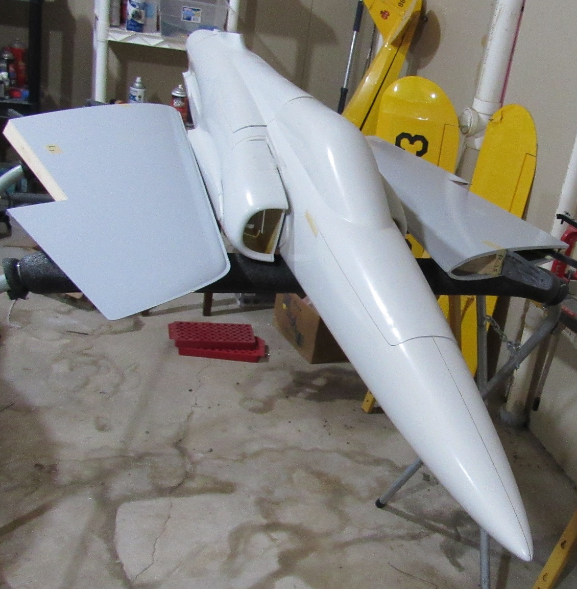

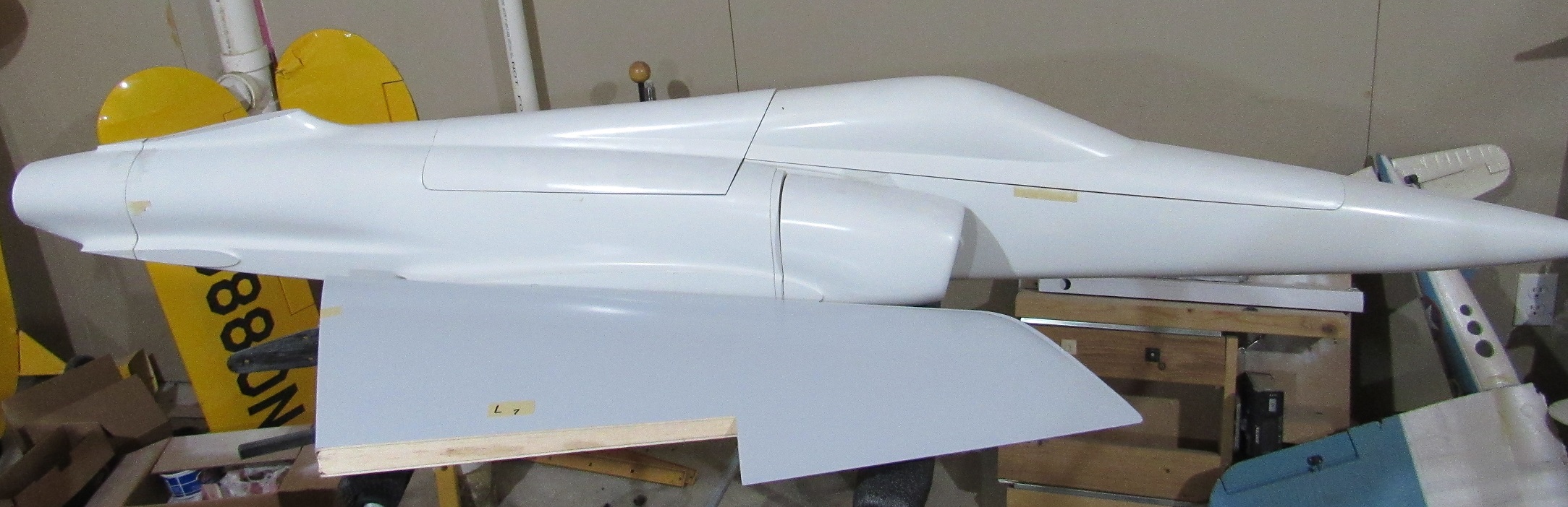

Wings, tanks, turbine kit, gear, its all there.
Sexy

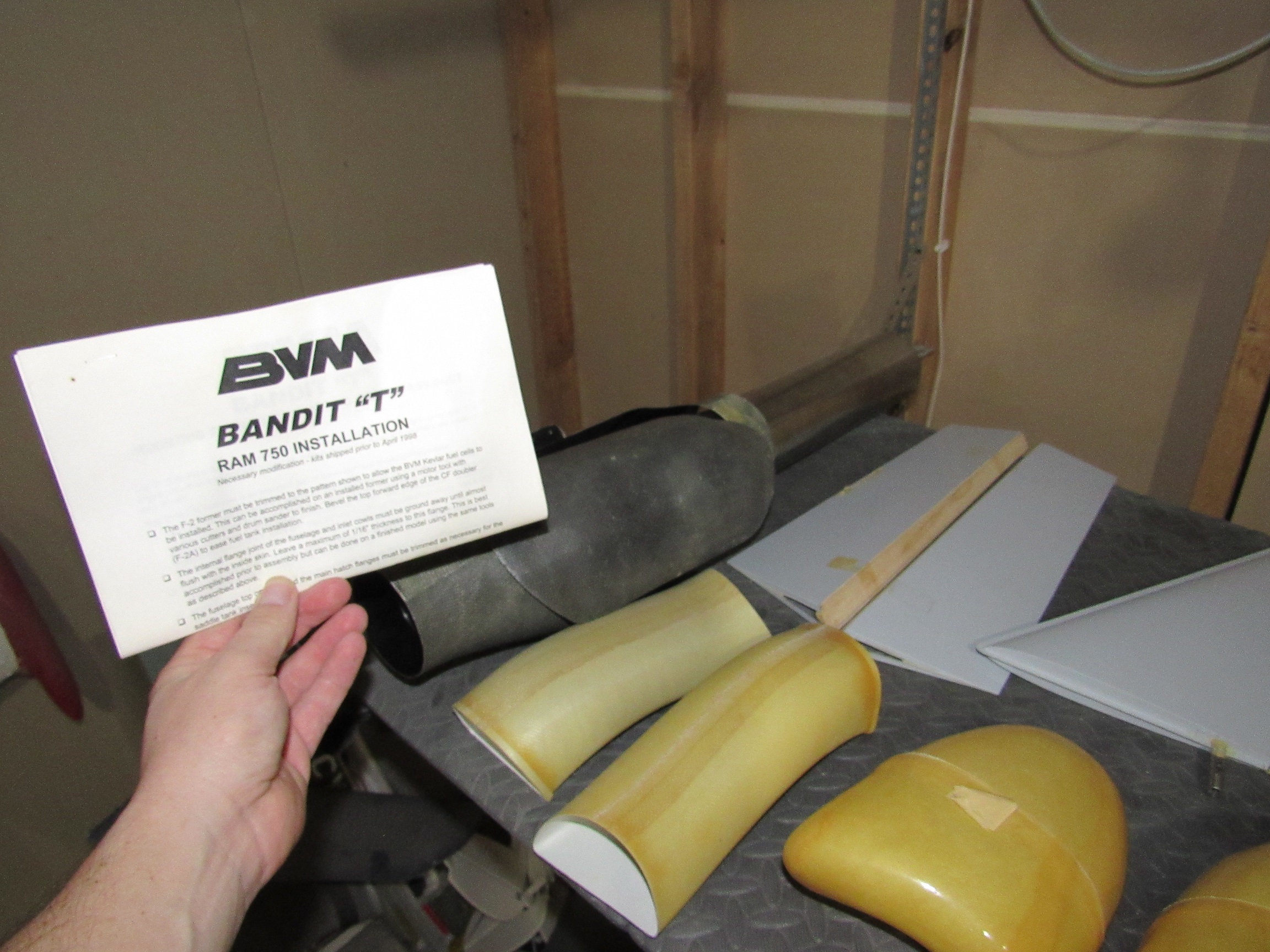

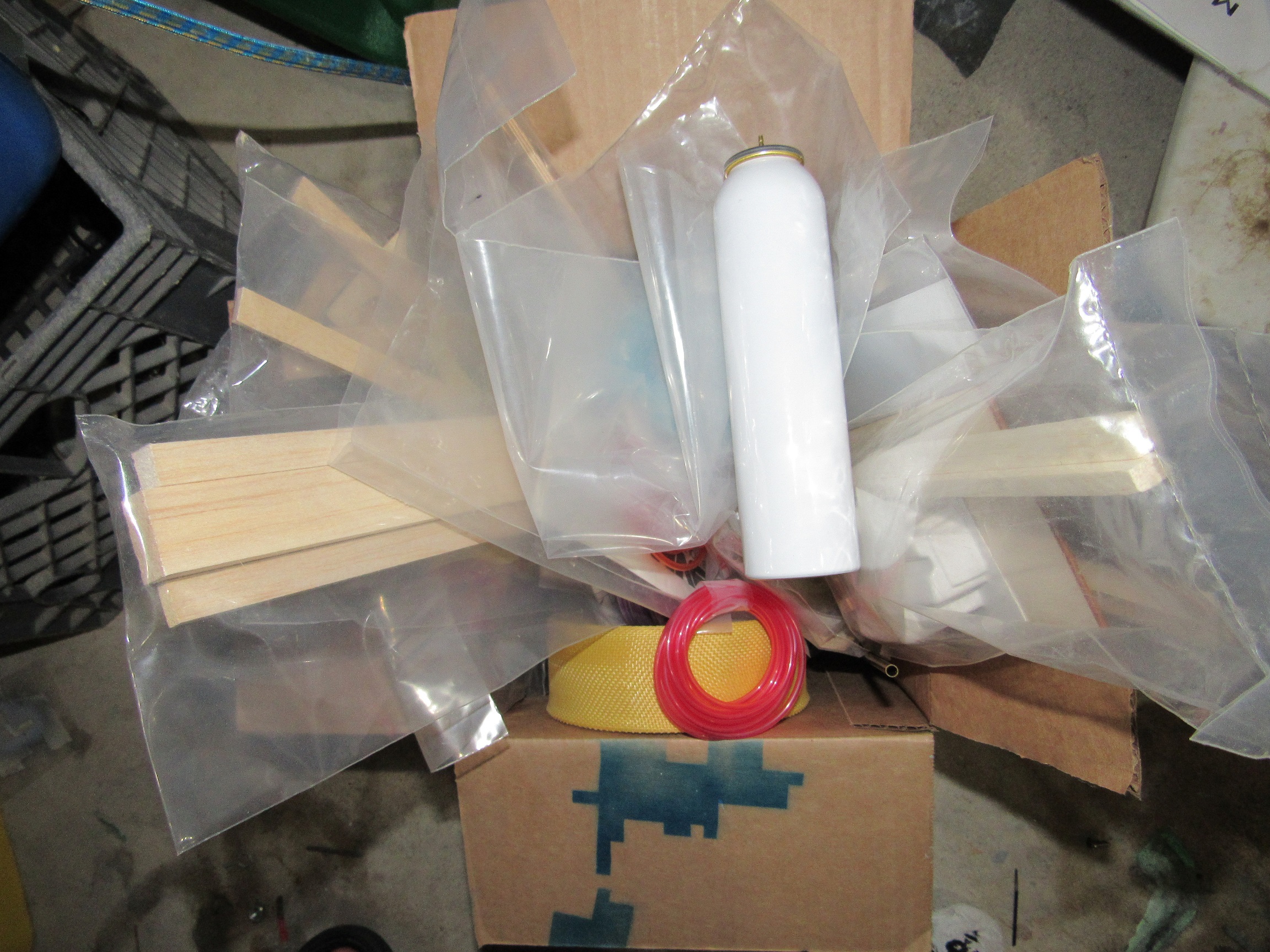

Box full of Goodies, hardware, valves, air line, everything.
Ram 750 install kit, like the truck??

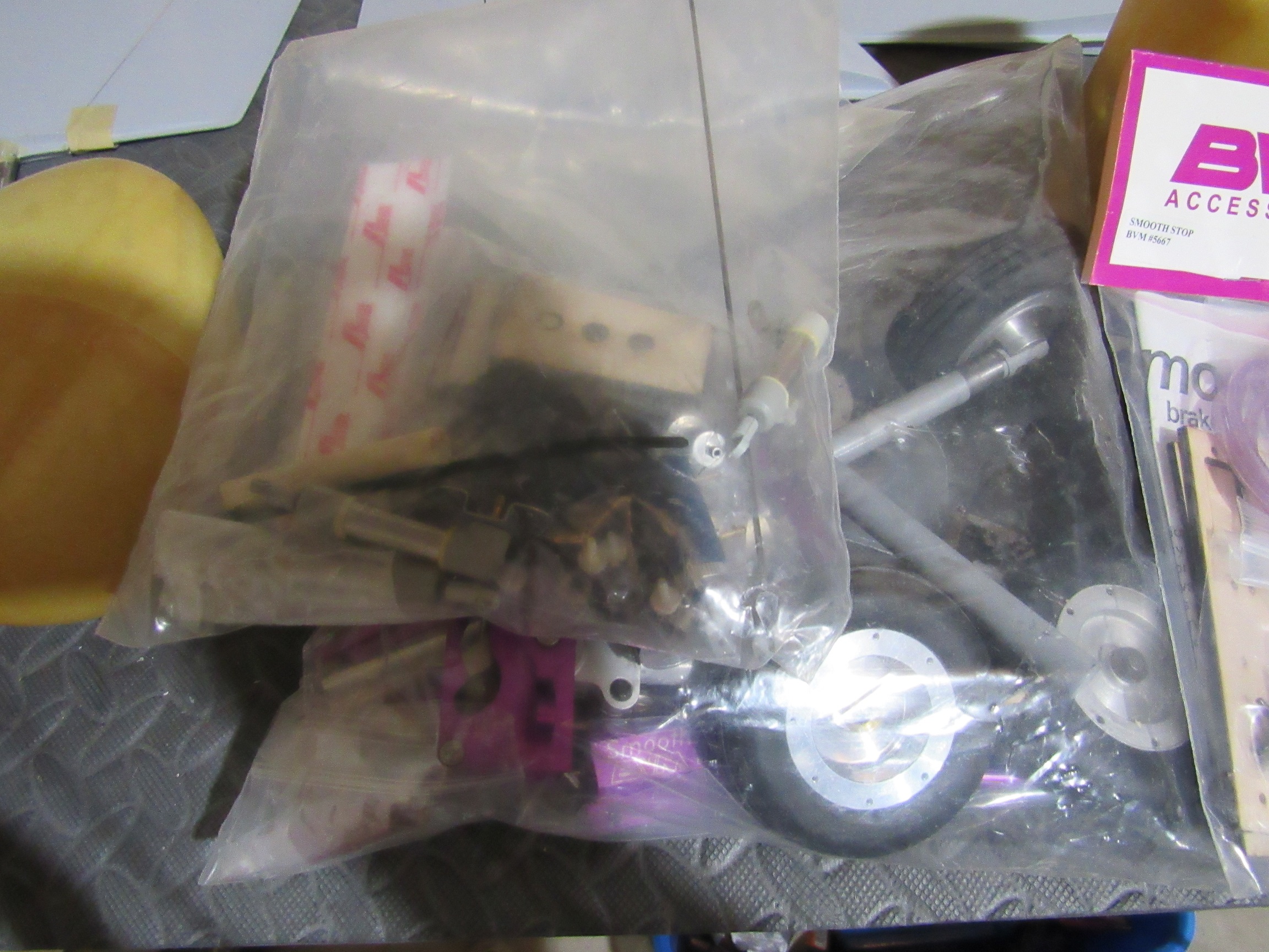

Original external air cylinders
Original gear and a set of purple retracts I plan to use.

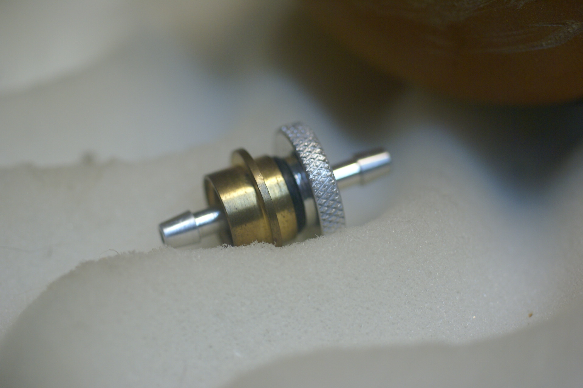

Original BVM smooth stop, V1

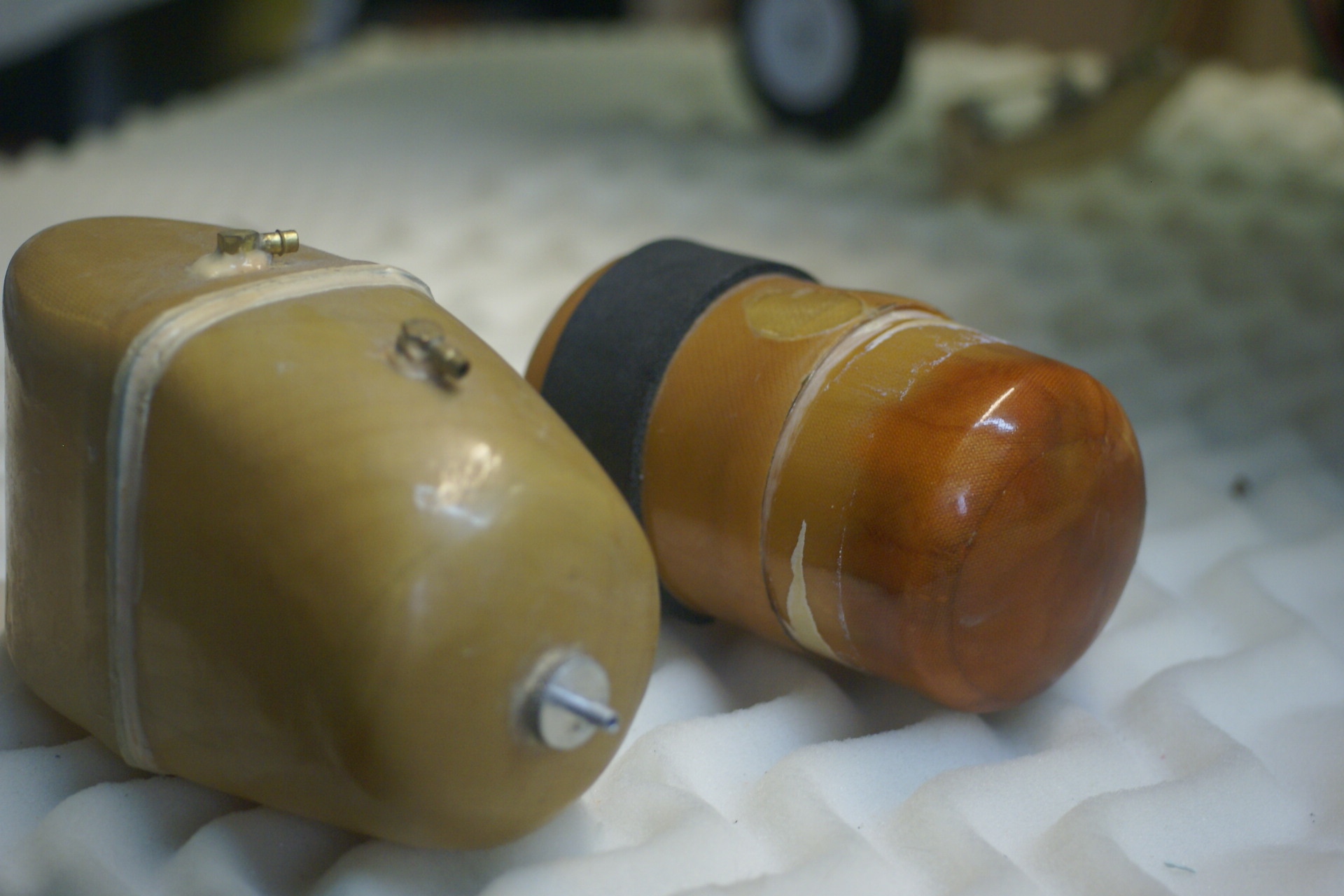

PPG$ Primer
They used to put cow urine in the epoxy back then apparently.

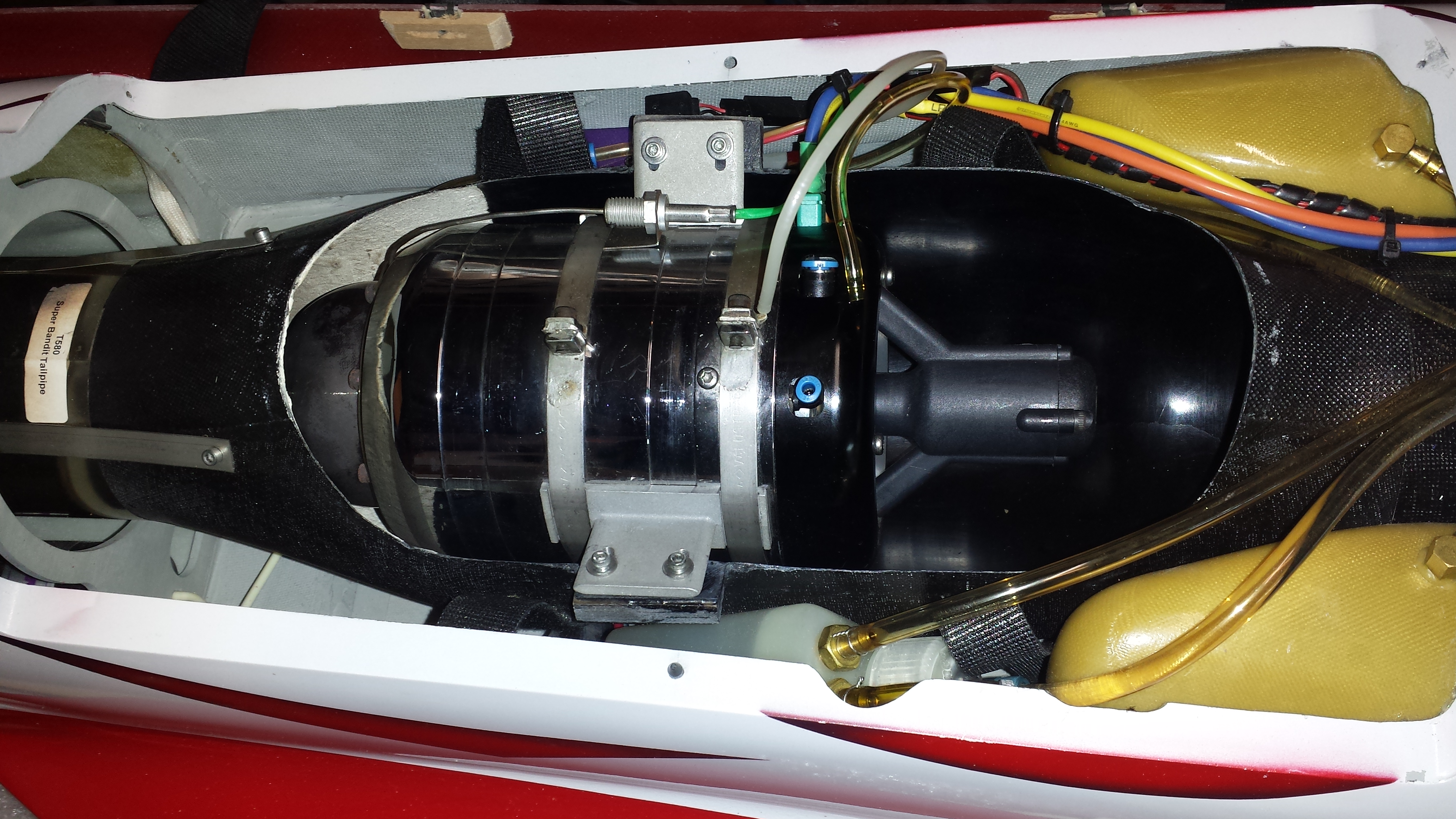

Heres a question to start it off, I have the original single wall pipe which has to be built up to a dual wall. Its seems kinda flimsy, is it up to the task of a K140g? (27-30 lbs of thrust).
Also what was the weight of the original ram 750 turbine? I'd like to see how much the K140g will weigh it down.

Probably worth talking with BVM. I'd change the pipe, the early ones were always on the limit and when they collapse its a mess! The Bandit also came out nose heavy with later lighter turbines.
Think the RAM 750 was based on a KJ 66 so like a JetCat P-80-120.That would have been a bare turbine on gas start, so turbine unit weight verses installed weight is different to now with valves and pumps installed internally. The ram was probably an ounce or two lighter on the turbine, but I remember their pumps, wiring etc being heavy.

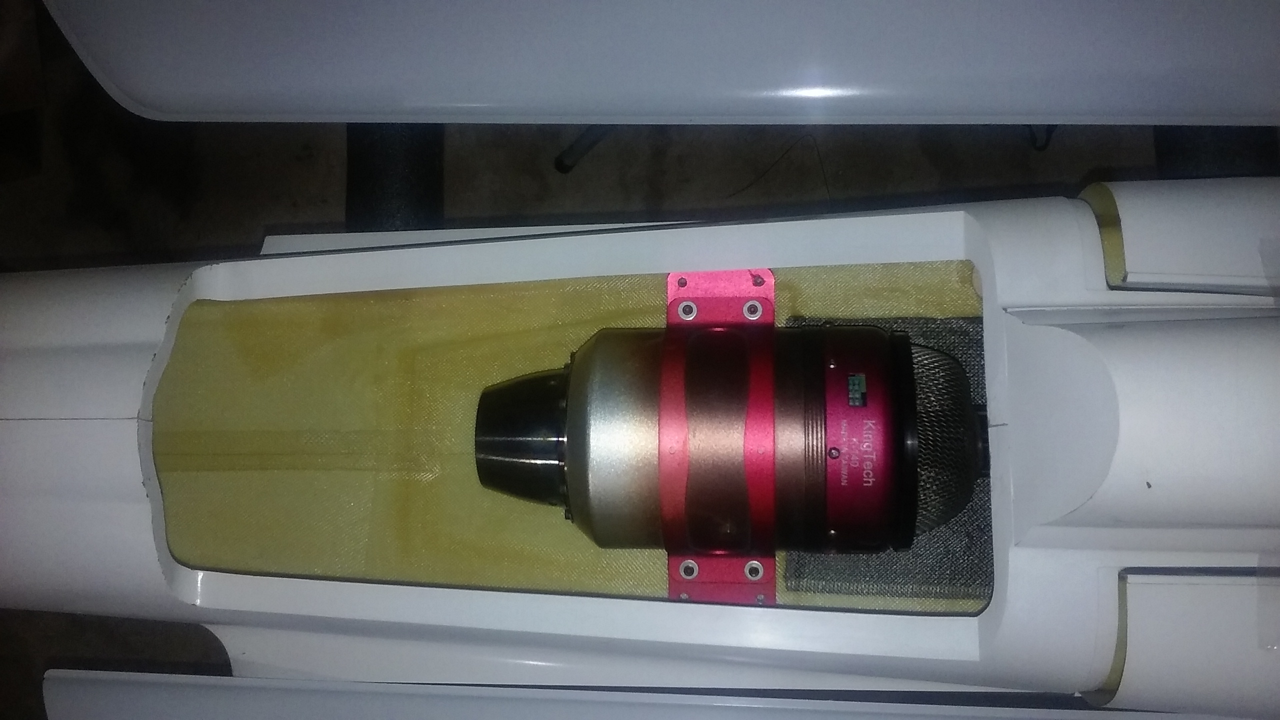

After reading this, I dug out my old RAM 750 air start manual. The installed weight of just the engine was 2.2 lbs. The manual has no other weights listed for the peripherals.

I would recommend getting a double wall pipe. BVM could make one, or you could get on from Tam.
You can purchase a Smooth Stop II upgrade piston from BVM. It's worth the money.
When you look inside, some of the "cow urine" you are seeing is really Kevlar clioth. It's yellow in color.
The resin yellowing is caused by UV light exposure, and time. Some resins contain a UV stabilizing agent, but it's effect is minimal.

The pipe mounting scheme is overly complicated. Including the double wall nozzle .
Copy the SB pipe mounting system if you can. And check the pipe wall thickness. They increased it dramatically, fairly early on.

I would not run without a bypass but of course that is your business. BVM flow path engineering is the best. And your turbine is much safer in a crash. And that thing will be very fast and I am not sure I would trust all of that ram air to find its way out of the fuse without popping hatches off.

Never fly the Bandit without using the bypass, and cover.
Years ago a friend (who will go nameless) flew his without the bypass cover after ignoring my warning not to do so. A short time after take off, well below top speed, the air pressure from the inlet blew the engine hatch off, allowing the canopy hatch to slide aft and blow off the airplane. Not only was the jet very tail heavy at that point, but the vertical fin and the canopy transparency were damaged when the canopy hatch struck the fin leading edge. It could have been worse.
Also, to parrot what Matt stated, forget the plastic header tank, and make a tank out of the Kevlar cover by gluing another BVM tank vent fitting to the top forward end, and installing another BVM tank feed fitting and receptacle centered on the forward end of the tank. Aeropoxy the tank halves together and you have a Kelvar header tank.
If you send your purple gear to BVM, Casey can reverse them very easily. No additional parts are required. They will end up looking like a set for the BVM AFS T-33. I would think an hours labor would cover it, but call Patty to make sure.

essyou35 - You will love it. Here is a pic of mine. I had no hand in the building or painting or re-painting
Jeremy Ferguson in BC built and painted it (twice - original scheme was black and too hard to see.)
I have an EvoJet Booster 130 in it. It is very, very fast if I want it to be. I have the front hopper tank in there. I can fly 6 mins, land and taxi back and still have the hopper full. With the 130 very little throttle is needed to fly at a comfortable 150-170mph or so. You don't need much thrust at all to maintain those "slow" speeds. Crank it open and you can turn it in to a speeding nearly invisible dot scary fast.

Here are some photos of the original Kevlar hopper tank shield. It's .the round one in the photos.
On a virgin kit tank shield, add a round hole for a BVM Tank stopper in one end, and install a BVM vent fitting as appear on the Super Bandit hopper tank as shown in the photos.
Aeropoxy the two halves together, and you have a 24 ounce hopper tank to replace the 16 ounce Sullivan tank.
On the round one shown in the photos, you can see the large diameter hole in the end, which must be covered by a disk of G-10 , and then penetrated for the BVM tank stopper.
As an alternative, BVM sells the large Super Bandit Kevlar hopper tank for $155.00, part number is K5300-55. It fits between the inlets. You will then have 3.6 liters of fuel.
It is shown installed in my Super Bandit.
Looks like I duplicated one of the photos....rats!

A size comparison to my JL viper. As you can see the viper is bigger and more draggy. Huge canopy, taller and thicker airframe. Much bigger vert fin too.
However the K140 is the correct turbine for it and the K100 is weak sauce in it. It still lands like a putty cat. Even with the K140, though I never open it up much past 3/4 on straight lines, its not breaking 150mph by much. However the takeoffs are vertical.
Wings are similar in airfoil and size. The Bandits wings are wider and the vipers wings are longer (excluding winglet).
Not the best compare since I am neglecting the tails.
Don't know why the pics are updside down but whatever.
So going to think the K140 over and maybe consider a K100.
