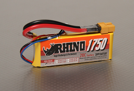

I use two, 2S 1750 Rhino LiPo packs into a Smartfly Turbo or Super Reg. I have NEVER had a problem with a bad Rhino LiPo pack in this application. I use one 2S 3700 Rhino pack for my ECU (JetCat) power as well. They are inexpensive from HobbyKing.
Bob
Bob
Looks like a very reasonably priced alternative that is worth considering. Might be a great option for the light and afterburner ring systems which require good 2 to 3 amp batteries. Thanks!
Actually, I use them for my light systems too. My Eurosport uses 3 1750 packs - 2 RX and 1 light system, and one 3700 pack for the ECU. Same for my L-39. My ME262 will be using two 3700's for the RX, and two 5000's for the ECU's - but in this application, I needed the nose weight, so why not carry it in batteries instead of lead...
Again, the RX and ECU's are such low-current applications that the batteries are not stressed at all. As long as they are properly maintained and balanced, their reliability is great.
Bob
