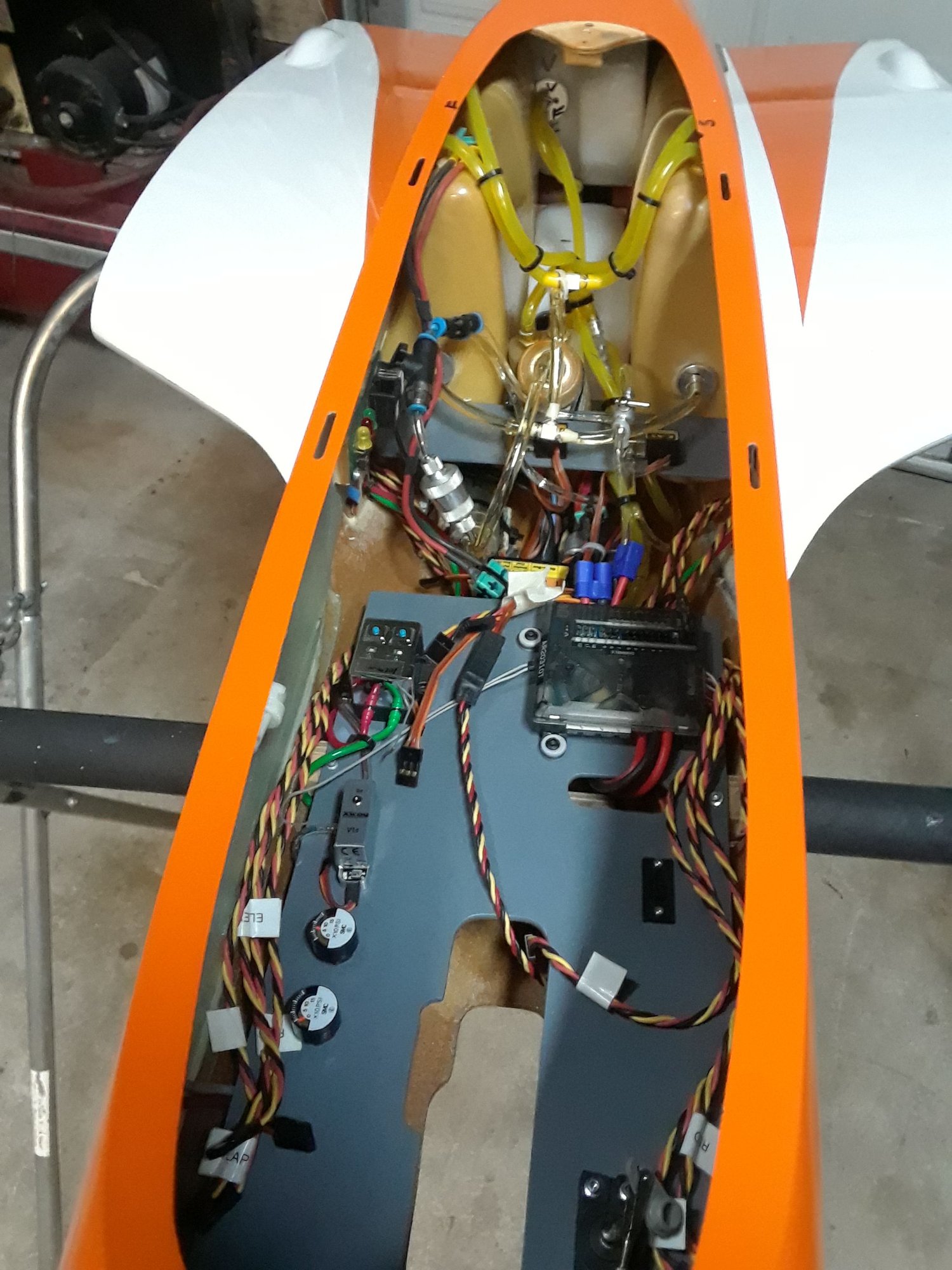

Did some work today with good results, not knowing Spektrum has delayed my progress but, we are moving forward.
I've fixed the loose comm cable, added a bit of mid CA to the cable plug, just enough to make it fit tight in the comm jack on the turbine, nice and clean job, I now have temp readout from the prob ( the old one ) with that, I needed to prime, both fuel lines, the
main fuel line was not a problem, to prime the plug line I connected the propane selenoid to the fuel selenoid spot on the ECU and primed the fuel selenoid but I was priming the plug line, with all that done, I also found a fuel leak coming from the festo Y, I will get a new one soon but for the moment some mid CA did the trick, just enough to run the engine.
The engine finally started, some flames.... watch the vid, it explains it better.
I also tried the smoke pump, no go on that one, the Y that I probably made some 15 years ago has a broken spot some where ( I will fix that soon ) I end up using my second LIPO, the pump runs.... watch the video.
All in all a good day, I finaly got the engine running as well as the smoke pump, found a bad fuel leak and a broke Y that feeds the ECU and smoke pump, GREAT!!!! more stuff to fix
Forgot, I also change the fuel lines inside the turbine, they have been in there over a decade and some time ago I also change the starter O ring, I suspected it was 1/2 way gone and dry.

Well, things a going back in where they were, the next thing to do is radio check, servo checks ( already found one that is no good ) set up and then some
A lot of small things that needed fixing to get the engine, and pump runing but, they are now, I re-solder the batt Y and it's works fine now, swap the old Jetronics dual valve for a new one with fail safe, moving forward.
Programing will have to wait till a couple of weeks, I'll be in LA and going to Disneyland on my next days off so, no work on the jet for a week a half.
I still have to check the fit of all the parts, I know already the the small tube spar fits tight on the right wing and have done some sanding to get it loose, so far it's working.
CG should be right on the spot, with the new playwood tray the nose is light.

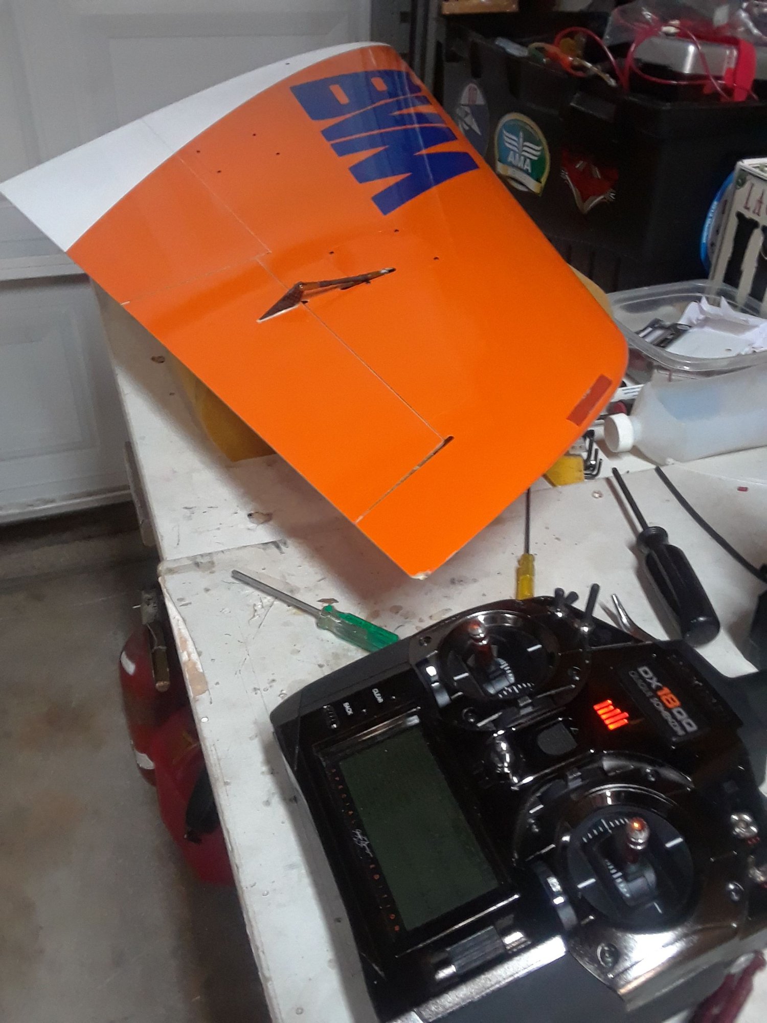

Programming the flaps is going very easy, I am liking this radio more and more, I still have to do some minor adjustments like, more flap travel for the TO and Landing.
I took a snap shot out of this vid, looks like this KC has the TO flaps travel down to the bottom of the booms.
I also got the link to the BVM page where they have all the travel measurements for all of their models control surfaces, thanks to my friend Raffy.

After trying different ways how to set up the flaps ( the vid I watched and the KC manual ) I decided to go with the manual, it takes more doing and if I need to readjust the landing flap position, I will have to readjust the landing flap position manually.
The manual tells you to have to servo arm parallel to the pushroad when the flap is fully deployed, this way when fully deployed there is minimal load on the servo ( tested it by pushing on the flap ) sounds reasonable to me.
