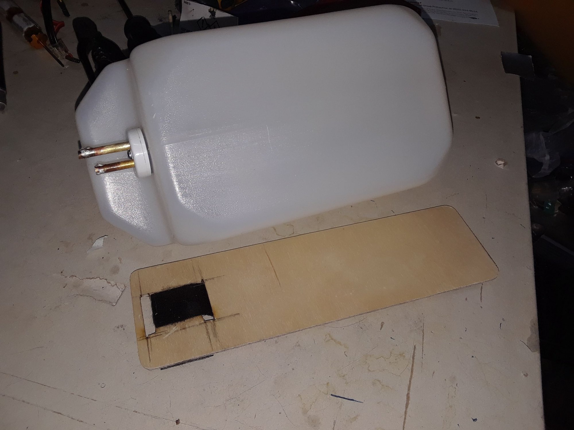

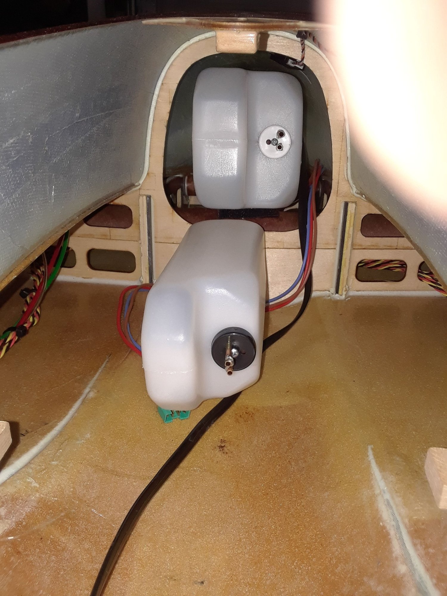

Looks like you are almost done with the KC furbishment, I will be adding a 40 oz Dubro tank for smoke inside the fuse cone and a 20 oz tank in-between the main tanks.

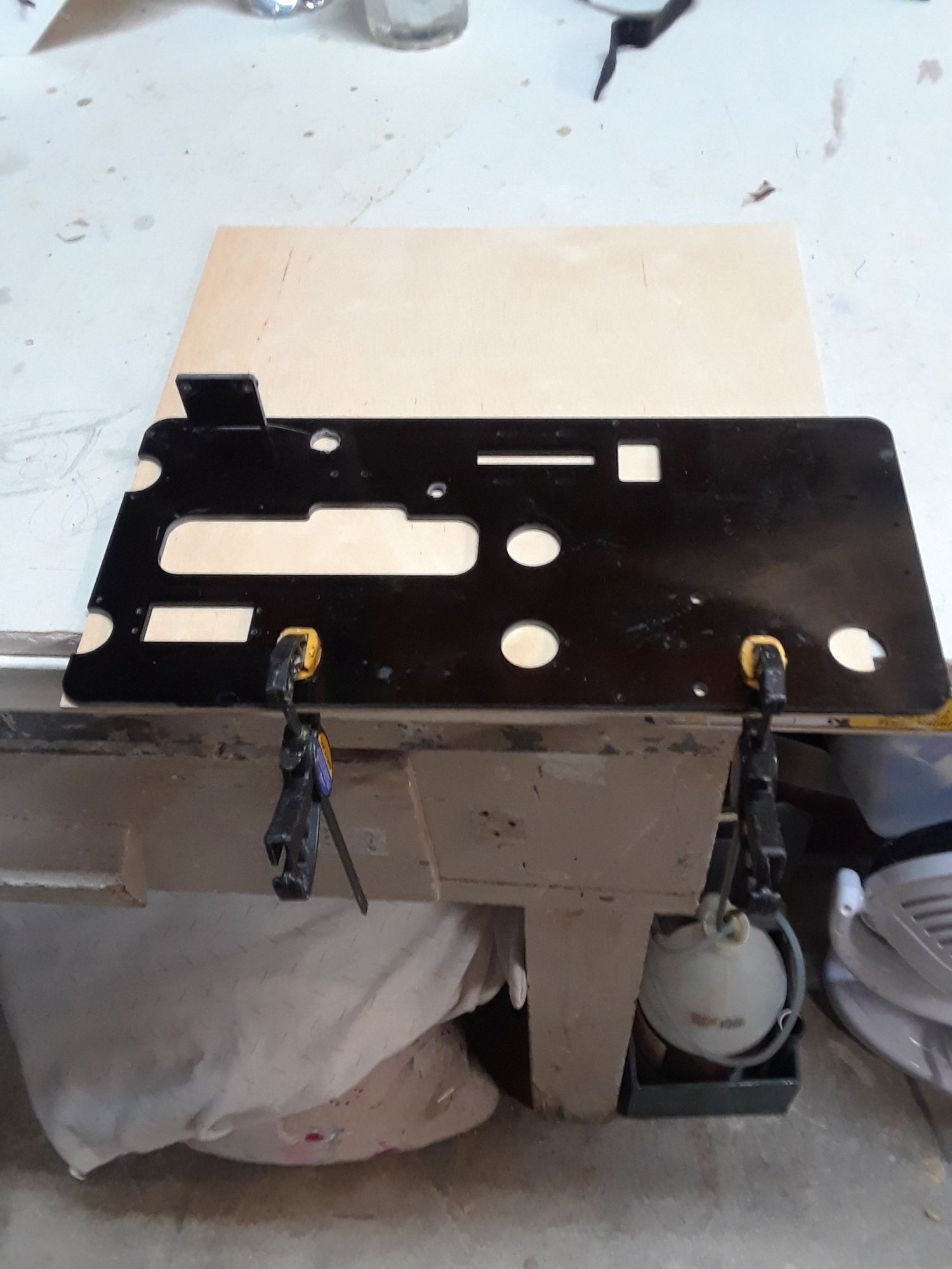

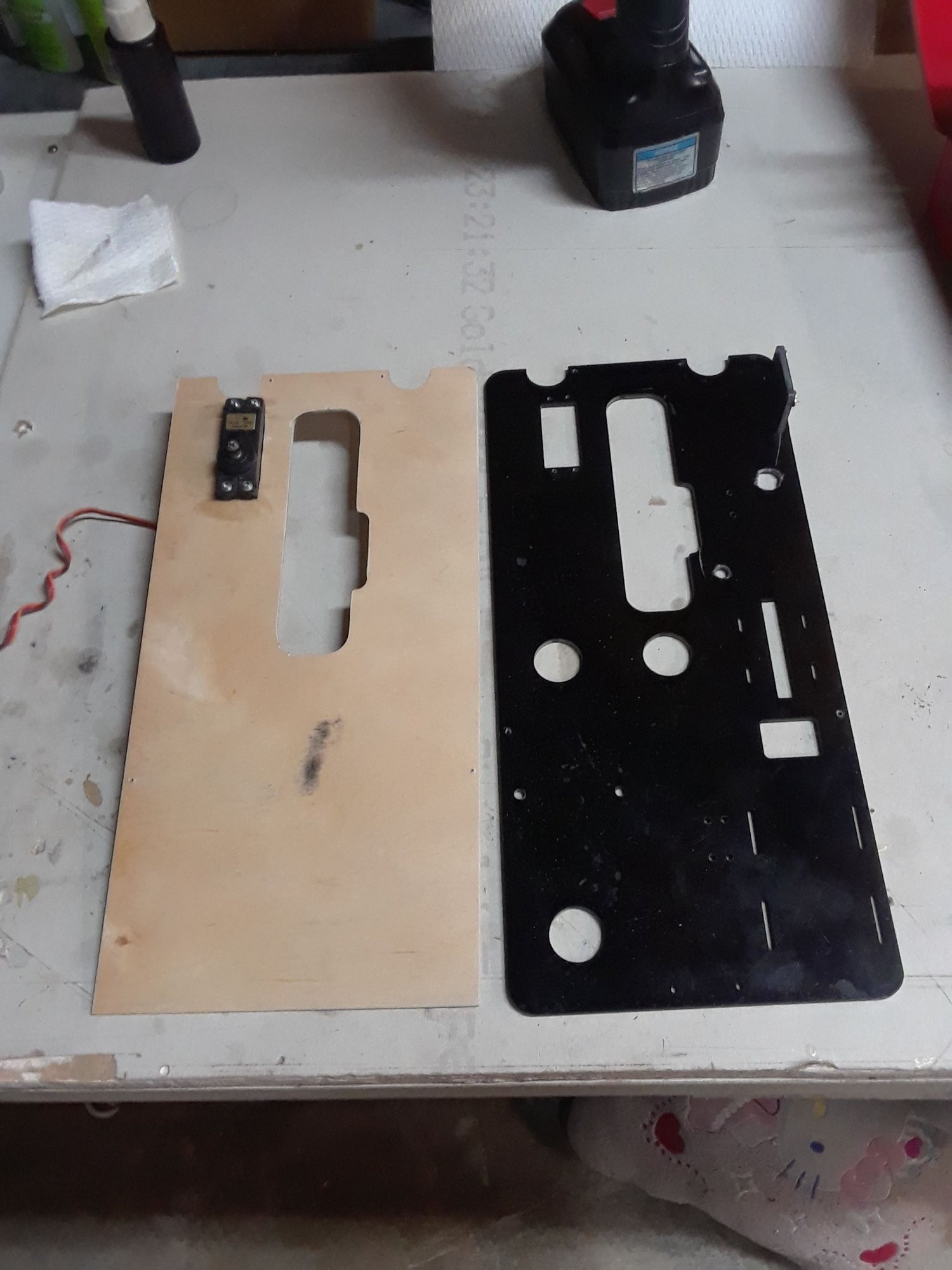

Cutting a new tray out of aircraft plywood.

Tray is cut, I will make holes as needed.

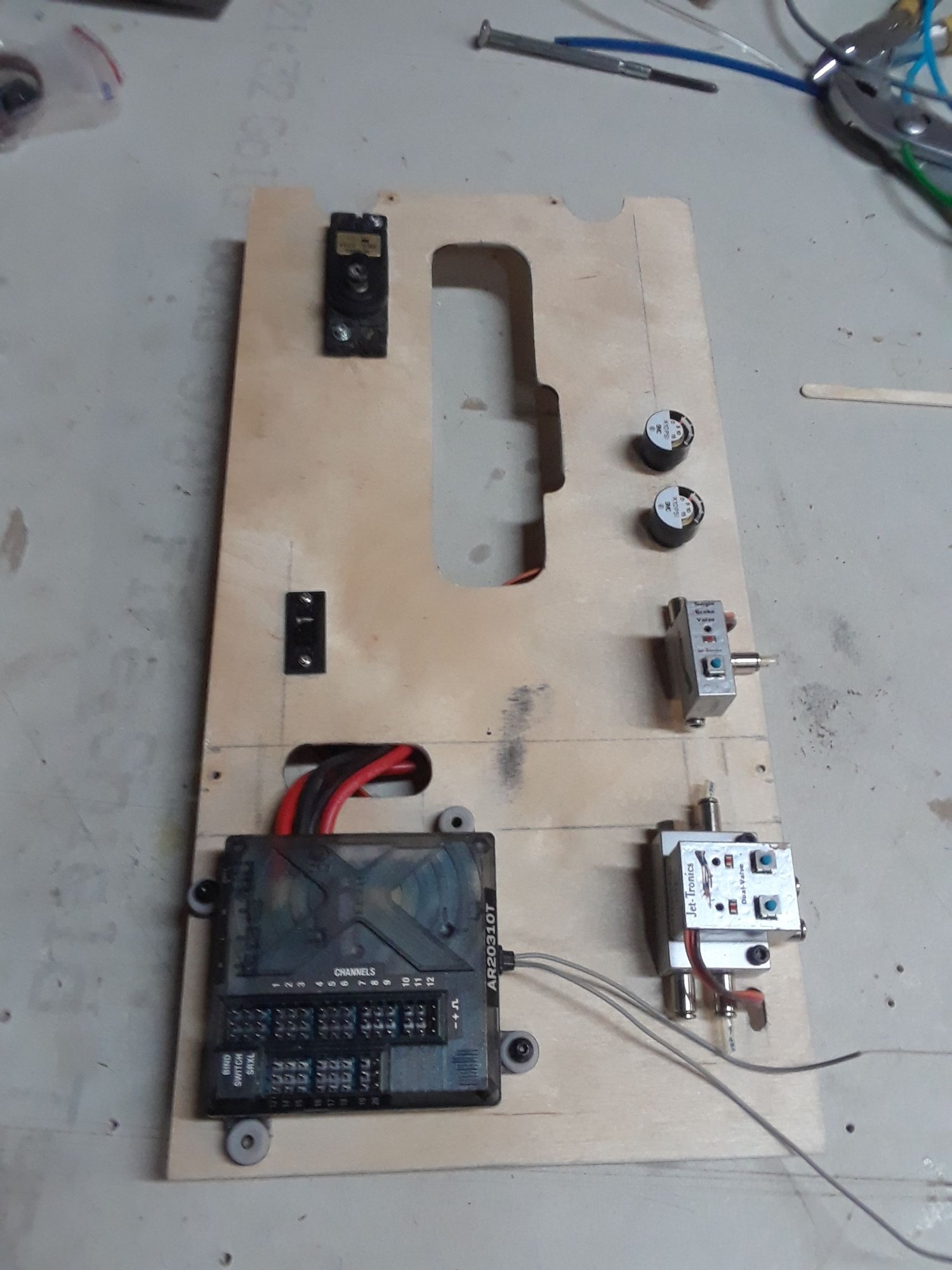

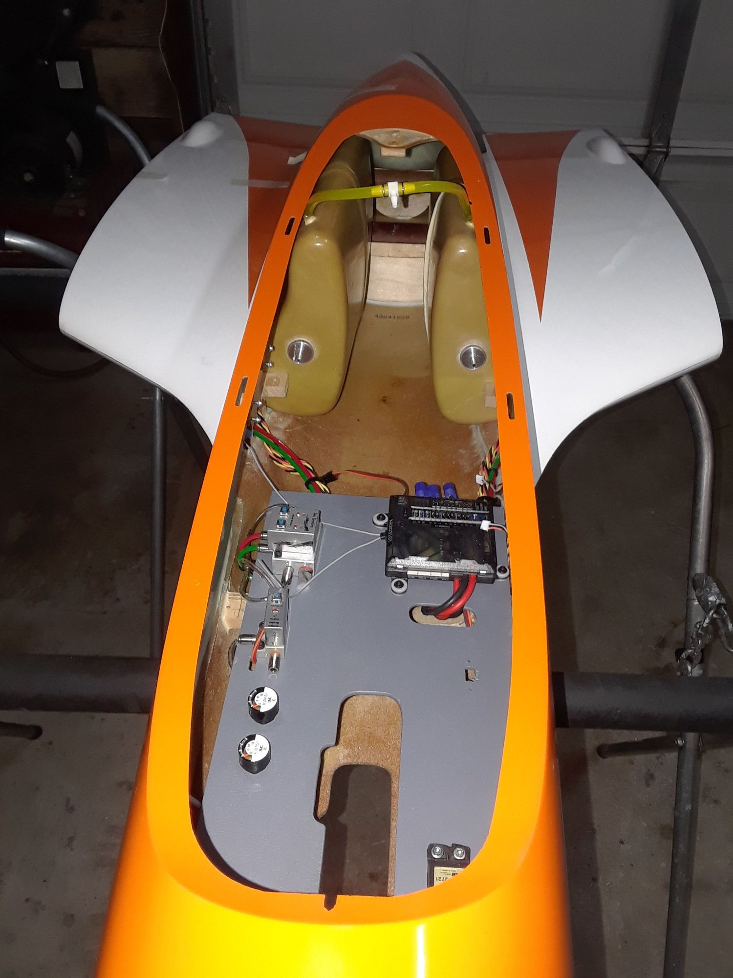

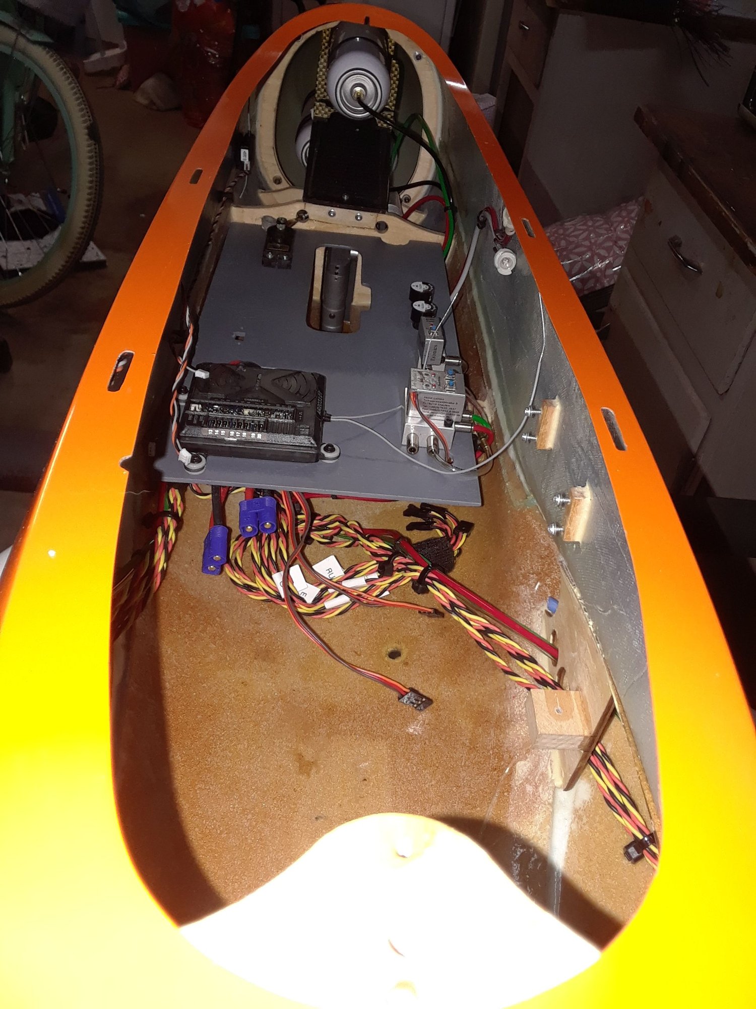

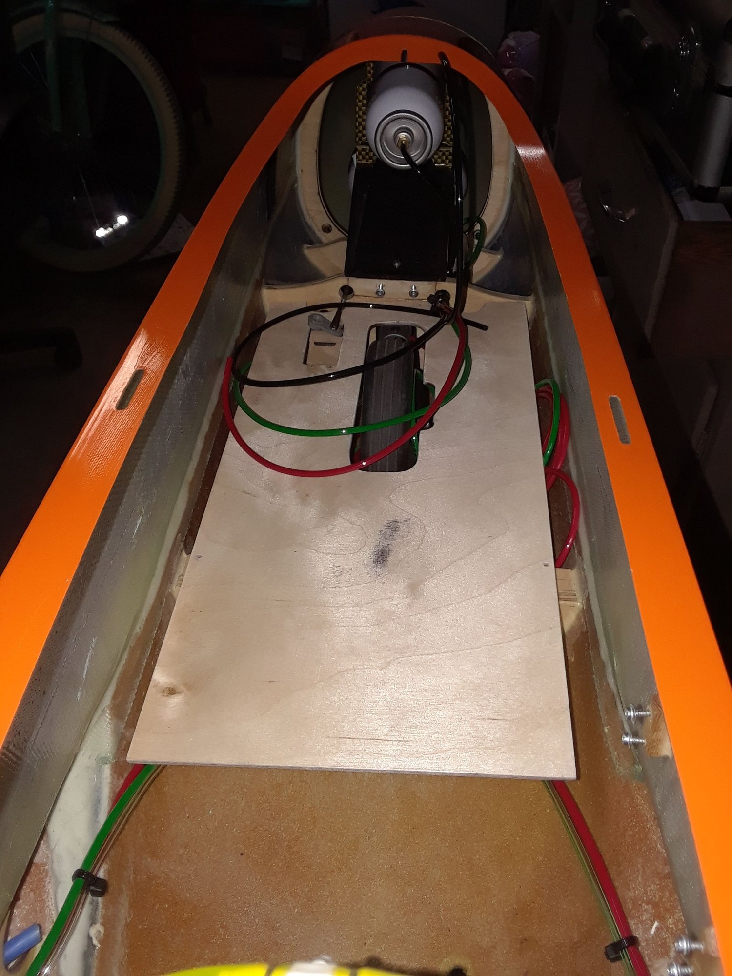

The air tanks are back in and nose cone back on, the new tray fits good, the double and single Jetronics valves, air gages, on/off switches and receiver are the only things to be mounted on the tray, the gas and smoke pumps are going to be under the tray.

The tray is looking good now, more to do to it, then gray primer paint.

The dual retracts Jetronics valve is working just fine.
The single action valve for the brakes is not doing so well, on the picture you can see it's plugged in like the dual but, I'm not getting a red light on it, do you guys thing it's burned? Do I have to replace it with a new one?
Does anyone knows if this dual valve ( this one is old ) can do more than just retract and deploy the landing gear?

So far the tray, the airlines and extentions are done, the fuel cells are ready, I still have to mount the fuel pump and smoke pump.
I'm thinking two more weeks for a driving test, engine run and range check at my flying field then, maiden flight two days later at his flying field

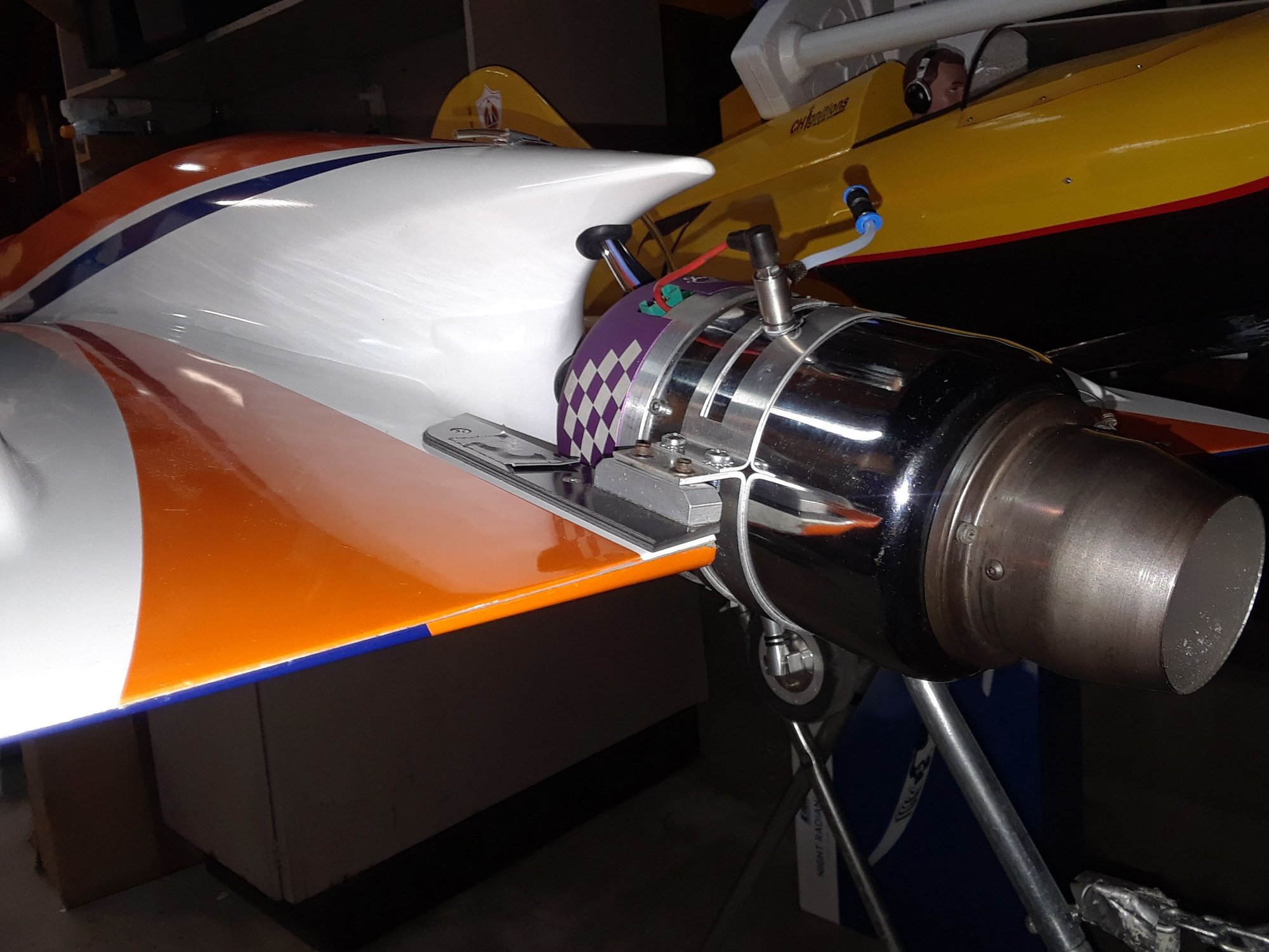

The refurbish continues, I got most of the tray install done, engine is mounted now.
I swapped the glow plug for a kero plug, I suppose I need a Y fitting to split the fuel line into two, one for the fuel in and one for the kero plug, Is that correct? And I suppose it's best to install the Y fuel fitting in front of the engine, correct? I haven't had the opportunity to use a kero plug till now, so I ask
I also build me a tray that will be held by Velcro so it can be removed at any time, it will support the 40oz smoke tank, this tray will go in between the spars sockets, the 40oz tank will end up right on top of the CG point, there will also be a 20oz smoke tank positioned in between the main fuel tanks for a to total of 60oz of smoke oil that can be carried

I was going to ask about kero plug tubing install but as usual, I found my answer on another RCU thread
