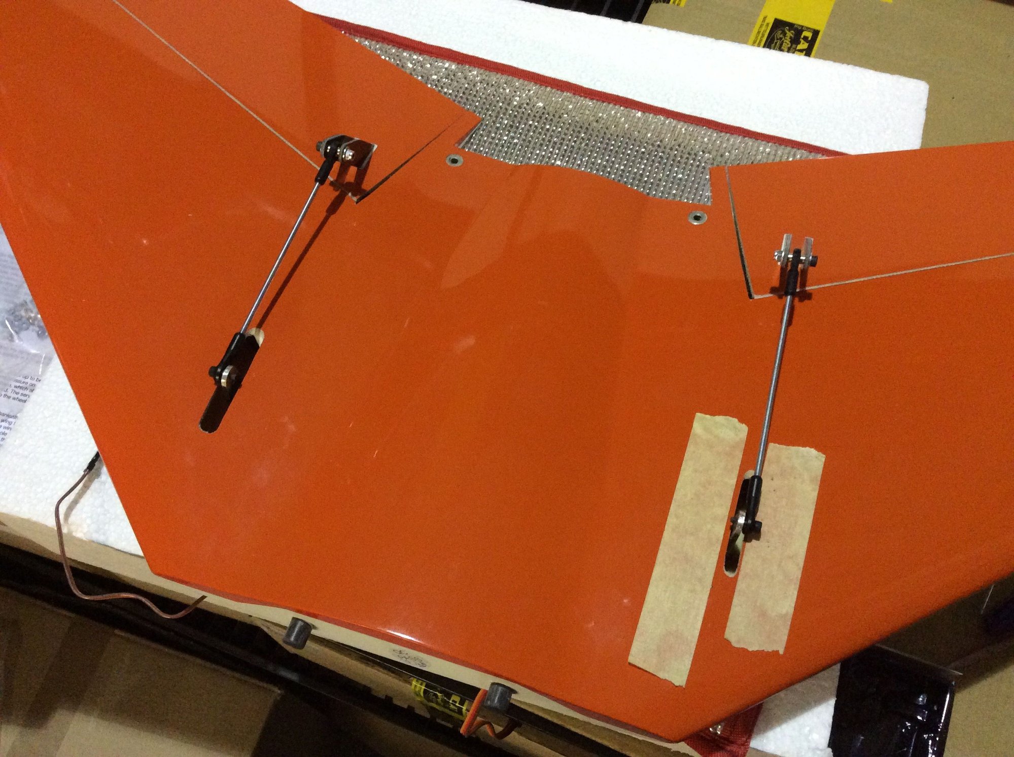

Work got in the way the last two days, so slow progress. On the full production kits the surface control rod slots will be cut 2mm wide to allow you to open to suit the arm offset you use. Mine was already opened to 5mm so I have ended up with a wider slot than I wanted. I may put fairings over the front section anyway to clean them up.
MacGregor 6928 Brushless servos on the stabs the same as the two prototype Bolt! Airframes.
Note the kit comes with carbon sleeves for the pushrods. I’ve just not set the length yet.

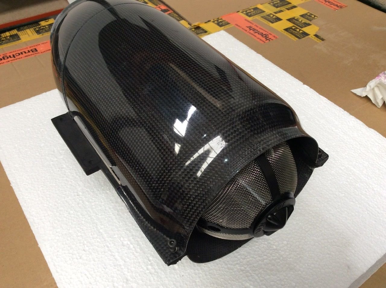

Spent a little time tonight looking at various parts. The bypass should take all 200-260 turbines with little effort. The JetCat P-220Rxi I’m using just needed the lugs taking off the cover and a notch cutting to clear the strap and 6mm packers.
Trying to decide where to mount things. The two prototype models had the bubble trap mounted right at the front, but I think I’ll go for the shortest fuel line runs into a 6oz Map twin input tank

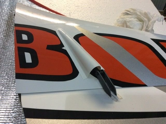

Tailplane is the first part finished, the linkage screws are not final fix as I’ll wait for the programming stage for that. One of the nice things about the Bolt! and anyone who has built an Ultra Lightning or Mephisto wing will know you need the right tool to fit the servo mounting screws...so CARF have supplied Allen head screws and an extra long Allen driver for the job...makes it really easy 🙂

Fin next. The hinge line dictates a ball joint at each end, it was tried with a 90 degree pushrod but it worked out better like this. The slot has to allow for the pushrod indexing...so CARF moulded a cover. Not just a flat base flex and fix down- no it’s moulded to match perfectly just sitting there like I show. It’s glass fibre not plastic.I’ve started to trim the flange and will finalise tomorrow, eldest daughter is just home from a week in Scotland so I’m required for some daddy time,.,even though she’s 23!

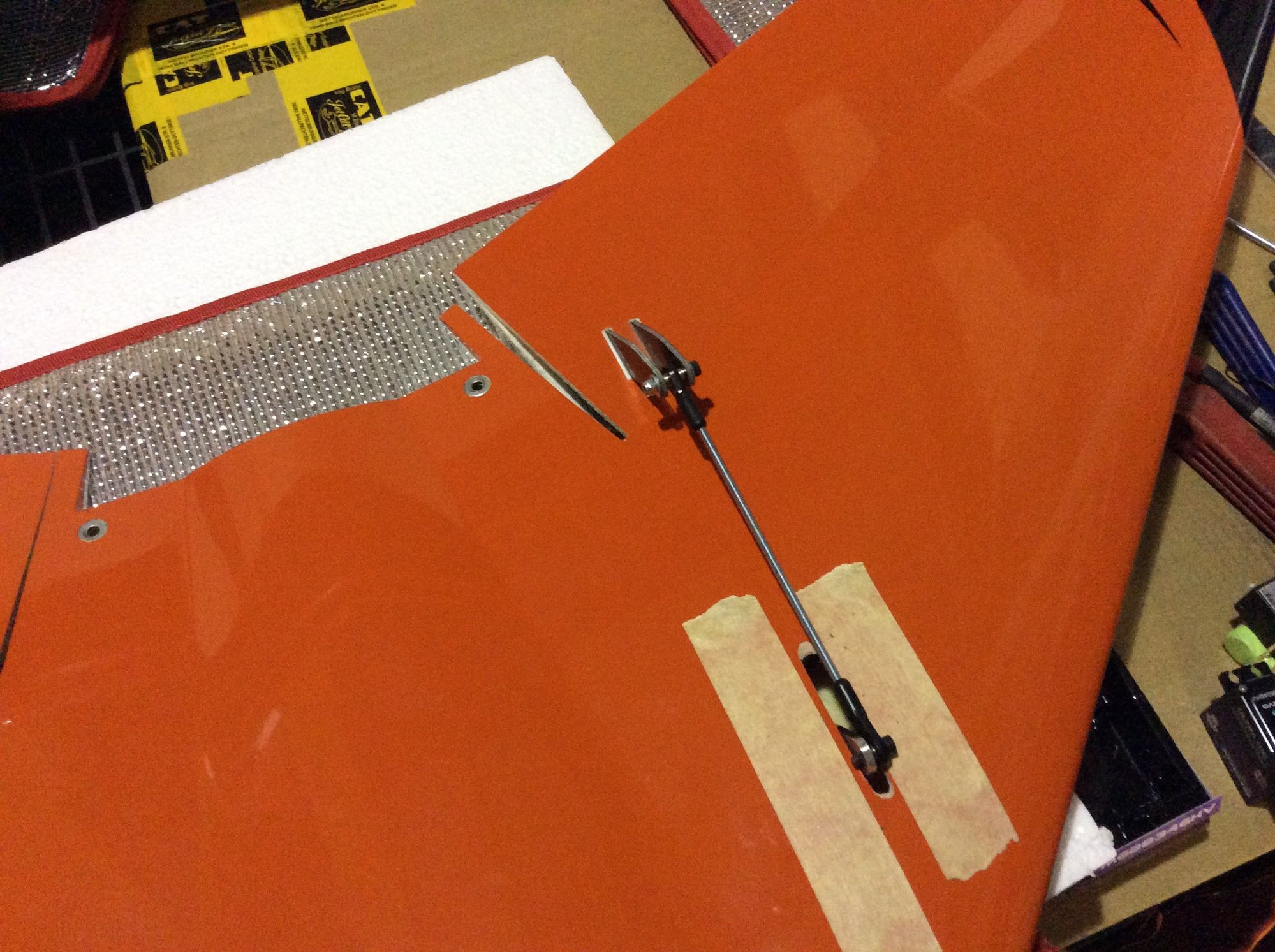

Looking at the wing today. Quick check on the slot position with my MacGregor servos and Secraft arms using thin wire. The rod indexes on full movement so this is the slot shape I ended up with.
