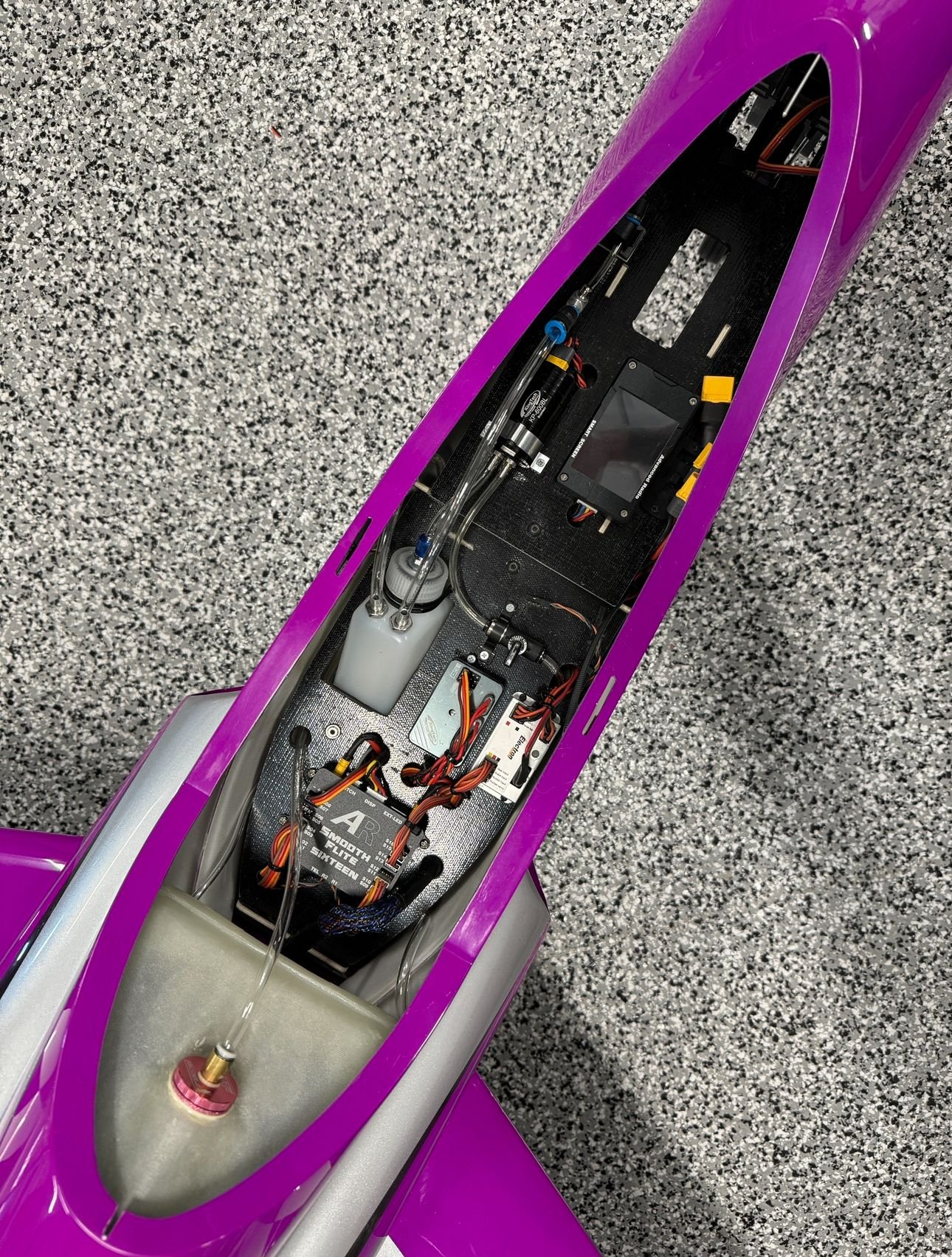

I have two questions, has anyone have good pictures of how they have the two saddle tanks held in place and which glue is best for canopy gluing?
Old 09-19-2023 | 08:17 AM
  #164
Joined: Jun 2002
Posts: 13,258
Received 788 Likes on 571 Posts
From: Watford, UNITED KINGDOM
I used Velcro!
ZAP560
