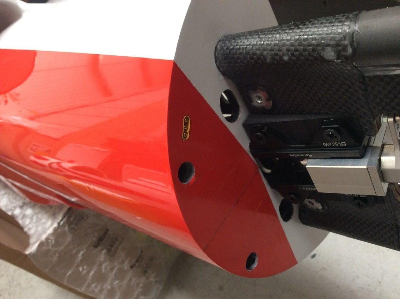

Originally Posted by Dave Wilshere
The harder I try to get free time...the more people visit me! Today has achieved little, but the last real construction was finished last night when I fitted the nose gear servo plug & socket. I mounted the plug in the fuselage and socket in the nose. The plug was mounted first and two strips of masking tape laid back to back were tasked together with spray mount. The position of the plug was cut through both layers, then the nose installed. Separating the two layers allowed the tape to stick to the nose and once removed the exact position of the socket was cut...lined up first time 🙂
Hi, does the servo plug give you any trouble over time, would you recommend to install the same plug or just manually insert the servo cable to fuselage?
Old 07-15-2025 | 12:34 AM
  #193
A343's Avatar
Posts: 260
From: Hoersholm, DENMARK
I have mounted a MULTIPLEX plug on the nose, socket on the fuse, same location as the yellow AMASS plug shown. This gives me possibilities for a beacon light on on top just behind where the clear canopy glass ends. Just slide on the nose to the fuse, works great 👍
Old 07-15-2025 | 08:58 PM
  #194
Joined: Jun 2002
Posts: 13,258
Received 788 Likes on 571 Posts
From: Watford, UNITED KINGDOM
Plug has worked perfectly over hundreds of cycles. As long as you mount it securely you won’t have an issue. This is a Powerbox One4One lead
Dave

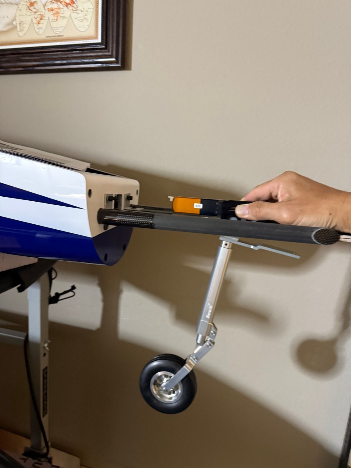

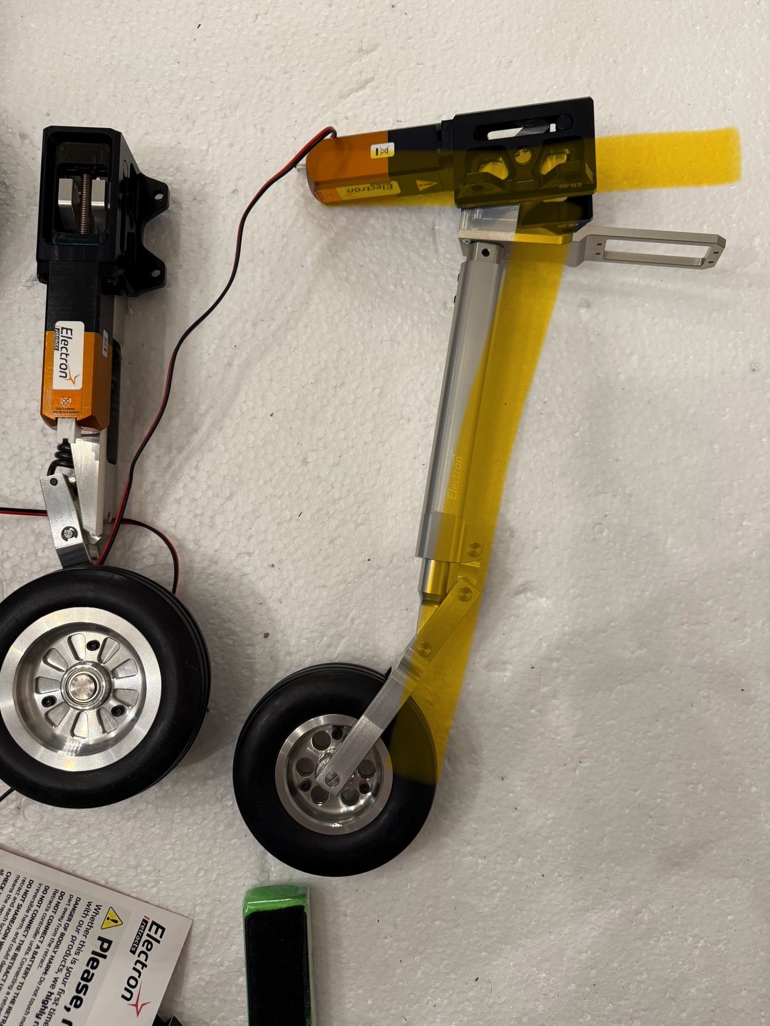

Old 07-18-2025 | 04:22 AM
  #197
Joined: Sep 2005
Posts: 20
From: Missouri City, TX
The electron nose gear came with 100deg trunion so the struct is pointing backward, is this a mistake should I be using gear with 90 deg trunion Instead?
Old 07-18-2025 | 11:02 AM
  #198
Joined: Jun 2002
Posts: 13,258
You need to look at the thread and get the two wedges out to mount the nose unit….
