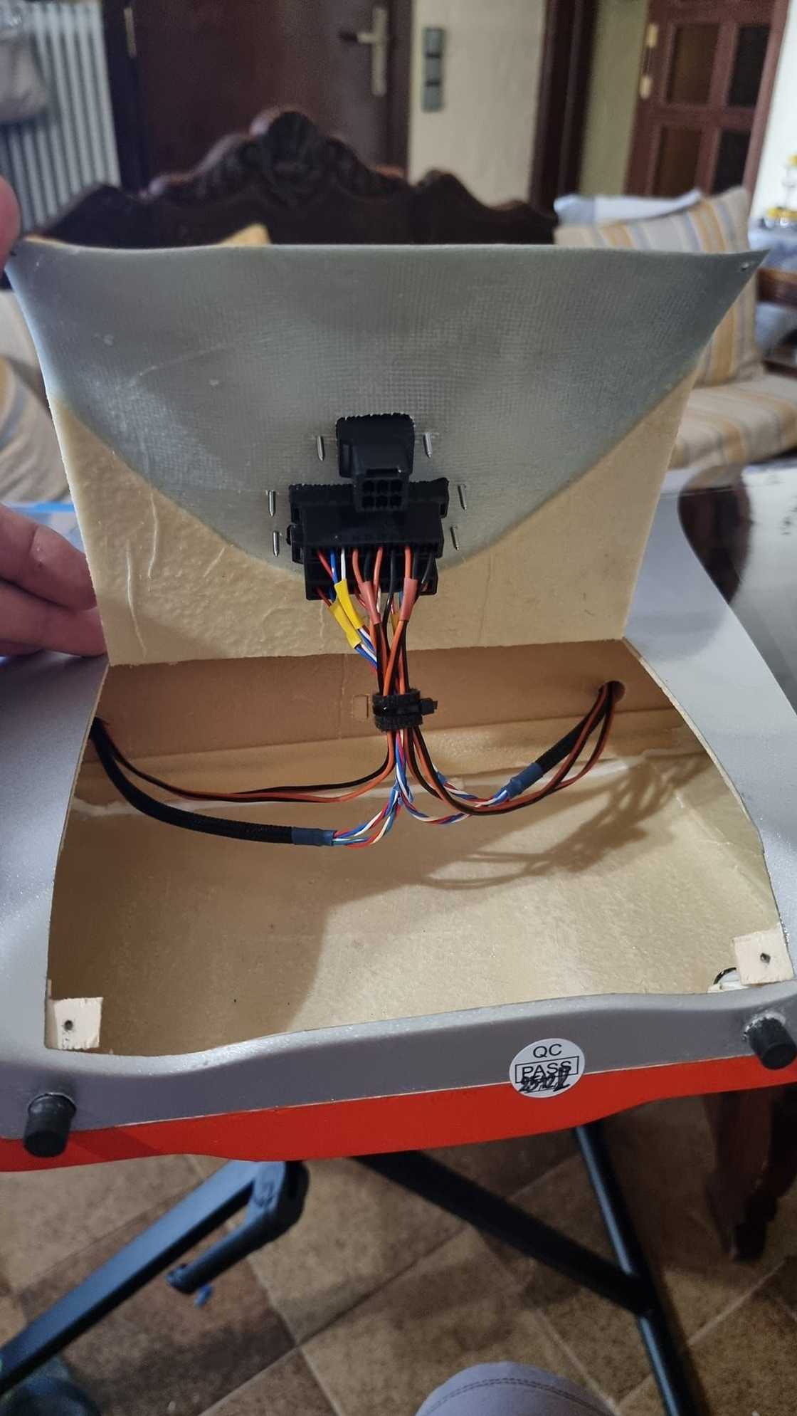

i have placed all the conectors in the cap of the wing tank (i havent installed one though).and i have wires comming from the fuselage side.

Originally Posted by zx6rg2
Hi has anyone got a easy way to connect the wing servos ect the fuz
just give attension if the plugs interfere with the wing.

Nice idea , MPX plugs are more compact and may be a consideration
But the QC sticker is a joke !!!

Cutting out that much of the center-wing on one side - isn't that affecting the strength of the whole wing ?
it was like this from factory.this is the space for the wing tank if you want to instal it.

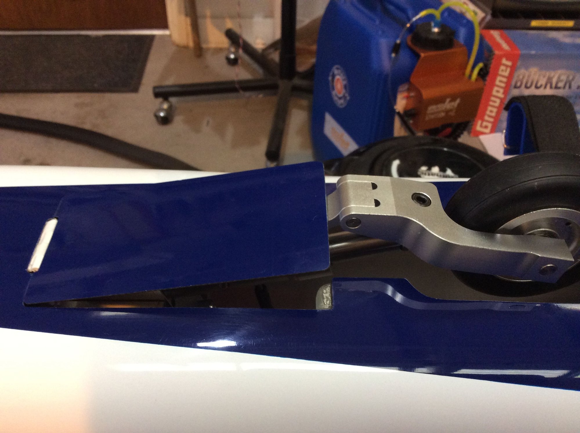

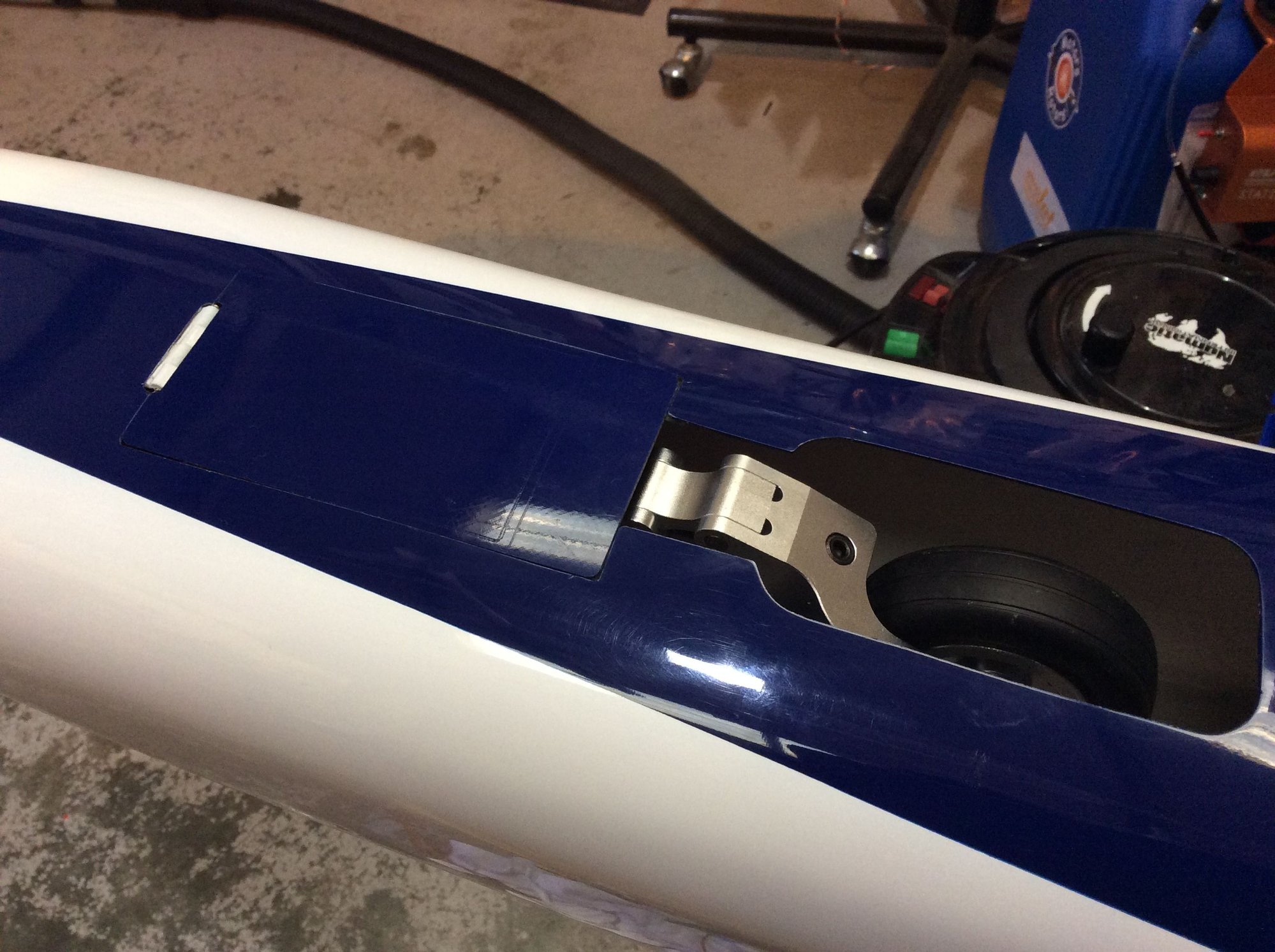

Can someone measure the electron strut length for me? Does this look a bit oversized? You can see the retract black mount with screwing holes is pushed all the way back on the nose gear tray/former. I can open up the nose wheel opening slightly but the wheel kinda overshoots the instrument tray wheel hole as well.. Does this look ok?

Just make the hole bigger so the nose wheel clears. I had to do the same. It doesn’t take much.
it was designed for the JP gear.

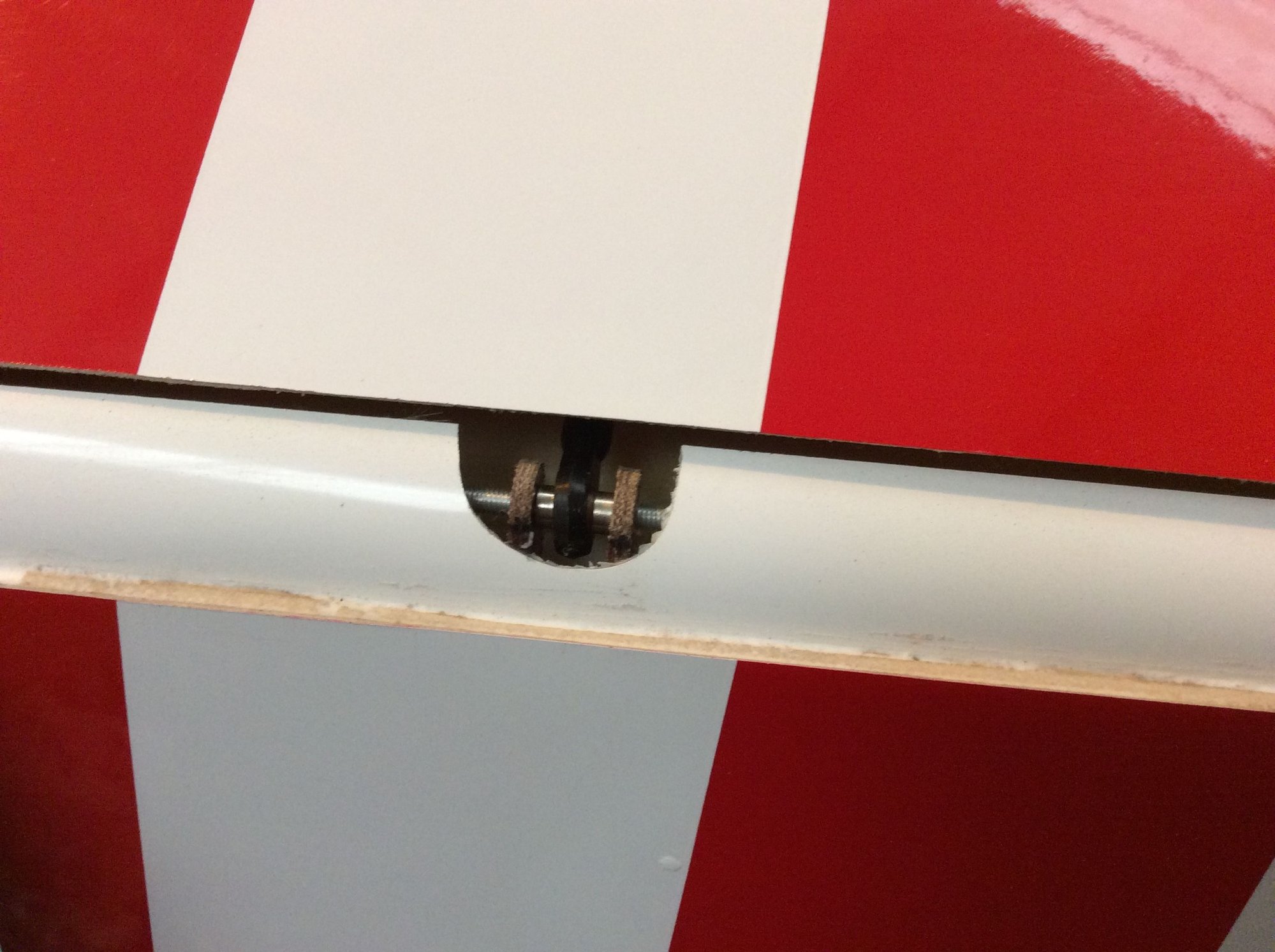

Flap question.
How do i start? As the servo trays are already glued to the cover, do i first connect the metal clevis on servo side and then
slide the ball link side out of the hole towards horn on the flaps? Or the other way around, quite a sketchy task.
thanks

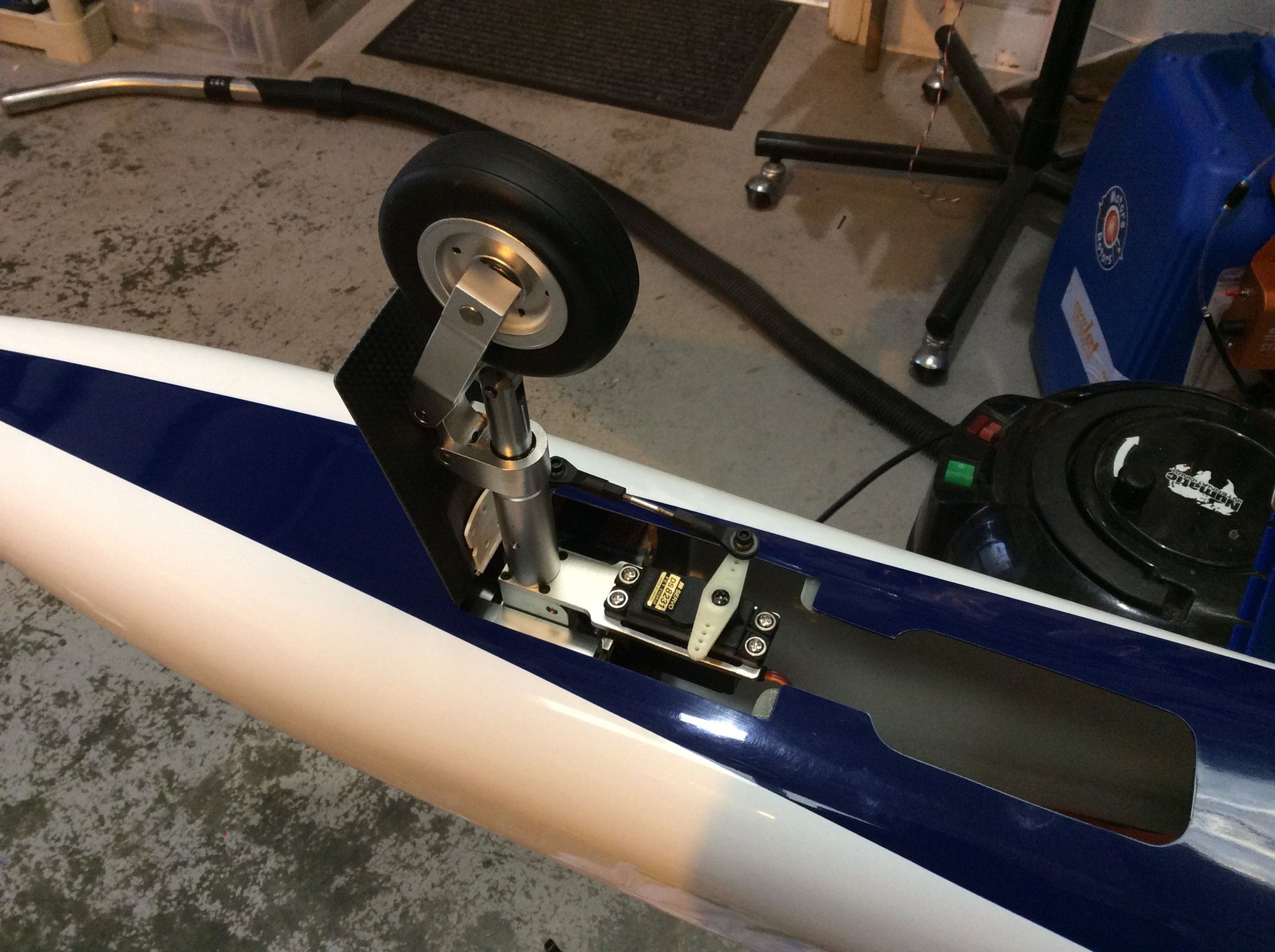

It does look long. Leg length is only part of it. The trunnion length and pivot point on the frame will vary the final axle position.
main gear is likely to be fixed length, so put the gear down, wing on. Stand it on bench and see what angle it sits with the nose leg length you have.
Flap is easy. Work out where the servo spline is on the cover hatch. Mark that through onto the top wing skin. Put a 15-16mm arm on flap servo. Set it with your radio, you want the servo arm angled back at full flap, it will swing forward to flaps clean. Put the servo arm in the landing position, mark the hole distance back from servo arm centre on the wing skin. Put a pushrod on the flap with ball link. Put flap at angle you want, lay the pushrod over the mark and mark the pushrod with a pen where the servo arm hole is. Put the flap clean and mark the skin with the pushrod travel. That is the servo travel you need to set in your radio flap travel.
Cut the pushrod and add the clevis/ball link you will use.
It’s normally easier to attach the servo end first, feed the pushrod through to the flap and add fixing screw once the cover plate is in position.
Easier to do than read!
