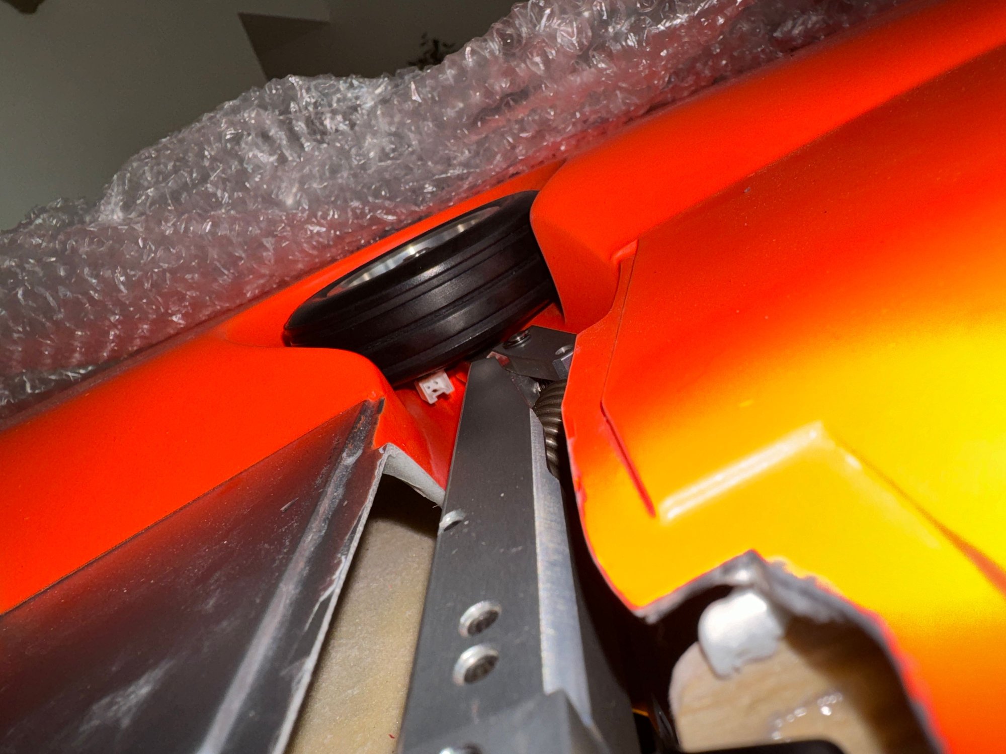

My latest CARF model was shipped without the holes cut for the main gear wheels in the fuselage. It was covered in quality control stickers and I wonder how such a large visable mistake was missed. No big deal for me, I did the cuts and may have done it better.
When I built my flash, with elecrons, I needed to extend the opening to make the nose gear fit. The longer leg will make the airplane have a higher angle of attack for takeoff and this may be an avanatage.
Old 01-15-2025 | 08:37 PM
  #859
Joined: Mar 2023
Posts: 71
Received 6 Likes on 5 Posts
Did you also have to enlarge the fuselage tray wheel opening for the wheel to sit flush?

The brake pin on the electron gears is quite close to the wheel well wall, i guess max i am able to get is 1 - 1.5mm leverage. Did anyone here with electron gears had to modify the underside of the wheel well so that the pin does not hit the skin?
Old 01-16-2025 | 12:19 PM
  #864
Joined: Jun 2002
Posts: 13,265
Received 792 Likes on 575 Posts
From: Watford, UNITED KINGDOM
I always pack the gear so that the wheel/tyre is flush with the lower surface…least amount of drag.
that gives clearance
