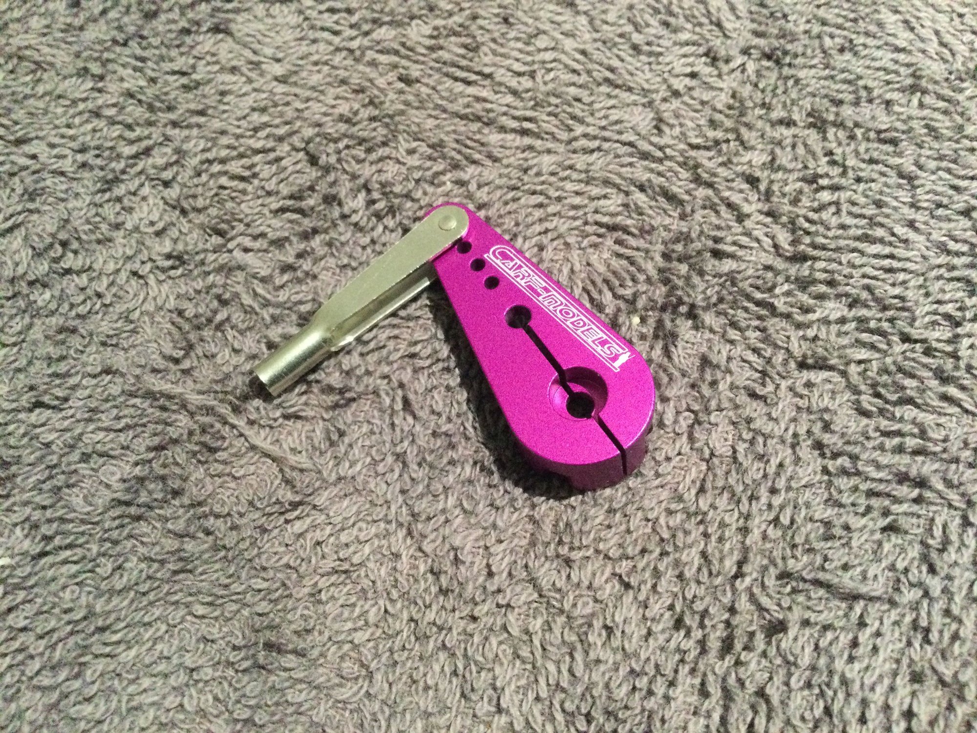

Not able to find appropriate metal servo arm of the correct length for my flap servo. I did order shorter Kst servo arms but the holes are m3 which are too big for the supplied metal clevis,
Is it ok if i use ball links on both sides on the flap linkage (on the flap side and on the servo arm side) Is there any negative of such linkage that you can think of?
thanks
Ball link is fine. But CARF make a suitable arm for the clevis pin.

Looks like no problem, thanks
Originally Posted by AEROSHELDON
I used a ball link on both sized with no problems... you might need to open the hole the pushrod goes through but I think you need to do that anyway.
