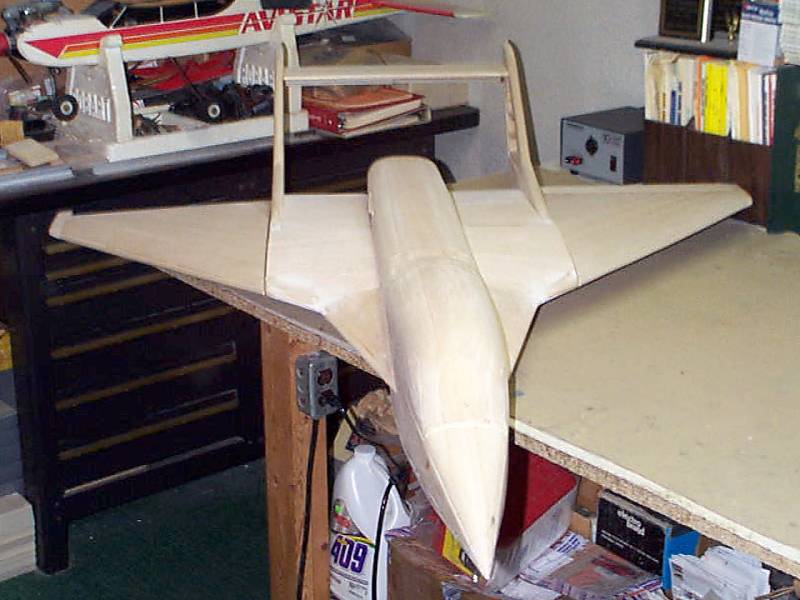

LOOK AT WHAT I BOUGHT !!
A friend bought the Eagle V plans about two years ago and started building it. Later he realized that a turbine was not in his future anytime soon. So I bought the project off of him. It probably won't be finished anytime soon. I wanted it as a back up in case anything happens to my Turbine Enforcer.
The Eagle is about 90% built. He made the booms 1/2" wide so that they would accomodate thin wing servos. The canopy is carved balsa and rather heavy. I'd like to find a suitable plastic canopy and re-do it. Anyone have a canopy suggestion?
Joe
Joe

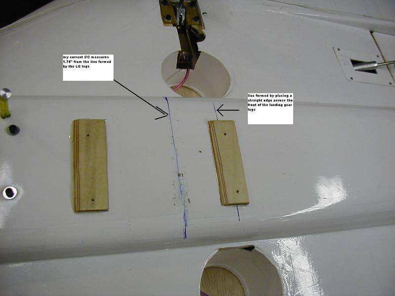

Here is my current CG.. see the PICS I built my EAGLE as one piece so I hope you can balance yours using these pictures
I fly with high rates on rudders, low rates on Aileron and I take off with low on elevator then switch to high on the elevator for landing
