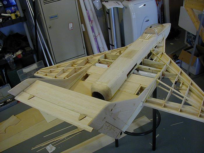

Another question for you,
What' the black thing coming out behind F8 to the outer part of F9?
Martin

Default RE: RCM Eagle V
What are you looking at ... one of my pictures or the plans
call me 302-762-0816
Old 05-04-2007 | 12:06 PM
  #124
geh3's Avatar
My Feedback: (84)
Joined: Oct 2003
Posts: 1,374
From: wilmington, DE
OK I figured it out. That black thing is just 1" wide black electricians tape that I was using to keep the tank snuggled back against the former in front of the turbine during the building process. I had the tank in there to make sure it would fit OK and once I glued the turtledeck on I couldn't get it out easily so I just left it in there!
