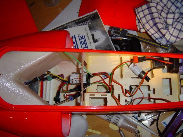

Made some blocks for my engine mount, and threw it all loosly into the plane.
its 15mm tall, but might have to add a few mm more.....maybe.
And....I have bought new fuel stoppers for the tanks that wil take jetfuel/petrol.
ID:	255269   Click image for larger version
ID:	255270   Click image for larger version

I changed the setup a bit.
To get the tanks on CG, I had to remove some of the former hloding the inlet duct. I also reshped the inlet with heat, so the tanks fit.
This also enables me to move the engine further forward.
ID:	255614   Click image for larger version
ID:	255615   Click image for larger version

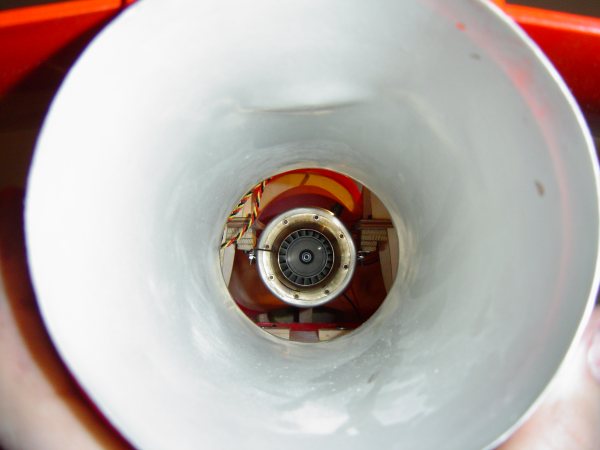

Installed the engine.
My engine mount had to have 20mm of shims added for the engine to be centered.
ID:	255709   Click image for larger version
ID:	255710   Click image for larger version
