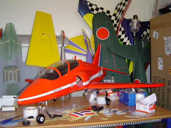

You guys seen the new scheme from AMD?

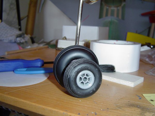

Have to install the aileron and flap, and nose wheel servos, radio gear, tanks and turbine. Shouldn`t take that long.
I got a more suitable nose retract unit, and modified the nose wheel well for it to fit. Now I can have a larger diameter nose wheel, which will be much better on my grass field.

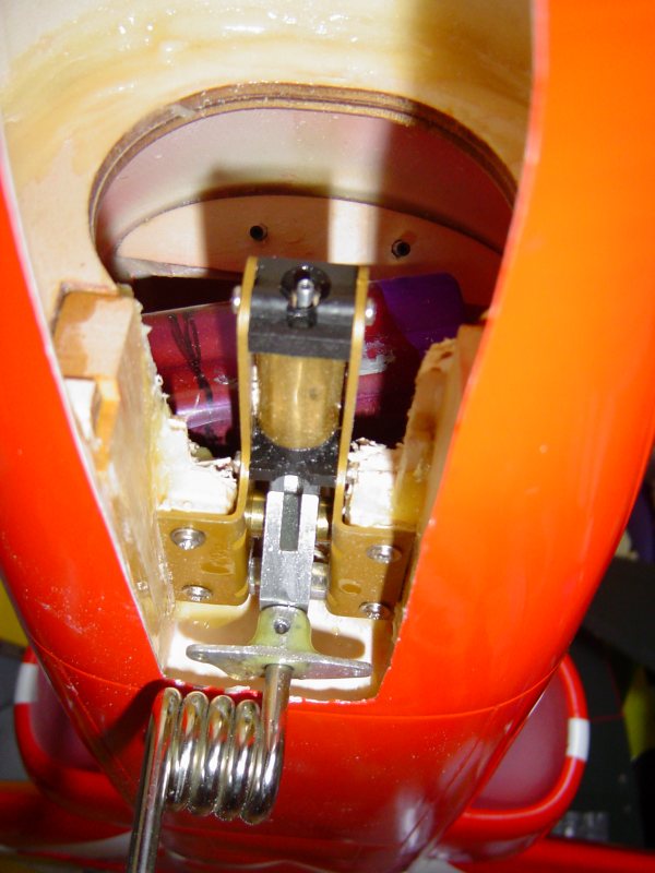

Where have you installed the elevator and rudder servos ?
Old 04-06-2005 | 09:45 AM
  #148
Joined: Jan 2004
Posts: 2,081
From: glasgowScotland, UNITED KINGDOM
Default RE: AMD Hawk.
Sonnich
I am going to copy your rudder / elevator installation on post 71 (with your permission of course). It looks like you have passed a long cap screw through the elevator control unit and then used a piece of brass tube as a spacer between a ball joint which connects to the push rod /servo arm, and then a nut secures the whole assembly, is that correct?
There does not seem to be all the hardware to form this unit so I take it you have made up your own.
The instructions are a bit sketchy about this assembly.
John
Old 04-06-2005 | 11:33 AM
  #149
SJN
Posts: 6,326
Received 7 Likes on 7 Posts
From: Copenhagen, DENMARK
Hi John
Yes, you are correct. But I ended up using a shorter allen head screw (cap screw? ) than on the picture. This is a very steady setup.
Chuck the manual away, and build it better
Hardly any of the hardware in this kit can be used......lots of stuff, that can be used for nothing
but it doesn`t matter much.
