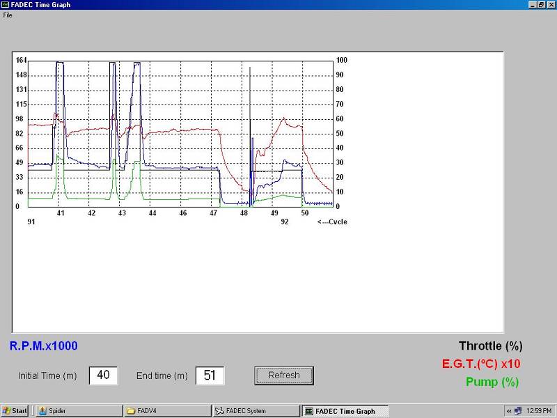

I did 2 run today on a stock engine .first on with a flightworks 200 pump and again with a jetjoe pump.It got to 720 with a 44mm dia tail cone. stock clearance motor . can not say for sure on thrust as it was on test stand and I check thrust in air frame tied to strain gage. I was surprized that jj pump ran just as good. It is 0c out and it pulls hard at this temp.

ORIGINAL: myring
GRW 688 bearing can operate up to 300 degrees as well as other GRW bearing without retainer. Higher thrust means higher EGT which deteriorate bearing. The inner race of rear bearing in my engine has gotten a blue color on the rear side due to heat impact. I don't know how long it can work for.
Forget tail cone design and size (or twin or single) for the moment, you are even able to run it without a tailcone at all. Yes tailcone
will effect temps but they are much more related to getting more thrust from the turbine exhaust gases.
Blue as found is a good indication of very hot running. The likely fault is an uneven burn from an uneven or blocked manifold. If the manifold when tested on gas set up (see pic http://www.rcuniverse.com/forum/m_29..._3/key_/tm.htm )
Note the needles are clear but the flames are not even height and need to be corrected.
The fuel needs to be directed towards the hot face of the sticks to vapourize quickly and evenly.
As Shadow9926 stated
" Idle is often when the EGT is highest, but your temps are too high. If you can notice any hot spots on the tail cone at idle , then I would suggest that you may have an uneven burn problem, either to do with the combustion chamber or a blocked fule manifold (more likely).
I have seen blocked fuel manifolds cause engines push the flame out of the exhaust and the needles on the JJ-1200 are only 24g so any small amount of dirt or flux from the soldering process could be blocking one or more needles"
THere are other reasons for the tailcone to glow bright red but not on the latest JJs.
How old is yours??
Then if all is fixed and corrected you can use my earlier post on the FADEC set up and training which directly helps temps to achieve cooler running (only with a very good turbine pump, buy the best and filter fuel regularly.)
Paul

myring
The FADEC advice is still good for the Regal semi auto FADEC,
Pump start point, The values of “pump start point†from 0-8 in a auto mode, will adjust itself pump power to start it slowly. Settings
are either Auto or manual a value of 0-255. On manual the higher the number the poorer the pump or its running condition. So if fuel is slow getting to the engine go to a higher Auto say +4 to test it. I use manual to tell me changes in pump condition each year as a check.
Start Ramp the increase of fuel flow during the start phase. To greater value, more quickly the motor will accelerate until the idle (also note the hotter things get at the exhaust)
Test if your TX is correctly aligned, min throttle is may be 36k and max 160k.
Stability delay, the parameter allows to stabilize the power once this has arrived at the value set with the throttle control. The value must be increased if the power is not stable. normal set say 50 but you can use 100 if things are unstable with rpms up and down.
Change too many parameters and it defeats itself and so then return back to factory settings.
Paul

I did a test run again yesterday. This is a little cooler start not exceeding 750 degrees by reducing start point setting to AUTO+0. But the engine need raise the fuel level higher than engine to reach idle. This makes me believe that JJ pump is so poor. Do you think that intermittent flame and pop noise occur is due to blocked fuel manifold at idle speed?
Another problem I have is engine only can reach max 110k rmp. Is it due to poor JJ pump again?

I am pleased that some things are improving for you. Three things I think confirm your thoughts and point to the pump, fuel needs to be above the pump (not usually necessary at all), flame and popping noise point to irregular flow +/or cavitation (i.e air in the line). then lack of max rpm. The last needs checking in three ways, is pulse on second screen showing max pulse width when stick is at max, is battery voltage reading above 6.5v at max rpm (might be a failing cell) and this lastly also checks the ECU is calling for more rpm, therefore higher voltage, therefore more pump rpms to deliver more fuel leading to max rpms on turbine.
Time to try a really good pump I think.
