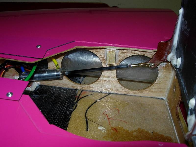

Here's mine - Note the balsa block glued in at midspan of the actuator rod. Some of us have experienced the door pulling overcenter when opening, thus preventing closure. The block prevents this condition.

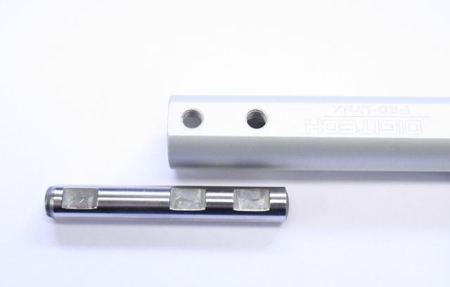

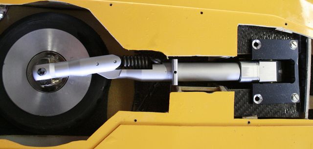

ORIGINAL: luckyy
has anyone found any trailing link landing gear that works yet for my lightning
we just done doing them
this is also for all who asked me about springs and different setups
after trying 3 different oleo,s this is the final one..
ID:	954135   Click image for larger version
ID:	954136   Click image for larger version

ORIGINAL: pfact
Sandor,
Will your trailing link struts fit into the new Ultra-Lightning wing?
We are waiting for our Ultra-Lightning to arrive - we probably won't see it before late Summer since they are not yet done with the new mold for the modified fuse. Several of the old lightning's at our field used P-160's and found that the increased weight and residual thrust were too much for the Behotec brakes. Can you recommend a system with more power than the Behotec's offered by C-ARF? We plan to use a P-160SX.
Phil
our new oleo,s do fit the ultra lightning wing , infact the first set went to someone who owns a new UL.
yes you need a larger brake system for more brake power
i suggest you use the jet-1A wheels for that
they have 110mm wheels and large brake setups.
and they use diskbrake instead of the pushout o-rings
they do fit our lightning struts also.

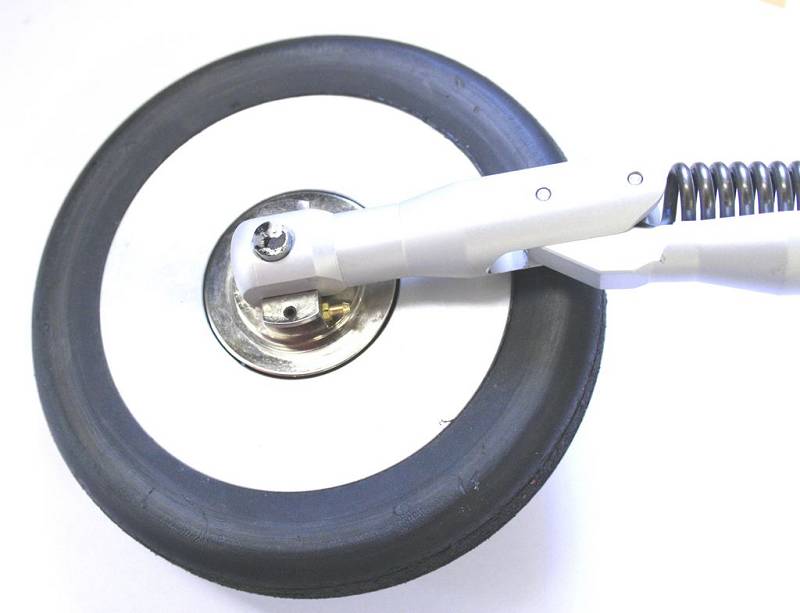

ORIGINAL: jeanfi
Very nice struts Sandor !!
What is the price ?
Jean Fi
have a look on our website , i promisse you wont fall over
also i am getting some emails concerning all the changes needed to be done.
this is a rumour spread by competition , but not to worry
here is a small manual so you can see what work is needed!.
[link=http://www.digitech-turbines.com/manuals/lt-0802.pdf]C-ARF Lightning (ultra) 08[/link]

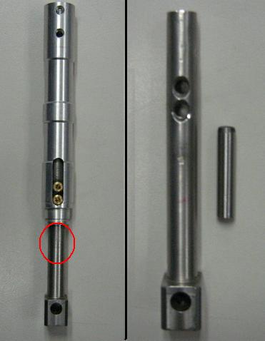

For those using the stock Behotec main struts...
The lower section is hollow and has a weak area - see red circle below. The strut can bend here & cause binding, preventing it from sliding in & out smoothly. Inserting a piece of 6mm dowel stock eliminates this weak point. I've been using this mod for the past couple months off rough grass, including a few hard landings. I have not had any problems or issues.
