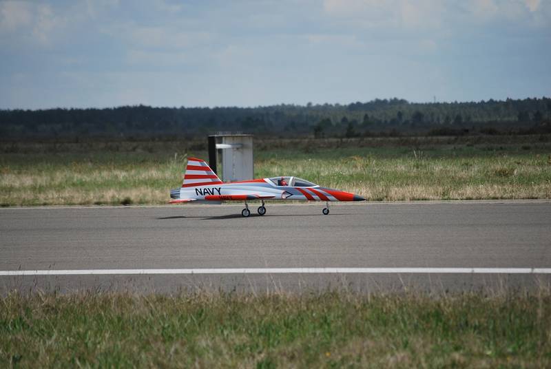

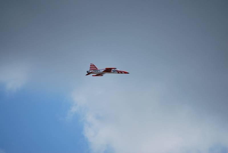

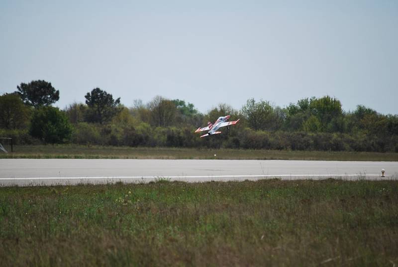

Hello,
Maiden flight of my Lightning on Saturday.
Everything ok and a smooth flight !! Delighful !! :-)
You can see I had to pull up the elevator a lot to take off, so the plane has jumped in the air...Not very good for me.
I didn't use any flaps for take off for this maiden flight...Maybe 15° of flaps deflection will be the answer to this behaviour.
jean Fi

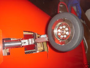

1. My friend got a classic lightning (used) and he wants to use his existing JR 8611A servos through out, with a PB Champion and twin 2800mAh PB packs with a P-160SX - what do you think of this setup ?
2. Which LG is this in the picture ? retracts, struts and wheels ?
3. Can anyone recommend a nice pilot figure for the lightning ?
Please advise.

1. This is great setup but needs alot of weight in front to balance. A good idea would be to install Tam's pipe and save around 200gr from the back and then the weight required to achieve the CG in front is reduced.
2. I think these are Dreamwork's struts and Intairco wheels and retracts. However for really heavy duty struts I think the new BEHOTEC struts are on a league of their own

Just varified that the wheels are Intairco for sure (jsut as on their website), and the struts are Dreamworks (just like on their website).
Anyone has any idea about the red retract bases ?

Yes Lior,
The retracts of Intairco are red and these should be Intairco. Try sending an email to Peter ([email protected]) from Intairco. He usually answers very fast.
Tassos

I like how the main strut is drilled for multiple pick-off points for the outer gear door....somebody was thinking there!
