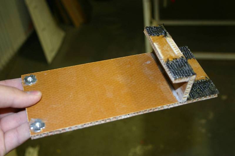

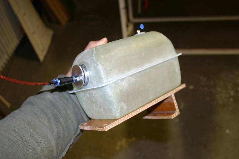

Next step:
I am not the biggest fan of coke-bottles in jets. I used them several years with great success, they are damn cheap, but: the use up a lot of space inside the fuselage. They spread the fuel on a large surface. We have cut the middle former, after we made a template of it (you never know). The fuel-cells will be held in place by honey-comb-plates. They lock under the wing-tube at the rear and two bolts at the front-end hold them in place. The fuel-cells are laminated over positives. They will be glued onto the h/c-plates. The tanks hold 2.2 litres each, makes a total of 4.4 litres. The trhee coke-bottles hold 4.5 litres. And there is still lots of room for a header and one or two smoketanks. They will be made the same way as the fuel-cells. Not as stylish as the Jettech kevlar ones, but cheap. And it feels good that you have made something unike
David
David

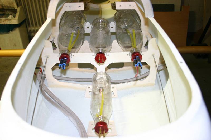

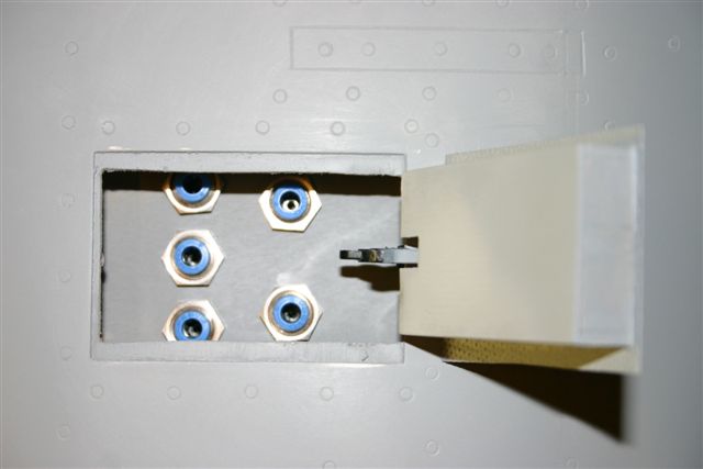

Just forgot these two:
If you didn't know how it looks with the coke-bottles: left and right are 1.5 litre bottles, in the middle there is a 1.0 litre bottle and the one in front holds 0.5 litre. The rear spars are made to suit three of the 1.5 ltres bottles, but I just had two.
The Tutor in the pisture belongs to either MArtin Foster or Martin Sannwald from swiss model shop. The flew a very nice display at the german masters. This picture shows how nice and slow the Tutor comes down for landing. I can't wait to see mine in the air.
David
David

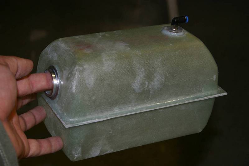

#59
Hi Dick!
The tank-fittings are made by Erwin Tratz aka airtech-germany. Try webmaster[at]airtech-germany.de They are not on his webside, he is probably to busy making retacts for the jet-guys....

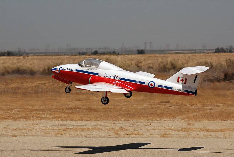

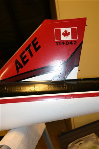

Steve Rickett put the first two flights on his 114 in AETE colour scheme at RAF Leuchars on Saturday. The model flew beautifully, absolutely rock solid in the air and very scale performance on Jetcat P120. Landings were superb, this model is very realistic as this the "sit" in the air was perfect and it is very easy to see in this colour scheme.The landing gear is beautuifully made and operates very smoothly.
John
John
John

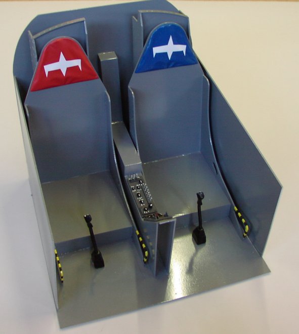

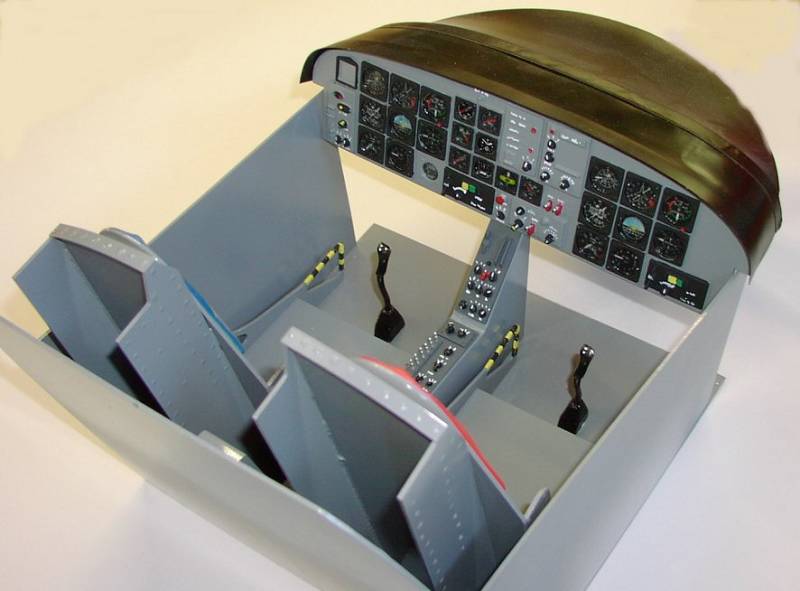

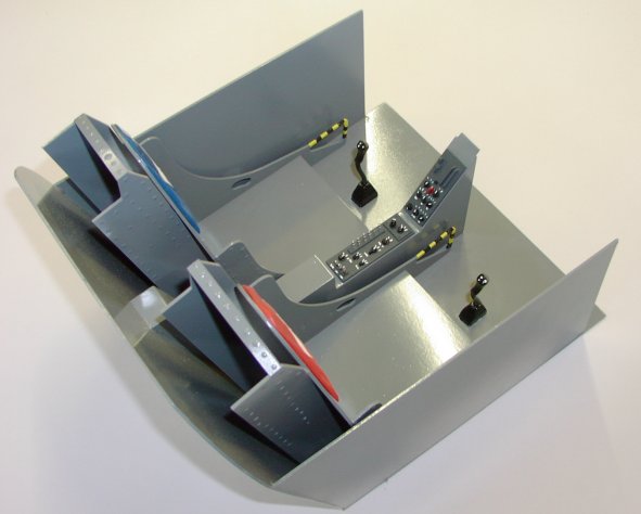

Hi Dave!
You got pictures of the cockpit, I recieved mine on saturday..... Only difference to the one in the picture is the missing Snowbirds-sign on the head-rest, as I am doing the AETE colourscheme.
Good to hear that Steves Tutor flew alright. I am getting paint-masks from him. Still some sanding and filling and sanding, but it is getting close to a painted jet
David
David

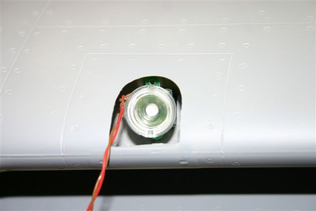

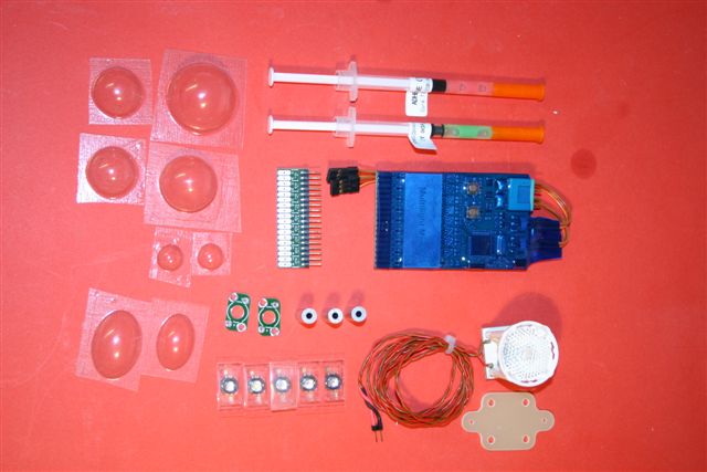

Hi Malcom!
The rudder former and the mould-line were the two reasons, why we decided not to cut the speedbrakes. I would probably cut a square opening in the former, but leave some wood on the inside. Then double it with a piece of fiberglass-sheet on each side. A couple of carbon-rovings between the wood and the fiberglass will give you lots of strength...
The lighting system is made by a german company. As I think a very sophisticated system. The lights are Luxeon Emitters. They are driven by an electronic-board which has connectors for each light. It is good for a 4.8V battery. There are two leads for controlling the different features. By programming you can decide to use either one or two channels and you can set the switch-points. For example: I will y-lead the main function to the throttle channel and set positionlights and ACLs htat they are switched just by putting the throttle trim from min to max. So every time I start the engine the lights turn on. The landing-lights will be y-ead to the flaps and set to minimum flap. No problem to fly with a minimum amount of flap if you like to tur on the lights.
I have the three position lights, two red ACLs (bottom and top), a big landinglight in the nose and two small ones in the wings. The ones in the wings are angled at some 35-45° like on the fullsize. I will take some pics of the lighting-system later and post them here.
Best regards,
David
Best regards,
David
#68
Hi Malcom!
Sorry for the delay. The lighting is from www.flugmodellbau.biz . Their webside is kind of weird, you better send an e-mail to Hajo Giegerich [[email protected]]. Say hello from me (Dvid Buesken). I don't know if he talks english, if that is a problem he should contact me and I will translate it for you guys. Tell him what you need and he will tell you what you should buy
. We use just a standard flashing-emitter as ACL, but they do have rotating beacons! Have a look at the pics.
David
. We use just a standard flashing-emitter as ACL, but they do have rotating beacons! Have a look at the pics.David

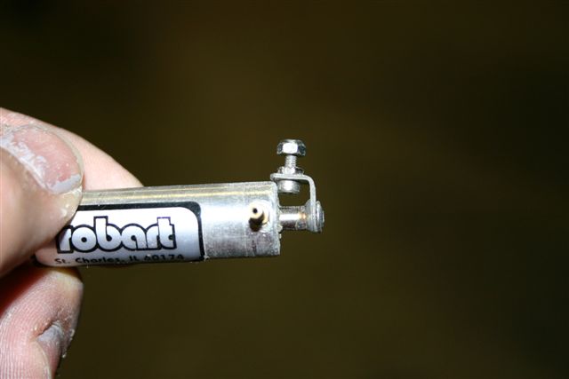

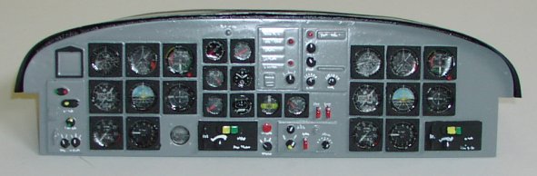

#69

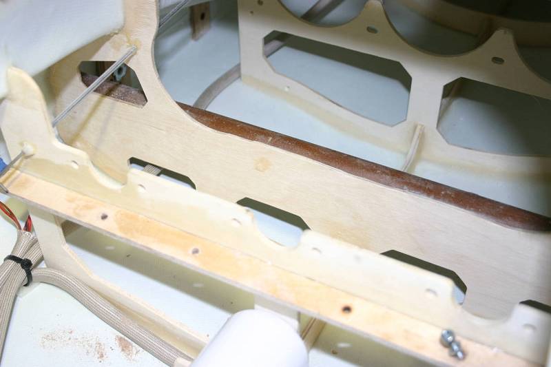

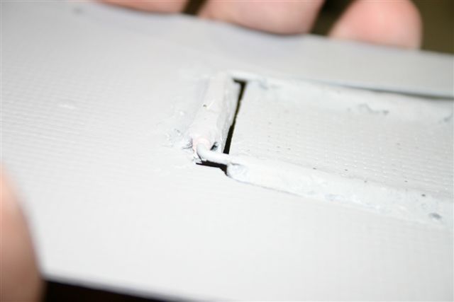

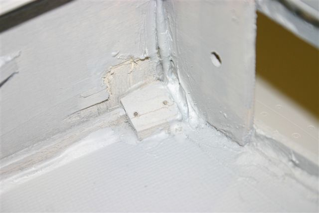

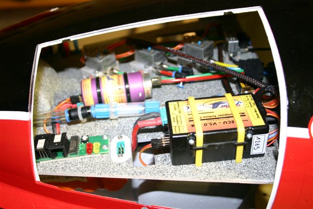

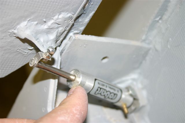

While putting ECU, pump, doorsequencer and Jettronic valves on the rc-board I realized that there is no place to put the fill-valves. So I cut the same door as Dave for easy acces.
The main-geardoors were a little bit tricky. My dad took almost two days to work it out. He used brass-hinges from the home-depot. The doors are actuated by robart-cylinders, crewed to a small wood block in the wing. Works perfect so far. There is not much space for wheels, cylinders and all that sort of stuff.
The outer doors are hinged pretty easy. A piece of plastic-tube is glued to the vover-plate ad a piano wire put inside and bent two 90° angles. The piano-wire is glued to the door. a second tube is glued to the door. A piece of alloy is attached to the strut. A short piece of piano-wire is bent 90°, a ball-link is attached to the alooy piece, the other side just slips into the tube. Hard to describe (especially in english lol), easy done. I will show a picture of the strut....

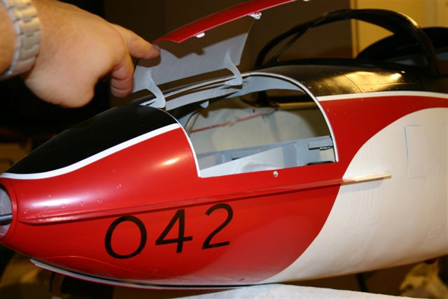

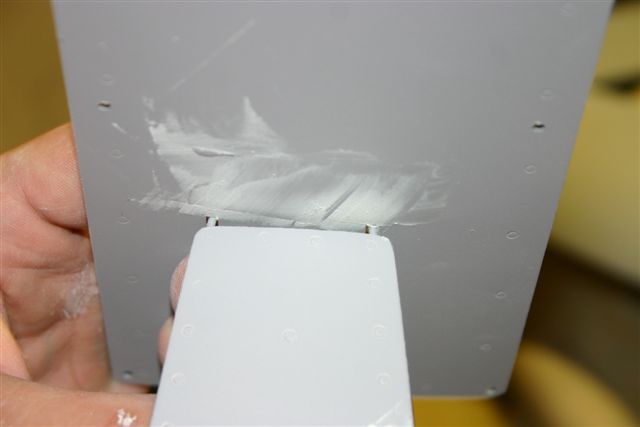

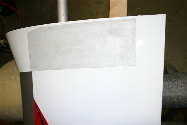

#74

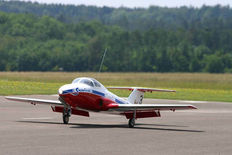

G'day guys!

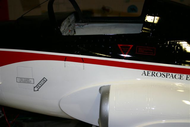

Took me 3 1/2 weeks to paint the Tutor. But the weather was to good, so I went flying instead of painting everyday. and I had to work, to finance all the turine-stuff. Too bad
Her you see the fuselage and some details. Most things are painted on with paint-masks from Steve Rickett. The small decals are made by Ralle from www.tailormadedecals.com . I hope we will get it ready in the next couple of days. keeps us busy for the next days....
#75
The last for today.
most of the radio and turine-gear is placed on the board infront of the cockpit. Good access through the doors. The anti-slippery-whatsies on the wing-root are made with some 30 minute-Z-poxy and some sand out of the bird-cage. After removing the residua sand, it is painted with a slightly darkend white.
BR,
David
BR,
David
