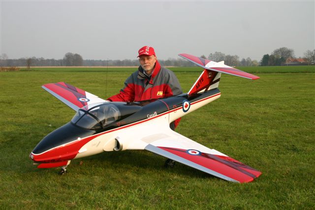

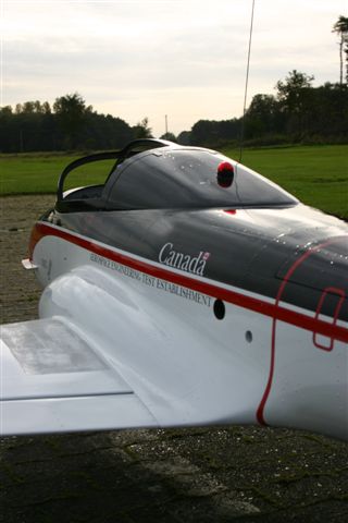

Hi guys!
Thanks for the nice words.
Hard to dicribe the locking-system for the doors, I will post a picture later.
David

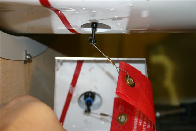

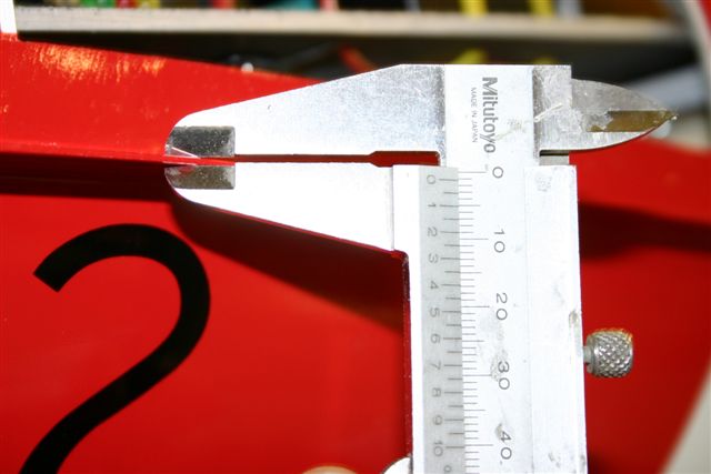

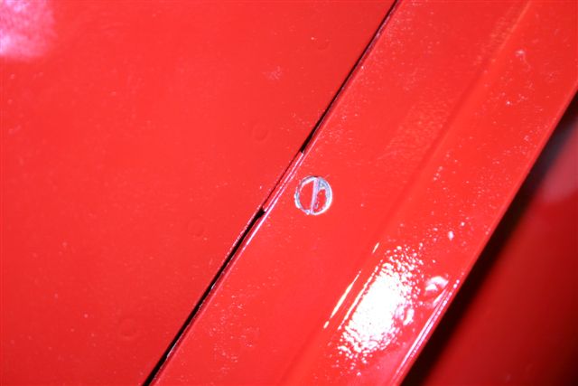

Old 10-19-2006 | 05:06 AM
  #82
tahfiet's Avatar
Posts: 463
From: RaesfeldNRW, GERMANY
Default RE: CT-114 TUTOR ALMOST DONE!
Hi Malcom!
I am back with a couple of pics. The strakes are amde of 1mm fiberglass-board. It is locked with two "latches" and glued with resin. The doors are locked with three short fiberglass-strips. You have to bend the door slightly, so that the glass-strips can slide in. The one in the middle has a flat screw glued to it. There is a matching hole in the fuselage, where the screw-head sits in. To open the door you press the screw-head with a screwdriver and open the door. The idea is from Martin Forster from switzerland.
Best regards,
david

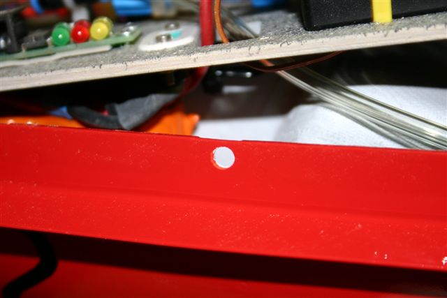

Old 10-19-2006 | 05:19 AM
  #83
tahfiet's Avatar
Posts: 463
Some more pics....
it's getting crowded inside the wings. 5 airlines per wing.... I use some plastic-cable-whatsies to hold the airlines in place. Took a short piece of silicon-tubing to protect the yellow airline at the end of the retract. There is a more or less sharp edge and it needs to be curvy. I have used the instant-air-connectors from dreamworks. They work perfect and I don't know why I didn't buy more of them. The airlines for the retracts ar rooted through small grommets (old servo-grommets) and connected with Festo QSM-3. The 3mm Festo-tubing is not the tightest fit on the black quick-disconnects from dmp, but they are good for more than 7bar! We will see how they work in summertime. The fuselage did look very bad during rigging. Now, most of the parts are installed, all airlines and fuel-tubings are rooted through the fuselage, air-bottles glued with hot-glue and it starts looking nice inside. We have measured the c/g yesterday. There is still the glass-work missing, no lighting-electronics and the batteries for the light and the turbine were missing. It needed 500g lead, so it might work out without any balance-weight. But the JetCat P-160 is lighter than the Peggy.
Almost forgot to mention: I have cut a couple of vent-holes and added cardboard-tubes to get a nice look. The one on the bottom is for my vent-lines. I am using a 6mm Festo-fitting for kero. I still need to add a 4mm brass-tube for the smoke-fluid. I love these small details.....
BR,
david

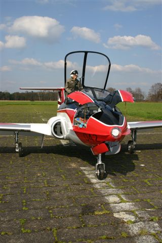

Hi Dave!
Sorry for the late reply. I finally maidend the Tutor. It is a lovely airplane. Still have to do some mods, like moving the CG back and change from NiCads to Lipos. But I've got a couple of pics for you. I like the pics with my dad, cause they show the size of the aircraft.
David

Hi again!
Here are the pictures from the maiden. Took-off in about 80m from a grass-strip. Plenty of power with the JetCat P-160. IIf you fly from a concret-strip a 120 is more than enough, but we fly alot from short grass-strips on jet-meets in europe and the extra power is very helpful on hot days.
David
