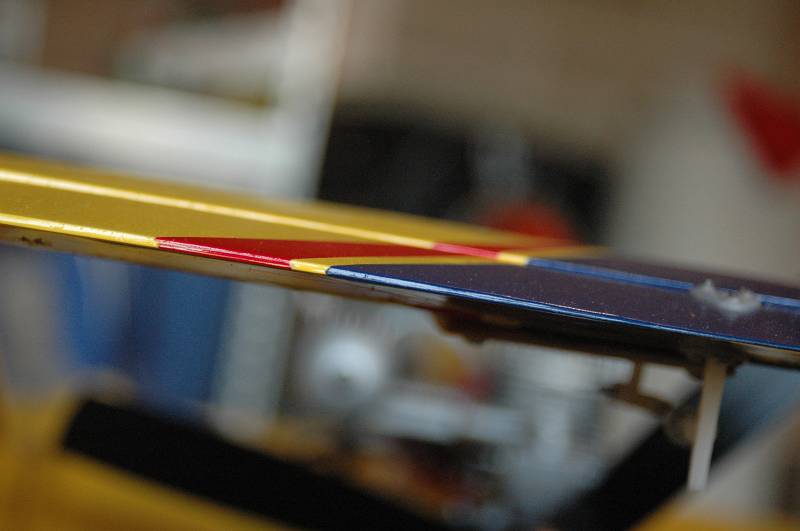

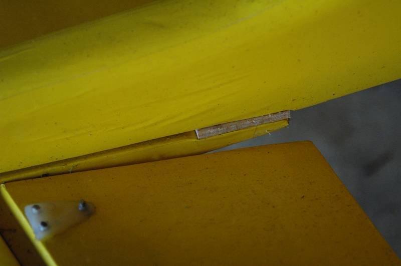

well I think I'm done adjusting my bobcat. In the first photo you can see I added a 1/8" shim on the tail boom and wing and the second photo you can see the elevator is straight with the stab after a flight. my cg is at 9 7/8" and now this planes glides down real smooth and will fly inverted real nice. will have a vid when I can get someone to take it for me. I'm not saying this settup will work for all but it works for me and I'm a happy camper now

I have to agree with you that the flat bottom stab is probably the culprit.

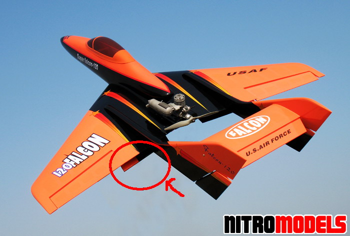

The dimensions of the super falcon are now very close the BVM Bobcat. The Nitro models Bobcat is in my mind a different plane that BVM does not offer the modeler. IMHO the super falcon is really pushing the limits on duplication at least they gave it a different name. I may end up buying one of these at some point if I can wrap my conscience around it.
