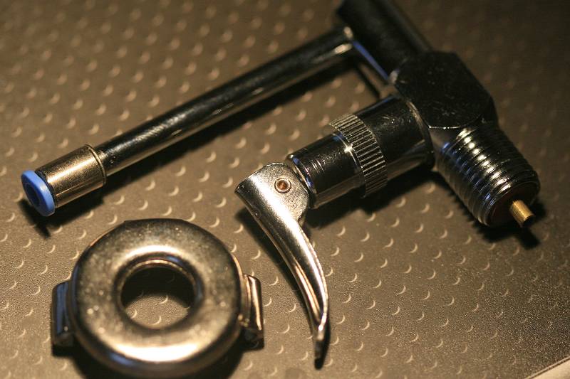

Can someone post a close up picture of the bottom of their Powermax Trigger Valve, the part that mates with the can? I was able to obtain an original PECA TV101A trigger valve from a photographic supply house. It looks like I'll have to cut off some threads to get the valve stem to push in on the can or machine up an adapter. I've e-mailed Daryll Usher for help as well. Thanks.

Here are pictures....
Don
Sorry, it would not let me upload them. It said the connection was reset during upload. I will try again after while.

I will try one at a time..

Another...

And another...

Thanks. Looks like I'll have to cut off the bottom threads to the rubber gasket and then add a little brass tube into the bottom of the valve to get it to go into the can. Can you take a close up of the very bottom that has the brass tube? Thanks again.

Ask and you shall receive...

This Propane Trigger Valve is compliments of Dreamworks. Todd sold me one when I could not find one to buy anywhere.
Thanks Todd.

Synthetic, thanks for the speedy response and excellent close up!
