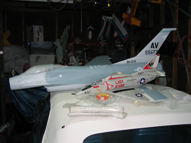

We'll I have the tracking number and it is on it's way.So far Eagle Jets has been great to deal with.I have been having trouble trying to pay with my credit card,It would not go through pay pal so I joined pay pal and it still would not go through.So I went to the post office and got a postal money order,I was unsure about sending just the money order.Eagle jets as far as I'm concerned went way out of there way to help me get the jet.They answered any of my e-mails quick.I'm waiting for a tiger meet style.I paid the extra money for the additional work done, and have a brand new P-70 waiting for it's new home.I hope they do come out with the F-4.
