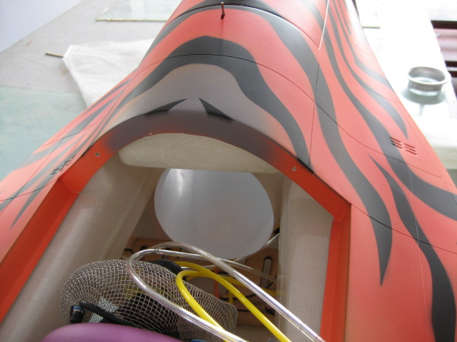

I just had my builders made me an extra tank for this hoggy bird! It's too cold to fly, but not too cold to come up with something neat. That tank was made originally for my Sabre but it fits quite nicely, and holds 22.5 oz of fuel. Now, I am going for a P80.
By the way what's the volume for the 2 saddle tanks?
Mike

That tank looks like it overhangs the equipment tray by a couple inches. As long as you allow for that it should work fine. I'd be interested in one except my tray is already done and I don't want to redo it. Maybe your guys could come up with one that just fits in that space between the mains, about 5 in. X 4 in. X 2.5 in. I'm sure several guys would be interested if the price was reasonable, either for extra fuel or smoke. I'd like about 16 more oz. for my Supersport.
The saddle tanks are one liter each. I measured them.
Joe

Thank you joe.
I pulled out the tank by a few inches just for the photo shot, It can be tugged in just enough to leave the cork out for fuel line.
If anyone is interested in this tank, just send me a PM, I will see if my builder has spare time to make a few more of these. I will just make the tanks that fit with sullivan rubber stoppers, so you can get the stopper from your local hobby stores. I don't like these Chinese made stoppers because they are too hard. Send me $10 bucks for shipping and handling for each tank.
