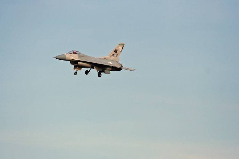

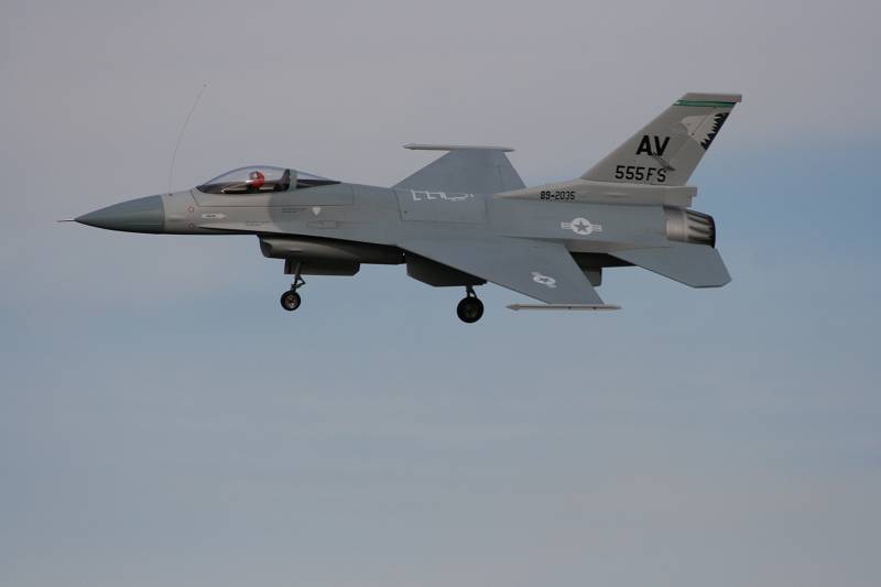

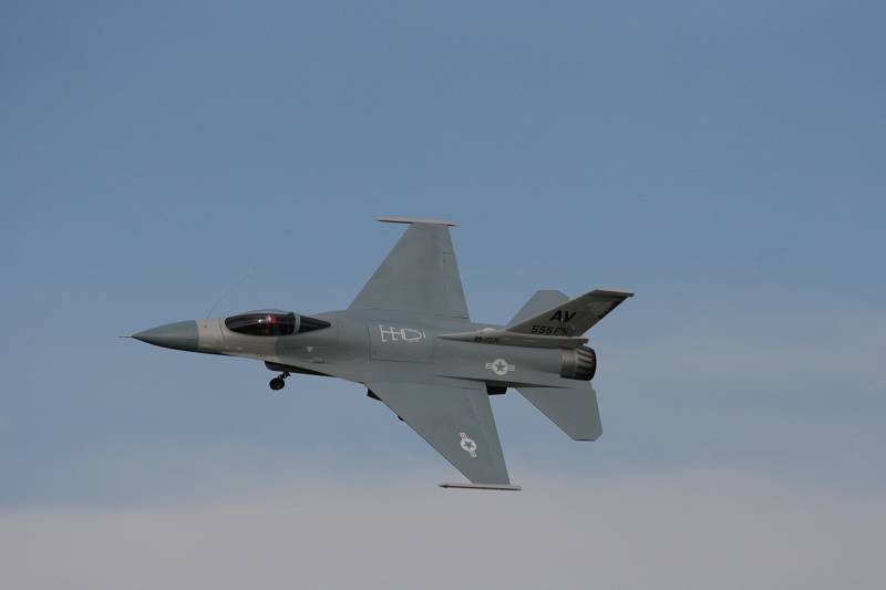

Hi All, today i gave my F16 it,s second flight despite a 20mph head wind and a temp of 10c i went ahead with the c/g now at 145mm back it flew very well ,elevator felt a lot better,roll rate was very responcesive.i had two problems the undercart would not retract with 120psi it just would not go away,yet after the landing it worked fine!! and i have an issue with the tanks not feeding the uat there was still a fair bit left in them yet the uat ran dry and the engine quit after 4 mins,i think this prob is do to a clunk problem and that i will sort out,there is a video which i will try and load up some where and will get back with the url regards Keith

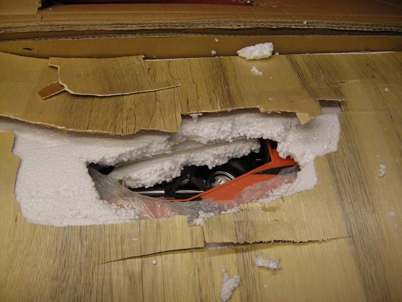

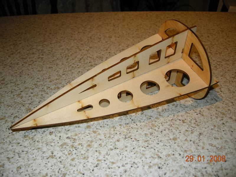

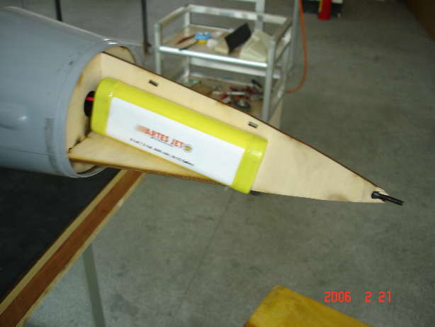

Hi All i recived two more F16s to day one Tiger meet, one Thunder Birds which i had ordered for a friend,guess what wood work turned up with them i guess the early kits were sent with out.One kit had a big hole in box with some damage,any body else suffer with this prob,what did Eagle Jet do about the problem regards Keith

That's interesting. About 4 weeks after reading your posting about balancing your F-16 I weighed my components and did some calculations and determined that I was going to have to put my batteries as far forward in the nose as possible to balance mine.
I sent FEJ an email with a picture of Skymaster's nose formers and asked if something similar should have been included with my kit. The US rep. responded that he discussed the issue with the factory and that they would design and make up a set of nose formers and send them to me.
A couple weeks later I received a set identical to those in your picture. I had to knock out the forward former in the fuse and grind down the epoxy fillet in order to mount them. The problem with the way FEJ designed it is that the horizontal former is in the middle, which doesn't leave room for a very large battery pack. If you look at Skymasters nose formers (see picture) you'll notice that the horizontal piece is lower, allowing more room for a battery pack or two.
I'm not done with mine yet. When I get to balancing I'll probably get a couple of custom packs made up to fit. That certainly is preferable to adding lead.

Send a picture of what you have to them and show them the damges, they are very helpful and will go out of their way to make you happy. WRT to the front formers, I made one from the skymaster webpage and Joe is correct the horizental former is tilted down, so it holds my batteries with no problem.
