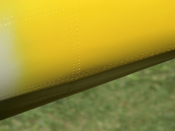

If you look in the 3rd picture, you'll notice a couple of rivets that REALLY stick out more so than the others. Those are the ones that i burnt in with a soldering iron. Personally, i didn't like the way the "burnt" rivets looked. So i took the brass tube, sharpened the inside of it, placed it on the surface and spun it (by hand) a couple of rounds to "cut" into the paint surface to leave the rivet. I personally think that worked out better, for my application. If you have a higher quality soldering iron that has variable heat settings, you would have much better luck. I didnt want to destroy my $80 soldering iron to do rivets, so i tried using one of the $10 cheap irons modified to hold the brass tube.

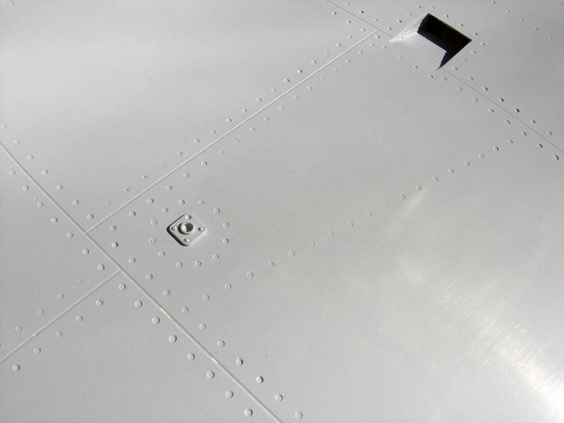

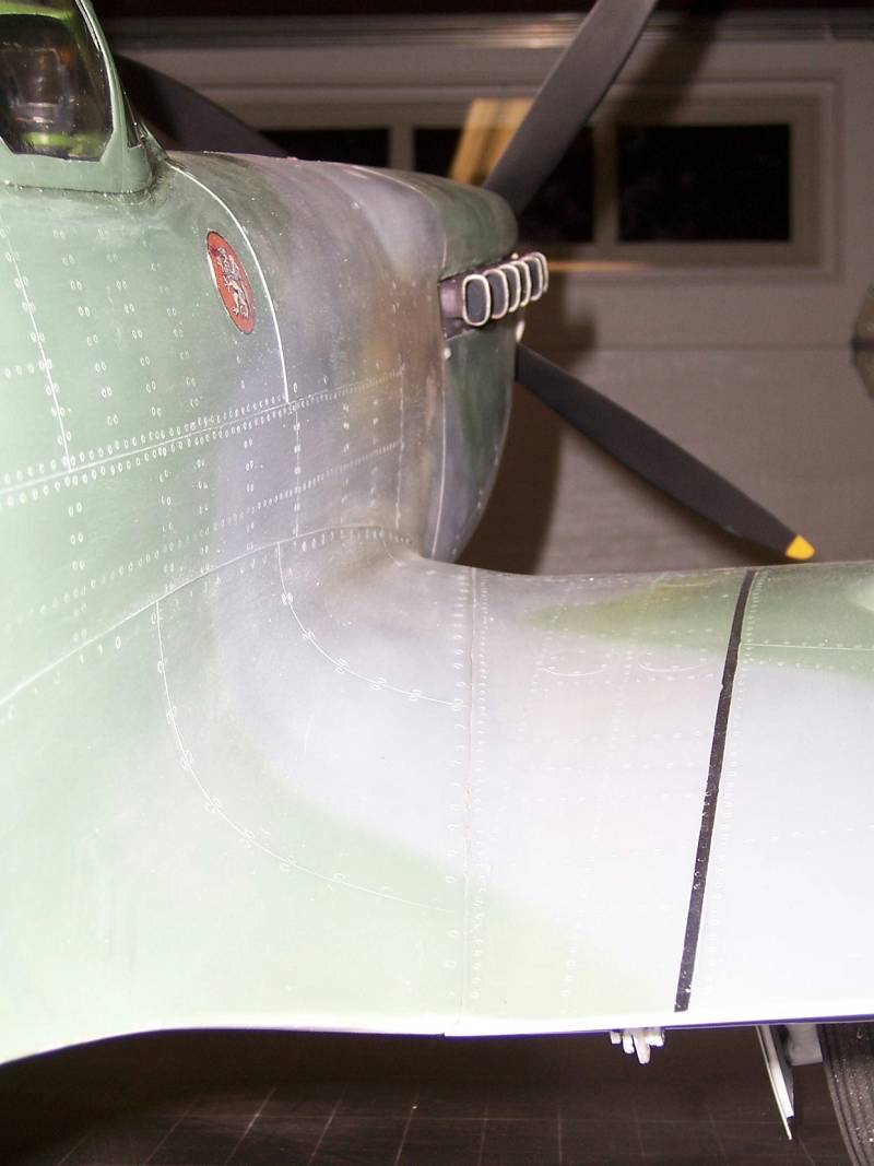

The method I use for flush rivets is the heated brass tube in primer technique. I used the smallest brass tube I could get, and mounted in my trim iron. I also put a 90 degree bend in the tube to make it more comfortable. I prefer to mark off all the rivets first, making proper spacing adjustments so intersecting rivet lines properly meet. After burning them in, I lightly sand with 400 grit to knock off any rough edges.
Scott

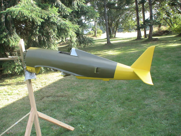

I burned mine with a soder iron and brass. I sharpened the brass though so it would go in easier and I could twist.
I didn't use a template so mine are not the straightess out there but it was the first time I did it. I did make a stand for it with a dial to adjust the power (thus the heat).
This is my TF P-47

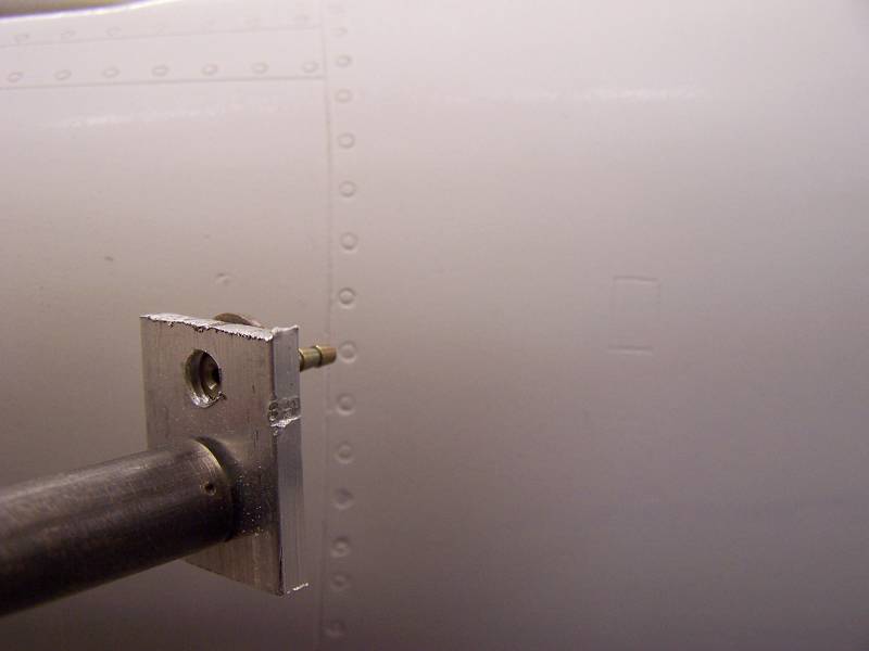

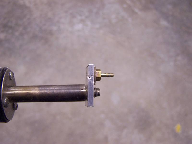

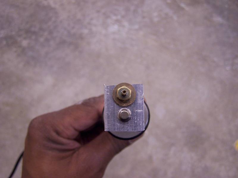

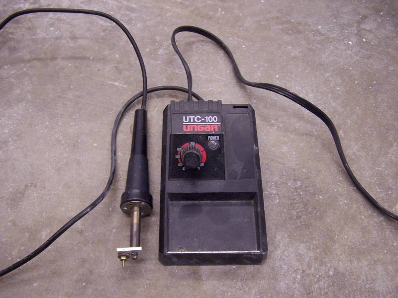

Here are some pics of the rivet tool I made from a soldering iron. It does help to have an iron with adjustable temperature settings. I used a brass fitting off of an old retract
Paul

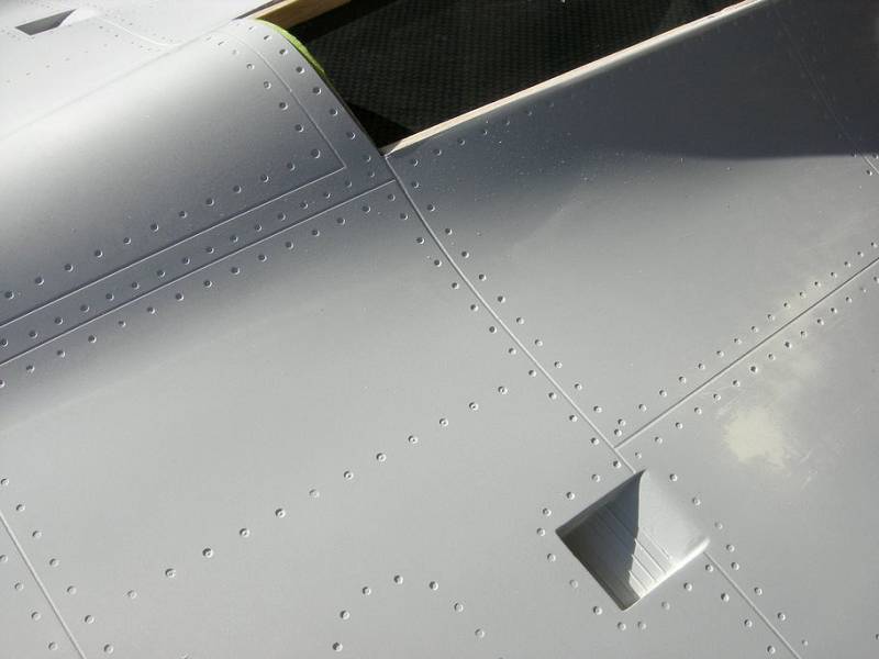

I did the whole surface of my SU-27 using a modified drill bit and dremel tool. It was actually extremely easy.

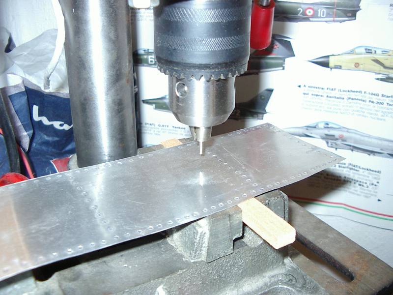

if you add a few little aluminium panel you can do this...
